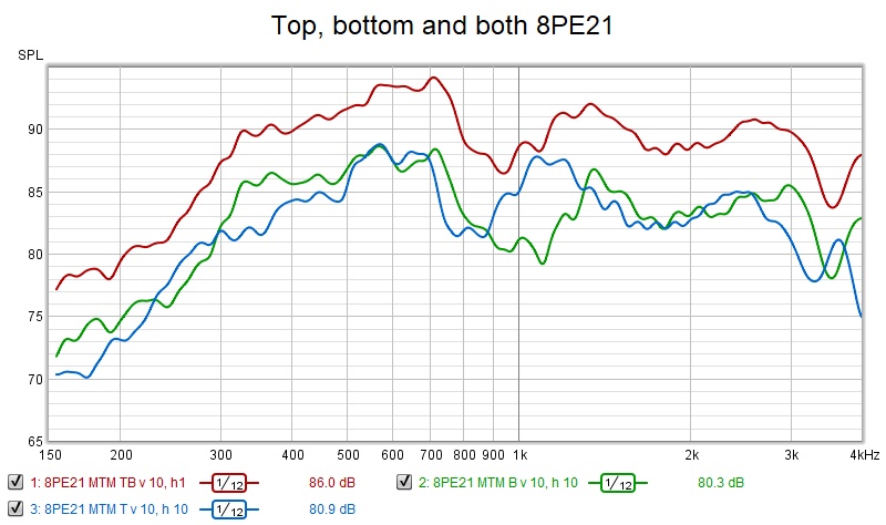

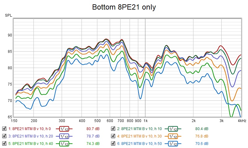

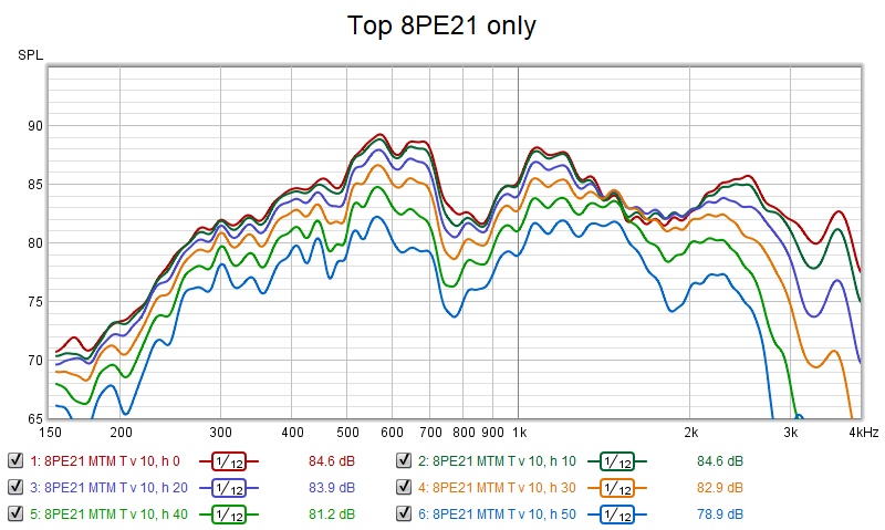

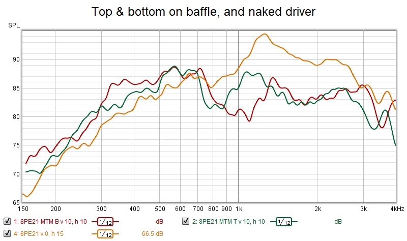

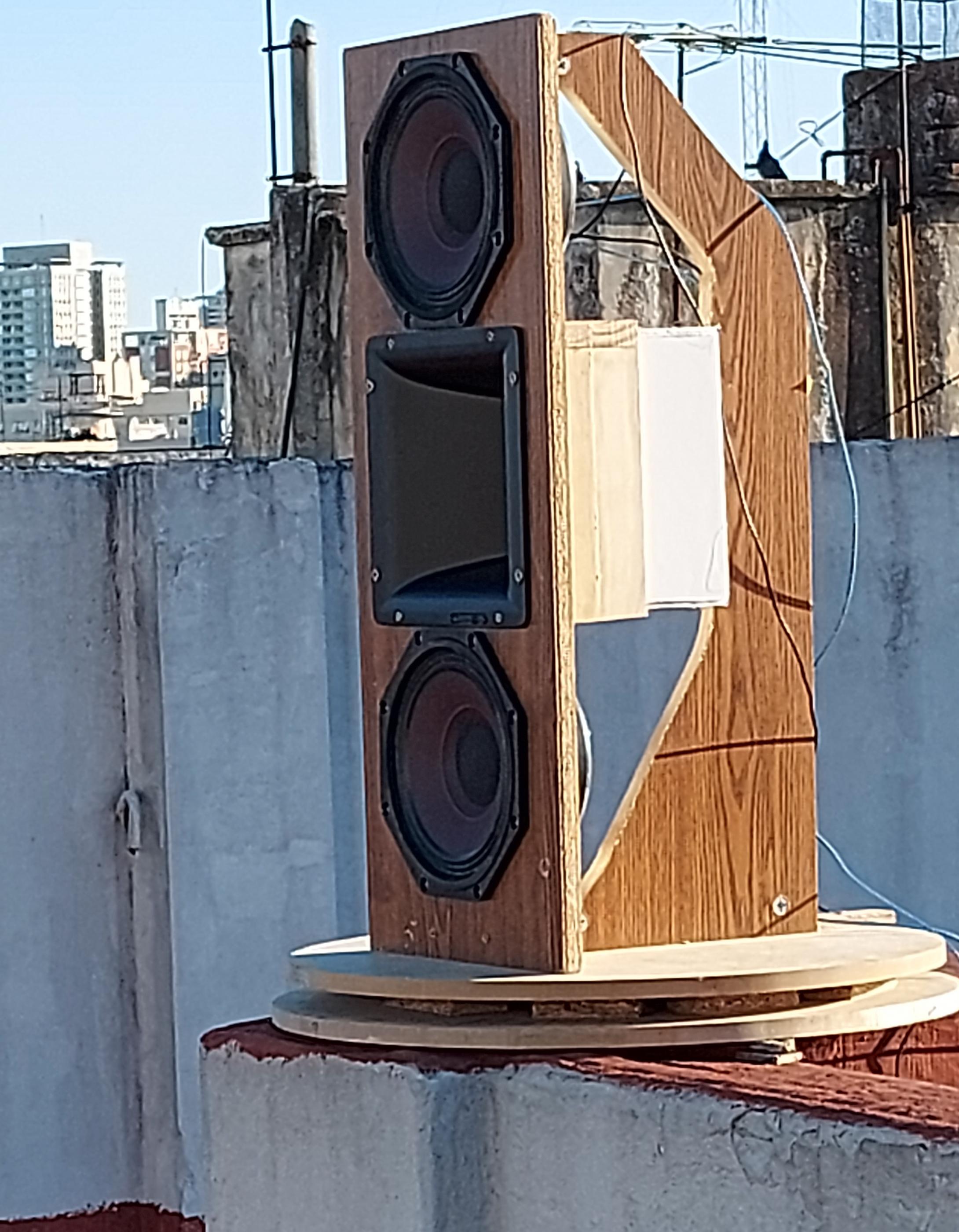

I was able to measure the MTM outside today. It was very windy so had let go of the intent to measure it atop the swinging 18" and placed the MTM directly on the measurement rotating table. Mic was placed at the center of the tweeter, mic at 1.6m from floor, 1m away from baffle. I expect a refection from the bottom 8" to the table, but it's a compromise I had to live with to get it measured today.
The MTM assembly was on the table and I connected/disconnected the driver I wanted to measure. TPL was installed but not connected.
Top driver playing alone:
Bottom driver playing alone:
Both playing together full range:
There is clearly something happening between 700 and 1300Hz. Probably a mix of driver characteristics (as seen in my Nov measurement of the naked driver) plus the effect of the baffle itself. But is interesting that when both drivers play together the trough at 935Hz it's at the same SPL that at where they reach at 290Hz. Since I will be digitally correcting the response, it seems 300Hz xo is a safe bet.
I guess an option is to run both 8" from 300 to 1500Hz, but the risk is lobbing around 1500Hz. So the inductor in between them would mitigate that. Looking at top, bottom and both drivers response:
The trough at 935Hz kind of kills my previous idea of taking the bottom 8" out with an inductor by 700Hz or so. Should I target 1kHz?

That 10db null would bug me. Should figure out what's causing it as your Nov measurement of this driver isn't that bad. I'd doubt this is correctable w/DSP .. at least not optimally without effecting overall in room voicing.

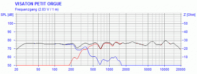

One can find the complete info from visaton about petit orgue right on their website:
PETIT ORGUE | Visaton
It is listed in German under "Technical Data" (you have to click "show all data"):
Trennfrequenz: 300 Hz
Trennfrequenz is translated to "crossover frequency".

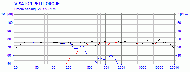

Let's look at their frequency response graph for the woofers, shown here:
You can see what remains of the resonance response peak from the Ripole's tunnels at about 350-375 Hz. It's not well attenuated, and this is why it appears that the crossover frequency is 400Hz. The peak could have been notched out, at least by 6dB or more, but that would require a more complicated crossover network. I'd give the execution a "meh". ¯\_(ツ)_/¯
Also, notice how the system sensitivity (it's shown for 2.83V input) is pretty darn low? This is another problem with the "Ripole" type constuction: low sensitivity. When using a passive crossover, all you can do is attenuate. To achieve a flat frequency response with extension shown (in the 20s!) you have to compensate for the rising response and in this case that means attenuating away almost 20dB of response by the time you get to 300-400Hz. You are left with the Ripole sensitivity at the low corner, and that is very, very low indeed. It's yet another reason why I prefer large H-frames. They don't have anywhere as much of a sensitivity problem.

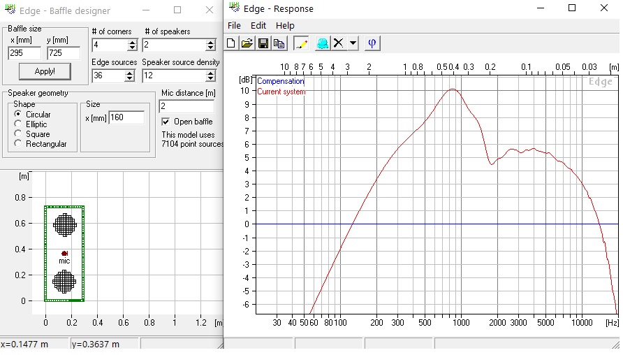

It's an 8dB null rather than 10dB and it bugs me too. Here's why I'm thinking it is a mix of driver characteristics and the baffle/MTM:
Here's a simulation with Edge with mic placed as it was during measurement: peaks at 800Hz, while the bottom driver measurement drops after 750Hz and the top driver drops after 700Hz.
Here are the measurements from top and bottom on baffle, plus naked driver measured in Nov:
Looking at the naked driver measurement, while not readily apparent when looking at that measurement in isolation, when superimposed with the top and bottom driver it appears there is a bit of a drop past 650Hz reaching the lowest point at 780Hz or so.
Hence my hypothesis that the null from top + bottom playing together is likely a combined effect of the baffle and driver characteristics.
Any other effect that could be coming into play? Or way to verify/discard any part of the hypothesis?

LewinskiH01 ... your hypothosis about lobing doesn't address the null when they're played individually. Must be something else. Any pictures of the as tested set-up available?

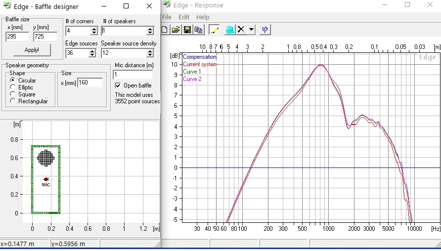

I modelled on Edge with the same open baffle, mic always in the same place, and simulated both drivers together (Curve 1), bottom driver only (Curve 2), and top driver only (current system).
Surprisingly they all display basically the same behavior. They all peak at 800Hz, though, which kind of mimics the null that was measured for both.
I didn't take pictures of the whole setup. I'm attaching the only picture I have, that only gives an idea of placement of drivers vs rotation table...FWIW. The center of the AMT tweeter was 1.6m above ground. I'm wondering if there was a side reflection from the mid-height wall seen on the picture. There are actually two identical walls at both sides 4m away to the left and right. The wall looks higher on the picture than what it actually is...I'm thinking it's lower than 1.6m (where the mic was).
