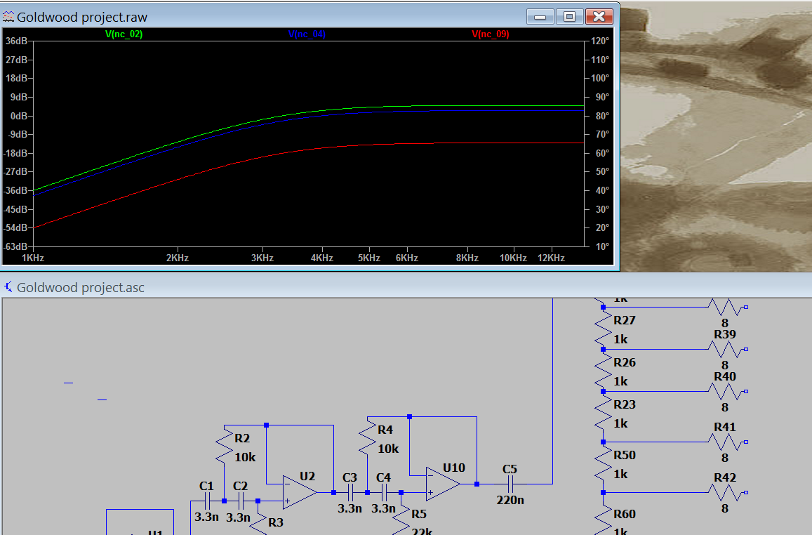

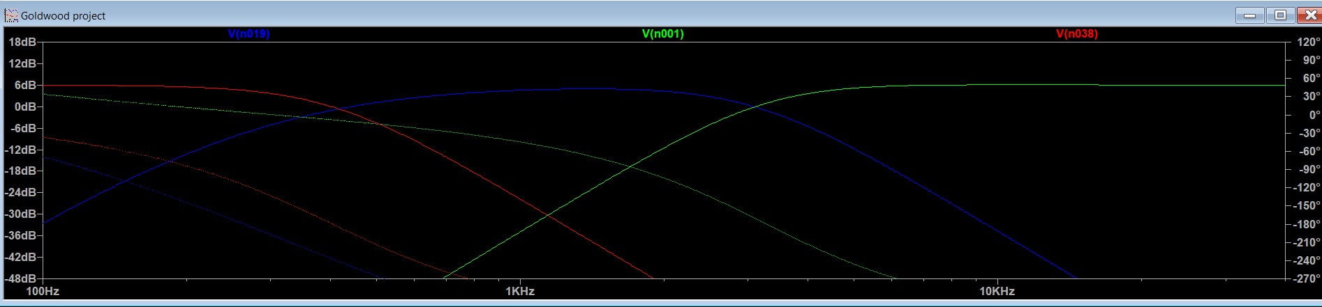

Here is famous example about 3 way active crossover
https://www.eeweb.com/electronic-crossover-with-3-way-output/
At the end of each filter he put a 10k trimmer for adjustment .
I tried to simulate the trimmer as a pot and it very very impedance dependable
Each test I put one ground to the 8 ohm resistor where I would like to test .
for more detail down load the project , am I doing something wrong ?

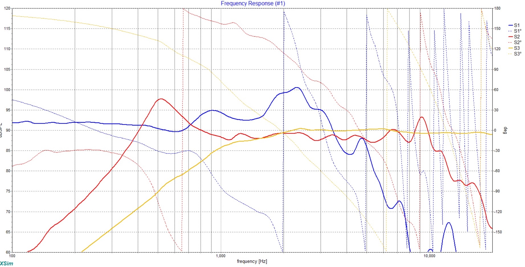

I could see with XSIM just need to know what configuration I has to do .
And how to calculate it with the XO in LTSPICE .

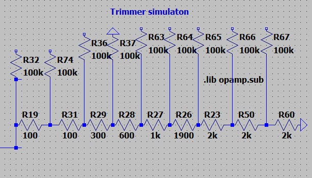

What is the problem?I tried to simulate the trimmer as a pot and it very very impedance dependable
Right I forgot we connect the active XO to the amplifier not direct to the driver
The input impedance of the amplifier is probably about ~100k
So the trimmer simulation should look like that and to put the ground where we want the adjustment .
Actualy the XO is fine no need to change something there .
off course the drivers isn't equal with there phase .
Here is picture of the drivers phase without any filters
The cut off FR of the active XO is 400HZ and 3KHZ .
At this points the difference , in the phase between bass mid is ~ +30... +60 degree toward the woofer .
Mid-tweeter about a +120 toward the mid .
If I get it right , to do the adjustment we have to minus woofer phase or to add midrange phase , in the XO , same trick to mid \tweeter ?
