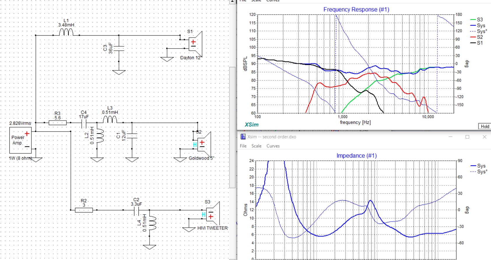

I will read how to do this and update you .Did you engage hilbert transform in XSim for phase calculation of the files that don't contain phase data? It appears you did not.

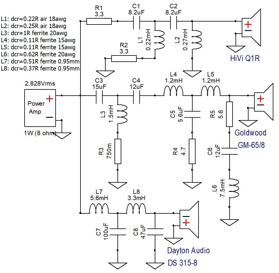

parts for cross over are cheep no problem with that . after your design I find some money and order it and test it .Right, good luck Rhino when you see a 20 parts filter in the midrange section only.
Ok looks like you made the circuit well done , but it is not normal to build such big circuite perhaps we could make more simple circuit . or maybe replace the midrange to more suitable driver
here is project it should look like that ?
three-way crossovers are almost always big and complex if done properly.
you might be able to simplify by using a midrange with more flat response, but i doubt that.

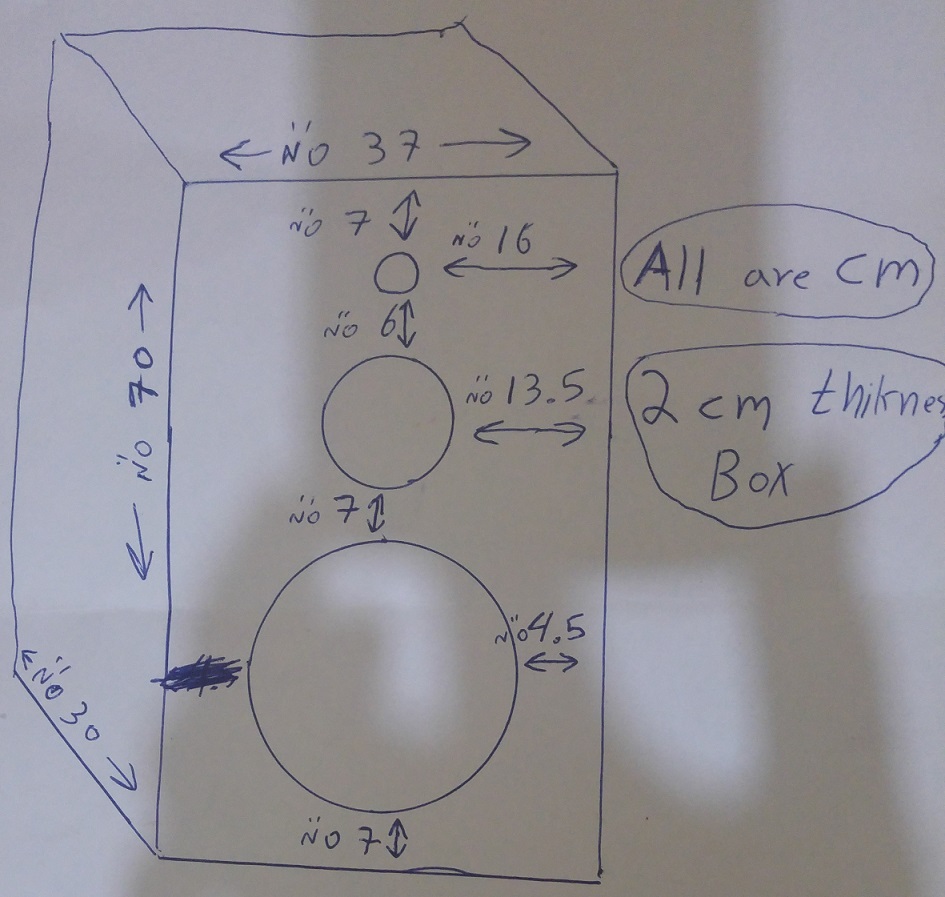

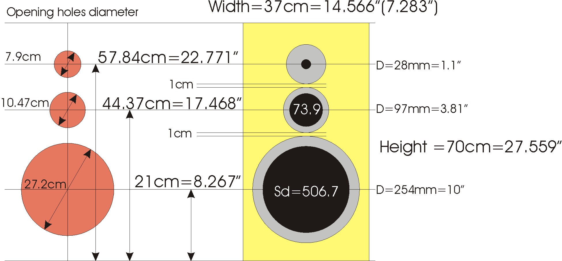

considering that mounting the tweeter from behind the baffle is no good idea (unless you have a precise idea of the waveguide you want to build) and you want to simplify the project and use the existing enclosure and the woofer you might be able to change the project to a two way system with a 5" fullrange and a low crossover frequency.
