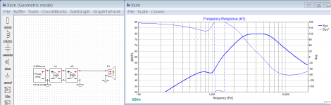

It could be done using VituixCAD, Xsim3D, Speaker Workshop and probably others.
If you measure with a microphone on your scope then you will be trial and testing for a long time, but you can do it. How will you set the phase when some of the response is not minimum phase? You need a plan to get from what you have to what you want.
OK I understand it .

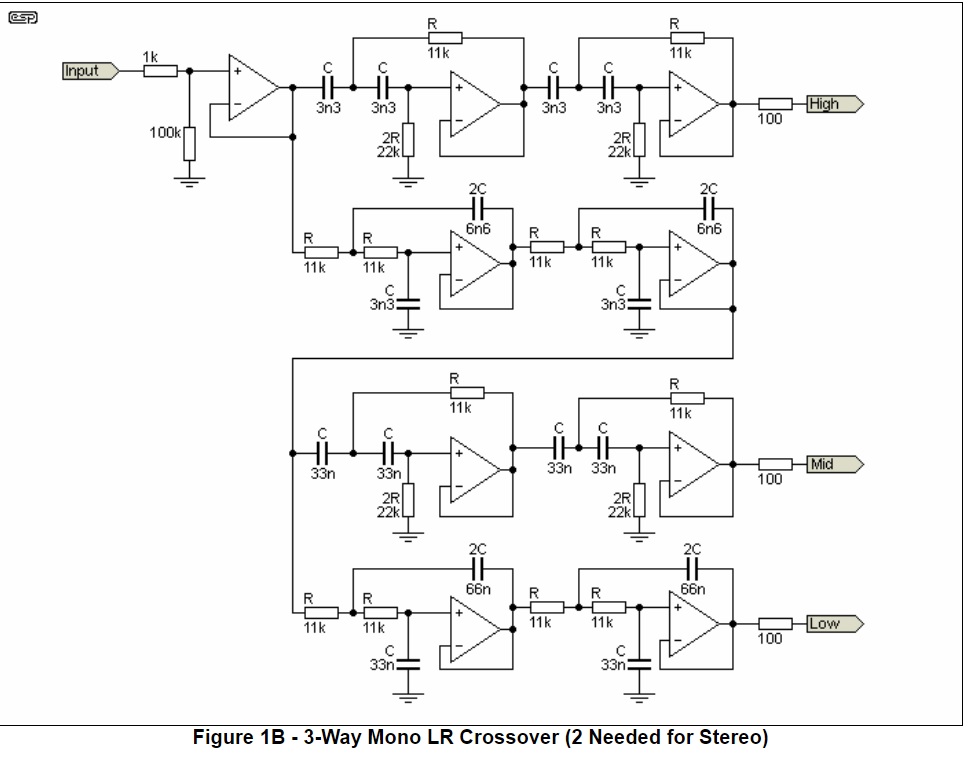

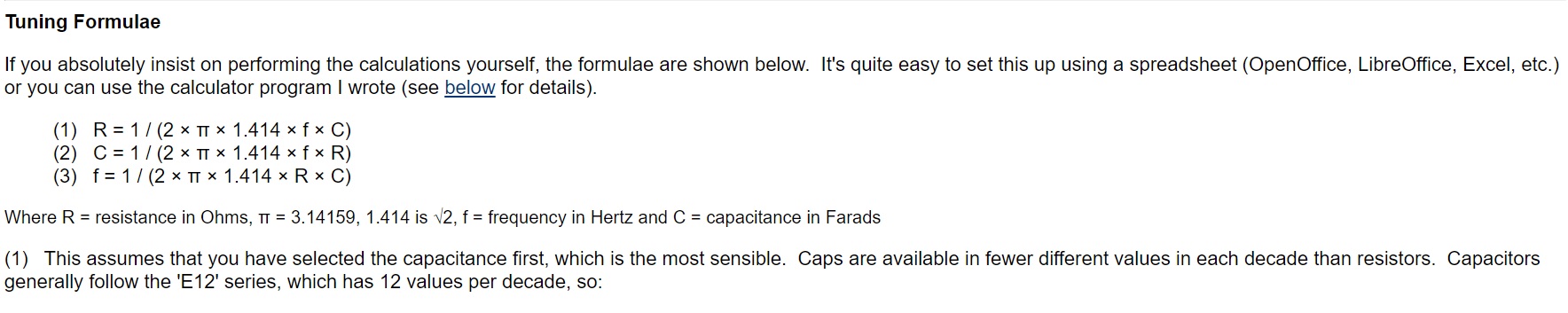

This is the formula for cut off active cross linkwitz

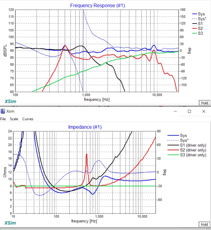

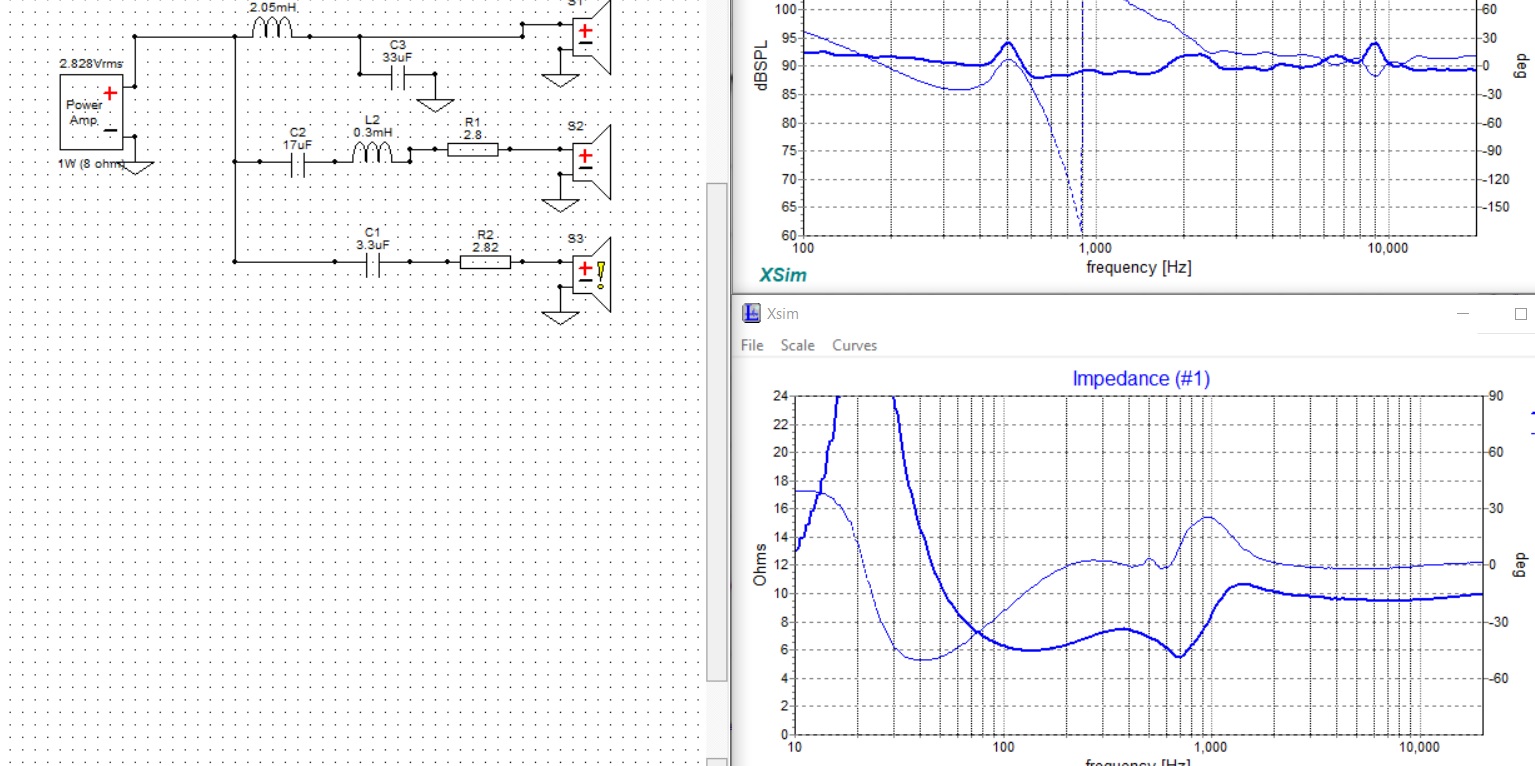

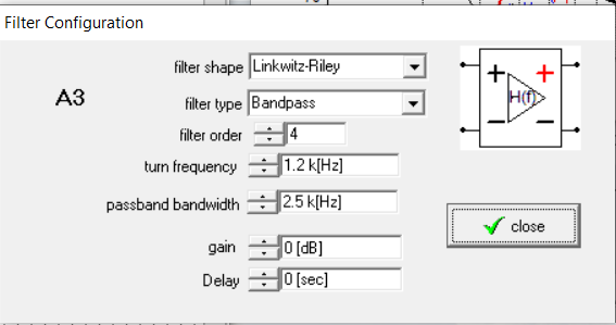

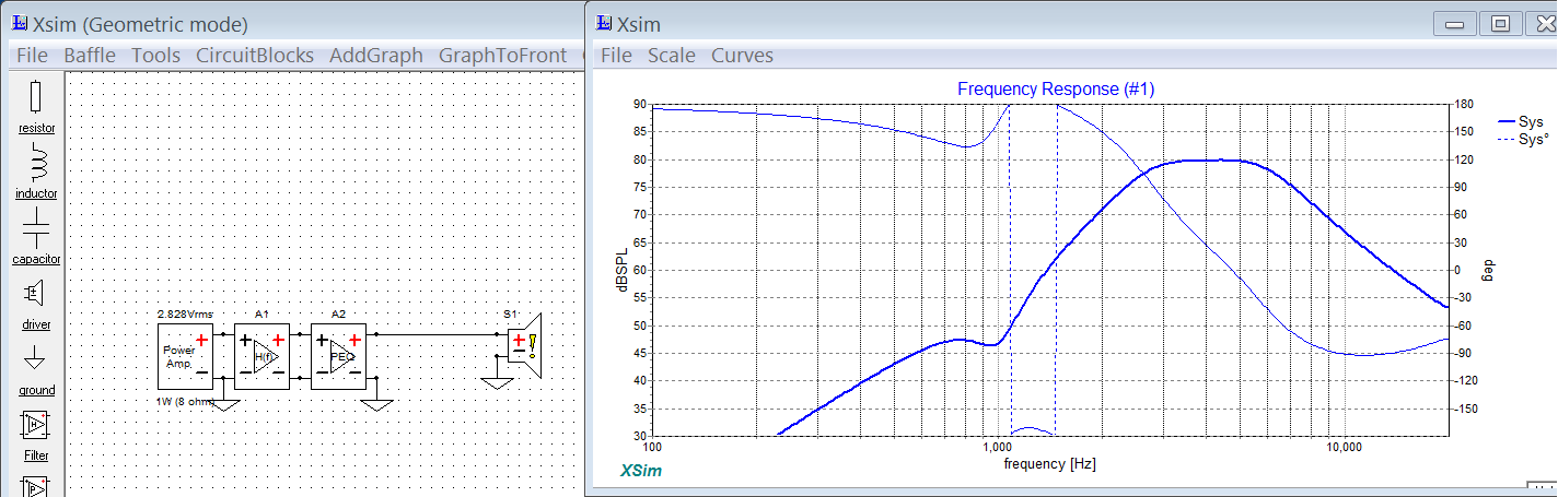

I test filters in Xsim linkiwtz 4 order 24db
looks like the best filters to my elements is
LPF for woofer with cut off 600HZ
Band pass for Mid 1.4KHZ-3KHZ
HPF for tweeter 3.2KHZ
There is allot of space between woofer and mid that is because
both are need Attenuation at this FR range .
