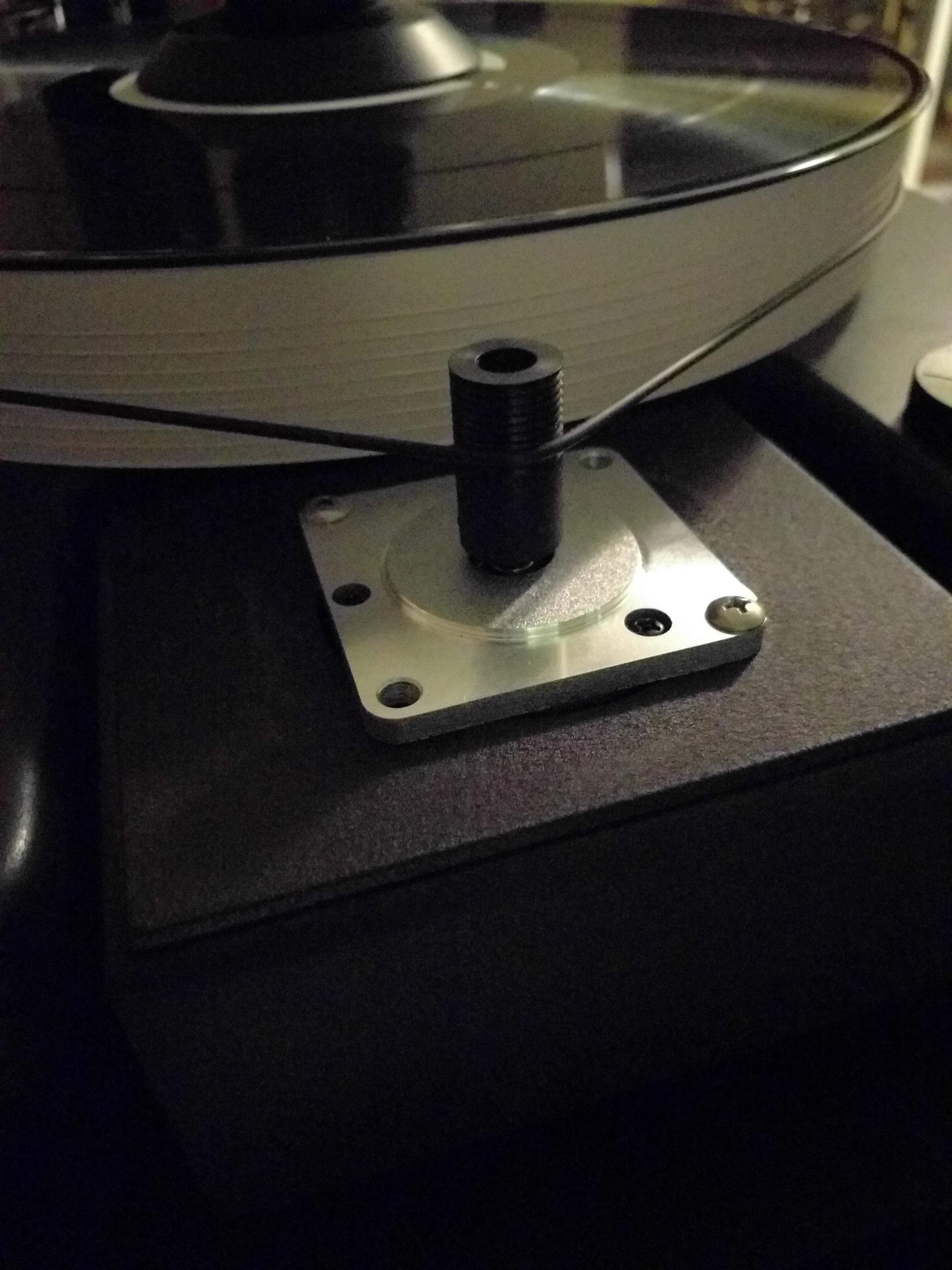

I am going to try and 3d print a 1/4" pulley with an online machine shop called Xometry, tolerances are stated +/- 0.004” or +/- 0.002” per inch which if no warping or any other issues occur I would assume will function. Price is $36 and doesn't drop with quantity.
Nice! How's the speed stability, vibration and sound?
Sound is good and the speed seems stable. It's definitely quiet. Can you walk me through a way to measure wow and flutter? I have access to a pretty good USB A/D converter, from there I'm not sure where to go.

The material is FDM printed ABS-M30, its suppose to be a high tolerance functional plastic that can be used in end product applications. I am going to send them the file that Pyramid put earlier in the thread after a quick check for measurements in cad. If this doesn't work or that pulley is off, I will probably design another one and or reach out to machine shops local to try and get one done.
