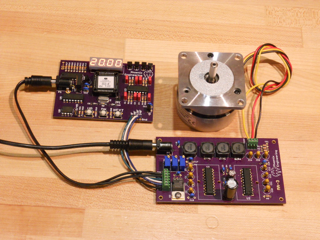

I took apart both BLWS and BLWR motors to check build quality and construction details.
One thing that I did not expect to see is dynamically balanced rotor in both motors. This certainly lowers rotor vibration and level of noise generated.
Next, ball bearings are press fit onto shafts and preloaded with wave washers. There is absolutely no axial movement/play that I could detect mo matter how hard I was pulling/pushing the shaft.
There is barely detectable cogging when shaft is turned by hand in the motor with 4mm shaft and no cogging at all in the motor with 1/4" shaft.
I am trully impressed with the mechanical construction and build quality of AA motors. I cartainly did not expect it in this price category.
In couple of days I will have Maxon DC motor and controller in my hands. Retail price is slightly over $500. Rest assured I will take the motor appart to see what makes it 5x more expensive than one from AA.
My circuit boards are out for delivery today. I will build two amps, one for each type of AA motor, and test over the weekend.
Report will follow in few days...
Pyramid, just wondering if you have a finished controller you could post pics of.
Also, what platter diameter are you using to determine pulley diameter?
Thanks, Greg
These photos are in the assembly instructions as well.
The pulley diameter is for use with an 11.5" platter. If you have a 12" platter, it will still work, but the 33 RPM freq then becomes 20.87Hz (41.74Hz for BLWR series) and 28.17Hz for 45 RPM (56.35 hz for BLWR series).
