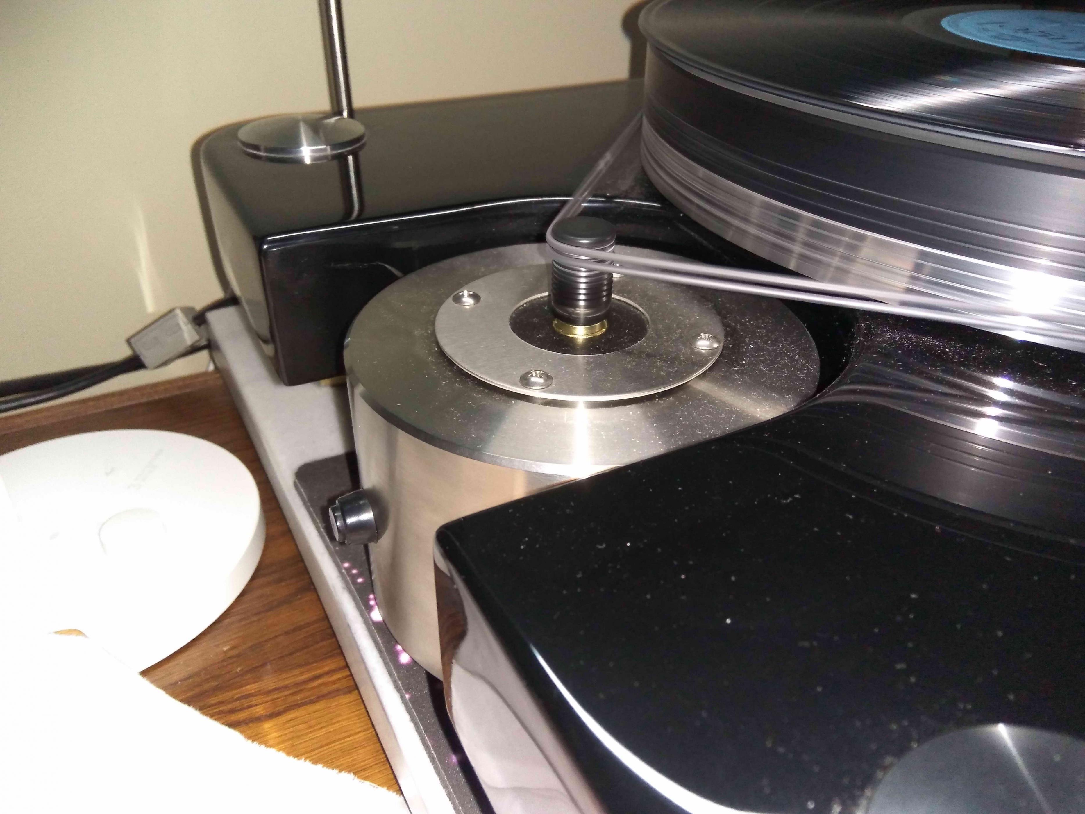

I own a VPI Aries with dual belt and Falcon - Roadrunner.
Am I right that I can use my pulley with the BLWS series motor? (with the SG4 of course)
@Mirko-You should be fine with that combination. 600 RPM is ideal.
@ george-You would need a new pulley with the BLWS motor. It has a 0.25" shaft and the VPI pulley is 3/16". The BLWS motor should fit in the VPI motor pod.
The BLWR series motor will work with the VPI pulley with the addition of a sleeve to convert its shaft (4mm) to 3/16", but the motor will be too tall for the pod.
I'd advise against this. Nearly impossible to keep everything concentric. If you have a lathe, turn a new pulley from scratch and do the center bore in the same operation to keep everything aligned.
Granted, it's not easy...However, I think it is possible to do if I make an arbor the size of the original bore, clamp the pulley onto it and bore with a centering drill from the opposite end. I'll have to compare the tolerances of the new motor shaft with my center drill and a test bore. I don't need to bore the pulley to its full depth, as it can be flipped and set screws added to the opposite end. This assumes that VPI made these perfectly concentric to the bore to begin with. I will test the run out of both my arbor and the pulley.
