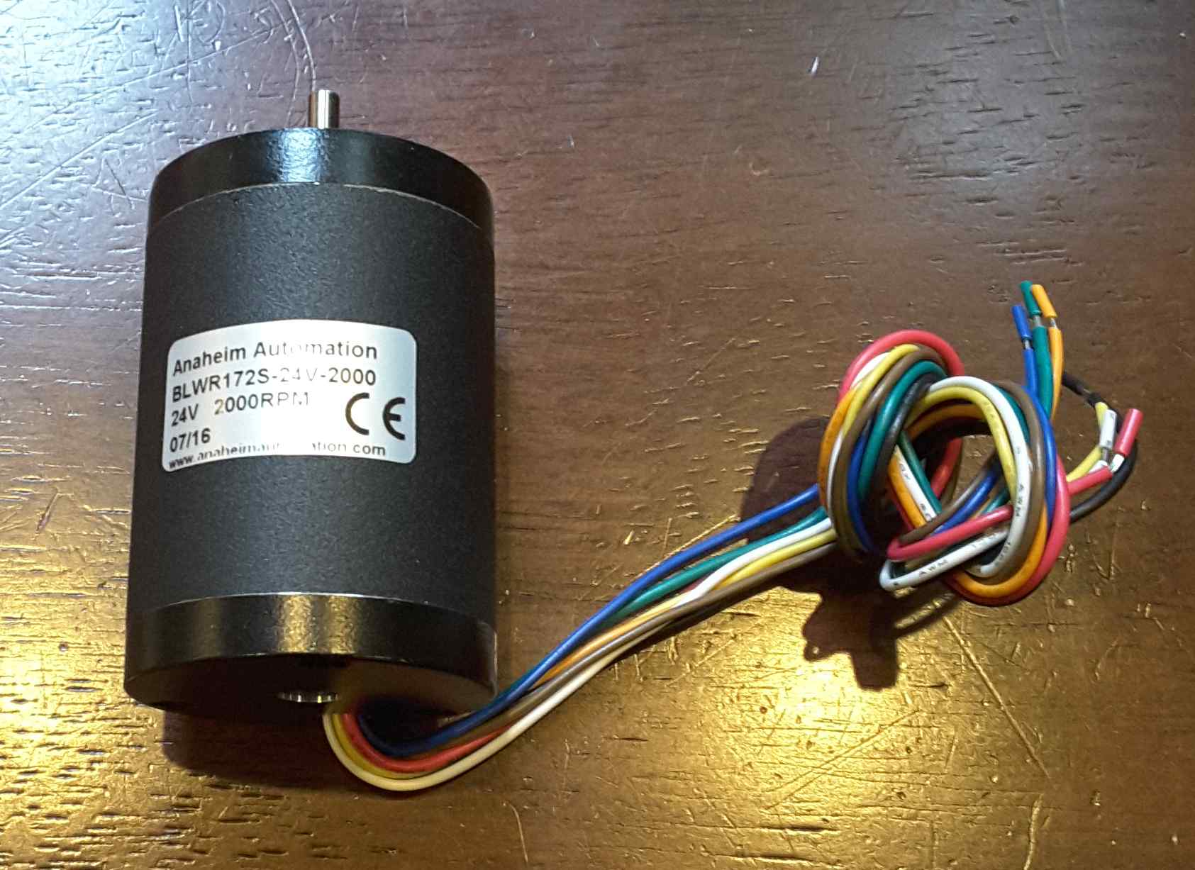

I assembled two amplifier boards and tested with both BLWR and BLWS motors. BLWS motor is slightly quieter and both motors produce more than enough torque to drive 20kg stainless steel platter.
Currently I am using BLWS motor and it works great. I did not have time to compare it to SG4/PAPST ac drive yet but I can tell that BLWS motor is quieter than PAPST.

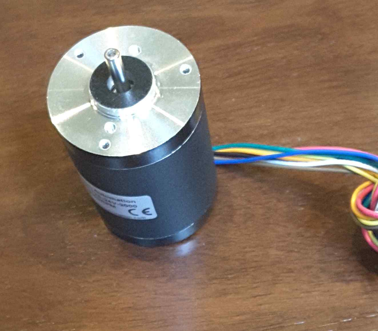

My AA motor arrived today and I'm so excited I had to post.
@cary300b - did your maxon motor come in? I'm really curious.

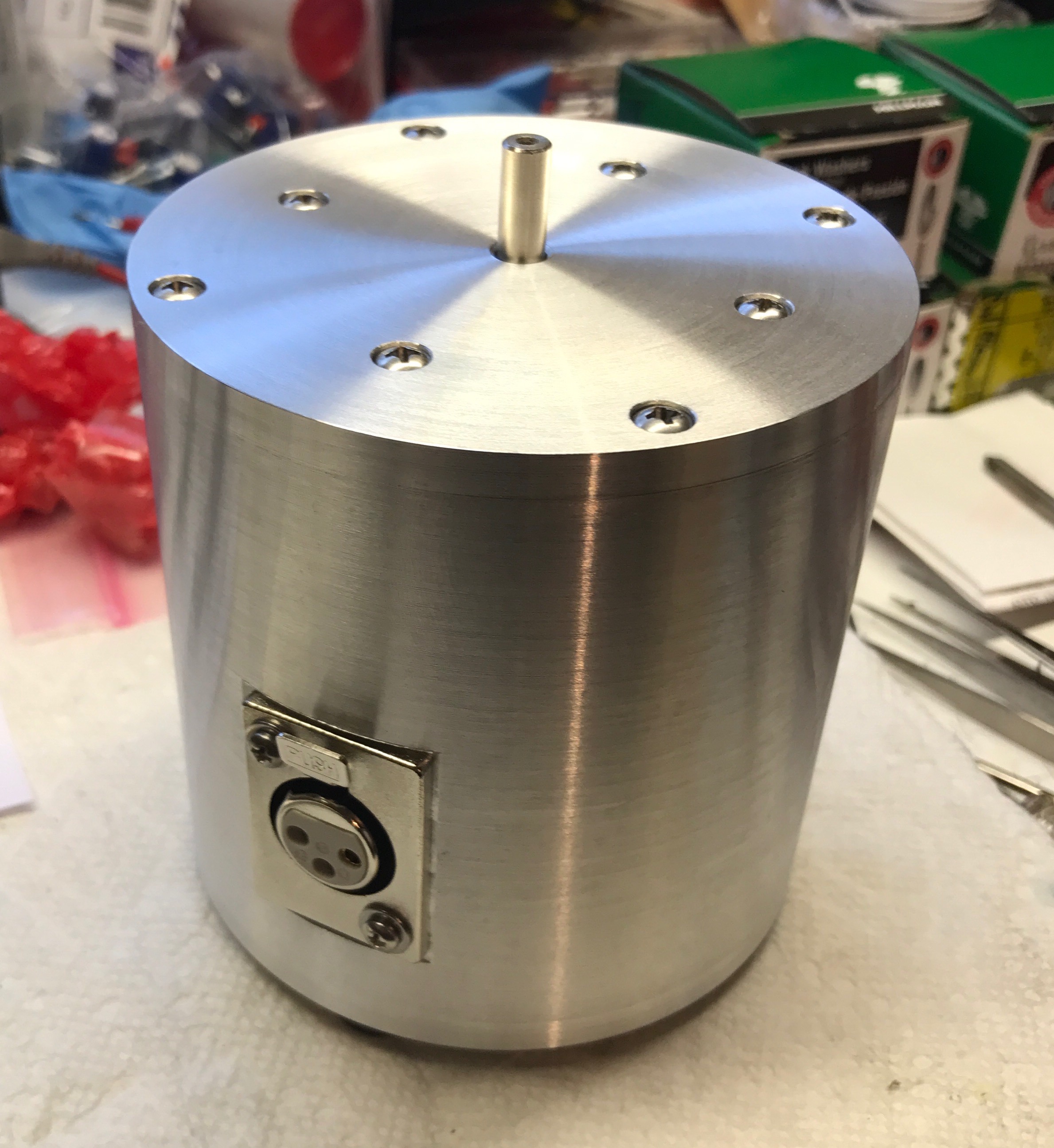

I posted this pic in the motor thread already, but I figured since there was a discussion here about motor weight, vibration and damping I would chime in with a little more info.
My motor housing was made from 1/2" wall 4" diameter aluminum pipe with 5/16" aluminum plate to cap the ends. The total height of the housing is just over 4" with a 3.5" tall cavity. I used the smallest diameter lead shot I could easily source (#9) to fill it once it was complete.
The only other items I added to the assembly was the XLR connector and a small plate of aluminum that is bolted across the bottom of my BLWS motor using longer hall sensor mounting screws so as to prevent the lead shot from possibly entering the motor or binding against the bottom of the motor shaft.
I was able to achieve a total weight of the motor assembly that is just under 8 lbs.
