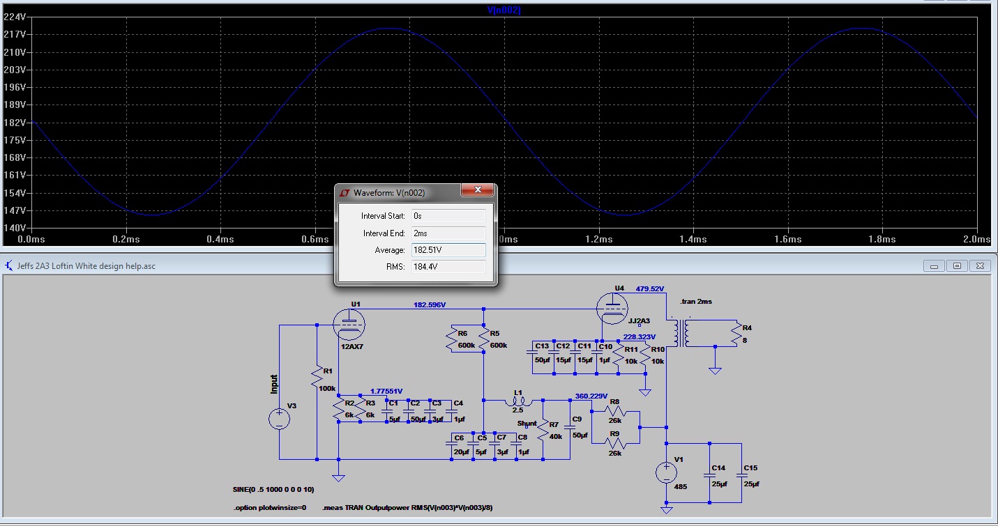

3 direct coupled 2A3 amps
Do a quick calculation: what's the "looking in" impedance at each of the cathodes?
You lost me there. Are we calculating impedance of the parallel caps and resistors at a given frequency? Or each one separate at different frequencies?
I see your point as each one would behave differently at the same frequency.
Does a 12ax7 had the stones to drive 2a3? - even when parallelled? You might just want to try a pentode or triode strapped pentode... then LED bias the first stage...
Doesn't do a great job but the MU is very high on the 12ax7. Anything past 2.5 watts and it starts falling apart. If your looking for the output of a 45 in a two stage then this would make sense.
The attached is a snap shot of the voltage swing at the 12AX7
My Direct Coupled inspired by Dr Lowmu

You want R1 to be 250K or more, not 100K.
You do NOT understand how we bypass Rks. Never ever ever by traditional formula, always determined carefully by ear.
The largest Rk cap ( main cap ) on the 12AX7 will be 15 uF Film. All the other bypass caps, to that, will be various diminishing uF sizes, all under 1 uF, selected by ear, usually 5 added. Ditto for the 2A3 Rk, except 10 uF would be the largest main cap. The B+ voltages you picked are right on, very good.
If you wanna build something, I think you should contact me privately so you get it done well. I will help.
Half a 12AX7 will easily drive a 2A3 or Type 45 grid, because the 2A3 and Type 45 is EASY EASY EASY to drive in a direct couple !!!
Never should you try to parallel the driver tube, because, being high mu ( 100 ) you will get poorer sound, due to skewing of two dissimilar 12AX7 sections. Diction and enunciation on voice will clearly suffer, despite the "technical " EE reasons to parallel, it doesn't ever work.
Isamu Asano used 0.43 mA. and I use 0.60 mA. to drive the 2A3 superbly. Nobukazu Shishido used 1.0 mA. to direct drive the 2A3, but I have a feeling, Nobu's published schematic on line is NOT what he did in real life, a single triode is what sounds best there, Nobu showed us a paralleled 12AX7- yuck !!
I have A-Bed all of this, as have others, and I have DIRECT experience.
Neither. Multiple parallel caps are generally not useful and can sometimes cause problems of their own. The question then is, what to use for bypassing.
You start by determining the impedance that you need to bypass. For example, let's look at the first stage. The effective impedance at the cathode is 3k (the two paralleled cathode resistors- you really only need one resistor there, paralleling has no advantage) in parallel with the plate load + plate resistance divided by the mu. In this case, the plate load is 300k (the two 600k paralleled, ditto the previous comment), plate resistance is about 70k, mu is 100. So in parallel with the cathode resistor, you have (300 + 70)k/100 = 3.7k. In parallel with the 3k, you have an impedance at the cathode of about 1.7k. That's what needs to be bypassed.
Let's calculate the required capacitance. We'll call the lowest frequency of interest (say, a decade below the desired bandwidth) 2 Hz. For an f3 (at the cathode!) of 2 Hz, the capacitance calculates as C = 1/2pifZ = 1/(6.28)(2)(1700) = 47uF. So use a 47uF electrolytic cap there. You might want to go a bit smaller on it since there's a tradeoff between low frequency response and overload recovery time. But let's go with 47u for illustration.
An aluminum electrolytic cap will have a small ESR (under 0.1 ohm), but above its self-resonant frequency, the impedance starts to rise. For a single good quality cap (i.e., NOT an "audiophile" capacitor, but a well-manufactured name brand part), that rise might be as high as 3 or 4 ohms at 500kHz, way past any bandwidth you care about. But notice that the impedance is ridiculously low compared to the impedance at the cathode (1700 ohms). So the bypassing quality does not significantly change for any audio frequency and for at least an order of magnitude beyond.
Multiple bypassing complicated the picture by adding in all sorts or stray resistances and inductances. At best, it won't make things any worse than using a single decent bypass cap. At worst, you'll compromise the circuit stability because of the strays and the new loops created by the physical placement and wire leads.
