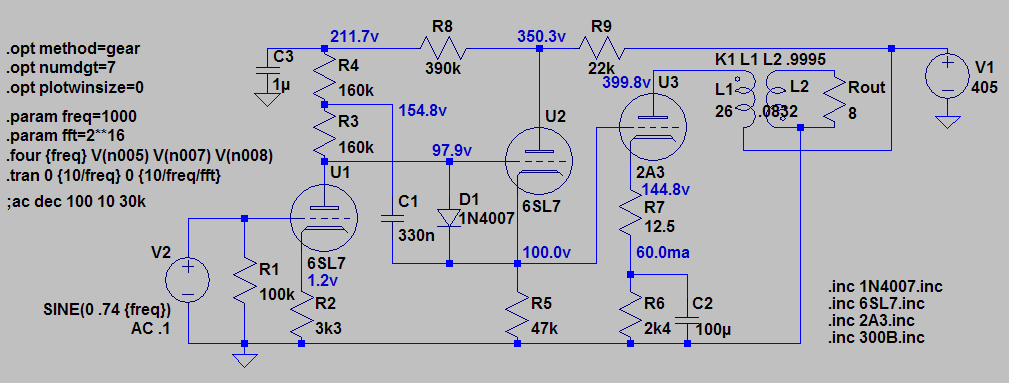

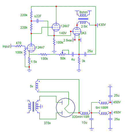

I spiced up the cathode follower circuit (3rd schematic post #1) a little. The freewheeling diode protects the 6SL7 during power on. The pre-stages deliver a nice 90 Vpp at 2ma thru the 2nd 6SL7 into the 2A3. Input sensitivity is 0.5V RMS.
THD for the pre-stages at full power is <0.1, with H3 and higher <0.03 for most of the audible range.
THD for the full amp comes predominantly from the 2A3 and consists mainly of H2, which is ~4.7% at full power. H4 is at 0.2, H3 and others is <0.1.
Note, all values from simulation!
Together with the direct coupling, this should make for a sweet amp. I think this sircuit is the one I'm going to use in my next built.

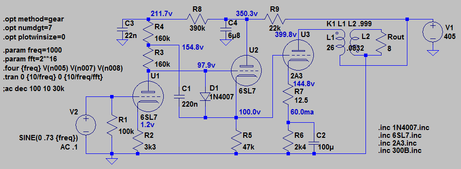

I sized C3 to stabilize the voltage for the input stage. The resistors are quite large and current flow is small, so C3 can be small as well. We can use a nice mkp or pio.Not bad. Is C3 not too small?
I did not yet check the effect PS hum.

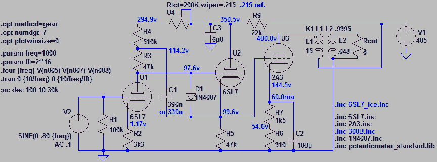

I messed a bit with the caps on the cathode follower schematic, and it's pretty final now.

3. Bootstrapped cathode follower
Pros:
- very low distortion of pre-stages at full power
- lowest output impedance, best drive for 2A3
- no need for bypass cap in pre-stage
Cons:
- additional stage, 3 stages total
- introduces additional cap for bootstrapping
- highest distortion at output at full power
- does not seem very popular, untested in RL(?)
All three topologies deliver about 3W rms into 8R impedance speakers using 2.5K primary trannies.
The cathode follower circuit has been sketched up by myself, using details from various sources, but there seems to be no tried and working instance around anywhere, so watch out. There may be kinks or room for further improvement.
Now, my question to you guys.
Anyone who tried these configs can comment on them from RL experience? Is there any mess up or striking error in the 3rd circuit?
Thanks & greetz to all
The bootstrapped follower has been tried: Loftin White: ECC83 300B Darius Loftin White Fortsetzung
But as long as you are at it, why not ditch the output cathode resistor and add the PS noise canceling circuit above. I built an amp based on Darius's circuit and it's my favorite amp. So quiet that it's my headphone amp. I didn't use the bootstrapped follower, but would have no hesitation in doing so. Note also that there is not an electro to be found in the amp or HV circuit.

Pardonez moi, but being ignorant about this, why is the "cap bootstrap" required for the cathode follower version?
Also, why 100K for the cathode? seems lowish in current through the driver tube?
Explained here, check the forth figure: Loftin White: ECC83 als Treiber für die 300B, Bestimmung einer Kennzahl
The bootstrap cap raises the impedance across the input plate resistor to 12MOhm, which makes it effectively a constant current source. Normally, a follower is used to lower the output impedance, which argues against a high u tube (with relatively high plate resistance). A high u tube in this instance makes it a better follower in the sense that the cathode more closely follows the grid. Same argument applies for using a large cathode resistor in this position.
Sheldon
Example (easy to change values to suit 6SL7). Fewer parts too:
http://www.diyaudio.com/forums/tubes-valves/128695-2a3-design-issues-long-2.html#post1595084

Thanks for all the suggestions, esp. hints from sheldon and listen. The Free Lunch looks great as well, but as I said anode chokes are just not my deal.

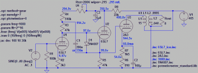

First, I wanted to post a correction to the CF schematic, see attached. You can trim the voltages in the system and bias of the 2A3 using the pot.

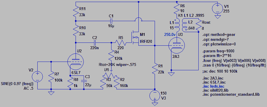

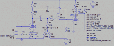

Then, while pondering lots of schematics, I came back to the tubelabs power drive, and sketched up a variant using no dedicated CCS but using a bootstrapped source follower instead. See 2nd attachment. This circuit obviously introduces a few caps here and there and needs a fixed bias supply, but should be good to deliver some A2 up to 5 watts from the 2A3 easily.
