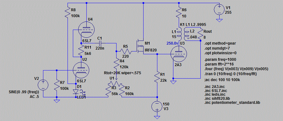

You could simply substitute a FET bootstrapped follower for the 6SL7 in the Loftin-White design. It's direct coupled, plenty of drive for A2, cancels PS noise (no electrolytics anywhere, including the power supply), and no cathode caps. The bias is self adjusting for tube wear.
It burns some extra power in the output cathode resistor and takes a little iteration to get the operating parameters dialed in during the design phase, but from then on rock stable.

You are right, the L-W still amazes today, although there are obviously a few caps connecting the cathodes of both the output and input tubes.
I attached another design which uses only 1 single small valued cap in the whole amp circuit, which is the absolute minimum I came up with. The currents across this cap are tiny and it works into well defined loads and never sees any surges from overdriving, clipping or such.
I believe the cap could be replaced with a 1-1 interstage xfmr for a totally capless design, but I'm not sure if this would distort any less than a quality coupling cap.

One small cap in series is certainly one cap too many, as is any interstage transformer. Nothing can beat a well done two stage with DHT finals and a small piece of 13 AWG Siltech ( silver with gold ) wire connecting the two stages.....

You mean something like this?
Of course, it's not a power drive and no class A2 action.
With the original Loftin-White take off, yes they are caps, but can be quality film caps. And the power supply needn't have very low ripple (that string between the cathodes completely cancel it. Few understand the design, but I can tell you it works. Here's a headphone amp I plan to cook up. Another option with even fewer caps is use that FET as a current source for the input tube, instead of as a bootstrapped follower. For plenty of A2 drive you can select an appropriate FET. In the current source case you can also use it as a u follower (probably a little better drive capability).
One more bit of info. The bootstrapped follower is probably the better choice, because it acts more like a gyrator than a constant current source. It lets the tube set the voltage, whereas a current source doesn't respond to tube changes over time or between tubes. As a result, the voltage will vary more over time or tube change with a CCS than with the follower.

You are right. The fix CCS schematic from post #44 is too simplistic and I do not recommend to build it. Anode voltage and thru direct coupling the bias of the 2A3 will potentially fluctuate wildly.

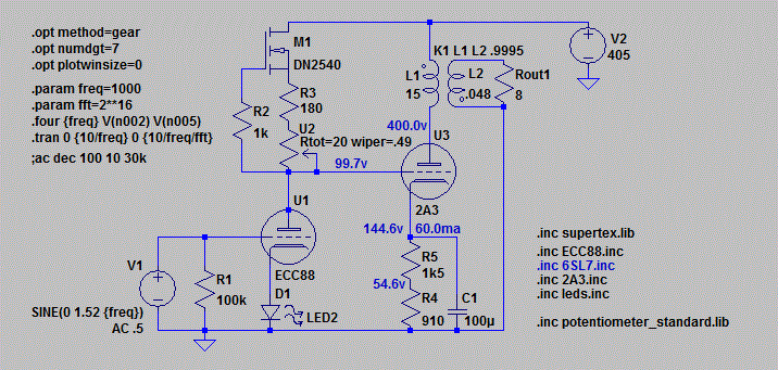

Ideas for Goldenbeer
From my experience, in 2 stage DC 2A3 amps, regarding your schematic in Post #44 above :
(1) your idea of using a 405 VDC B+ is not good. You want a B+ in the range of 450 to 500 VDC for a 2A3 or Type 45 Finals tube, mainly to optimize the DRIVER tube in the circuit.
Most of what you hear in such an amp is the DRIVER tube, just as Thomas Mayer has also written.
(2) Avoid use of a 6SL7, if you seek the ultimate in clarity, great diction on spoken words, and proper enunciation. The 6SL7 is pleasant, but gets a "D+" grade in the areas I have mentioned, it always had me "wanting more".
(3) Use 1/2 of a 12AX7, a 9 pin miniature tube. It can not be beat in this topology. Never parallel a high mu Driver tube, such as Nobukazu Shishido did, in a L-W amplifier. The triode halves do NOT match, and it is heard as a SKEWING of the music, to be avoided at all costs !!!
One ( or many ) REASONS why you can't beat a 12AX7 is because it is a 9 pin miniature, and the tube construction pins come right out of the envelope of the tube, and directly into the tube socket. Where the 6SL7, or ANY high mu octal tube "messes up", is when they have to add an extra solder joint, on every pin of the octal socket, which causes its vagueness in sound - as a high mu driver.
Despite common practice, and ANY thoughts on Miller capacitance, the 2A3 and Type 45 are VERY EASY to drive in a direct couple, and so, half a 12AX7 can be the best possible choice for 99 percent of the builders.

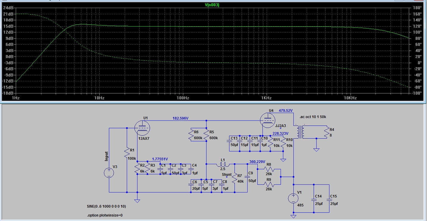

Now, back to your idea of 405 VDC for B+, and my suggestion of 450 VDC to 500 VDC:
a) Since we hear the Driver, most of all, it is incumbent that we totally optimize the Driver tube's Op points. Most old timers who are really "pros", will tell you a 12AX7 sounds best with about 195 VDC on the plate...most brilliant and alive sounding. Most will agree, 150 VDC is the very LOWEST you can go, to get the 12AX7 vaugely in the ball park, but NOT optimized. " I " like 175 VDC to 195 VDC Ea, at under 1 mA., and shoot for that in every such DC amp I do.
b) TOTAL amp Voltages : Lets say we use 175 VDC on the 12AX7 plate, which is on the the grid of the 2A3. Self bias on the 2A3, running it conservatively ( 250 VDC P-K, 42 to 43 mA.) may be "about" -48 VDC grid to cathode. So, that puts the cathode at 175 plus 48 VDC, equals 223 VDC on the 2A3's cathode.
I like 250 VDC P-K on 2A3, so it now is 223 VDC ( cathode ) plus 250 VDC ( K-P) or 473 VDC on 2A3 plate. Add 5 VDC for I times R drop across output transformer primary, and you can see we need a MINIMUM B+ of 478 VDC if we want to OPTIMZE the Driver's operation.
Also, Goldenbeer, that is "optimization" at 175 VDC Ea on the driver. IF you bump the 12AX7 up to 195 VDC Ea, under 1 mA., and you need 498 VDC as your B+ to the Finals stage. ( 195+48+250+5 )
No way, 405 VDC B+ will be worth using, you are defeating yourself before you solder your first solder joint.
c) Further optimize the Driver's B+. SHUNT regulate it !!! Throw away any type of CCS, with all its unwanted parts and complexity and signature on the music !! Less is more. From the 475-500 VDC Finals B+, drop down through about a 13-14 K Ohm "drop down" resistor, to obtain maybe 360 VDC as the B+ for the Driver. Filter it with a 50 uF WIMA DC LINK film capacitor. Place ( about ) a 36.5 K Ohms Mills MRA-12 twelve watt resistor from Driver's B+ to ground.
You have just created a KISS one part, zero negative feedback SHUNT regulator, drawing about 9.5 to 10 mA. against he Driver tubes "less than one mA." draw.
What this does for bass response and stability, clarity of complex passages, for the Driver stage, is beyond what you would imagine. It GREATLY lowers the stage's Z. It eliminates a CCS and its unwanted signatures - thank goodness.
There are additional optimizations one can make to the all-important Driver stage, if one is thoughtful.
d) One other thing, despite all E.E. theory, use a film cap on the Final's Rk, and make it act as a partial Rk bypass, to YOUR ear !! I usually use 8 uF to 10 uF as a main Rk bypass cap, with smaller value ( < 1 uF ) film caps in parallel. Have fun.
What I have written herein, IMHO, will be better than 95% of the DC 2A3 implementations you can build.
