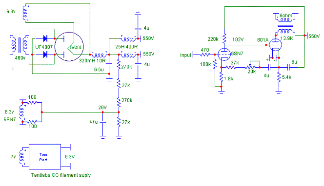

In the prior post, it sounded like you were signing off. If you are still interested, I'll (we'll) explain as best I can to your questions.
This is a deceptively simple circuit in terms of part count. But the design is much more clever that it appears at first glance. Here's my amp(BTW, recognize anything in the power supply? The initial choke maybe? But I didn't take it on faith, I simmed it in PSUD and liked what I saw.):
http://www.diyaudio.com/forums/atta...e-801-amp-801loftin-white-sn7-full-schema.gif
You are not the only one having a hard time wrapping your head around this concept. Bigun hit the key issue, and that's the concept of "ground", which is the normal reference point for each section of an amp - both for DC and AC. Any noise from the power supply is just added to the signal. If you have multiple stages, the noise affects each stage independently and may be in phase or out of phase or shifted in phase relative to other stages. All those noise (or ripple) components are summed and added to the signal. So you have to have very low ripple in stages that pass that noise along.
In this amp, the RC connection between cathodes, combined with the B+ connection of the output cap (AC is returned to B+, instead of "ground") counter balances the effect of PS ripple on the input stage against the ripple effect on the output stage. Since the ripple arrives at the input and output tubes at exactly the same time, you just dial the amount of feedback until the cancellation is total. It's a form of negative feedback - but only for the ripple component. If you continue to dial in more the ripple noise comes back, but opposite in phase to the original. You can see it happen on the scope.

Ha ha,
You commented " Here's my amp (BTW, recognize anything in the power supply? The initial choke maybe? But I didn't take it on faith, I simmed it in PSUD and liked what I saw.): "
Oh yes Sheldon, I noticed that immediately and chuckled for a moment or two.
There is a new player on the block, all of about 12 dollars. Hammond 159ZB. I believe its only 7.8 Ohms DCR !!! Instead of 10 Ohms. Have not measured or heard it, but I bet it will be fine !!! Maybe the ZB suffix stands for Zee Best ??
On a LSES supply, where L1=L2 and C1<C2, two ZBs would do a single Type 45 or 2A3 Finals stage just fine.

Worried about power supply noise? Check out the rudimentary supply on the original - a single diode (not even a rectifier), small PS cap. Ripple anyone? But low noise at the output. It does use a pentode on the input, so that stage is less affected by ripple than a triode, but not much different with the bootstrapped follower.
Now, I wouldn't recommend something this simple for the supply, because the cancellation will be very sensitive to getting exactly at the null. Nevertheless, it demonstrates the effectiveness of the design. One volt ripple will be no problem, but doesn't hurt to be quieter.
Sheldon
http://1.bp.blogspot.com/_oCEpds9Yo.../Loftin_White_Feb_1930_Radionews_Page_704.jpg
Edit: Ripple for the 801 supply is around 0.4V
Sheldon

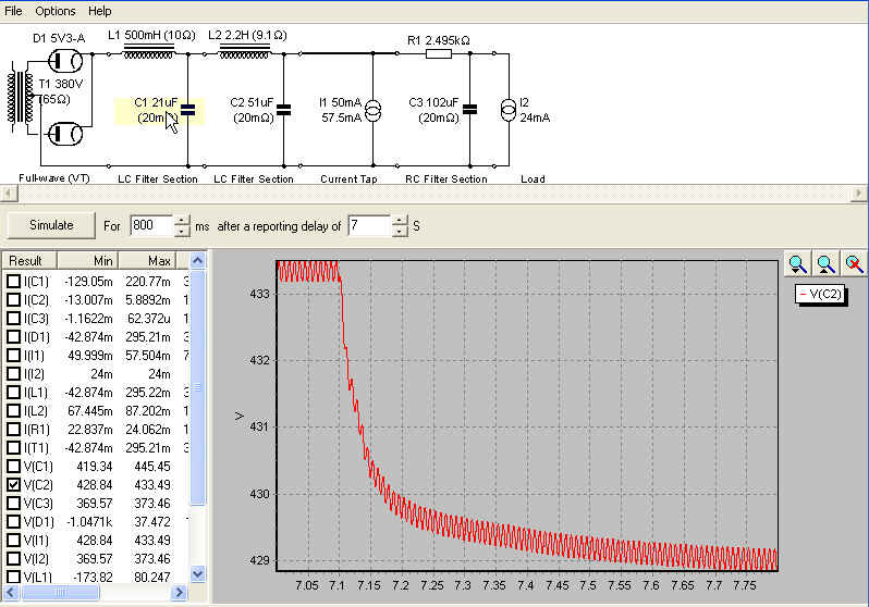

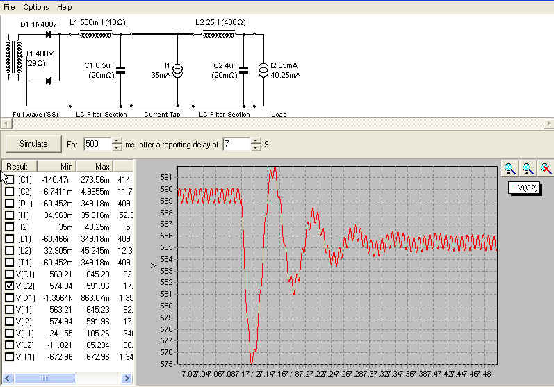

Hello Sheldon,
Perhaps off subject, maybe not ! When I just modeled PSUD2 your supply, guessing at values, I got over 1.2 VAC of simulated ripple, and it rings - a whole lot!!! Ringing is a problem I think. I have no way to sim a solid state and tube rectifier in parallel, but the ringing shows up with either device rectifying, on a 15% current step at 7.1 seconds.
I usually look for a smooth and somewhat quick recovery to a step test simulation.
For example, view the Dyna ST-70 Power Transformered DC 1/2 12AX7 - 6AH4GT amp, with perhaps similar current draw, 74 mA TOTAL for stereo. Your supply has about 410 Ohm of series resistances and my "kluge" has about 20 Ohms of series resistances.
Jeff
