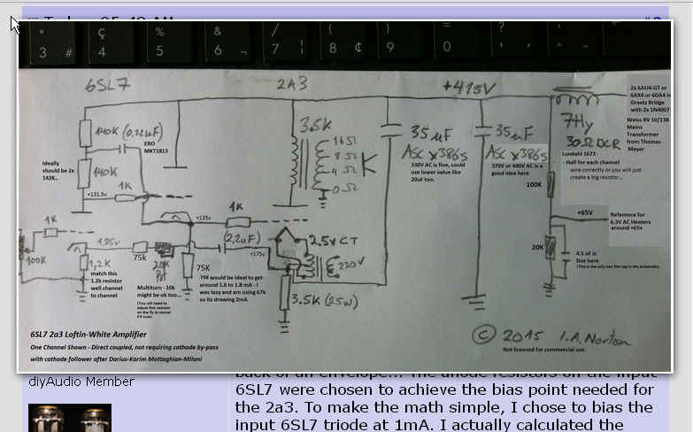

Hi Jeff
The "triode characteristic factor" is significantly better on the bootstrap follower design than in Bigun's original circuit. A quick calculation on his original circuit shows that it would at best have a "triode characteristic factor" of 2.5 - far too low... The "triode characteristic factor" needs to be over 4 if you want to avoid cathode by-pass. This explains to me why he abandoned it later in his thread.
If you want to avoid the bootstap topology of Darius then you probably can't use 12ax7 or 6SL7... If you use a separate power supply for the input and be able to do PSU noise cancellation. It just won't work..
Sorry to break your bubble on these points.
Btw - here is my circuit: my-new-iron-single-ended-2a3
Ian

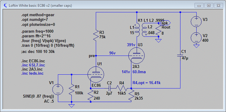

Hi Jeff,
I attached a slightly simplified (no grid stoppers) L-W schematic using only 2 stages. It works in simulation, and probably also should in practice. However, I'm not 100% sure about startup and power down behaviour, so beware. Also, the EC86 is pretty finnicky, i'm not sure about parameter variation or long term stability.
It illustrates nicely how the noise (actually, PSU hum! not component noise!) works, by injecting a 180° out of phase hum from the output cathode to the input stage, just the same fashion as some negative feedback. The result is (almost) zero differential hum across the OPT primary, and hence on the speaker.
It should be clear that any phase shifts between output and input stage act against a perfect cancellation, hence better reduce the number of caps in the audio part of the circuit where possible. (Phase shifts are mainly introduced by caps!) We do require the cap between the cathodes because of voltage differential, and no audio signal passes thru it, so it's probably acceptable, but try and stay away from any further caps.
About your PSU ideas, they become largely irrelevant in the L-W circuit since almost no variable load is put on the PSU. The ultrapath cap forms a closed AC current loop together with the output tube and OPT. Yes, the current draw from the PSU will become nearly constant, the only variation caused by variations in the first stage current draw. Yes, this means that things like PSU sag or impedance will become virtually irrelevant anyways.
I would like to hear from any experiemnents you would carry out on any of your (test) amps in that spirit, since I appreciate your independent spirit and voice in the diy community.
BR
GB

About your PSU ideas, they become largely irrelevant in the L-W circuit since almost no variable load is put on the PSU. The ultrapath cap forms a closed AC current loop together with the output tube and OPT. Yes, the current draw from the PSU will become nearly constant...
I tend to think this is semantics. In a non L-W topology there is still a final capacitor from B+ to ground and from the output tube cathode to ground, forming a loop that connects B+ to the cathode. Ground is just a construct, providing significant current doesn't flow from the ground to some point outside of the amplifier we can remove the ground symbol from the circuit. So whatever care is needed to make a good PSU, it applies in both cases but perhaps with different priorities (although they are not obvious to me right now).
Can you post the .asc file for your simulation (and associated library files) - it looks like a really useful way to see how it all works ? 🙂

Nice design. Plenty of current to drive the output grid. The "triode factor" for the input tube is a little low (about 3.2). If you don't mind a tiny bit of sand, you could reduce the cathode resistor by putting a schottky diode in series with it.
Sheldon
Maybe try running at about 3mA - 100k for R3, and 370 ohms on R2.
A rough calculations using the Philips specs sheet, suggests this will get you a "triode amp characteristic factor" of 6.8 (which of course is nicely over 4).
Ra/(mu*Rk+Ri)
Where Ra=100'000, mu= 15, Rk=370, and Ri=9'000
of course these values from the specs sheet are average, and were measured at with Va= 175V (not 96V).
The only think I don't inherently like is is the operating point of the EC86. Plate resistance and mu is much more stable over 10mA.
