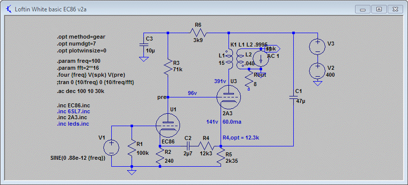

Jeff,
You are missing the entire point to my response, and of the unique design of this amp. You can't "decouple" the input stage from output stage. They are coupled plate to grid. There are only different ways of coupling. You have to think in terms of AC coupling and DC coupling.
Yes, in a typical AC coupled amp, you might want to provide additional filtering of B+ (not decoupling) to the input stage. In fact, you could use a completely separate power supply for the input stage.
In a typical design with the cathode bypassed to common, both the DC and AC (signal and noise) current components circulate in a loop from power supply, through the OPT primary, and back through the power supply via common. So the power supply is directly in the signal path.
In this design. First, the output cathode is returned to B+, not to common. So the signal path does not circulate through the power supply, so the power supply is not influence by the signal (or, it acts more like a constant current source). However, noise from the power supply still creates ripple at the plate of the input and output tubes.
Any ripple through the transformer and output tube has to show up also at the output cathode. So, secondly, an exact fraction of this noise is instantly injected at the (unbiased) input cathode, which exactly cancels this noise at the output.
Another way of saying it, is that for current to change in either tube, the voltage relationship between plate, grid, and cathode must change. It doesn't matter if the supply changes with respect to common, only what happens across the tube. This design keeps those in virtually perfect balance.
But, because it's using opposing changes to counter balance, they must be kept in perfect phase with each other. Any filtering you put between the input tube supply and the output supply will take them out of phase. Therefore you will add extra components and gain nothing. If you doubt that it works, I'm using mine as a headphone amp - essentially zero hum.
The design, as every good design, works as a whole. You can't blindly substitute pieces of something from an entirely different design concept and expect benefit.

Hi Jeff,
look at the attached pic. It illustrates a simple and most straightforward way to decouple the input and output stages, kind of, PSU hum wise.
Note that you need to adjust R4 in the hum cancelling network to achieve optimum performance, since the hum level on the input plate changed.
However, no matter what you do, the best achievable hum cancellation is now 5 times worse (for this schemo, in simu at least), which supports Sheldon's point. It just works better when you keep PSU hum in synch on all stages..
That being said, I'm aware there are other ways to decouple the input stage. One would be a stiff CCS load for the input triode, another one would be to feed only the input triode from a decent HV regulator (can be run from the same PSU). Both would effectively kill all ripple at the input triodes plate, rendering the ripple phase matter a moot point.
Both would however be more complex, and require the use of SS parts (in the audio path😉) for effective designs.

Hi Jeff,
Both would however be more complex, and require the use of SS parts (in the audio path😉) for effective designs. Think that out some !!
GB
