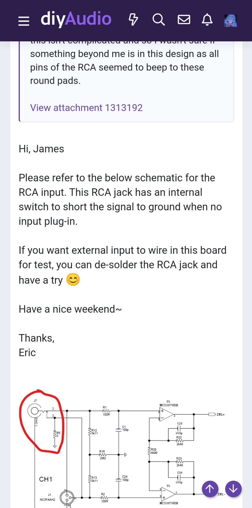

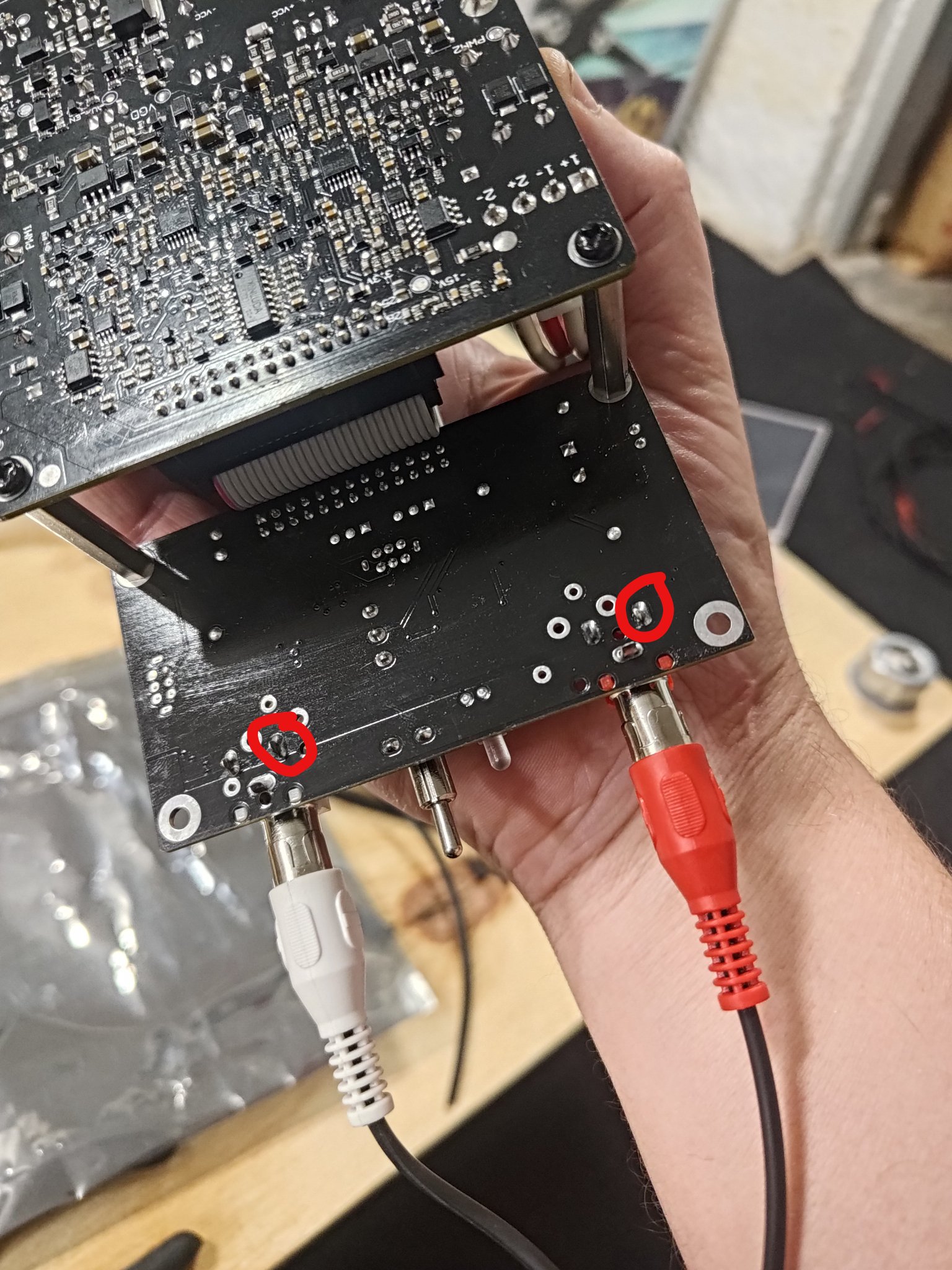

Hi, does this amp contain some kind of protection circuit against starting without source connected?
I used a phone and a 3.5mm to phono cable for testing the amp and everything went well.
But since I made the chassi for using chassi mounted phono sockets I soldered a wire between the phono sockets signal input and the left solder tag of the PCB mounted phono socket (see attached photo). Then another one between the chassi mounted ground tag and one of the other two solder tags on the PCB.
Lo and behold, the amp didn't make a sound!
I have spent an hour measuring and trying to move wires to no avail.
I am feeling quite stupid and can't figure out what is wrong.
So can anyone explain so I can be social and happy with my kids instead of thinking of wires the entire evening....
Yes, we use the internal short-SW RCA jack in the mono input for better noise immunity.
If you'd like to use the chassis-mounted RCA jack, I would suggest to de-solder the original one in the buffer board.
Thanks,
Eric

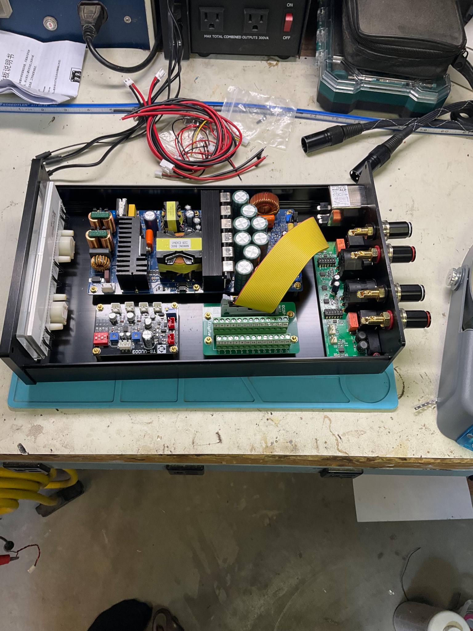

I am skipping the IO-board entirely. Not because of any fault or otherwise, just to save space and since I won't be running it bridged or using the standby switch I might as well skip it and save it in pristine condition for later.
I just ordered a new 26-pin flex cable that I will cut and use to connect signal input and fan.
kmj.
Keep in mind that the IO board is also providing some gain.
Correction. It seems the gain was removed on newer models. So it should be unity gain now.
I used XRK’s BTSB input board so I have rca as well as balanced inputs, it also lets you set the gain you want. The little adapter board makes a nice reliable connection to the amp board but takes some space, but the complete amp still ended up fairly compact. By the way the capacitors next to the larger heatsink run surprisingly hot.
They do, I think this amp is designed to have a fan for thermal management.By the way the capacitors next to the larger heatsink run surprisingly hot.
There is a socket for a 24V fan on the IO-Board.They do, I think this amp is designed to have a fan for thermal management.
I don't use the IO-board so I connected a 24V 4010 fan to the +12V supply.
Since it run at half the voltage it is more or less soundless.
I'm going passive cooling, outboarding TO-247 mosfets on one and the other I'll will make a negative pressure setup (like a PC) 12V 60mm fans running at 6V... testing is very positive, but I still have to fabricate the enclosures. It went from 70C at heatsinks to ~30C on a 20C environment.There is a socket for a 24V fan on the IO-Board.
This amps sound fantastic so for me it makes sense to have temps as low as possible (plus is fun)
I did put holes in the bottom and top of the case, I let it run all night. My flir meter showed it at 59 degrees. The opamp used on the input board is a OPA1646 and OPA1637 and they are brighter sounding than what the ones used on the original boards. I have not listened to it on decent speakers if it is a little bright I can dial it back with Ron’s eq function.
