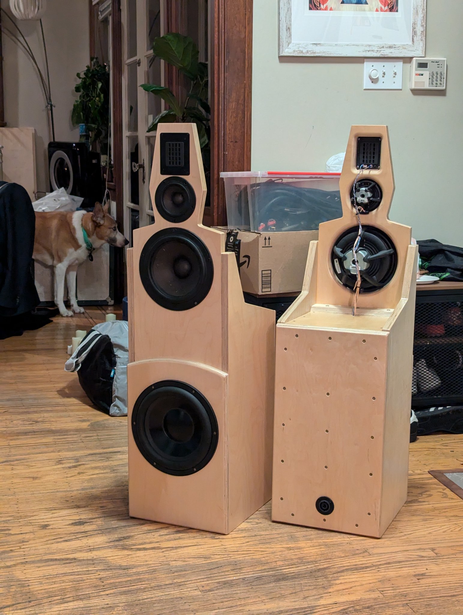

FWIW, I modified my 8-ch amp by replacing one of the 2x150W modules with a 2x300W. It was a tight fit. This was to increase the power for the woofers of the LX521-ish speaker I built for my son. That system had two Peerless SLS10" in "W" OB config, which proved not punchy enough for him. I ended up modifying it by pulling the SLS woofers, turning the W frame into a closed box & installing a Dayton RS265HF subwoofer driver w/200Hz LR4 crossover & DSP PEQ below 50Hz. The revised speakers totally kick ***. With heavy bass tracks, the whole 14x22x9' room shakes. My son & his friends can't believe the sheer power, especially in the bass, that these 1.3 cf boxes & the modest looking amp is putting out.

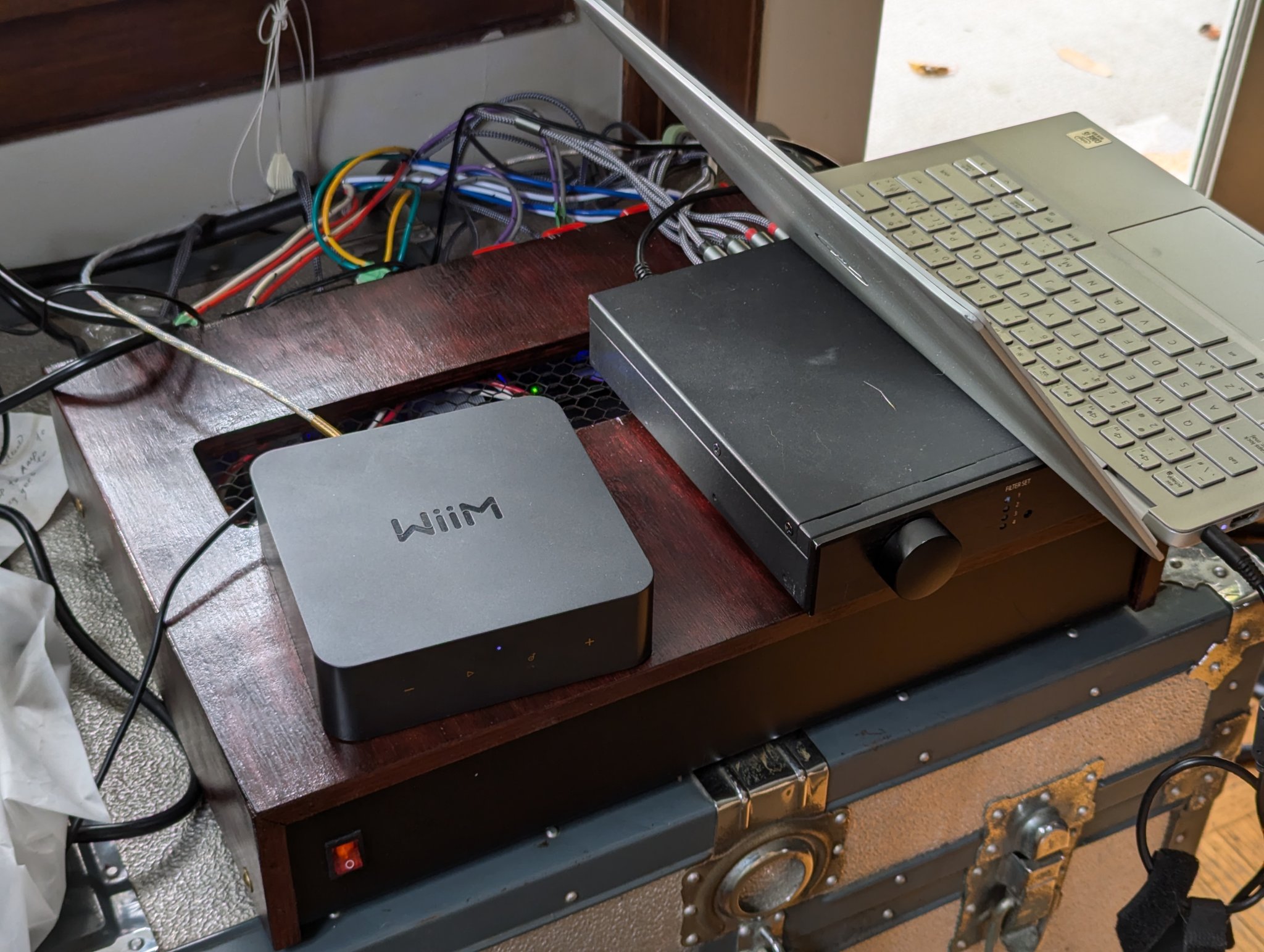

The amp is under the Wiim & miniDSP.

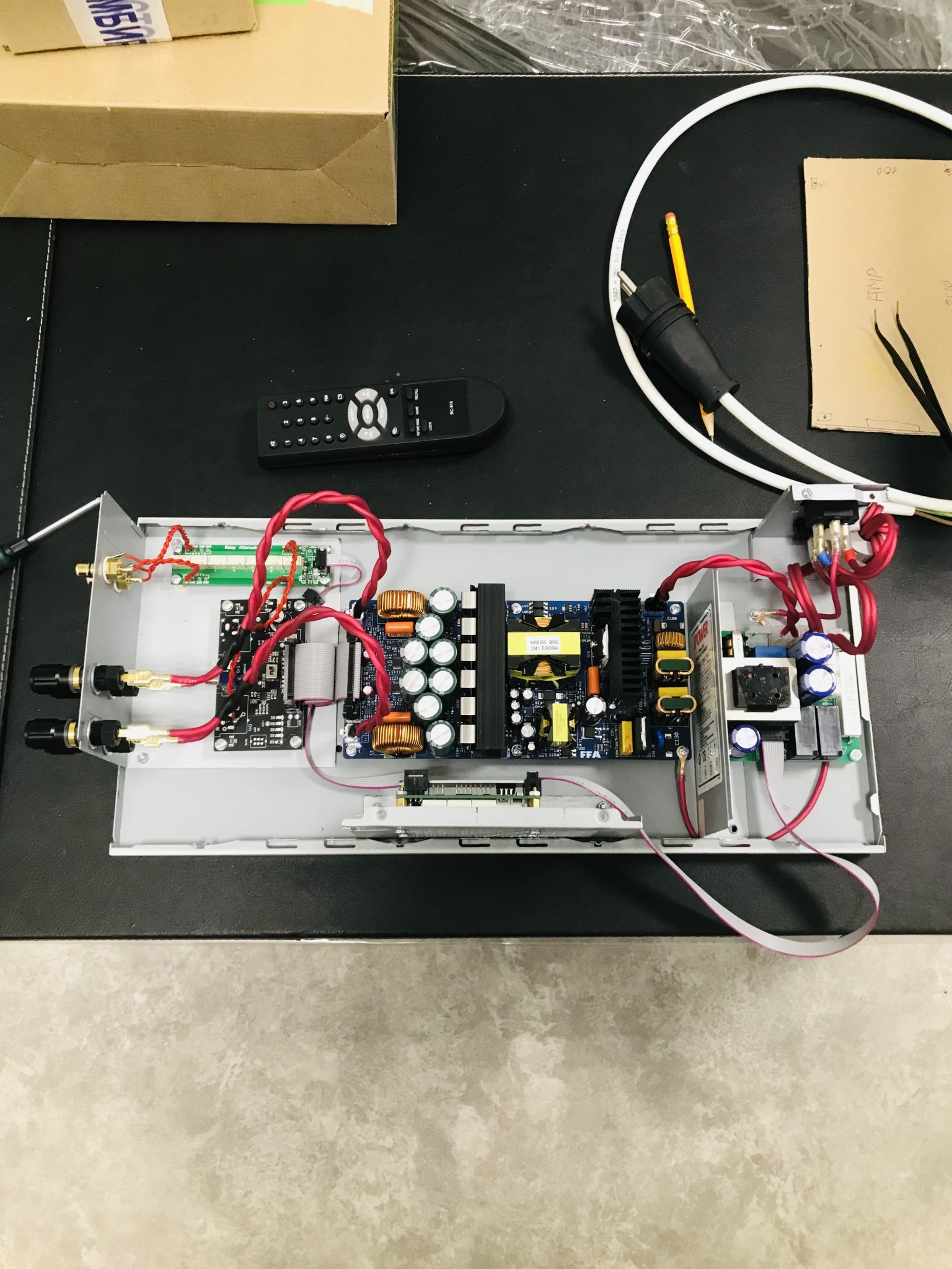

Hello everybody! My first project!
So far, without a chassis, another buffer board and without an input and output selector. I can't decide how many encoder knobs there should be and whether to make a preamp output. And do you even need knobs if there is a remote control.

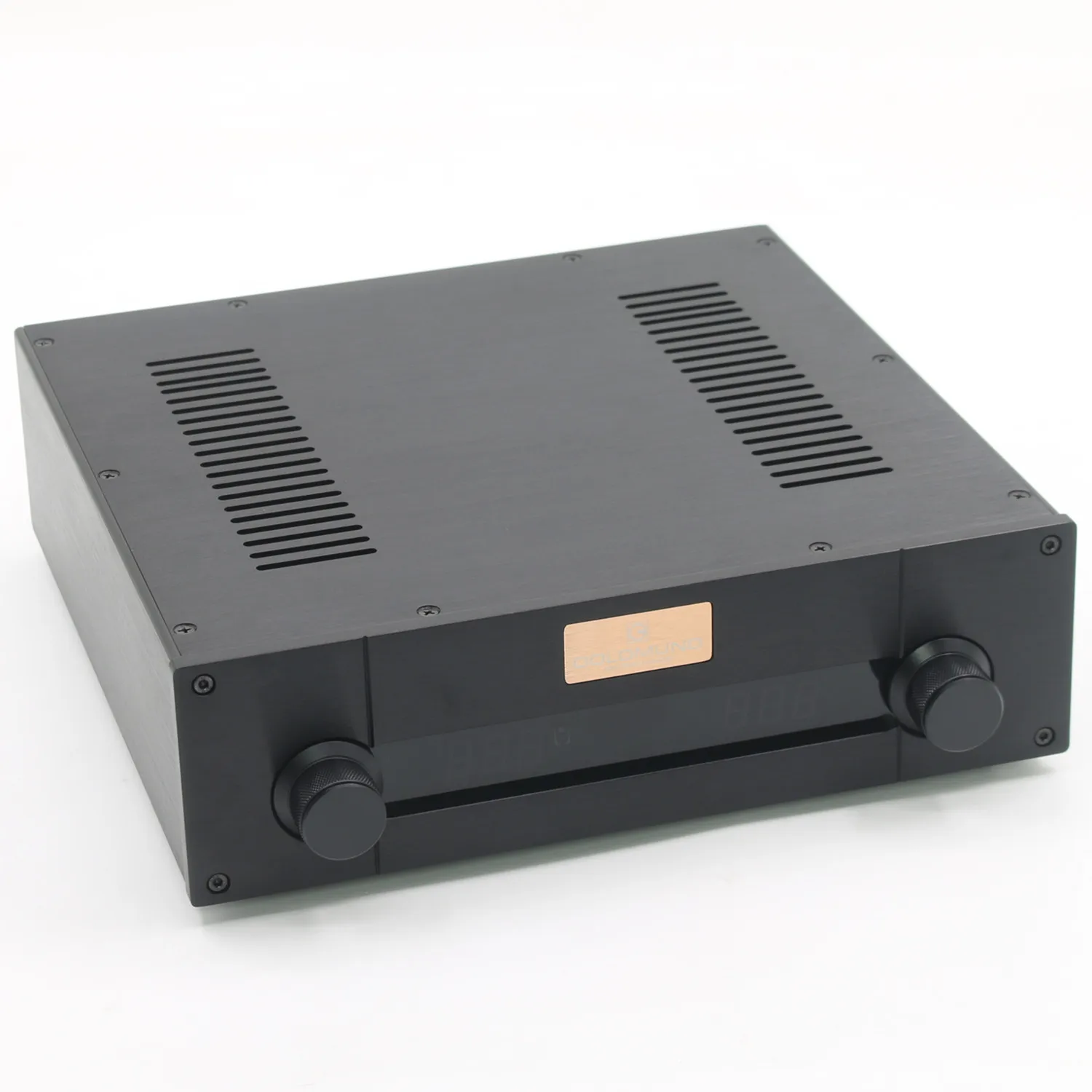

I really like this chassis:
