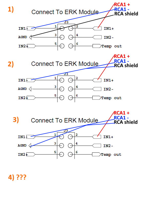

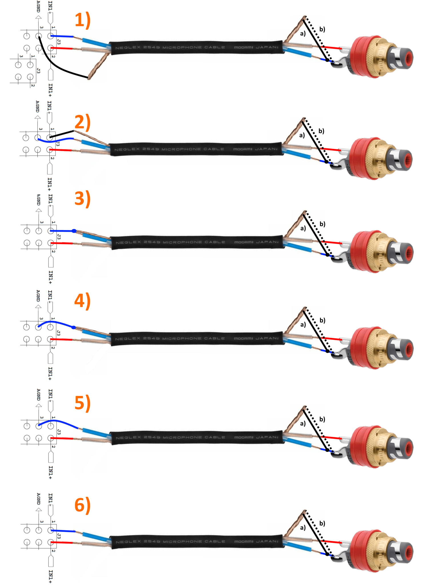

Thanks for the quick response, Eric! I would really appreciate it if you could explain how best to connect to FFA002. Everything is clear with the signal lines - IN1+ and IN2+ directly to the "center of the terminal", whatever it is... And with the "-" and the screen, the questions are - which side should I attach the screen from?
1) to J1
2) to the RCA terminal
1) to J1
Perhaps I was too hasty with the question, nevertheless it is still relevant and I will ask it in a different way. Please vote for one of the options, for example 1)a or 5)b. Or offer your own. Intuition tells me that with all the variety of options, there is no "right" in this picture))). Thank you in advance. And sorry for the noob question.
Hi, Mike
Previously, the I/O buffer was 6dB for balanced & SE, I think we changed to unity gain from last year, I also added the guide on how to change the 6dB to unity gain in a previous thread.
Thanks,
Eric
