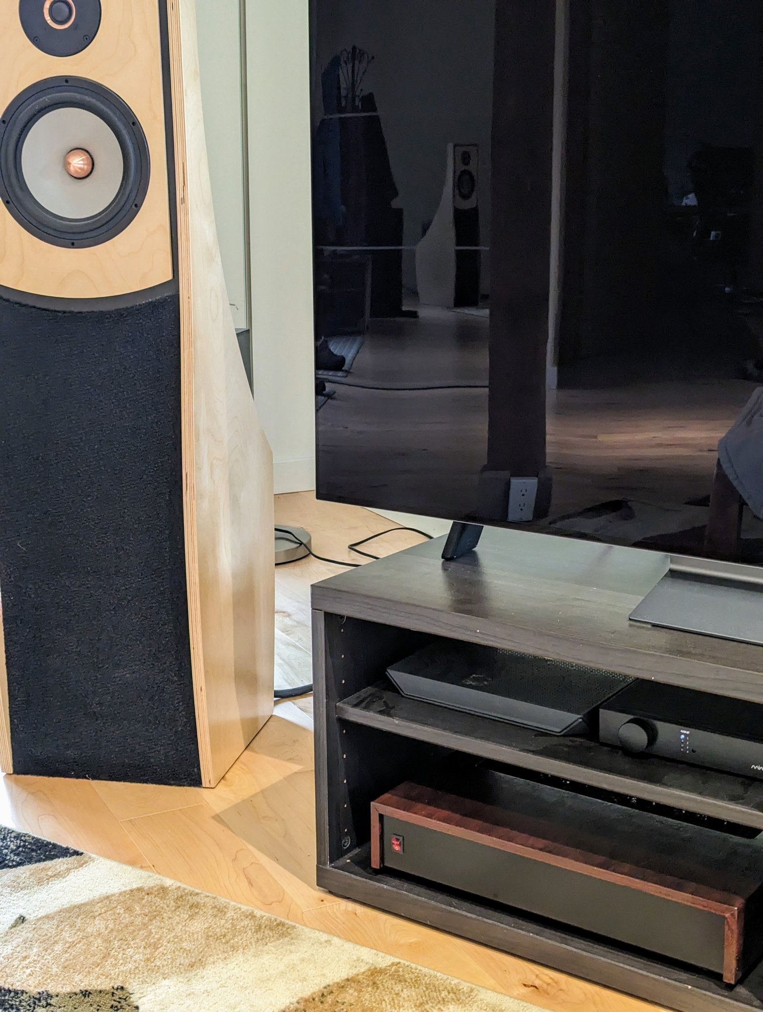

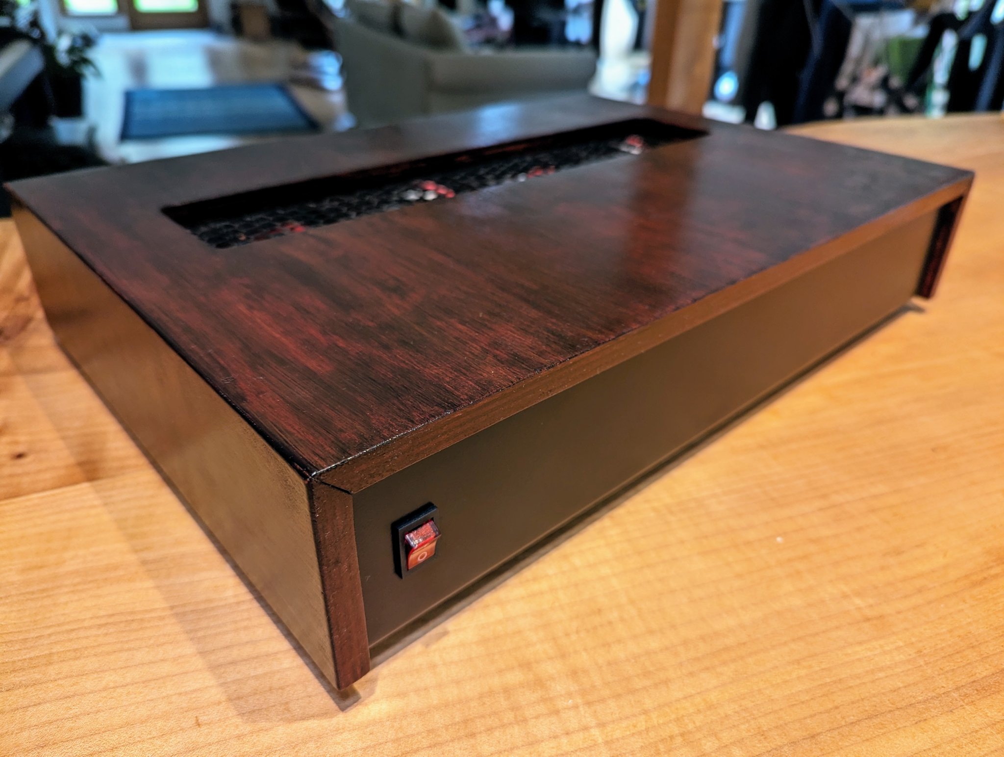

To complete the images of my 8-ch amp project in the previous post...
Here are pics of the amp in its multiple-layer stain & clearcoat finished wood case -- and in its final place in the audio/tv stand.

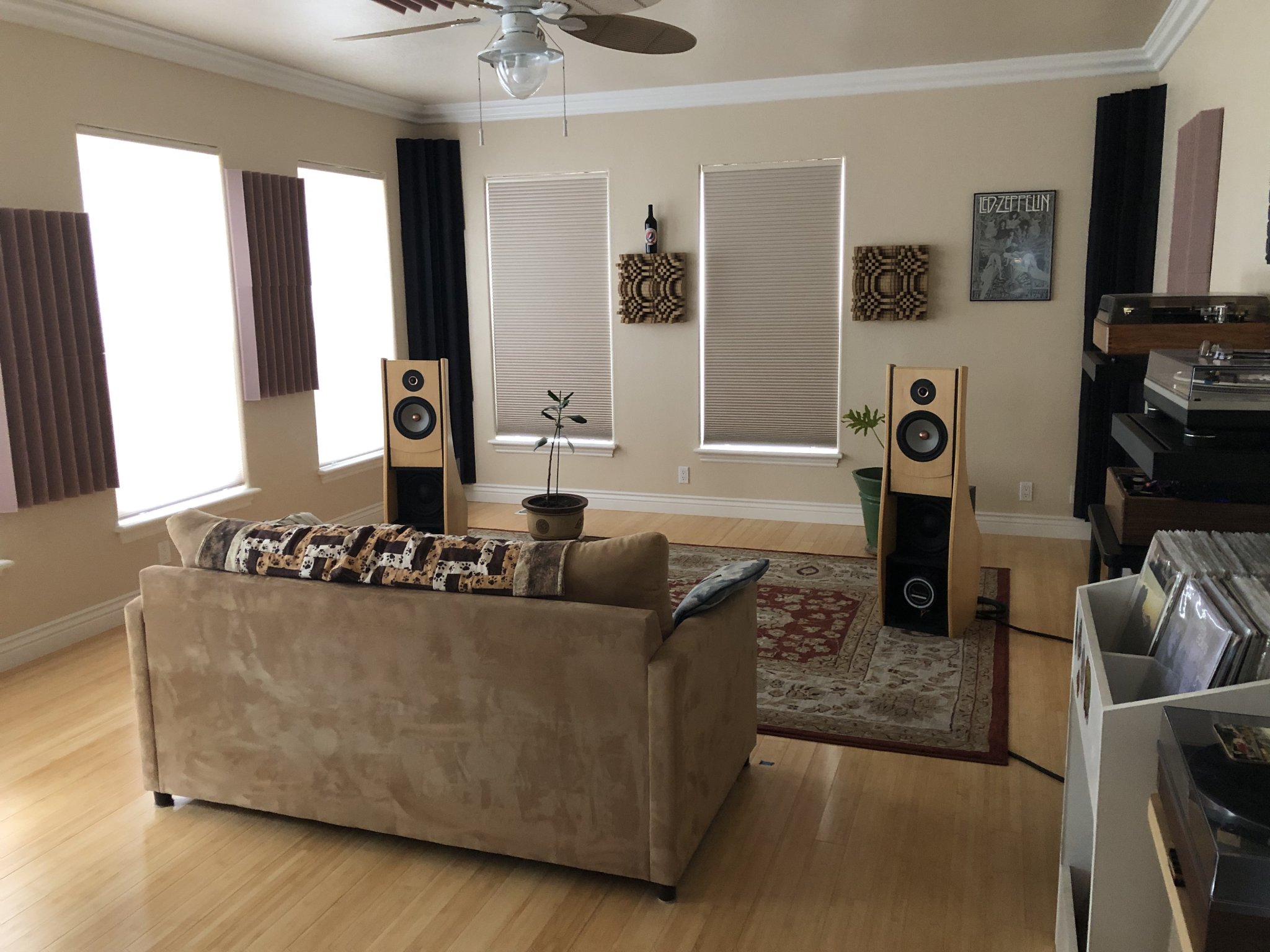

Thanks Bill. The Orions (3.3) were amazing in our Vancouver house -- great acoustics for those speakers. Not as good here in a "great room" of >1000 sq ft; way too much floor/ceiling reflection, difficult to place the speakers well without letting them dominate the space. Overall sound is very good 10~12 feet in front of the speakers/TV but bass thins and sound gets too diffuse quickly much farther.That is a sweet setup with those speakers, I looked at building a set but the investment was a little steep without hearing them. In the end I went with XRK

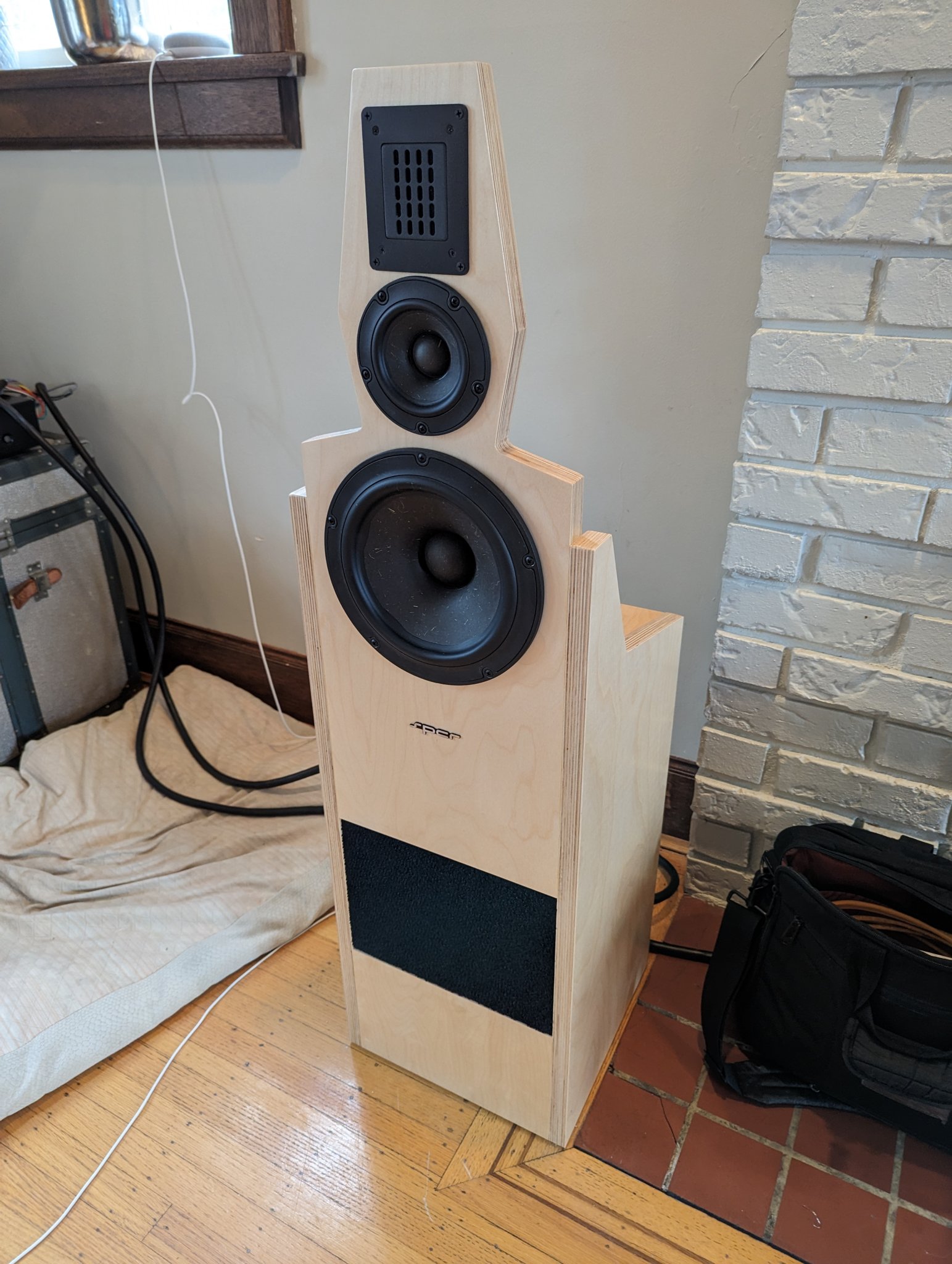

You know, I've pondered modding the Orions to a 4-way. An LX521-ish build I did 6 mos ago made me realize the side panels and part of original "box" could be reused.Coincidence

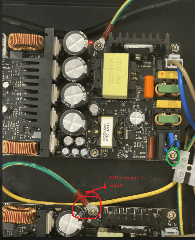

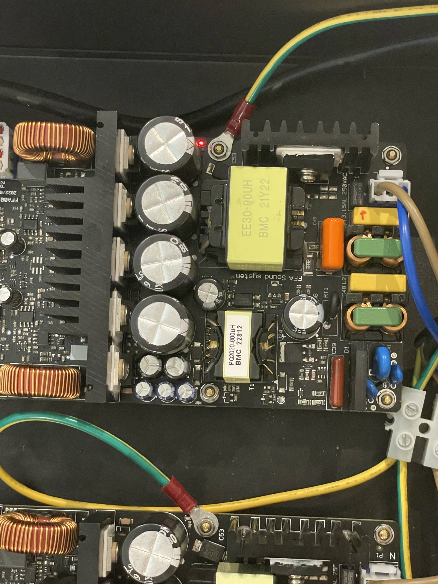

I’m building a 3-channel amp using Eric’s boards. On one of my boards I have a red LED lit up. It’s not lit on the other two boards. Does anyone know what this LED means please? Being red, I’m assuming it’s not good?
I’m using a different input buffer board (the eBay board mentioned earlier in this thread), but that’s the same for all three amp boards in this enclosure.
EDIT: I see the red light on other user's boards so more likely an issue with my power distribution to the other two boards...will report back.
The red LED lit means the board was pluged into the AC supply. It's the normal scenario.
While I'm curious about the other two boards, it should light the LED too; while I do see some issues on your wire diagram. Does the LED damaged by the ground plug? And suggest to use the circled "Green " point as the protective ground connection.
Thanks,
Eric
This is just the indicator. I mean, if it's not good to replace the LED by yourself, then you can leave it as open 🙂
The module can work fine without this LED.
