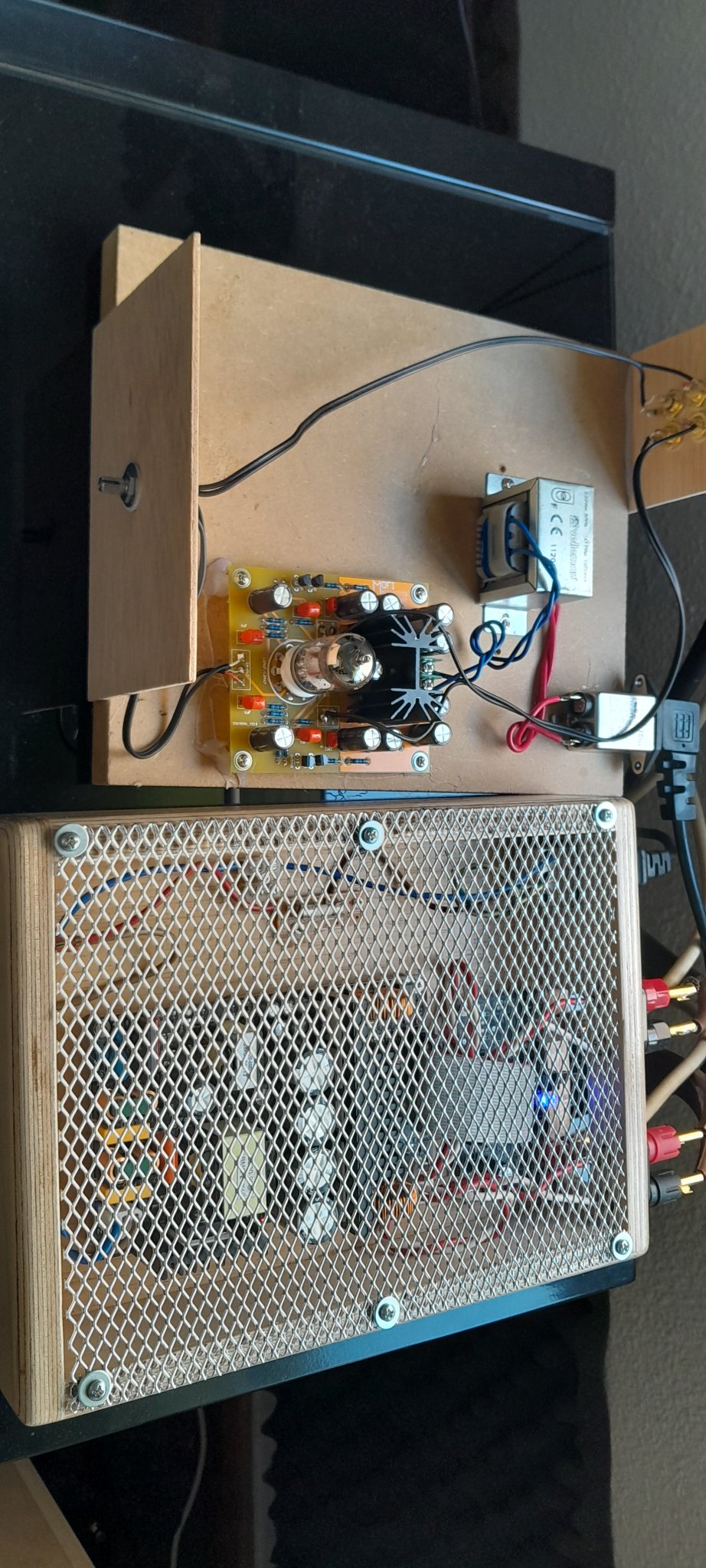

I'm listening your 150w amplifier of my friend Víctor, and I'm in love. I use a tube buffer for find more sweet sound, and it's really good.

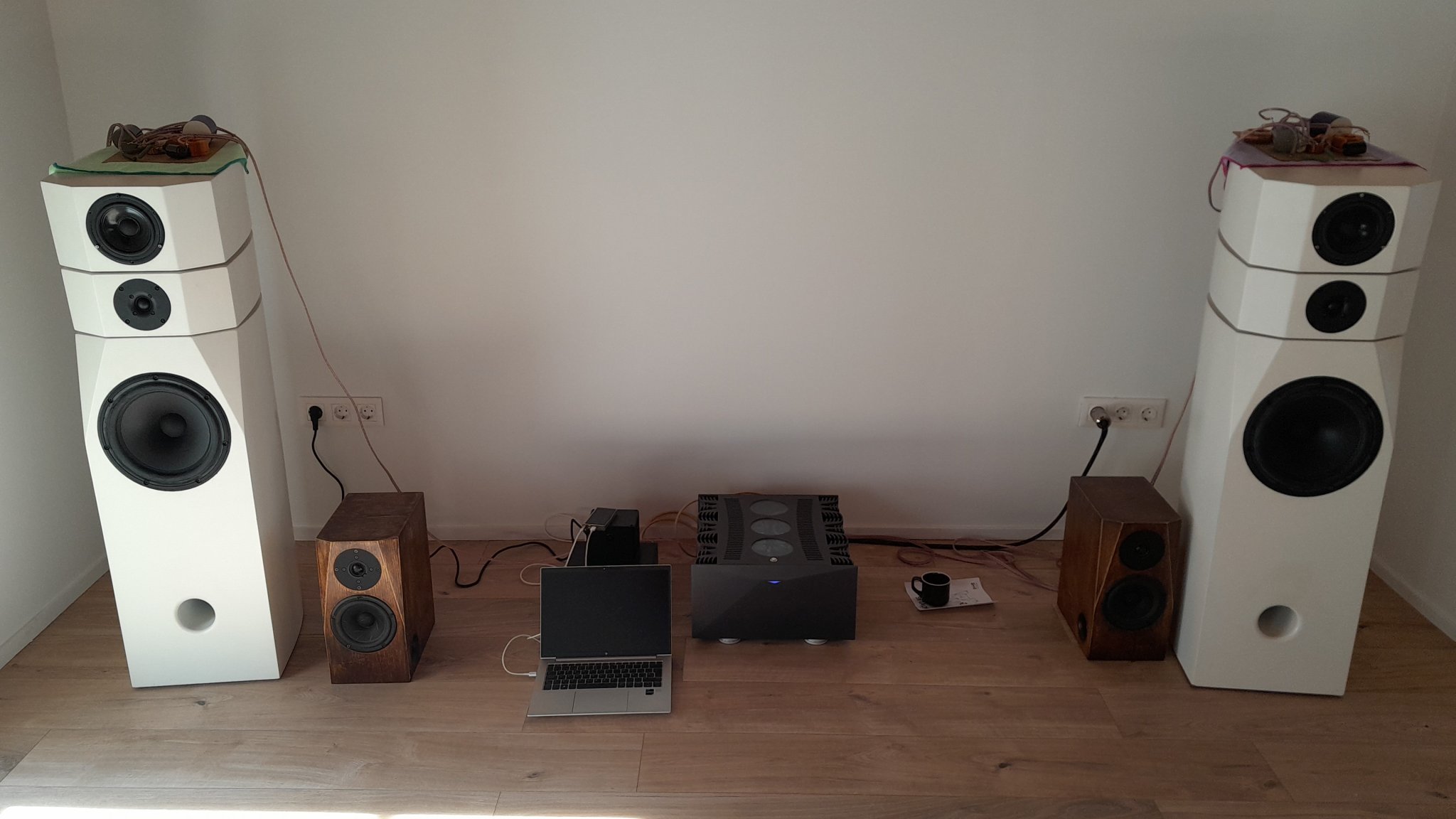

Nice looking speakers, btw! Passive, I presume? You could probably get an audible improvement going active either 2 (between bass & mid) or 3 way with a minidsp Flex.

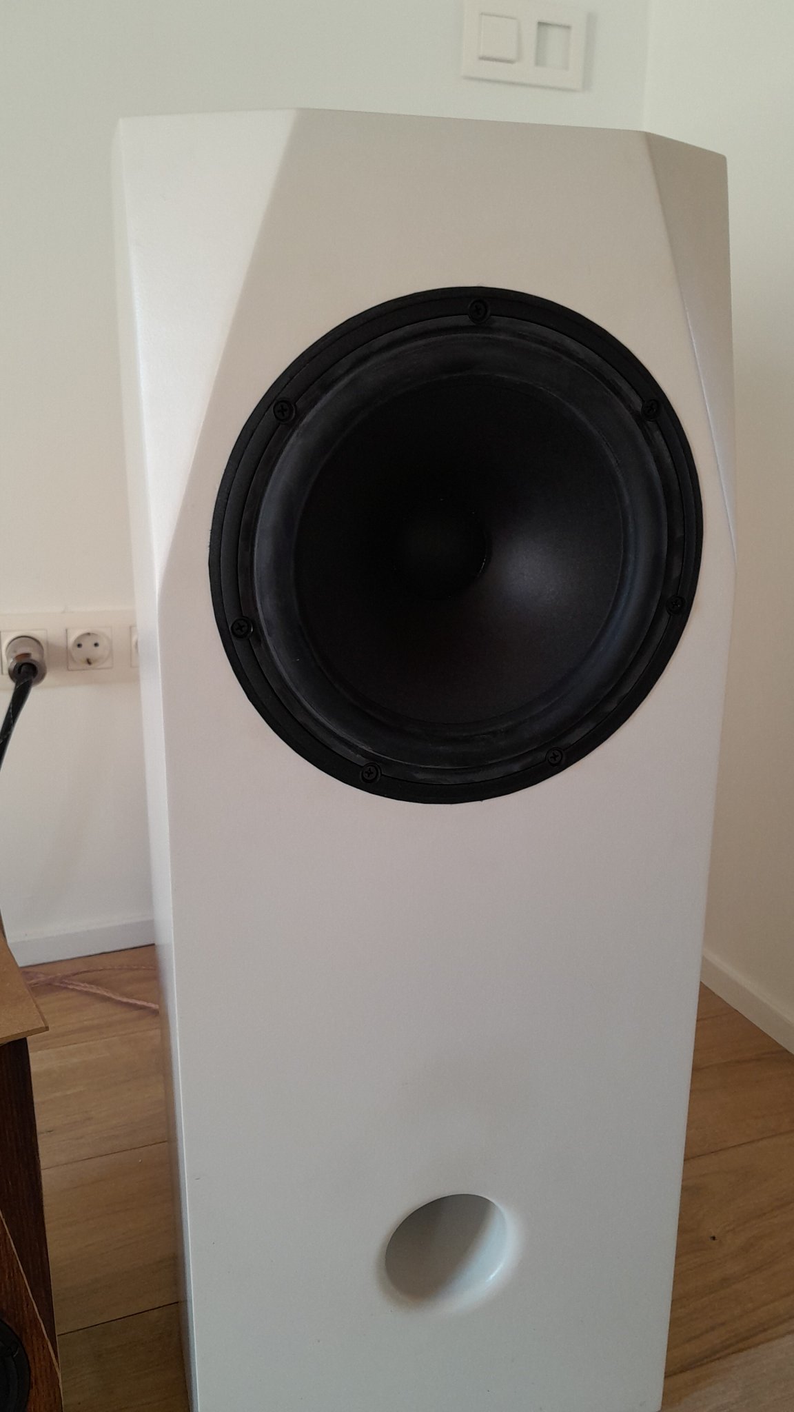

Hello mikessi, thanks for your opinion it's appreciated. I'm ready to get the 300w model, of it's more silent for me is ok. With this power I think is all I need. With a tube preamp or buffer sounds really good to my taste.
And yes, passive speakers a mix between seas and scan speak. The minidsp is the best option I know, but the budget for the moment is limited. Thanks too for the idea,this will be the next step, and maybe combine my pass a3 in tweeter and mids and this class d in the 10".

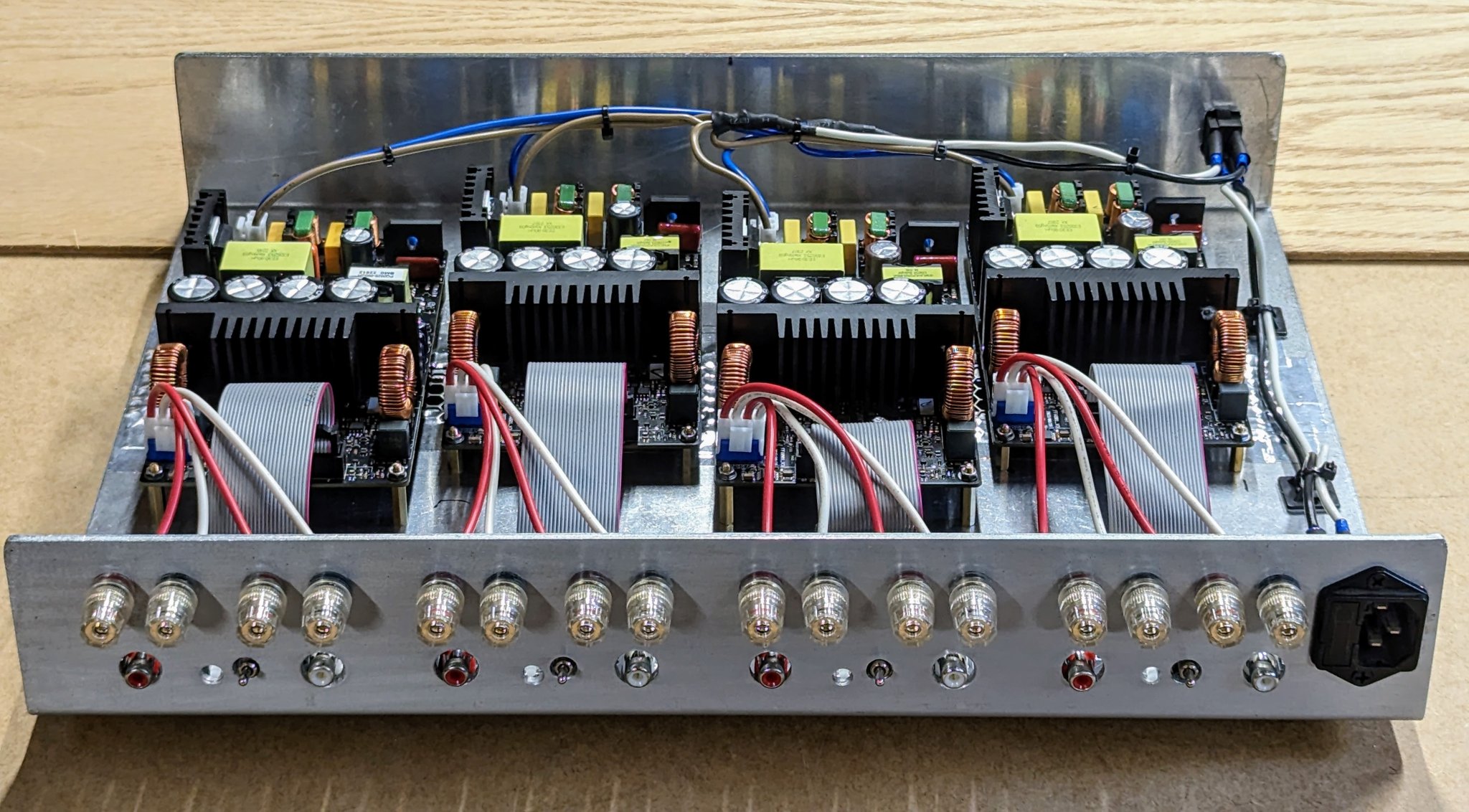

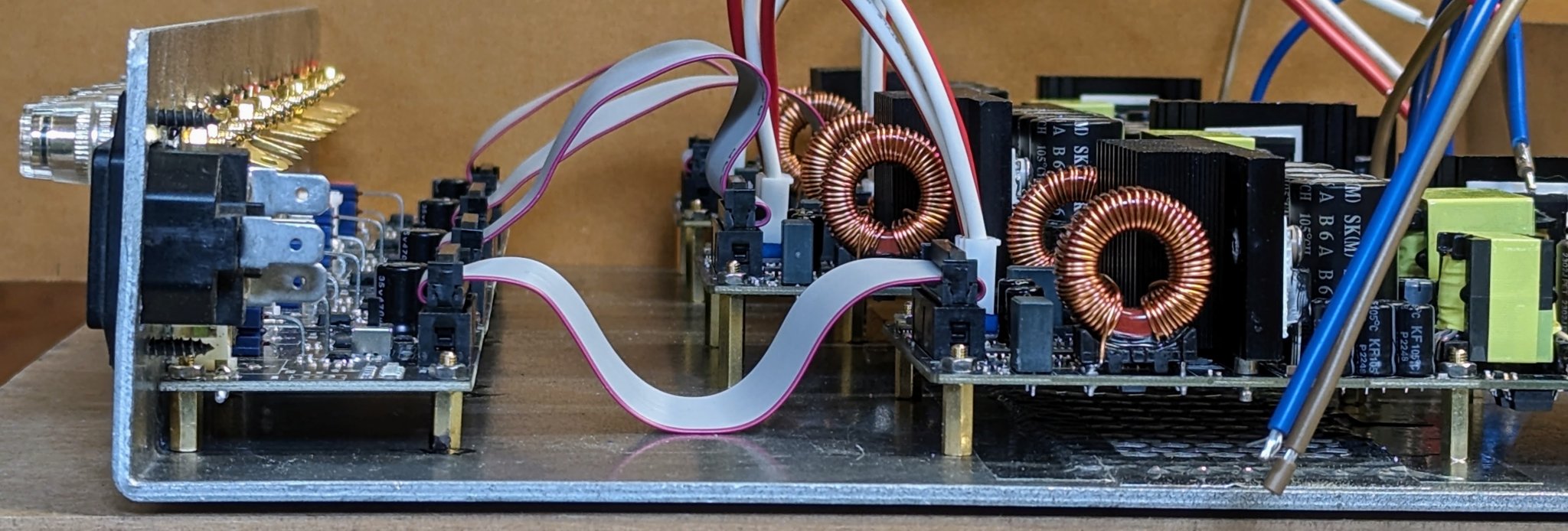

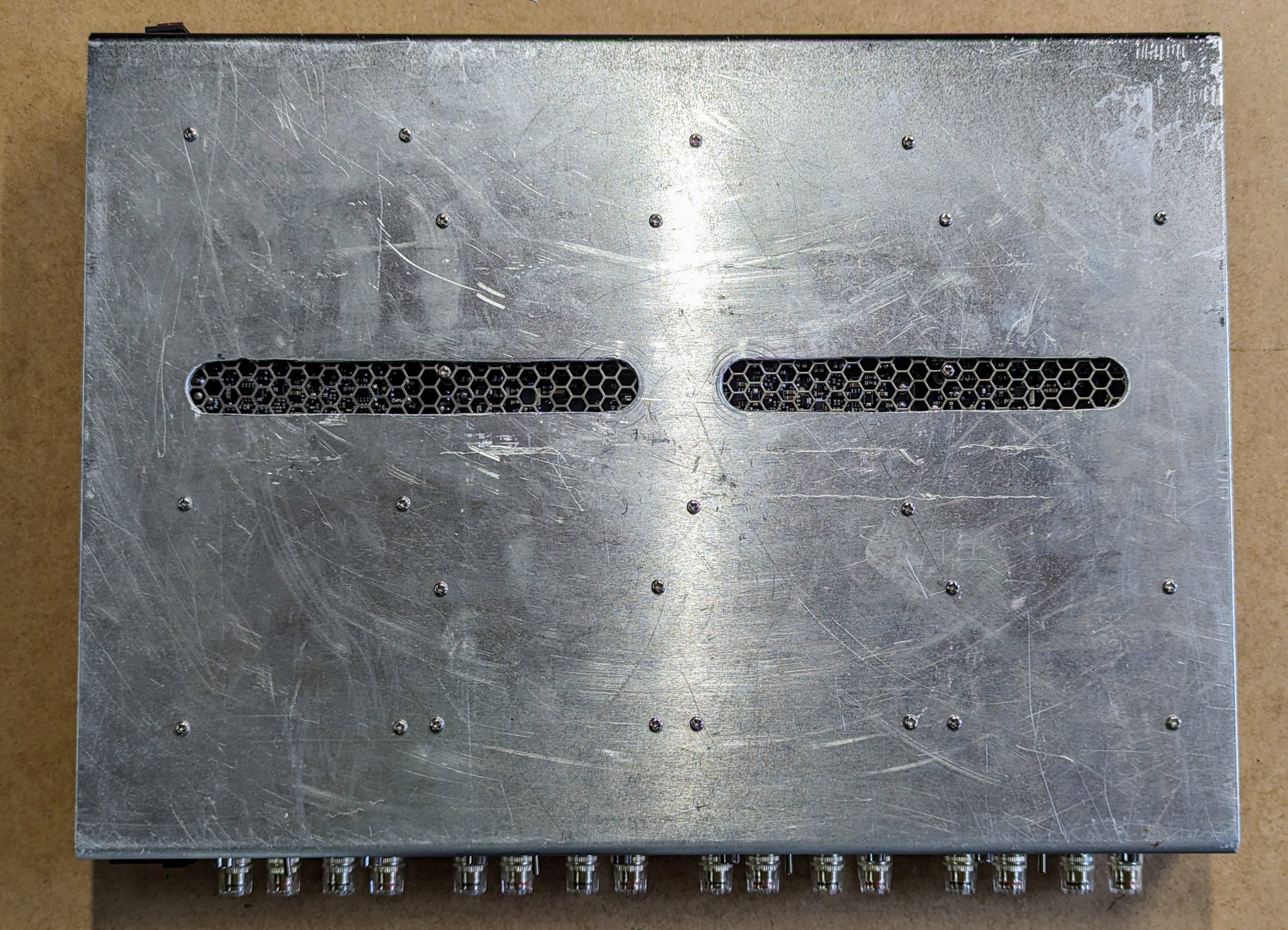

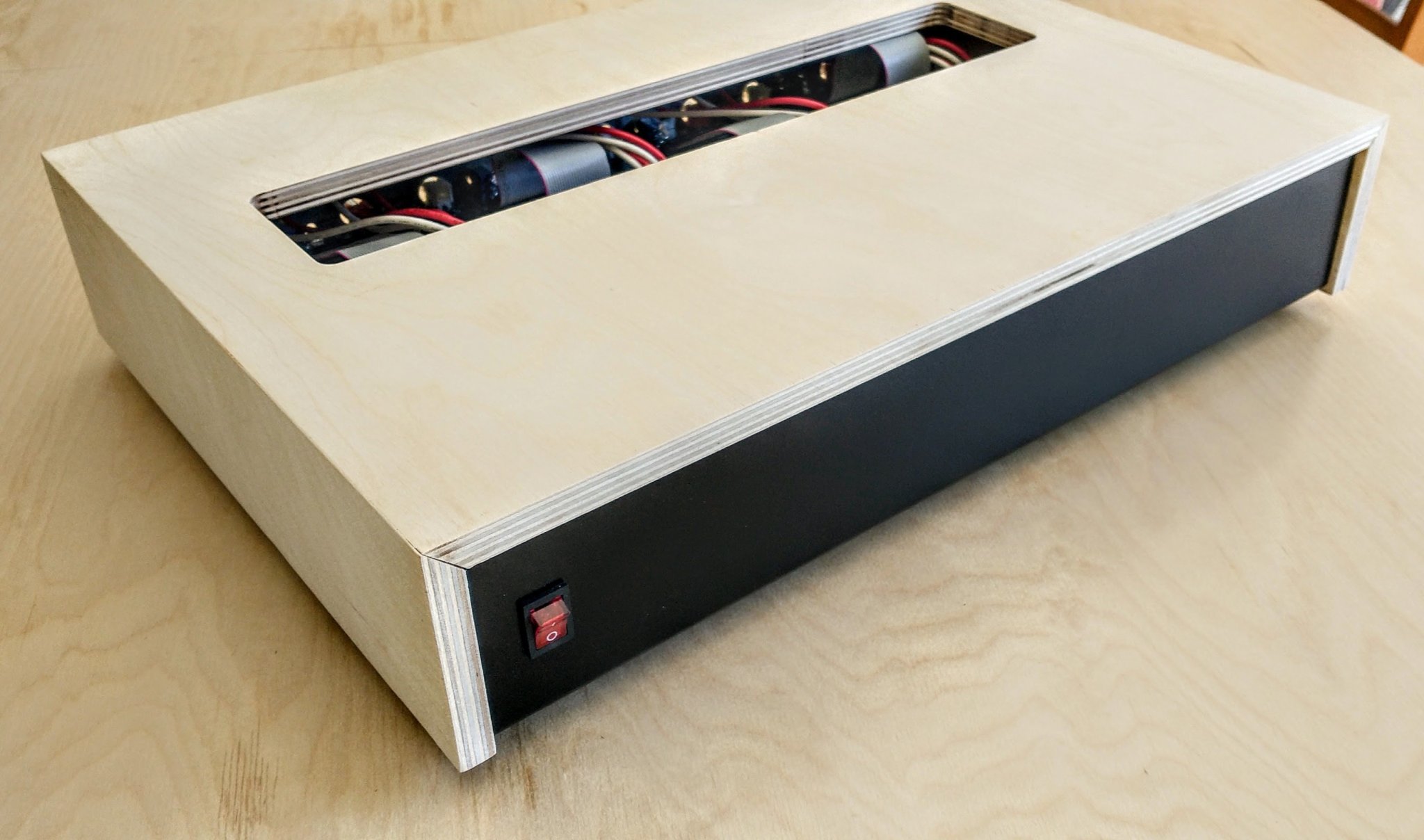

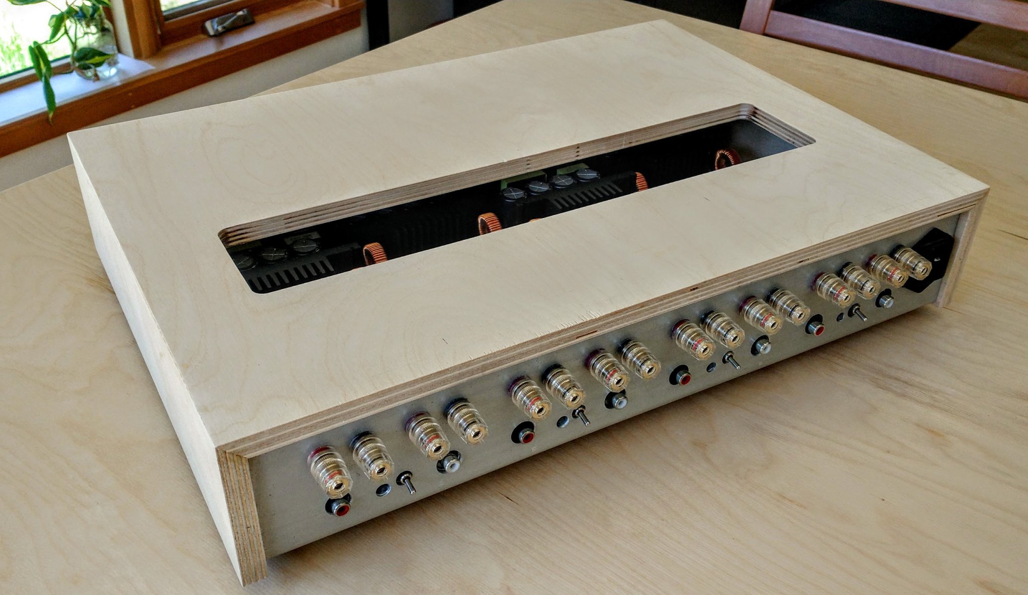

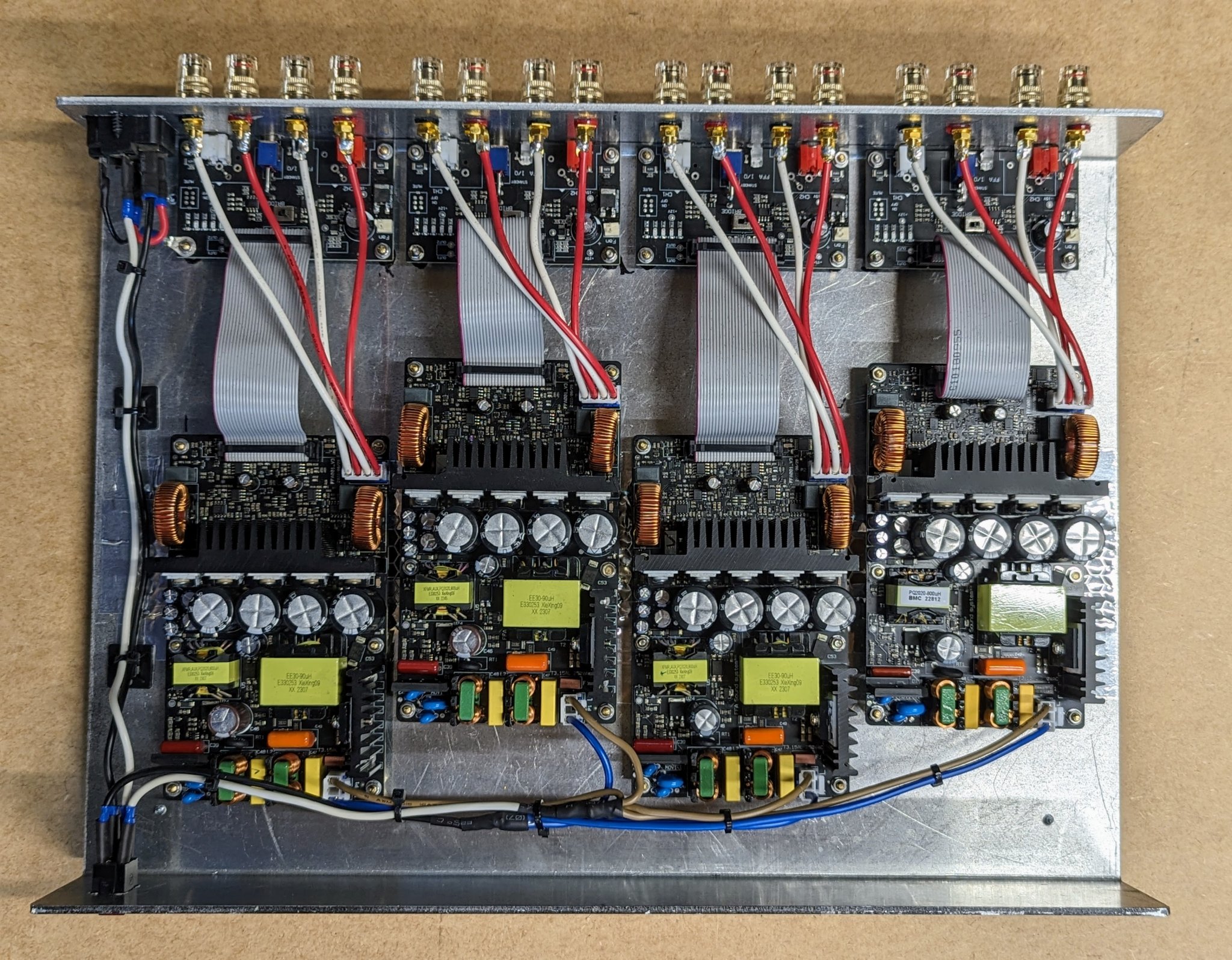

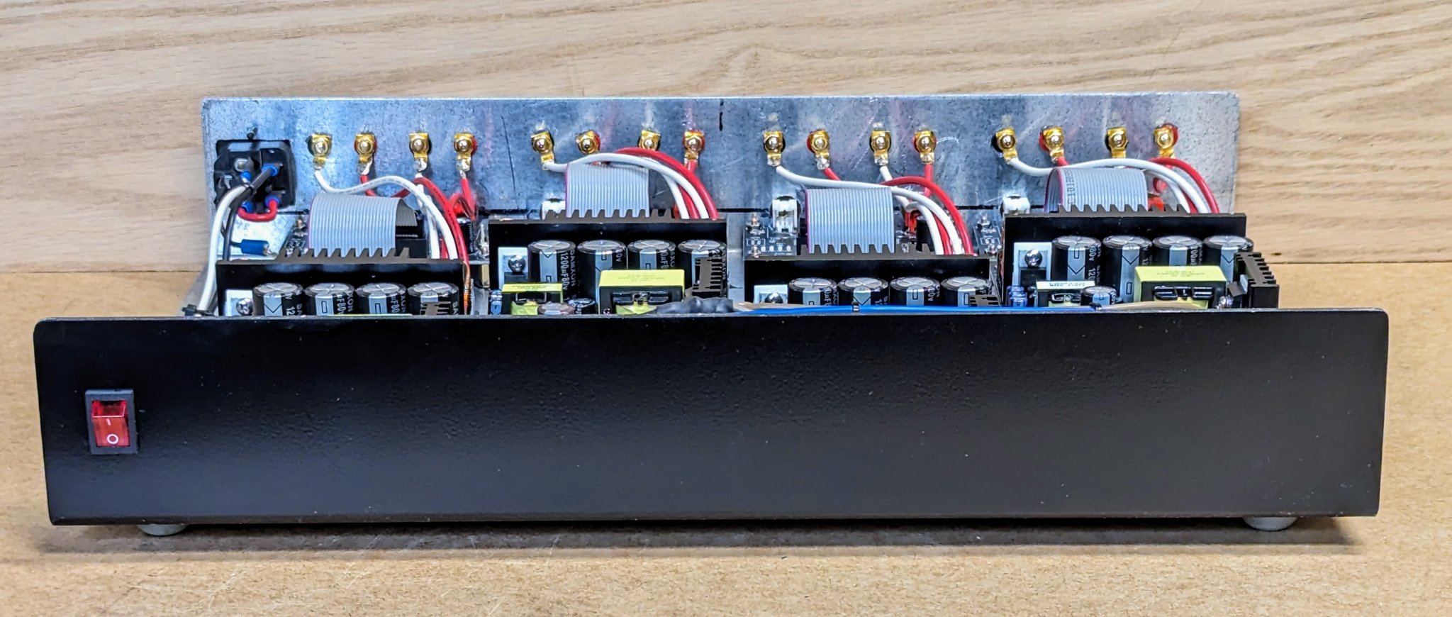

Finally finished assembly of my FFA001V3 4-module 8-ch amp for active multi-way speakers. Used an old DIY U-shaped 3mm aluminum chassis meant to house another project from >20 yrs ago -- a NAIM 250 clone: The case has very similar dimensions. This took way too long. The aluminum is a PITA to cut with typical wood working tools. It seems to melt under heat then binds the blade of the power tool, especially any kind of saw. 😕 Still, it got done. The wood sleeve was meant to recall classic hi-fi cases from the 60s & 70s. A slot on the bottom helps create convection for cooling, and the amplifier are staggered in 2 planes (with different height standoffs) for the same purpose. Actually it's not completely finished: Still need to install a grill for the top vent, stain & clear-coat, fill in visible seams.

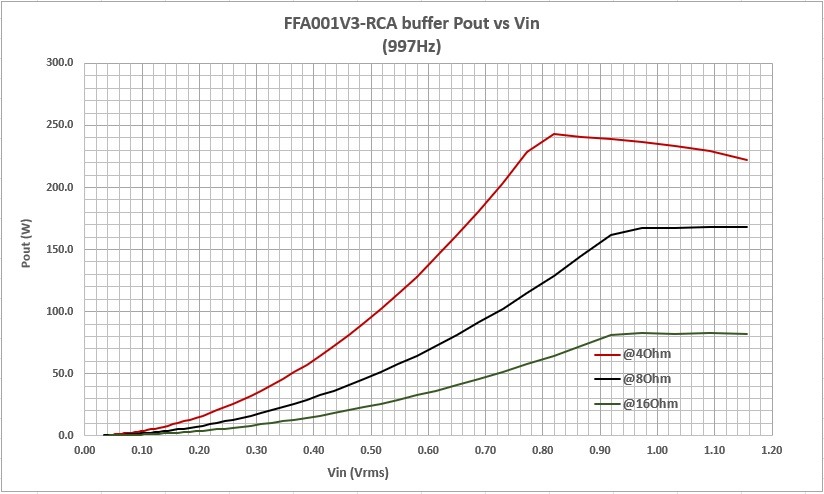

Requesting a smaller and less powerful module in the "style" of the FFA001 does not mean in the 'size" of the FFA001. Need something for the highs for usual dome stype tweeters. The FFA001 for lows and a smaller board for highs would be perfect for a 4 channel amp meant for 2-way activesIf the size of the FFA001 is OK, why would someone would need another module with less power? The price won't come down.
Using the FFA001 and reducing or limiting the max input signal voltage to 0.56Vrms would limit the max Pout to 60Wavg (on 8 Ohm load)

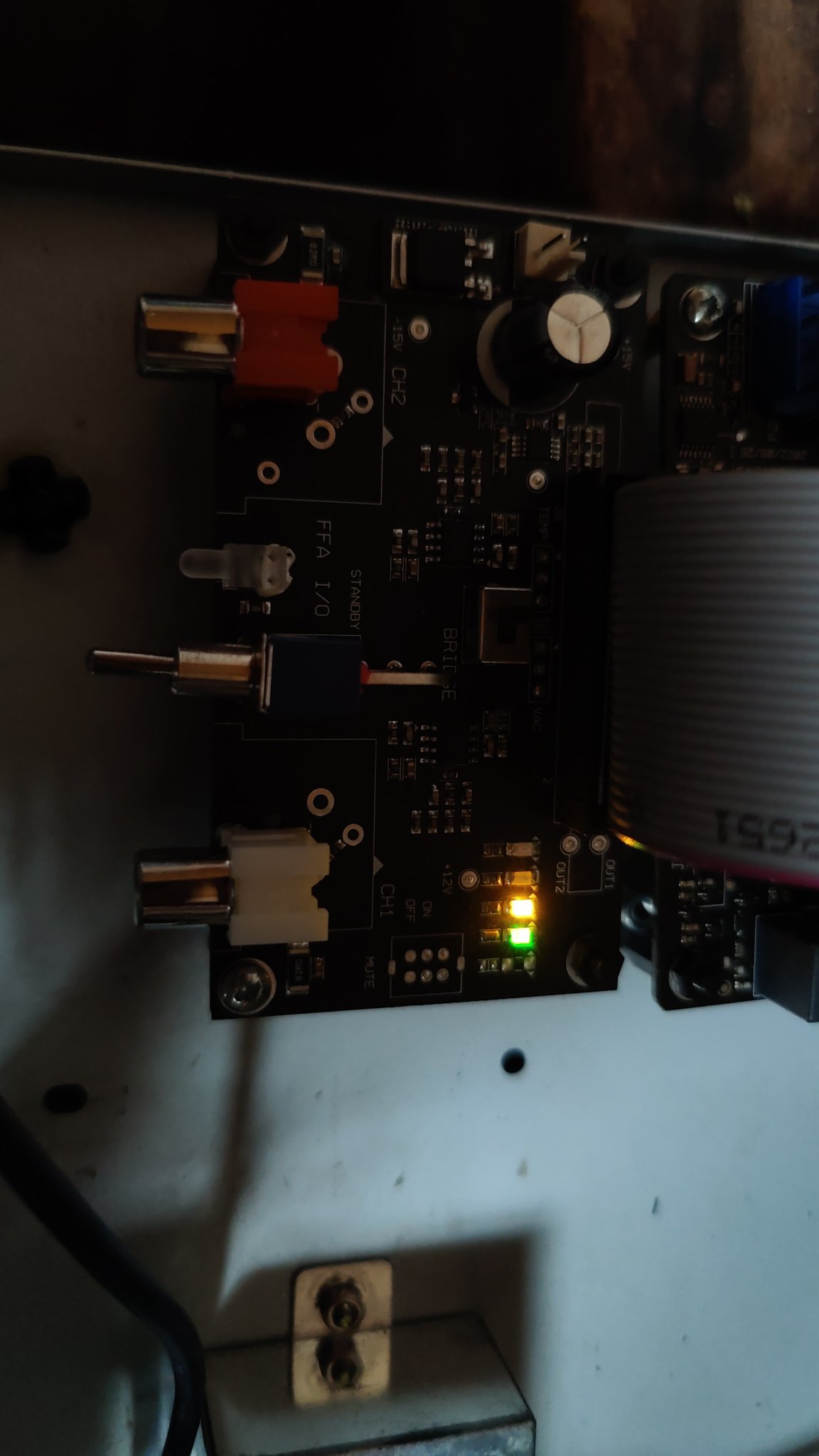

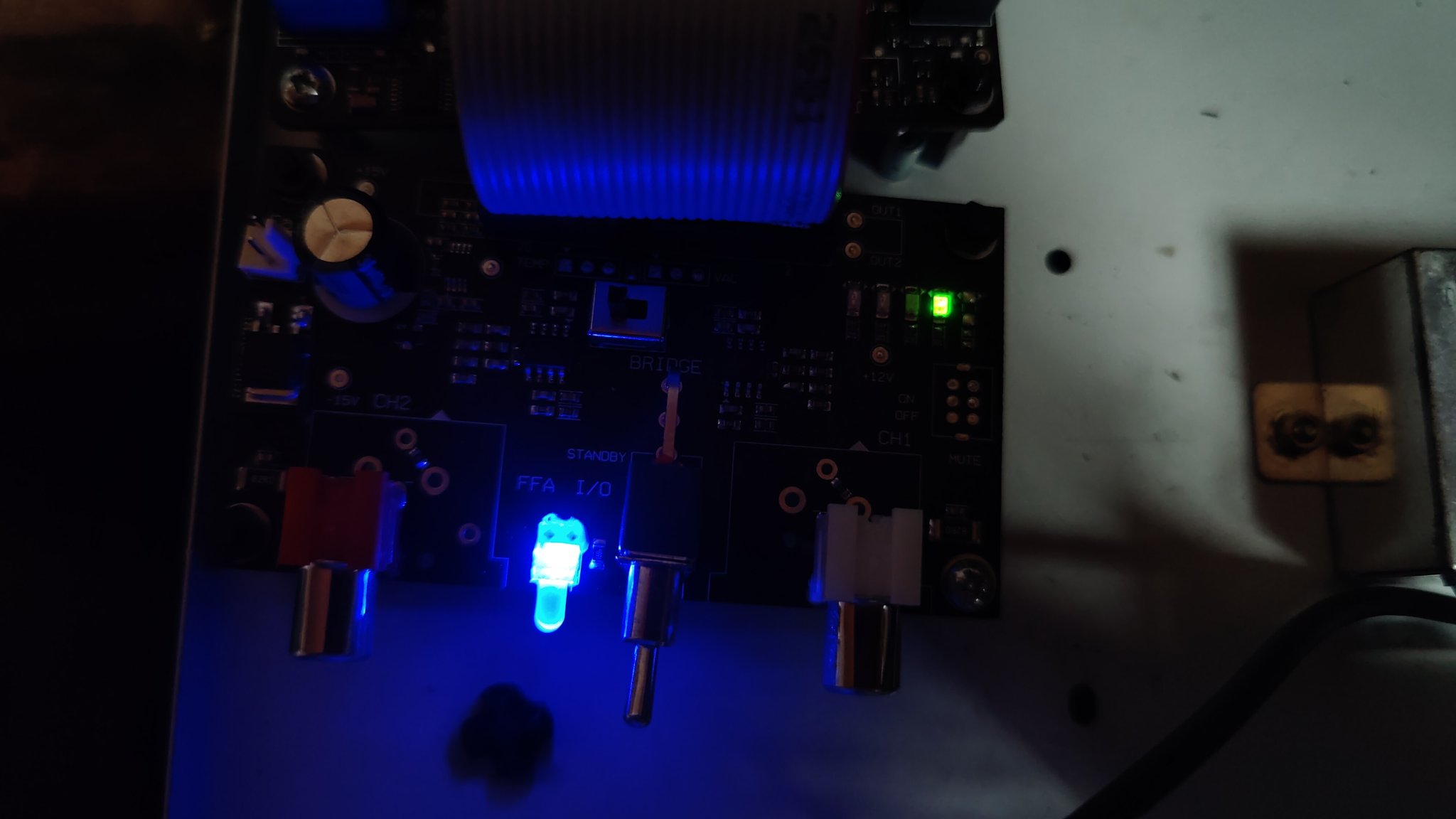

Are these LEDs what we would expect normal use case.

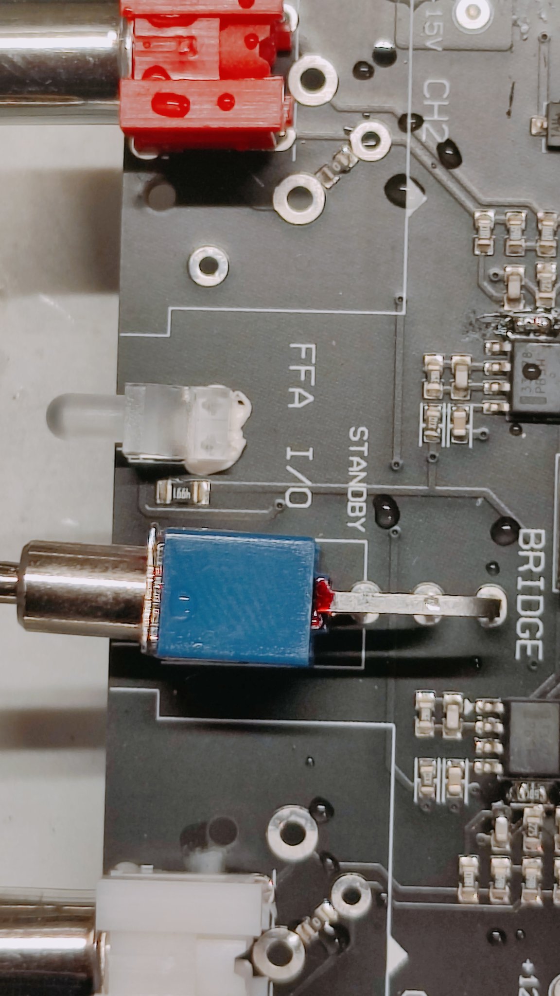

And could it be verified which pads to pick up if wiring signal straight to the I/O buffer board and not using the RCAs. I tried to buzz them out with a continuity test but I confused myself . Not hard admittedly but this isn't complicated and so I wasn't sure if something beyond me is in this design as all pins of the RCA seemed to beep to these round pads.
