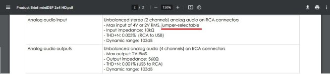

Mind the input sensitivity jumper positionWill be feeding these from a MiniDSP2X4HD
George
Thanx for the heads up. This forum with all the help is amazing. 👍
That jumper setting is only for the "Kit" version. Mine is the boxed version and all settings is in the UI.
i,ll will properly only use USB input from my Raspberry Pi running Volumio.
Ah, OK.That jumper setting is only for the "Kit" version. Mine is the boxed version and all settings is in the UI.
I read that the boxed version is set to a fixed 2.0Vrms max input (no hardware or software adjustment)
George
Hi, George and Zei.Hi zei
It takes 0.93Vrms to drive the amp+RCA buffer to full output See post #535
Now reading through internet, the iphone audio out seems to be around 1Vrms at loads above some 40 Ohms.
If this is true, the headphone out should fully drive the amplifier

Previously, the RCA/XLR IO buffer has 6dB gain inside, so it's the correct voltage as George measured to drive this amplifier to rated output. And with feedback from some friends that the entire system gain is a slight larger, so I reduced the IO buffer to unity gain at latest shipment. And this will require a pre-amplifier to drive it to rated.

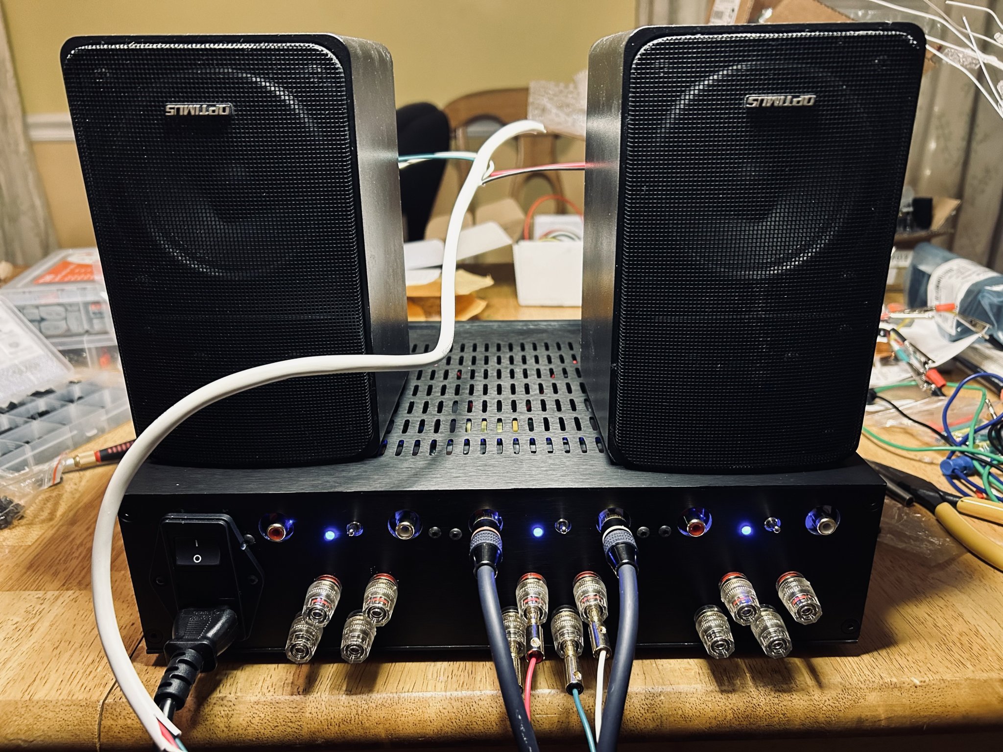

Ok.. so it really kicks @SS !
Even the 3bucks test speakers sound good with a little EQ... 😎🙂
Just one thing.. I might have got this wrong.
I,m using one module in bridge mode. And the bridge "switch" seems to just mute the amplifier.. It took me a while to figure out why I didn't get any sound on the sub..
Is this correct behavior ? connected to right channel RCA and both + on speaker out. when I flip the switch it just mutes the output. 🙄

In bridge mode, you only need to input the signal to CH1. Make sure you input the "right” input connector.
Or you can show me your system setup for debugging.

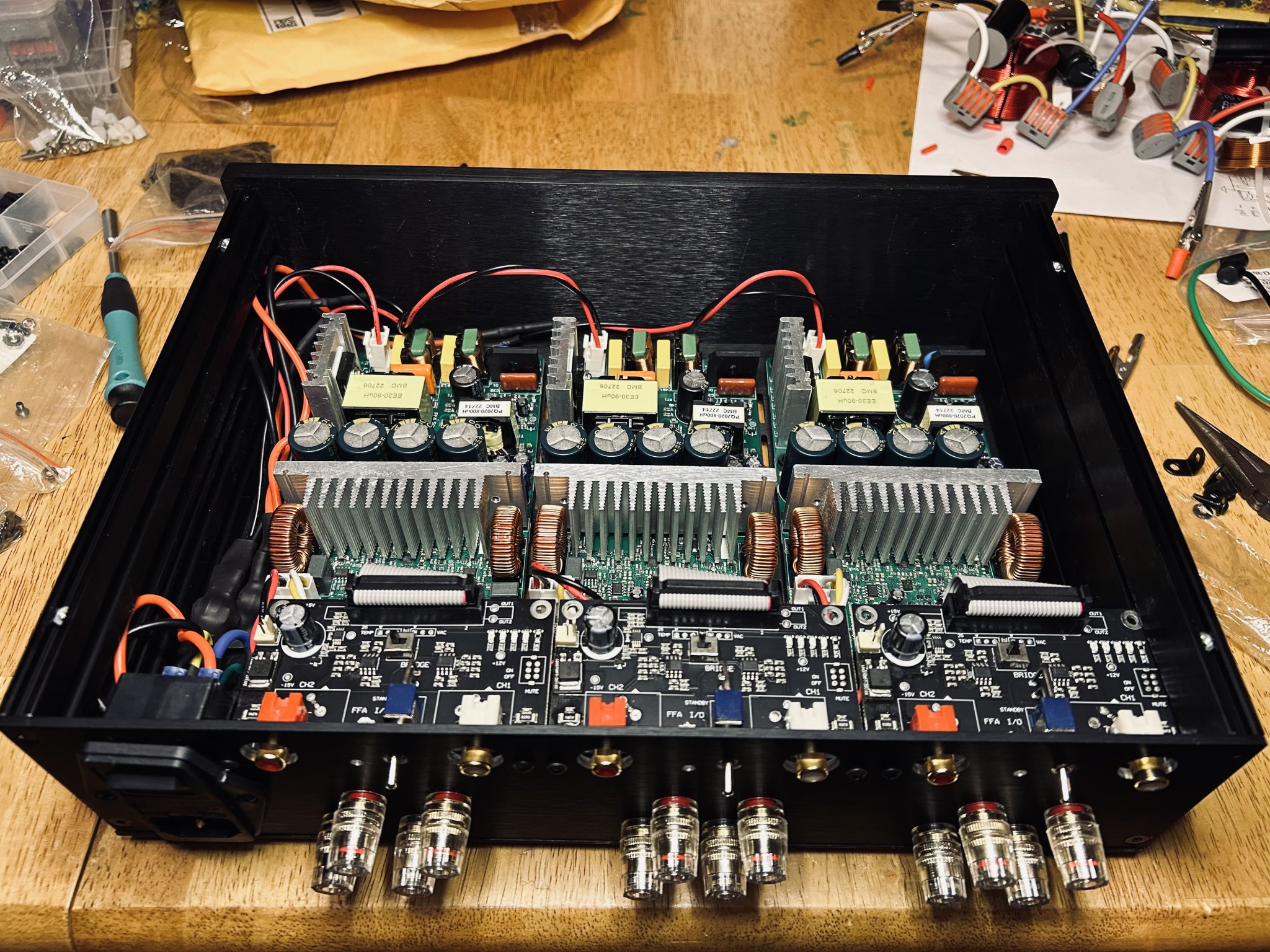

Spreading some love this wonderful Friday showing Eric's modules in action. 😛
