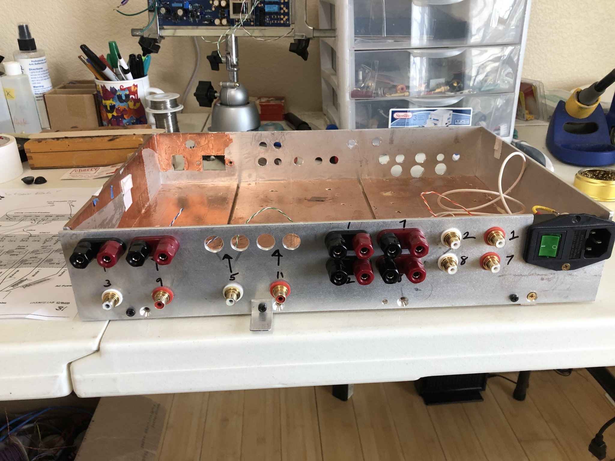

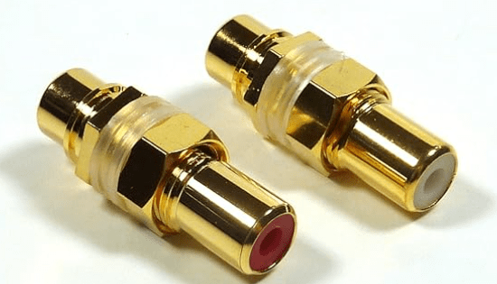

Quick question. I'm going to install RCA jacks in my enclosure. Do you need to remove the PCB RCA's or can they be left in place?

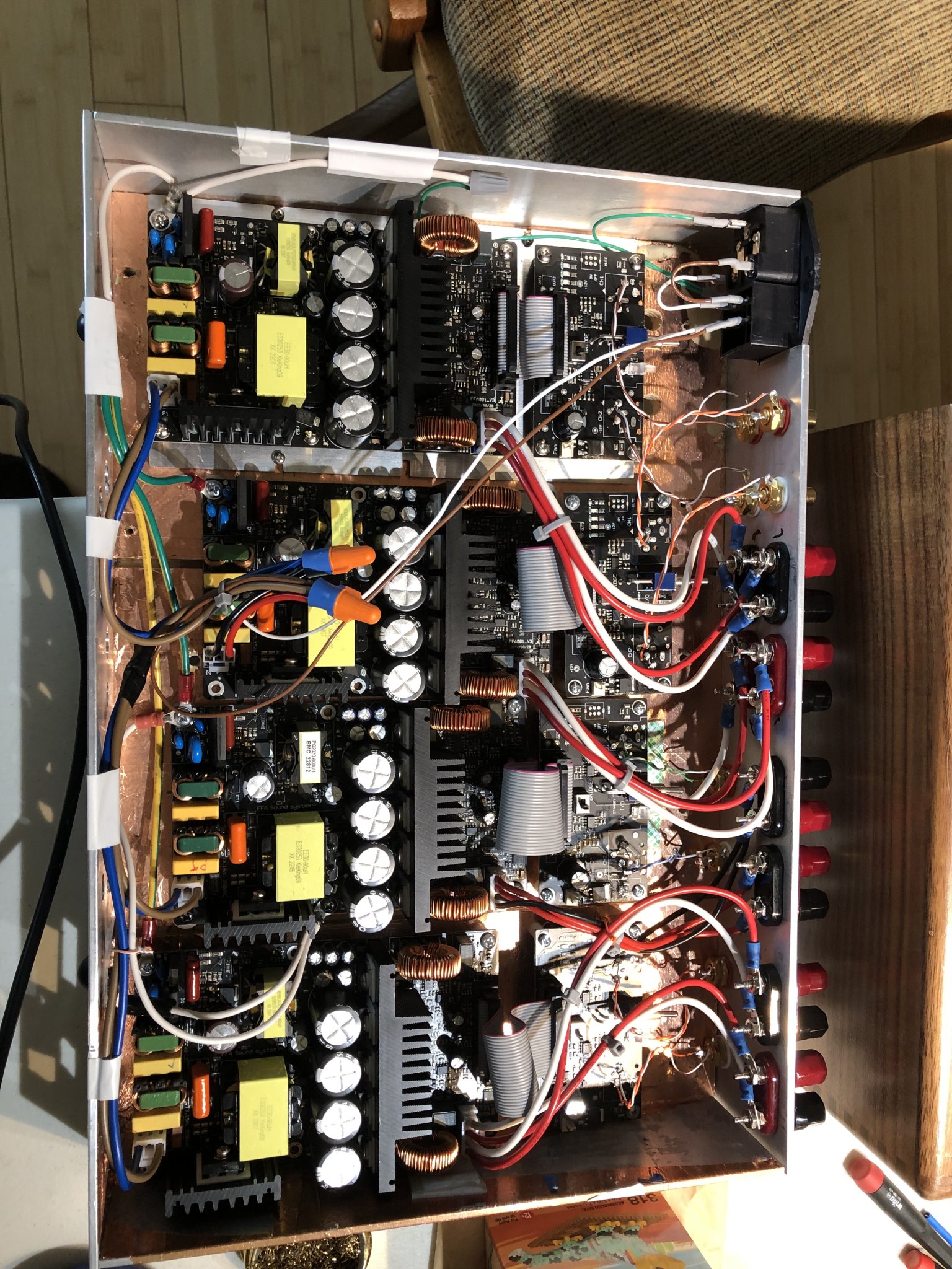

Using 4 2x150 modules. I'm going to wire the ps in series. Does anybody think I'll have start-up issues or should I just wire in parallel?
This gets slid into the back of a wood enclosure like this one,
Hi, Mike and Ronald
If you need an extra RCA jack to connect this IO buffer, I would suggest de-soldering the original one. Because the original RCA jack has an internal switch, if no plugs, the input signals are short to the ground.

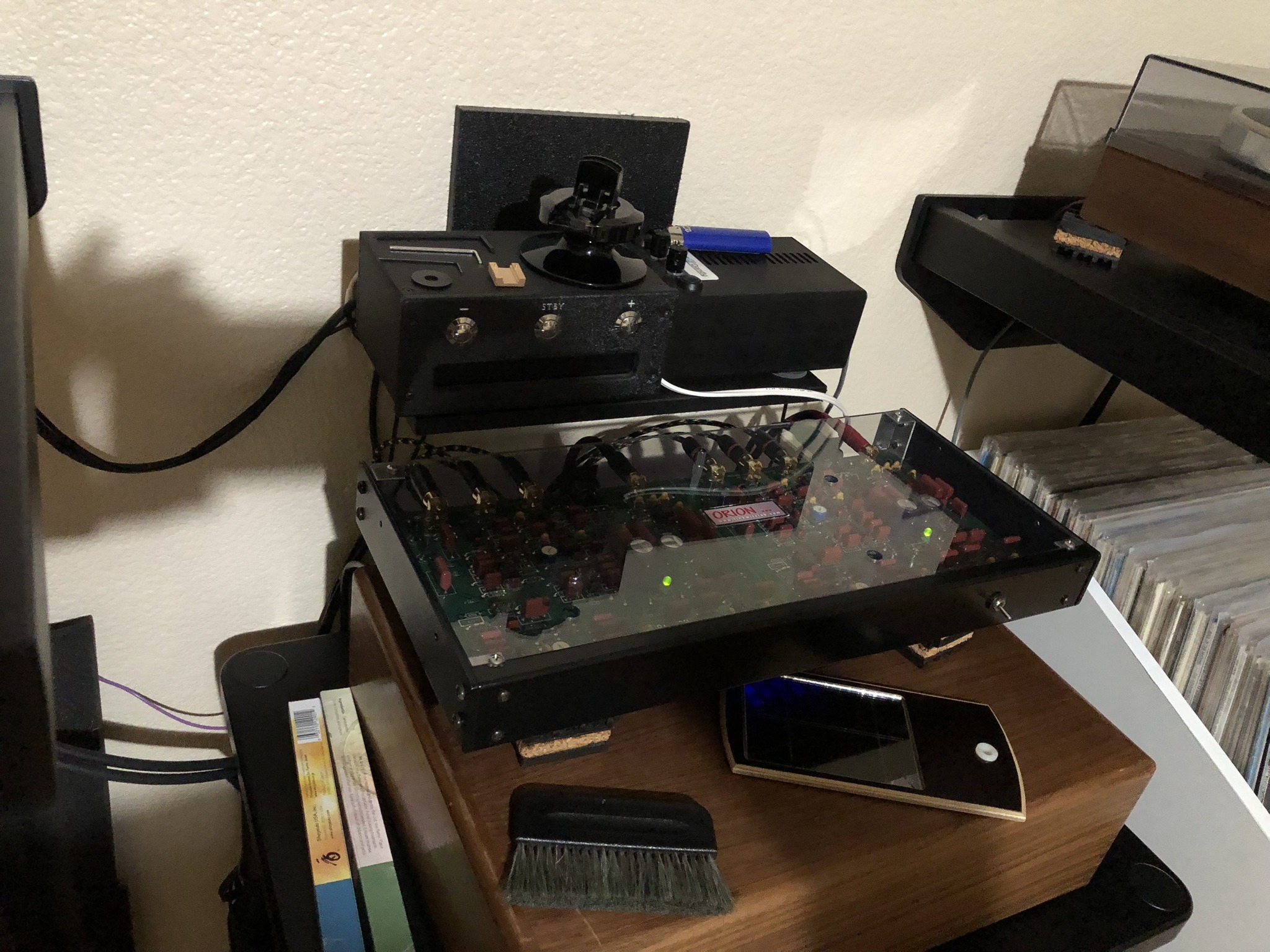

Darn quiet considering. Six inches away and quiet as a graveyard wide open.
40C in the enclosure. Driving Linkwitz Orions. I’ll take
another reading in a few hours.

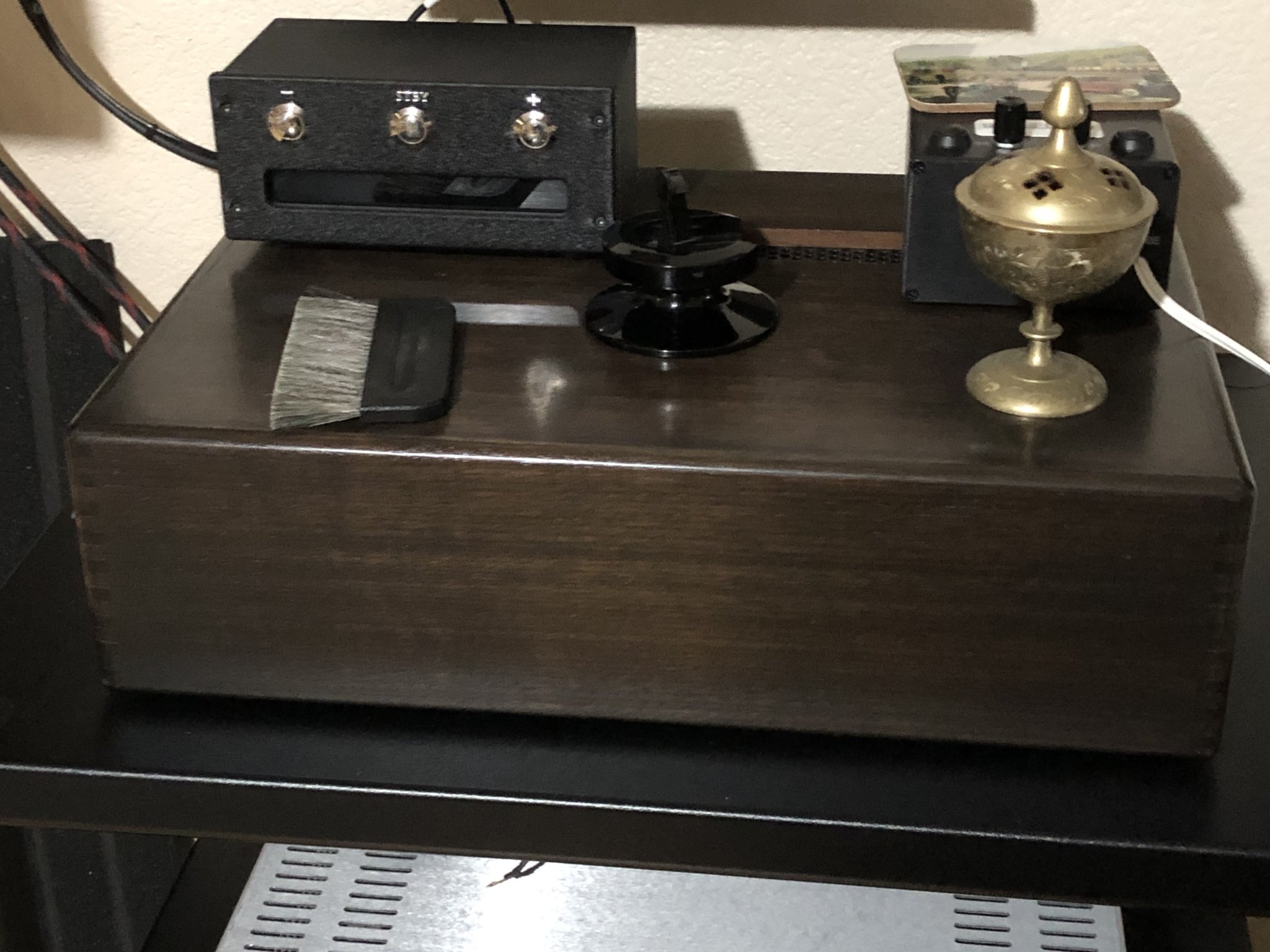

I installed two 2x150W amps into a case with more space around them than yours, with a wood cover. It got hot real fast. Not sure of temp but it felt uncomfortable. Cut slots on the sides for ventilation and that keeps it just warm. A top vent hole would be more efficient, but there's more risk of something falling in there.
