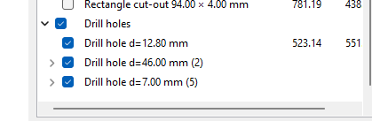

Hi team, I wonder if anyone is using Front Panel Designer for their panel cutouts? I'm not quite sure what I'm doing wrong but when I come to import the inner panel contours for the I/O board drill holes from the DXF file that Eric kindly posted, I get some weird diameters which seem way too large (an XLR panel mount isn't 46mm, more like 24mm).please attache 2d/3d files for the IO board with the rear panel.
I'll happily switch to any other software that othes have successfully used with these DXF files though...just trying to design a panel to send to CNC.
I think I solved my own problem by using the step file instead. 🙂import the inner panel contours for the I/O board drill holes from the DXF file

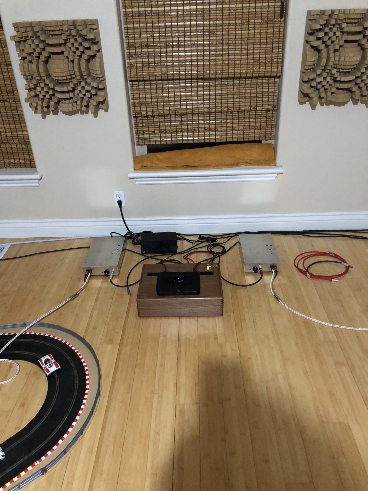

I received my FFA002V2 and set it up temporarily while I prepare the enclosure. Preliminary results are very favorable. I may order another and run two in bridged mode on my NX-Oticas.

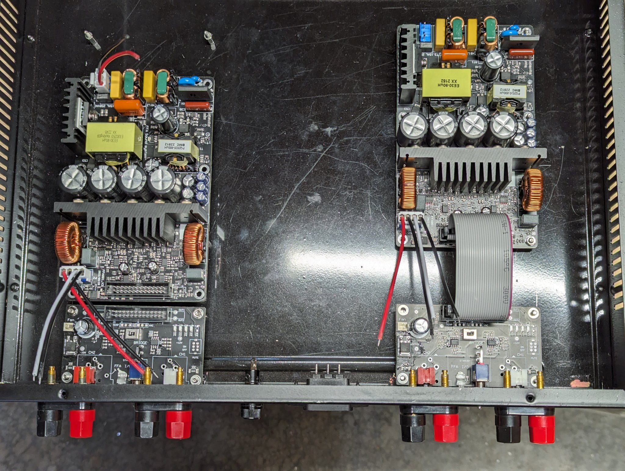

Eric, could you please provide longer leads for the AC & speaker output? 15~20cm would be great!!
The 4 amps I bought originally came with leads that are just 9cm long. This is just too short to be useful, especially for the speaker outputs.
See the attached pic.
The amp module on the right is spaced for convenience in this case. The 9cm long speaker leads cannot reach the binding posts.
The amp module on the left is placed as close as possible to the input panel, then ch2 lead reach but the (Red & Black) leads for ch1 don't quite reach the binding posts for ch1, positioned over the ch1 input jack.
Re-wiring the leads is problematic because the 4-pin plug that goes to the amp has crimped ends which are not reusable.
If all the leads were 15~20cm long, this problem would disappear. It should be an insignificant cost but if not, I'm willing pay an extra buck or 2.
Thanks for your attention, Eric!

Hi, Mike
Thanks for the feedback. Your comments are recorded and sorry for the inconvenience, we'll attach 20cm mating cables from now on.

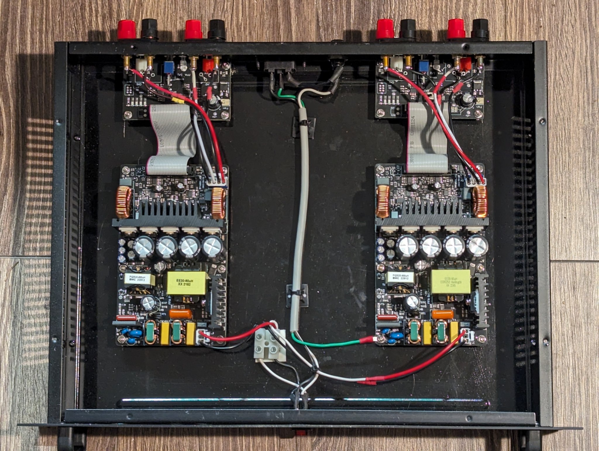

I ended up splicing a bit of extra cable to the ones supplied. A PITA, but it got done, and the end results seems fine.

Loving the slot race track; Scalextric?
