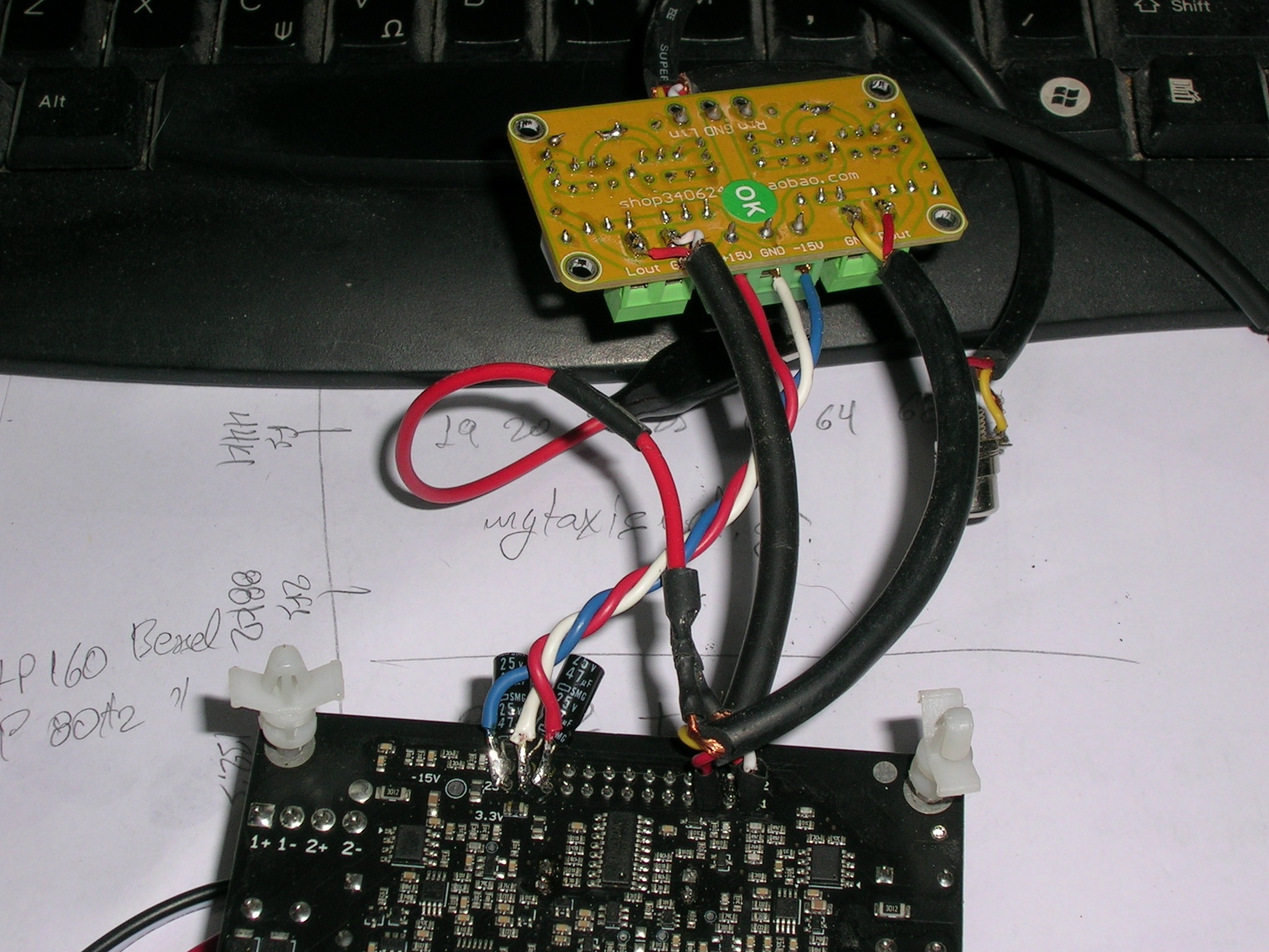

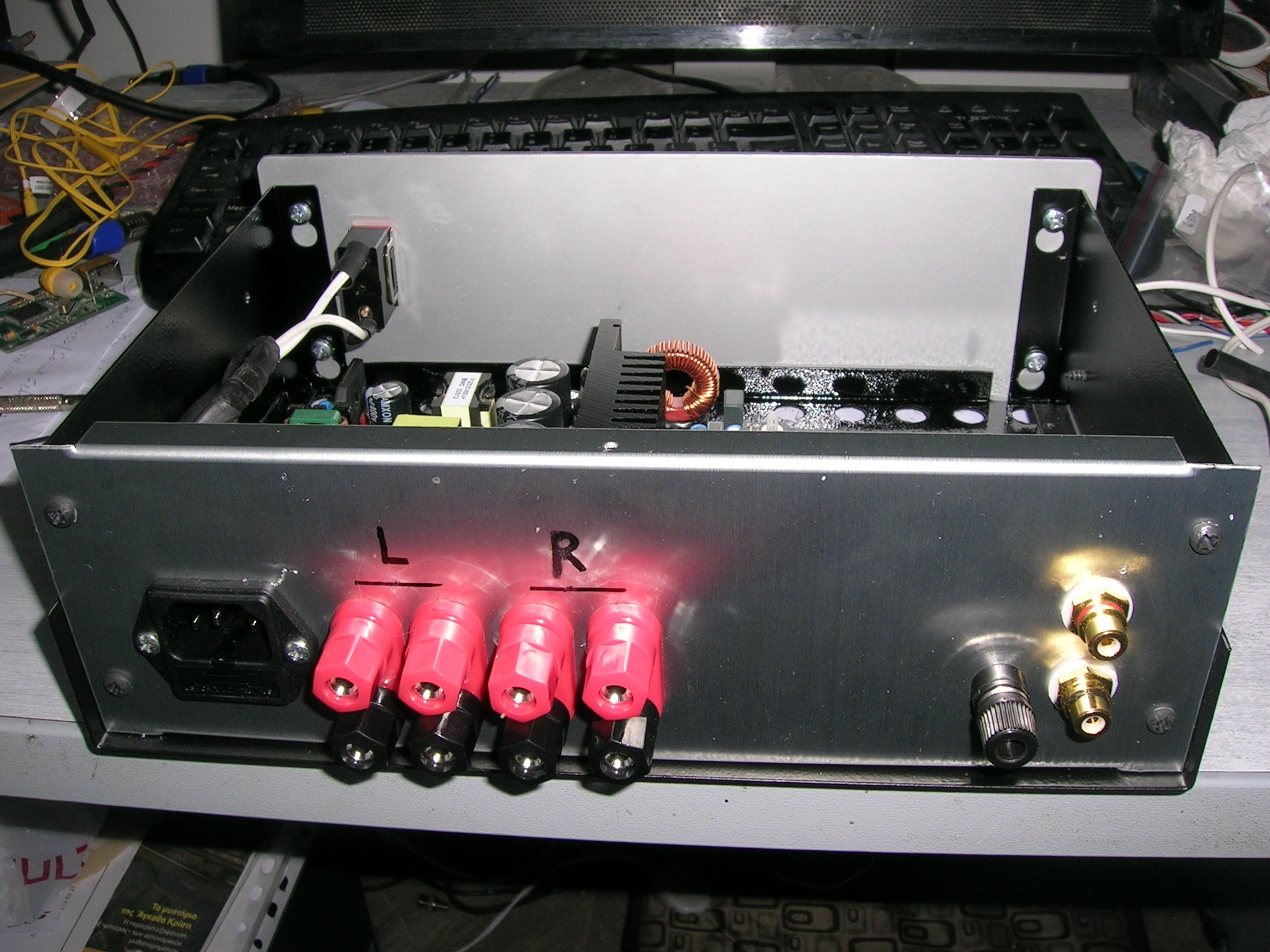

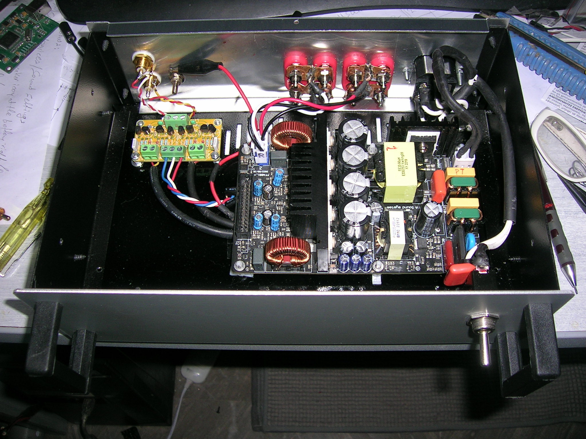

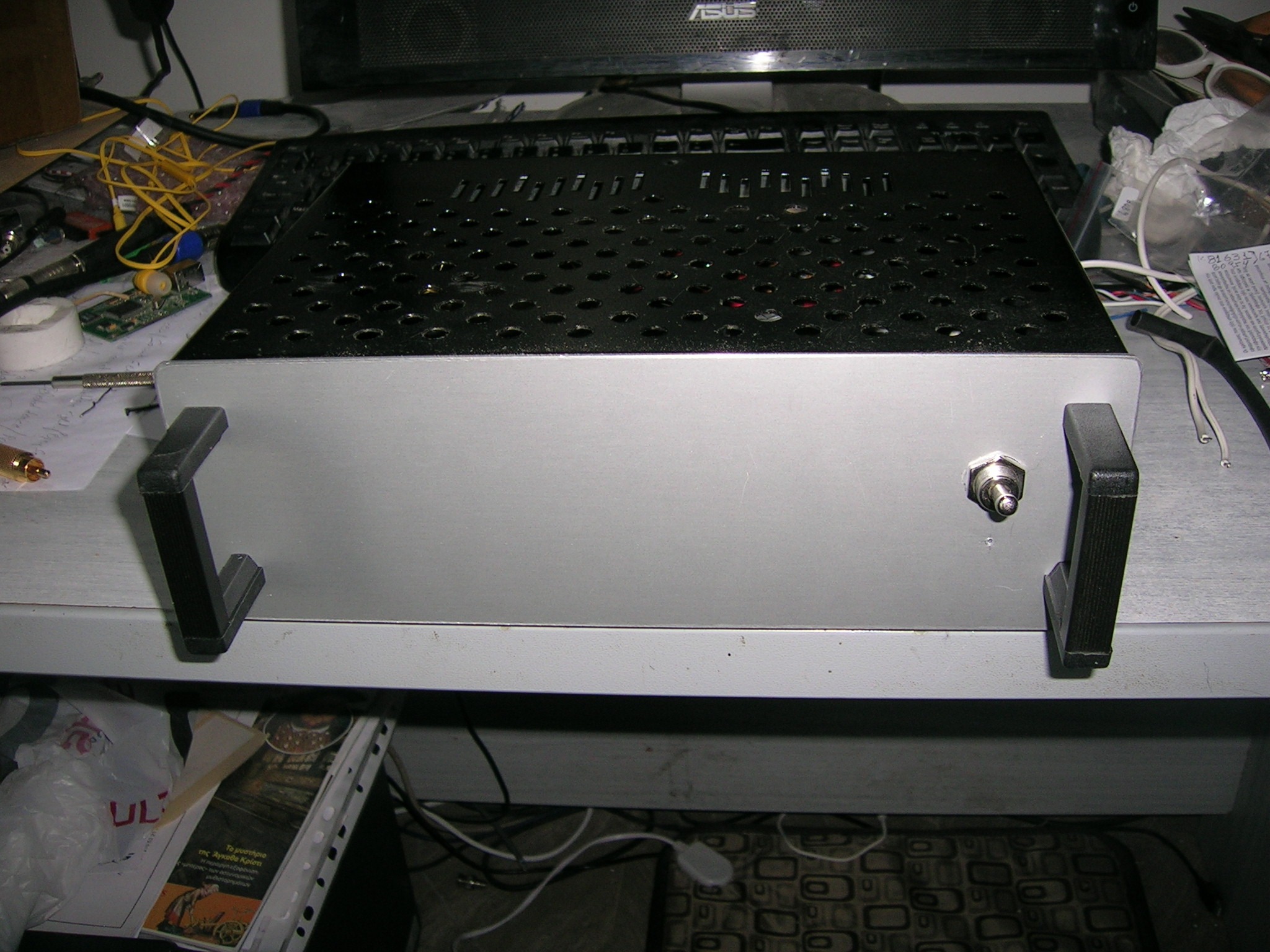

It was time to listen to the FFA001V3 without it’s Input board, driven by a small buffer.
The buffer board is the one shown here https://www.diyaudio.com/community/threads/2x150w-amp-module-for-sale.388868/post-7254865
My impression of the combination is positive, like zoom77 described it here: https://www.diyaudio.com/community/threads/2x150w-amp-module-for-sale.388868/post-7254726.

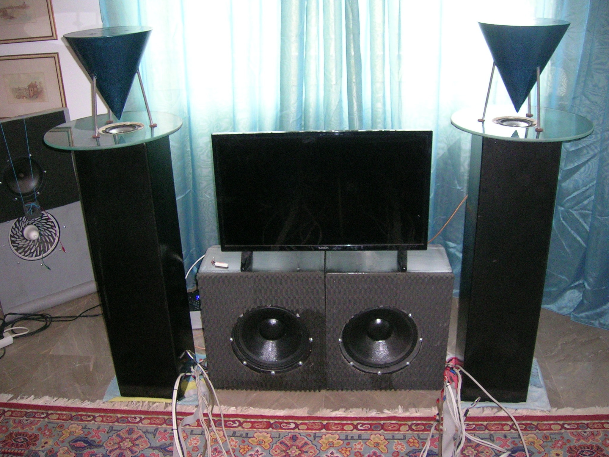

Hi Zeta4
I can assure you, driving Erics input module+FFA001V3 main amp from an AVC works great!
Although it may sound as an overexaggeration, an AVC+FET buffer+ FFA001V3 main amp, competes (acoustically) head to head with a 10k blue ALPS+ N.P. VFET amp (a wonder of an amplifier!).
In fact, in this combination, Erics amp has replaced VFET in my current setup. It drives a Jordan JX92S and a helper woofer.
(JX92 unfiltered. Woofer in series with a 23mH/2.5Ohm coil).
IMO this is an achievement in which both of you have a share.
Eric for the amplifier he designed and built. And You for the technical guidance and material help you offered me to build the AVC.
The final criterion in favor to Eric’s amp, was the LF control it can offer to this load at complex music crescendi (ample power reserves?)
