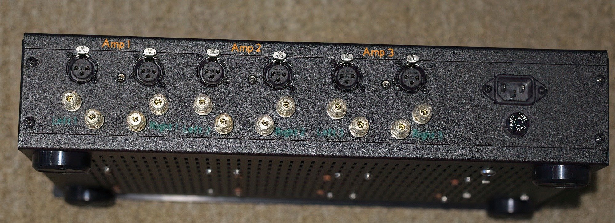

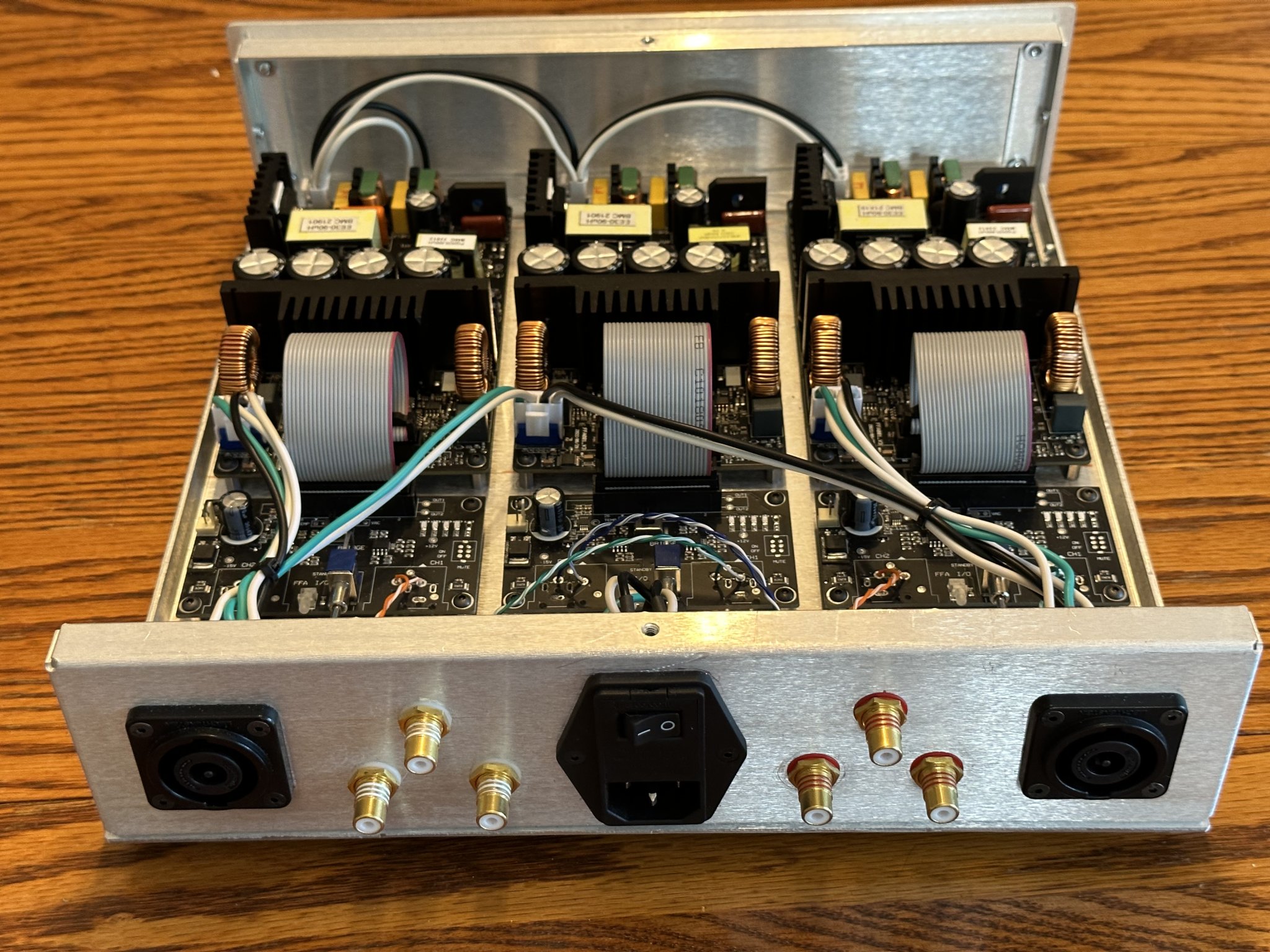

@Randy Bassinga you might go back and review the six channel by @von Ah (here and in other threads). IANA[EE] but if three boards coexist, changing the power limiter on one channel doesn't seem like it would make them fight. If you need more power than (whatever the base power line is there, it's ~15A here) you are now into breaker limits and separate lines run from the main power box anyway.
Thanks guysCheck out post 371.
https://www.diyaudio.com/community/threads/2x150w-amp-module-for-sale.388868/post-7214342
3 FFA001 modules (I ordered them way back near the beginning of this thread) drawing from one IEC mains connector works fine.

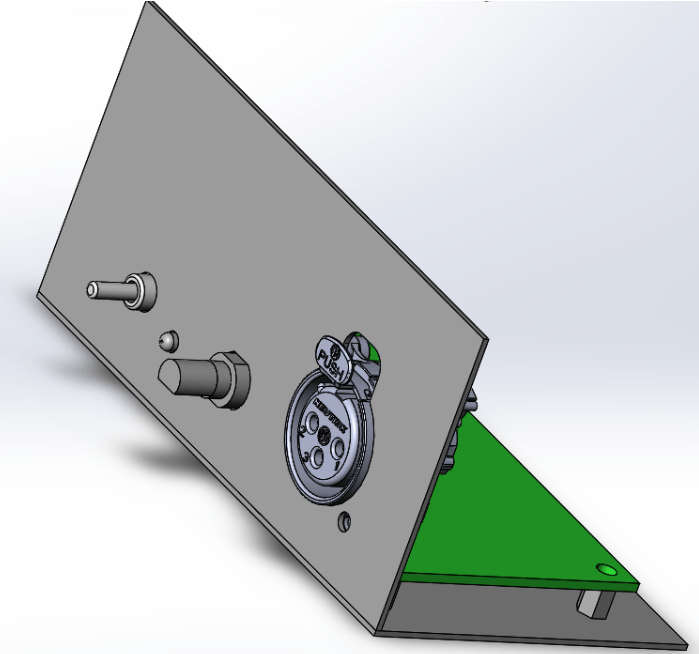

Hi, Friends
For those who ordered the 1*350W modules, I update some drawings here for your reference. It may be good for you to drill your amplifier enclosure.
Have a good day.
Thanks, Eric

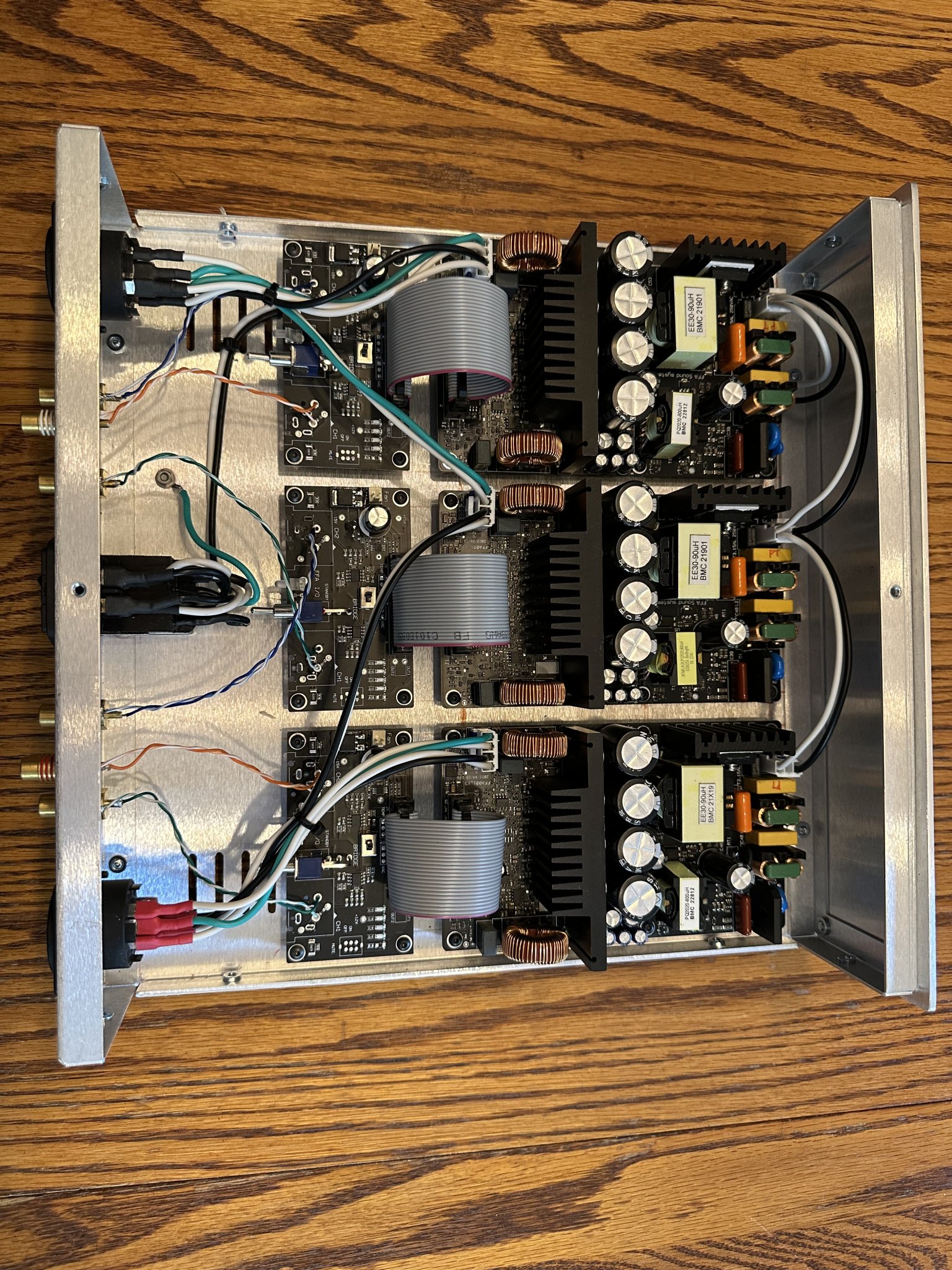

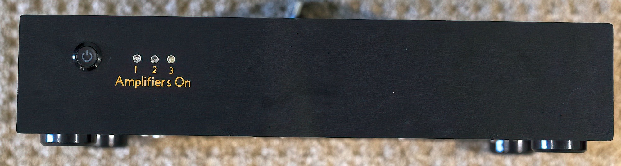

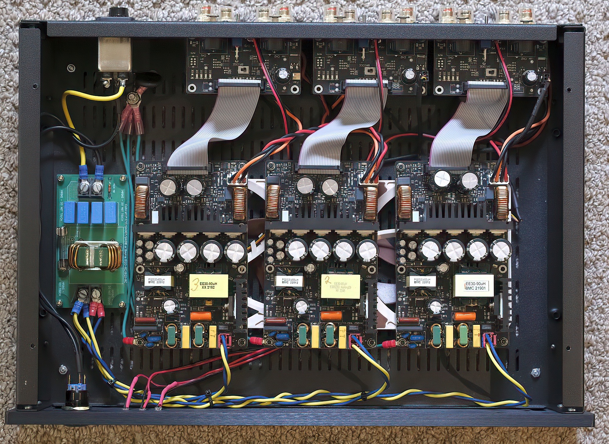

Finally completed my six channel version. Took a page out of Von Ah's build. I went with a 2U Pesante chassis from the store, added a Folsom filter, brought the indicator LED to the front panel and added the additional 100uf caps on the outputs that GPAPAG suggested.
Sounds very clean. I have several diy preamps that I have build that various forum members designed. I will take a listen to them and give some more feed back on this amp.

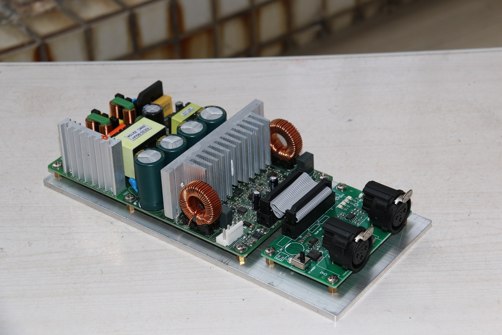

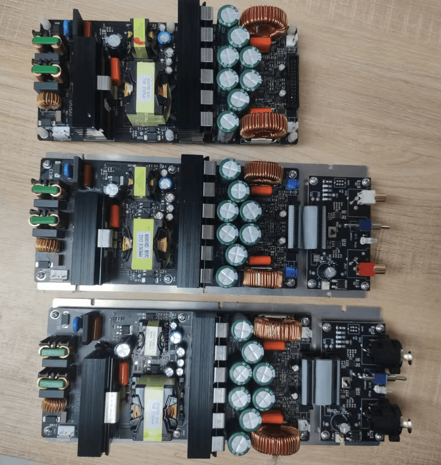

Hi @Erica.CHi, All
Announce the new 2x150W amplifier module here:
Input: 85--265Vac, constant power SMPS
Output: 2x150W @ 4 / 8ohm
Price: 49.9/Unit, w/o shipping
PM me if you need more information.
Thanks~
---Announce the new build with a new I/O buffer design(compatible with RCA and XLR input), friendly mounting into the chassis.
--- Ready the FFA001_V3 HB version (CH1=300W @4OHM, 150W@8OHM; CH2=150W/4&8OHM); Suitable for the active X-over and DSP pre-stage.
--- FFA001_V3 spec sheet & Test data;
--- FFA001_V3 & I/O_V1&I/O_V2 dxf file;

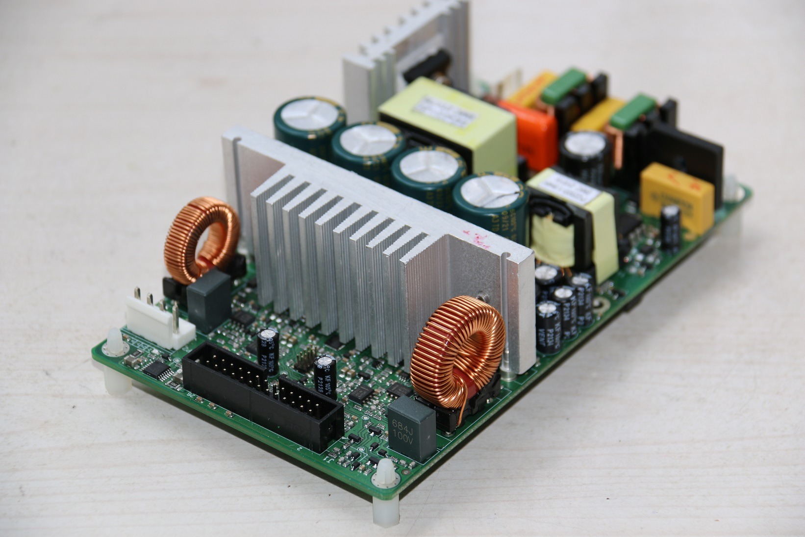

HiHello friends,
2X300W module is ready for order now🙂, currently, it only supports the 185--265Vac input.
I welcome you PM me for more details.
Thanks,Eric
View attachment 1161150🙂
Is there anyone who had compared this against the 2x150W version?
Any difference in sound or do they perform almost the same, just more powerfull?

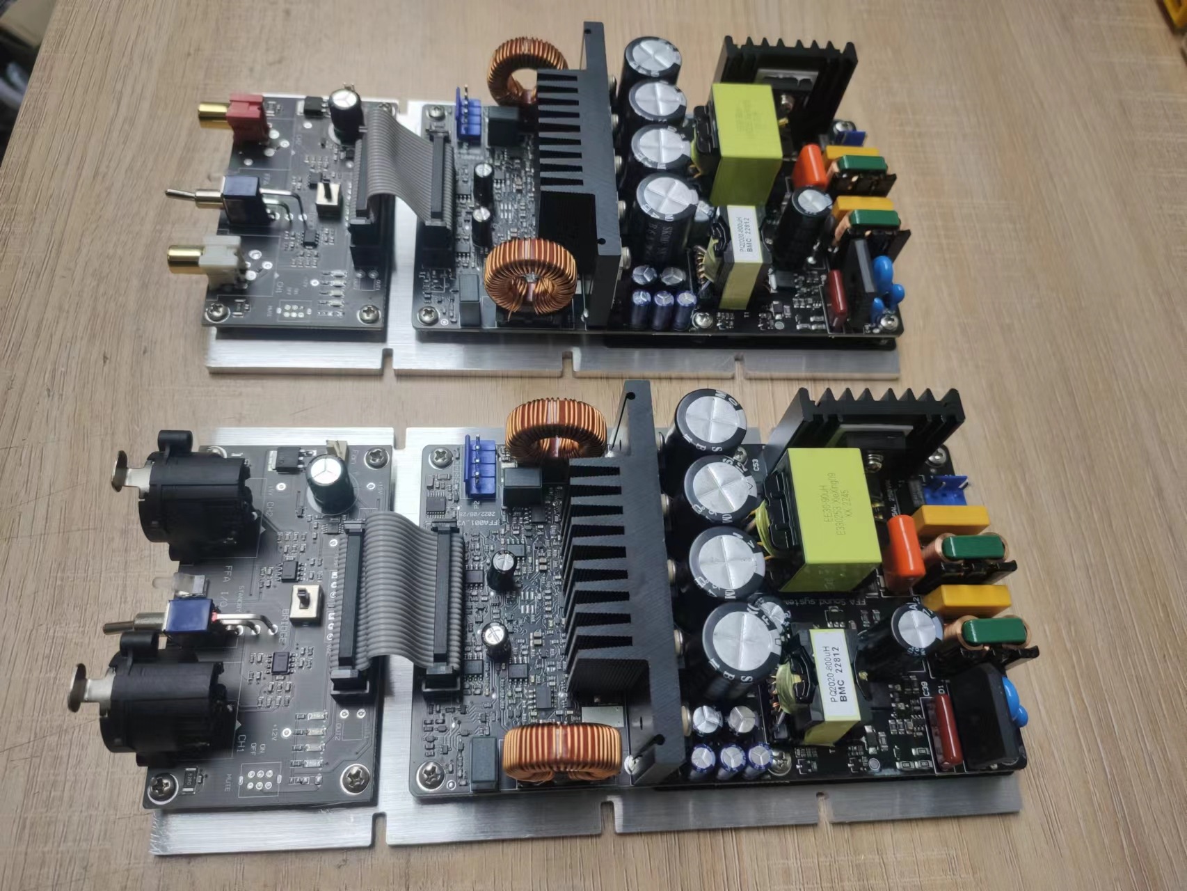

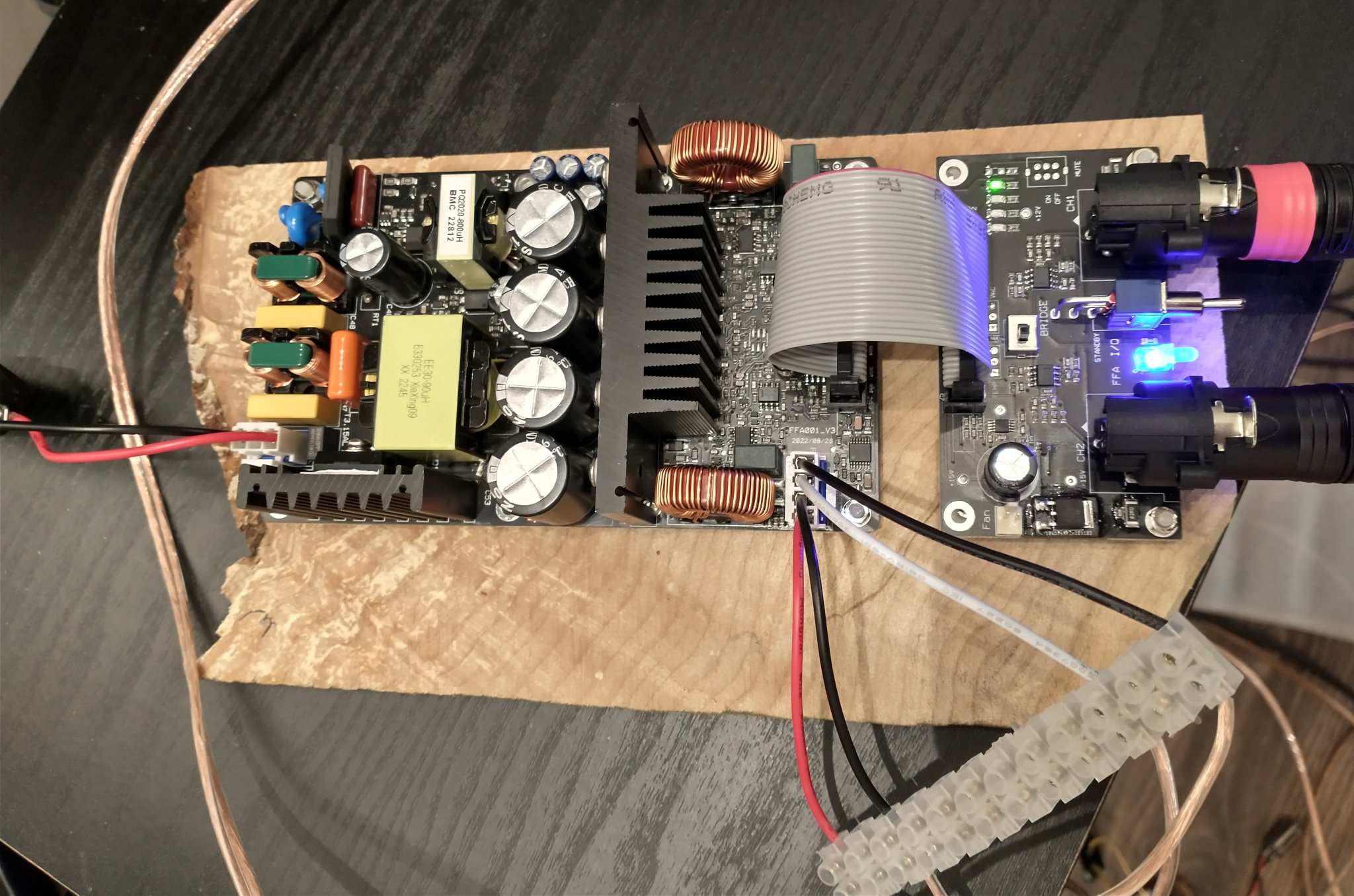

So the two amps I ordered arrived a few days ago (from a Canadian address!!) and I found time to rig one up temporarily. No connection for the ground of the AC cable seems a little strange. Excuse my ignorance: What should be done with the ground terminal from the IEC AC cable?
As everyone's said, the amp and input modules both look excellent, clean. 🙂👍
Had to hunt around for a passive speaker system as all my speaker projects in the studio are active. Using a pair of Paradigm Millenia Ones, the only passives I have on hand. Shocked the amp sounds as good as it does!
No hum, just a bit of hiss mostly from the tweeter a few inches away.
Like most buyers before me, I opted for the balanced inputs. The 32 dB gain mentioned for this seems really high! I would prefer not to have the additional 6 dB gain of this input board. Any way to change/reduce the gain?
Also, does the toggle switch function as a power switch or simply mute the input? I assume the on-board slider switch is for bridging.
This post goes in to some detail about PE and ground connections:
https://www.diyaudio.com/community/threads/2x150w-amp-module-for-sale.388868/post-7215251
