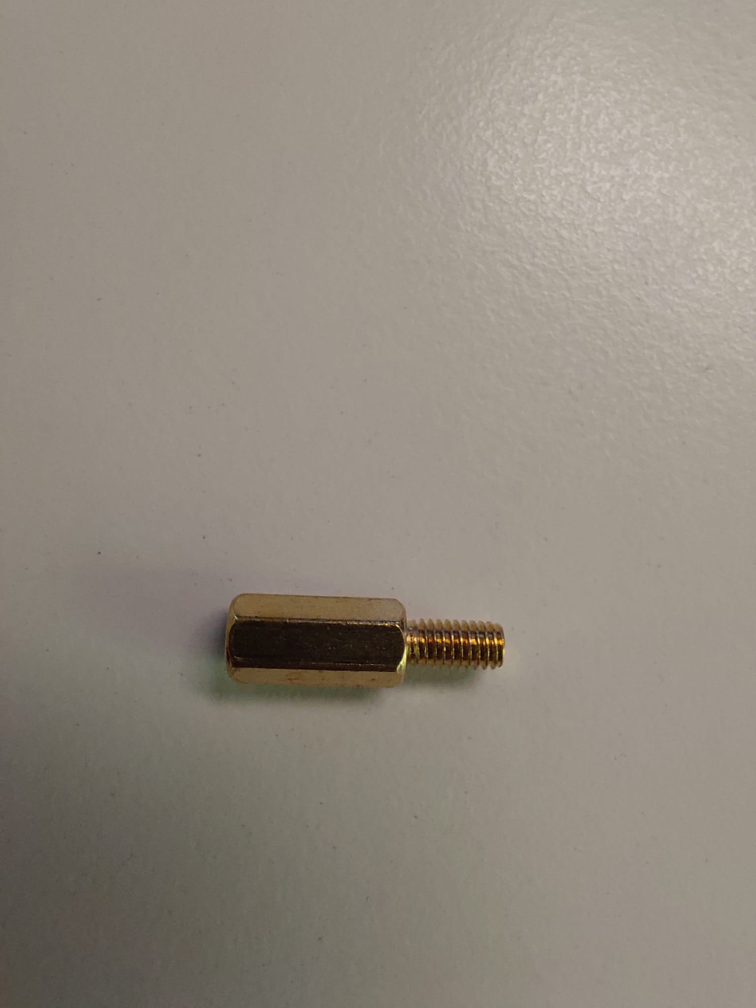

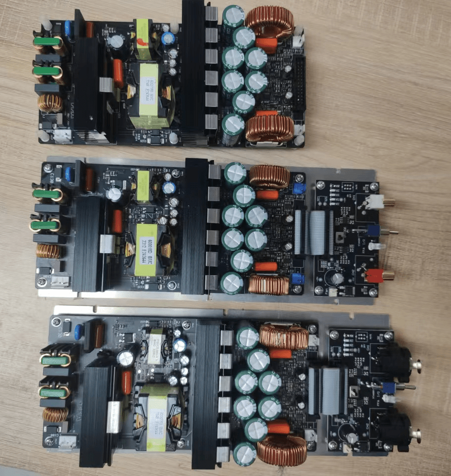

Dear Zoom, small question - how did you make the holes to put theFinally found some time and a chassis to enclose the amp properly. I have wired up the standby switch out of the board so to that the cables do not get it the way. The blue led indicator is also wired out with to the front panel so that its status is visually accessible at the front panel.
Dear Zoom, how did you make the holes to put the holders on the box?PCB standoffs

I used 10mm versions so that the overall height is not too tall
I measure the position of the mounting holes, draw the positions on the chassis. I dot punch on the four holes, drill smaller holes as pilot and then drill enlarged holes to fit M3 screws.

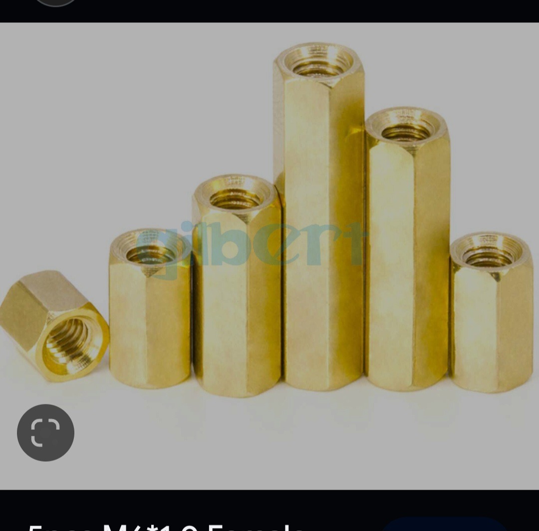

Hmmm can you show me what kind of standoffs you purchased? The standoffs should already be threaded for use with fastening screws on both ends.

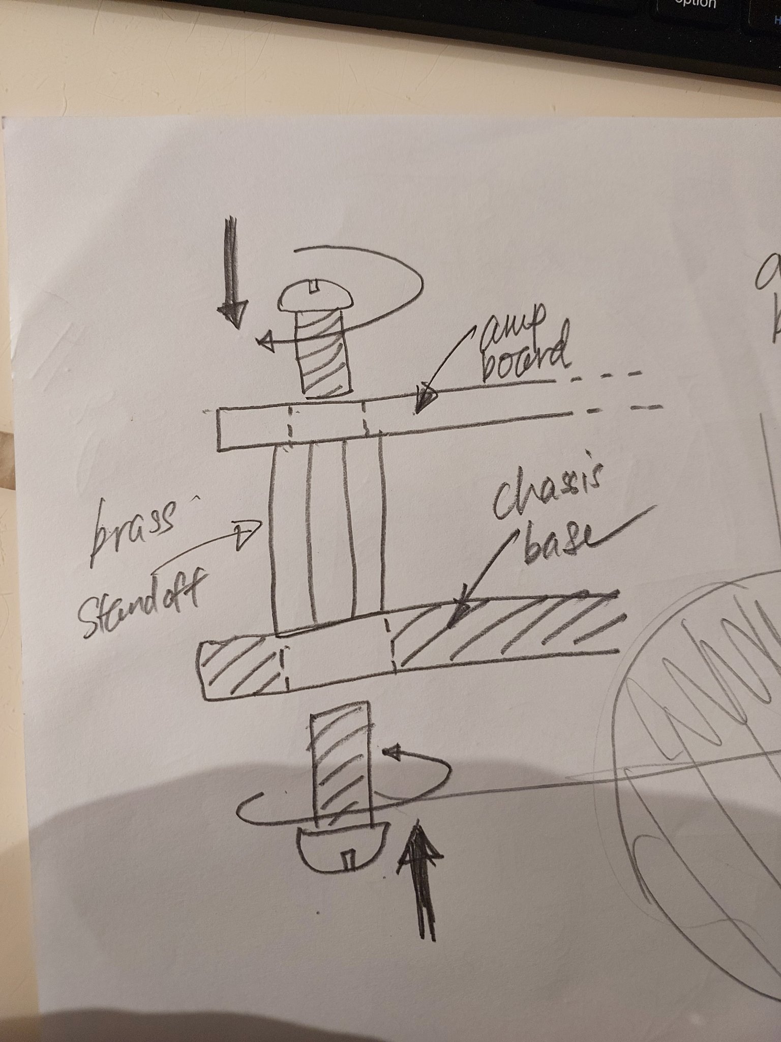

Yes drill holes on the chassis plate to accommodate the fastening screws.And how you screw them to the box?
You need to create screwing in the box?

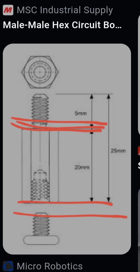

Dear Zoom, I bought these, as seen on the link you sent me...Yes drill holes on the chassis plate to accommodate the fastening screws.

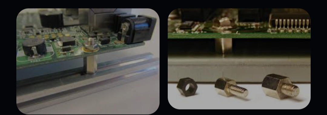

Then instead of using screws on both ends, install nuts on one end and screws on the other end. It still works the same.
If the bottom is thick enough, you can also drill a 2.5mm hole and use a 3mm x 0.5mm tap to make the threads in the case. That's what I did.

Thank you very much. I will try it when the case arrives.Yes drill holes on the chassis plate to accommodate the fastening screws.
