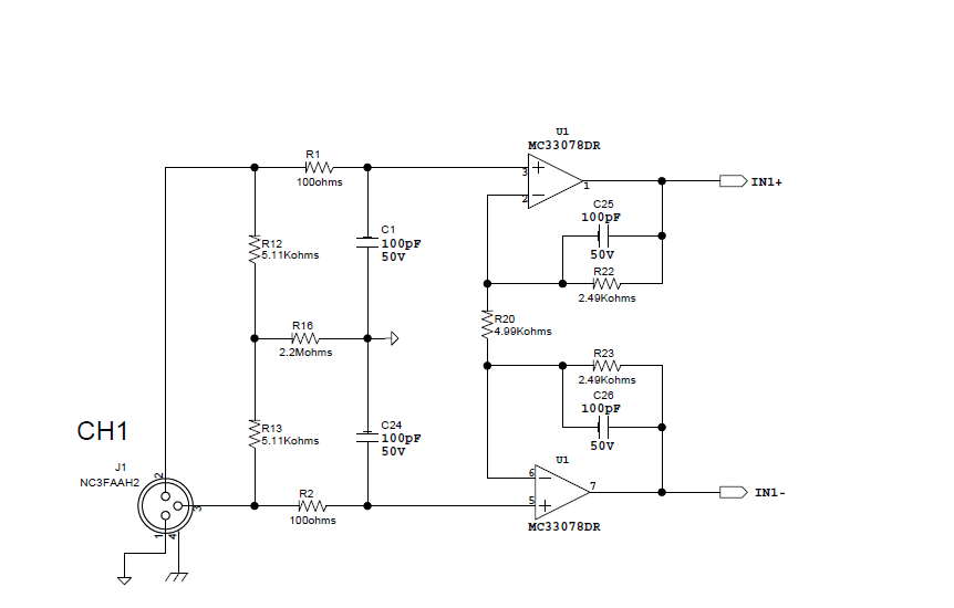

Did you succeed in adding a volume pot?View attachment 1132523
This is the op amp circuit on the I/O board. Any suggestions on how to include a volume pot? I am thinking of getting a 4-ganged volume pot of 10k or 20k and use the amp as balanced inputs. Do you think i should remove the R12 and R13 if i install the volume pot?

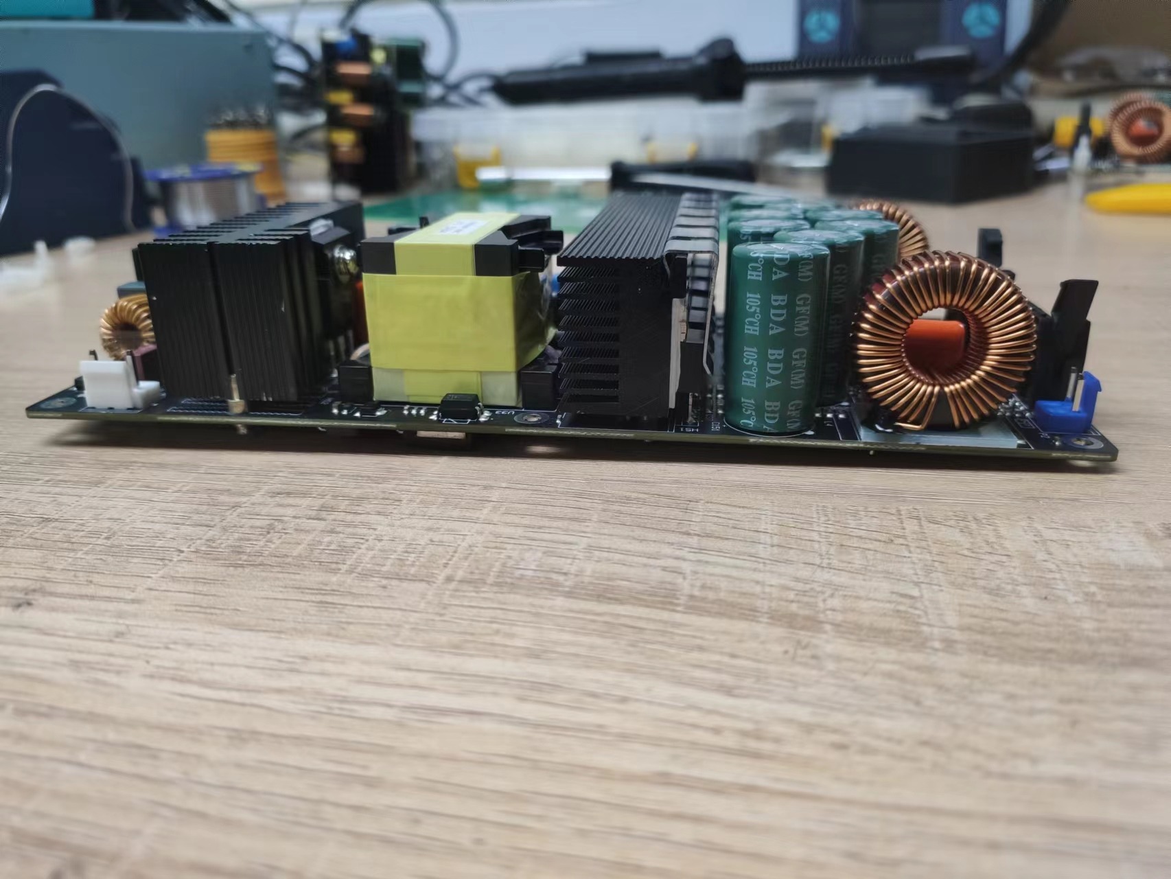

FFA002 family added a new member, the completely 1U height design 🙂

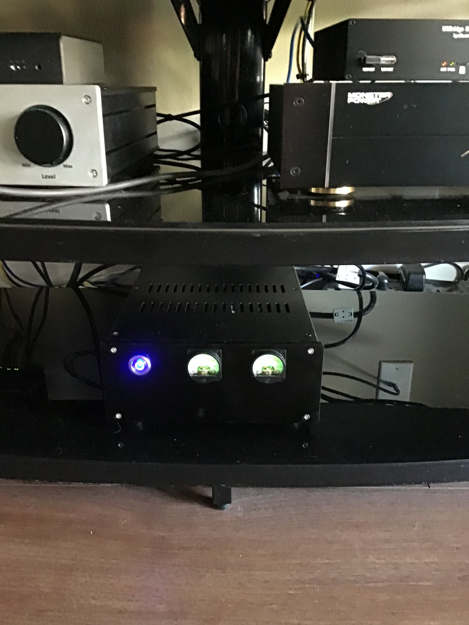

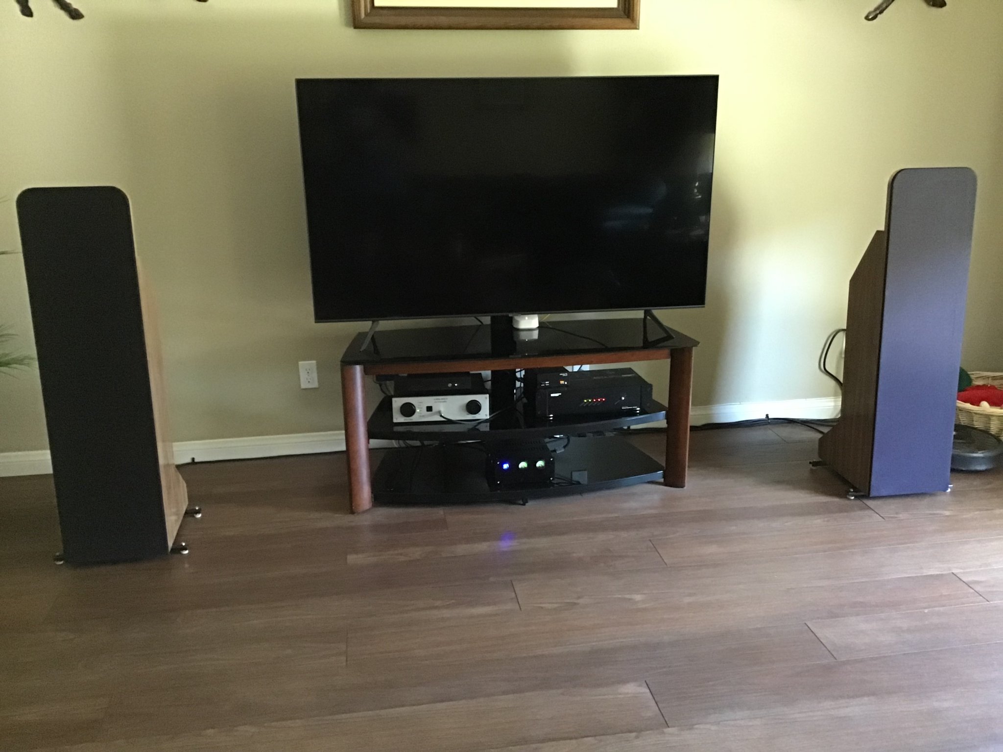

I know meters are cheesy but I had them and had to use them some where. Taking the wiring off the io board for standby switch on the front was not too bad but getting to the 12 v was to bridge the 6k resister and solder a plug after removing the on board led. That was a little bit of a hack I did not like, thank god it was a replaceable io board - I would not have done that on the main board. Speaking of io board I would gladly buy a new one if it had plugs built in for 12V and the standby switch.
Bill
PS : It sounds awesome, the open baffle speakers have a bass array of 8 - 6” woofers and it needed the extra headroom.

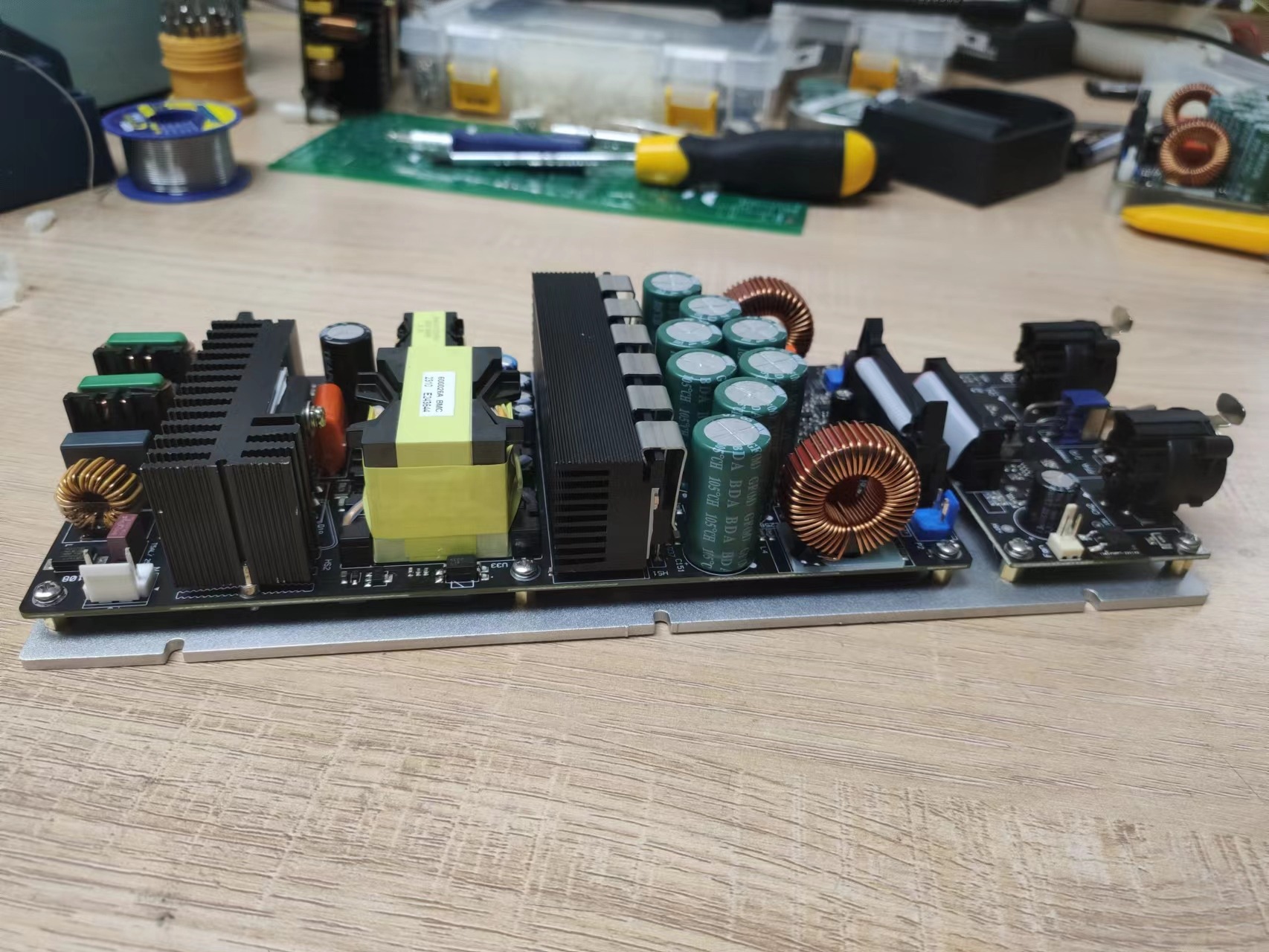

Hi,Kelvin
Thanks for your reaching out.
For the application, I'll attach the spec for your reference. The 26pin definition is same with Pascal 26Pin amplifier modules (Like Upro,Spro2...)
If you can build your amplifier plate as below picture to have a Fan up-side the module, it can be suitble for your inside or outside cabinet applications.
And, we do have a 12V/1A from the 26pin connector to supply the FAN.
Thanks,Eric
