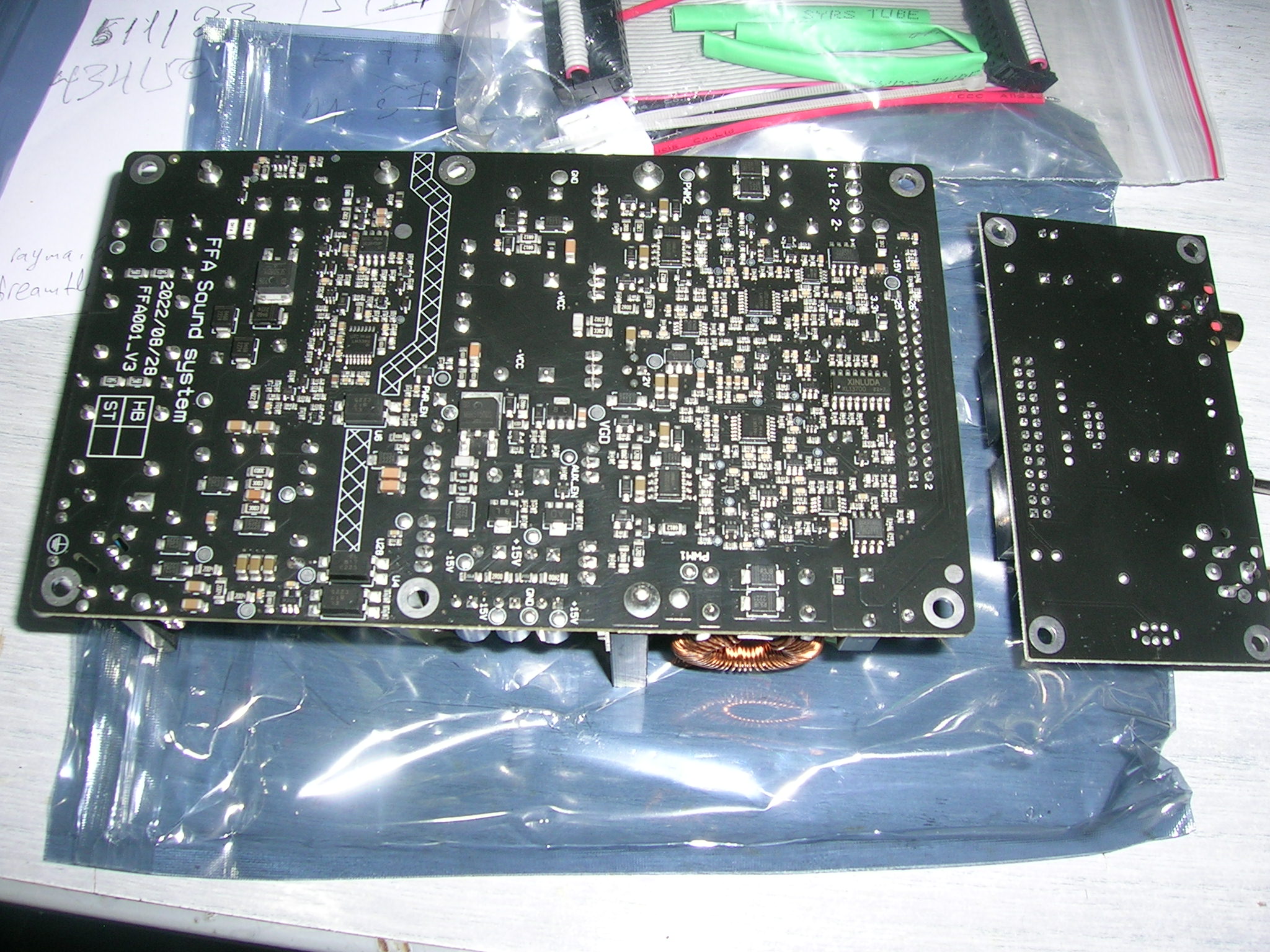

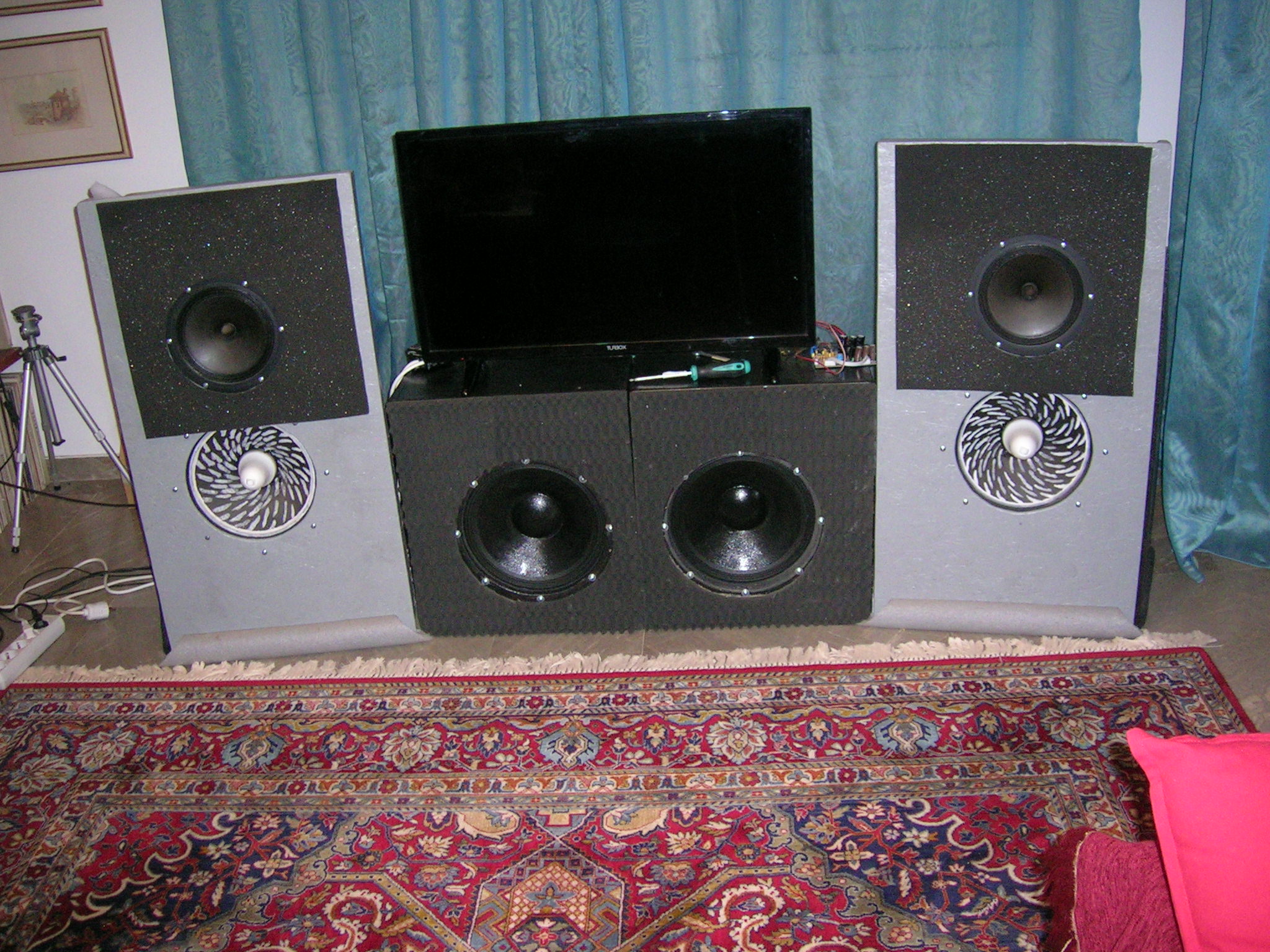

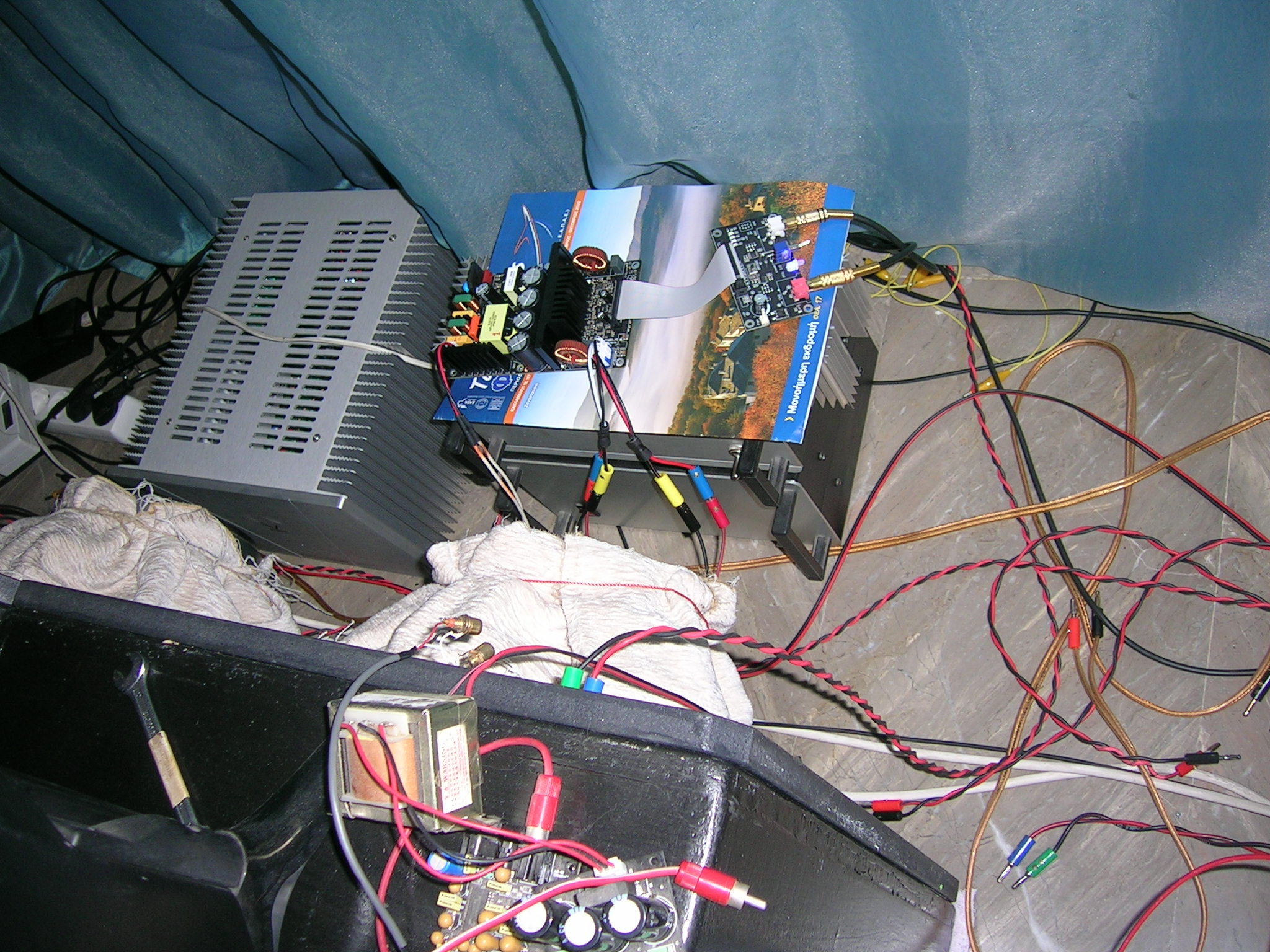

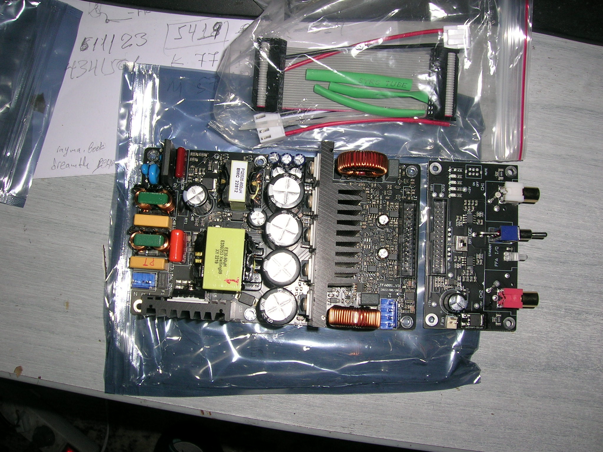

I received mine and from what I saw I concur with what bonjonno wrote "it feels and looks light years' ahead of a typical ali-express class D board" or any of the ebay class D boards I would add.
No time to waste, I connected it to my OB speakers and had a good listen from a CD player and passive preamplifier.
A young friend happened to be here and I asked for his comments. We compared it to some other amplifiers too.
My compliments to Eric for his brain and hands child.
There is nothing not to like. Neutral sound, no exageration across the audible freq band. Good bass control, clear and bodied mids, civilised highs. Powerful, detailed and balanced sound. No noise. No on/off clicks and pops. Minimal power consumption (some 10VA from mains when listening at average 75dB SPL at 2 meters. A big plus, it had no detrimental effect on the reception of my FM tuner (indoor antenna), quite an achievement itself for an unhoused SMPS/class D amp board.
I can only recommend it to other fellow members.
George

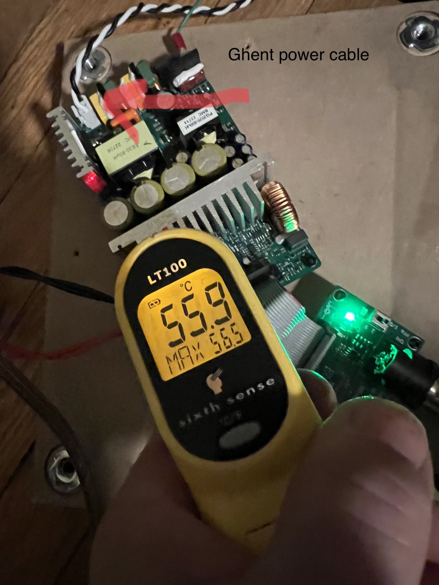

I’ve used Ghent cables for many projects they are reasonably priced, high quality, and ship free. In fact I used one to test out the first amp I purchased from EricI'm looking for replacement connectors to rewire with heavier wire maybe from Ghant. What are the spacings.
https://www.ghentaudio.com/item/jst/phr-list.html
Thanks.
YesIs the 16awg from Ghent a sufficient wire size for speakers and AC?
Are you using a three prong plug? So far I'm using a 2 prong. What's the recommendations for power inlet?I’ve used Ghent cables for many projects they are reasonably priced, high quality, and ship free. In fact I used one to test out the first amp I purchased from Eric
