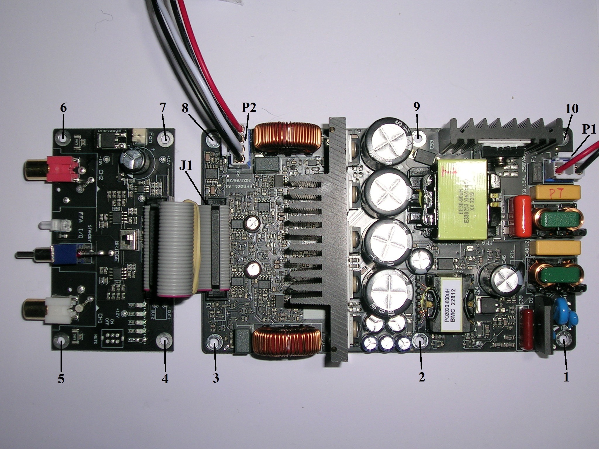

A few observations relating to grounding after probing around the FFA001-V3 module. They are in agreement with stryx posting https://www.diyaudio.com/community/threads/2x150w-amp-module-for-sale.388868/post-7212954
Please see attachment 1 and 2
Main board:
There is no direct (DC) connection between any of the mounting holes.
Hole #9 is directly connected to the PCB ground. Thus there is also 0 Ohm between this hole and:
Negative speaker cables (P2 connector pins 2, 4)

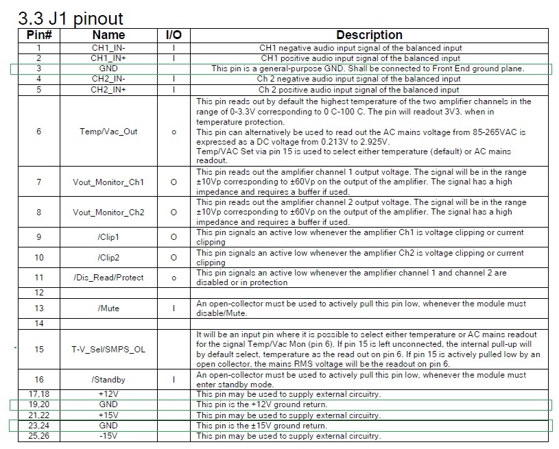

J1 connector pins 3, 19, 20, 23, 24
Hole #1 is capacitively connected to Live and Neutral AC mains input (P1 connector, pins 1, 3) through 1nF capacitors. It serves as the grounding connection for the mains LP input filter.
There is a 300pF capacitance measured between this hole and PCB ground (Hole #9). I don’t know if it is due to a real capacitor (component) or it is parasitic.
Holes #2, 3, 8, 10 DC float. Holes #2, 3, 8 measure 860pF to Hole #9 (smd capacitors on each) and 220pF to Hole #1. Hole #10 measures 0pF to both Hole #9 and Hole #1
RCA input buffer board:
Buffer board is connected to the main board through the ribbon cable. It’s ground plane is an extension (0 Ohm) of the main board general ground.
Holes #4, 7 DC float. They measure 0pF to ground.
Holes #5, 6 are shorted together. Each is connected to ground through an 820 Ohm resistor in parallel to a small capacitor, thus they measure 410 Ohm to ground.
Input RCA barrel is each connected to ground through a 0 Ohm smd resistor

It's a real capacitor between smps secondary and primary ground areas, you can find that big smd capacitor near hole #9.There is a 300pF capacitance measured between this hole and PCB ground (Hole #9). I don’t know if it is due to a real capacitor (component) or it is parasitic.
Erica.C it's done everything possible to prevent ground loop.

... On amp and smps pcb near main rectifier and three blue capacitors it is connection for EMI filter ground, you need to use that connection for optimal EMI filtration.
Today I listen that small amplifier, for his price its sound really good. I don't have any noise oe hum. I used just ground connection just EMI filter so it was impossible to have an ground loop. ...
I put amplifier in some aluminium box and grounded all mounting holes and.... noise, no hum, no nothing, just deep silent.

So, for a novice, if I were to use one of these, would I ground
- Only the EMI filter ground (or #1 on gpapag's diagram)
- All mounting holes
- Some other arrangement that is apparent to someone more experienced?
