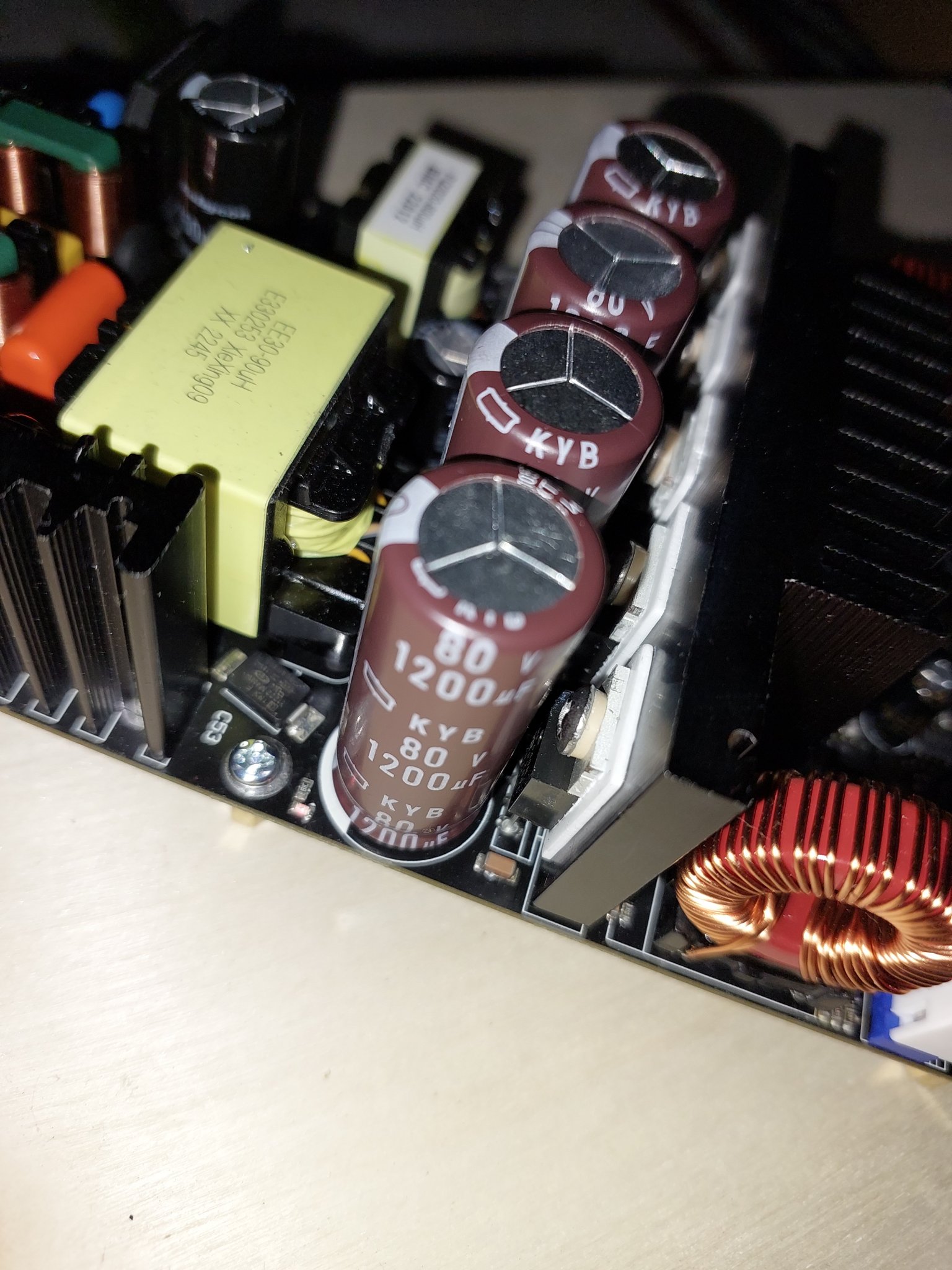

I want to share with you that I didn't regret changing the 4 large reservoir caps that came with the board to Nippon Chemicon KYB series ones which is rated low impedance, high ripple and long life. Please note that these caps have 60V running on them. The graininess is polished out and the soundstage opens up with more air between the singer and instruments. The amp is good but now it is great with this change.
Mouser P/N : E661-EKYB800E122ML40S

Mouser only have 5 in stock, with the next shipment due October 2023!
The main point is explore other 'better' caps after the successful initial power on and running tests. I think caps that can take high ripple and are low impedance will make noticeable improvements.Mouser only have 5 in stock, with the next shipment due October 2023!
The Samxon SK series capacitors that are used on the new black amps seem to be pretty good parts already. If it’s the Samxon name thats the issue I completely understand I think we would all prefer to see Nichicon,Panasonic, Rubycon…etc but then the price would be higher.

Sincerely doubt it is possible to differentiate between those caps in a ABX test.
It is more than likely that Samxon increased their QC significantly after the incident with a bad run some years ago, not taking action = suicide by rumour mill.
Without any data backing the subjective opinion of increased performance, I will interpret it as "expectation bias".

If you feel that the expectation bias gives you better sound I'm all for it.
Nothing wrong with enjoying a placebo effect, the important bit is the perceived improvement.

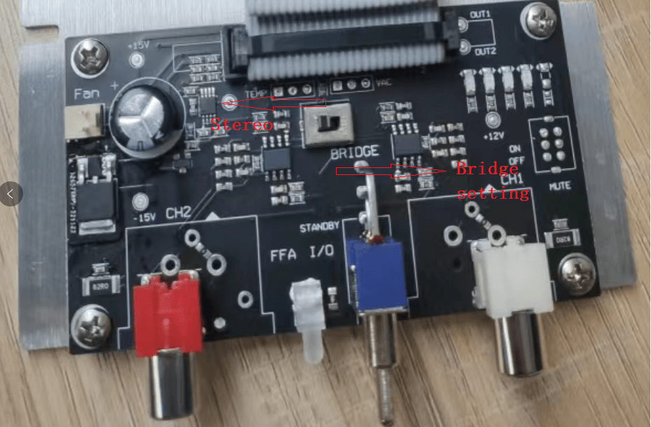

Received my new RCA I/O board at the weekend, thanks. Unlike on the original XLR I/O board, the on/off positions for the 'Bridge' switch are not shown on the PCB. Can you indicate the correct switch positions?
Hi Erica.C
Hi, Adrian
Please check below picture for the amplifier mode setting.

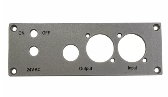

I have the RCA buffer PCB, would you have a mechanic layout drawing (PDF format) showing the distances between the RCA’s, power switch and led. I’d like to have a nice back panel instead of guessing where to drill the opening...😜

Please check this mech drawing.
Thanks,Eric
That drawing only shows the location in the horizontal plane. Do you have a corresponding drawing showing the vertical dimensions?
I do not have this data, I'll try to get the datasheet of these parts here for your reference.

i think Eric is asking for some panel cut out drawing so that he can do proper drilling for the connectors, switch and led. Example,
