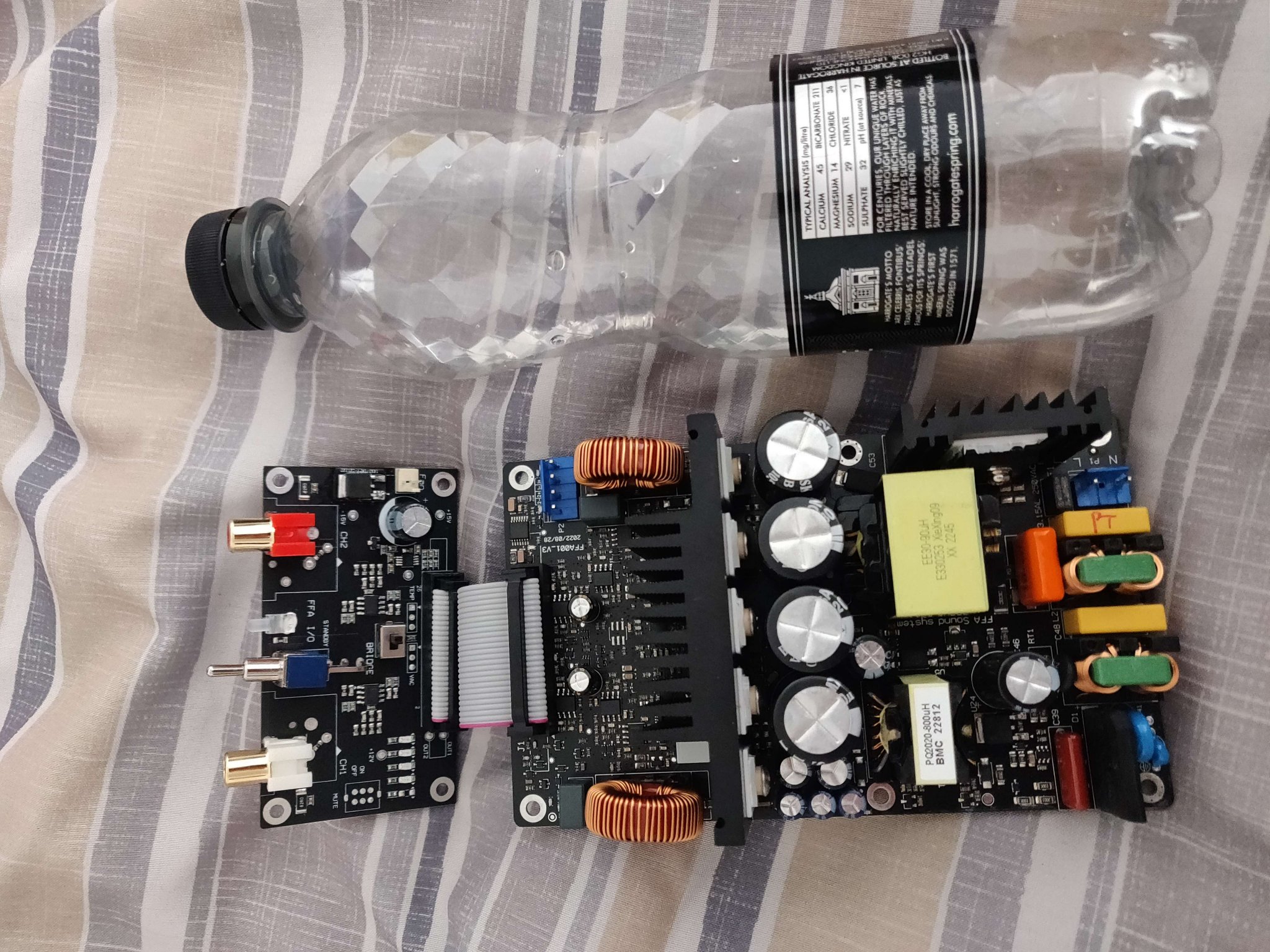

I received mine yesterday, great packaging Eric, thanks.
I had a chance to hook it up last night for a few hours and I was very happy with what I heard. My speakers are efficient (96dB) and my family was sleeping but let’s just say the 1-2W that I heard did not disappoint at all 👍

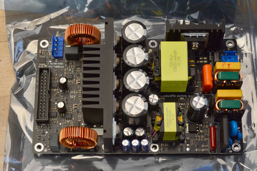

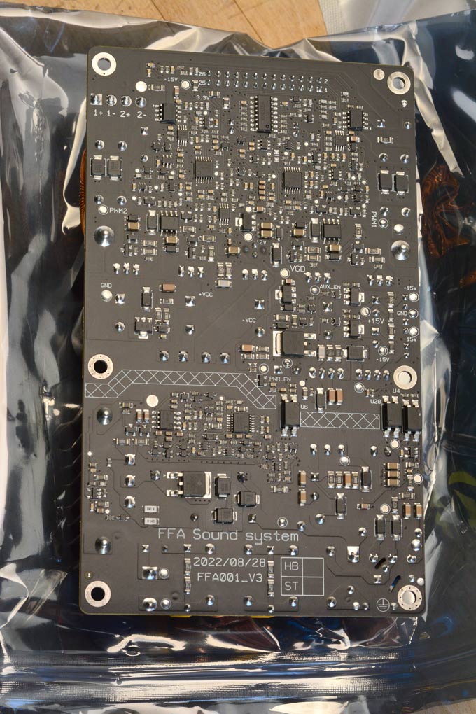

I received my amp today. Spent a long time shoveling in -10F so delivery truck could get in, and then they managed to cram the package in my mailbox 3/10 mile down the road. It was such a tight fit I almost couldn't get it out. But gladly I did and not only was it packed to perfection, it is a thing of beauty. A fine piece of gear which feels and looks light years' ahead of a typical ali-express class D board. Can't wait to get it up and running, but need to get some standoffs first to mount it in my case. Thanks again Eric. A super person to deal with btw.

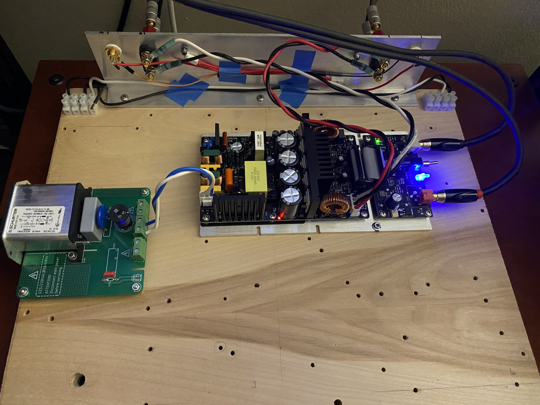

Powered up on the universal test bed, quiet and drama free. First impression: this module has a lot of built in gain, very little volume control with my Iron Pre. Probably best to use a preamp with no gain like a B1 rev.2 or modify the amp module to lower the gain.
I will have to turn up the house heat because this amp only draws 8.5W from the the wall, The Class A that was sitting there sucked up 200W and was a nice toasty heat source 🤣

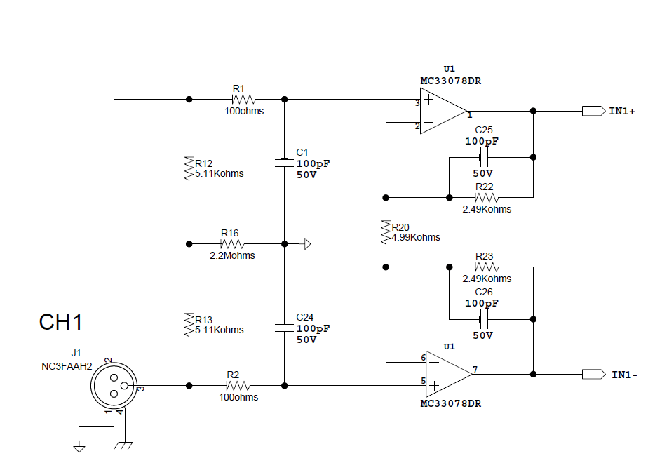

The gain is indeed high. The spec sheet available in this thread and attached here shows a gain of 26db which is typical but I wonder if the buffer pcb also has voltage gain (I’m aware that certain buffer have gain and other attenuate like the B1.
Maybe the designer Eric can confirm the overall gain of the power amp + buffer.
Hmmm....
What about using a different buffer altogether? The BTSB buffer can be adjusted for 0dB, can convert SE-->BAL and uses better opamps. I guess investigating the 28-pin header functions would be the next step.
