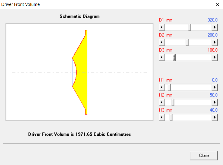

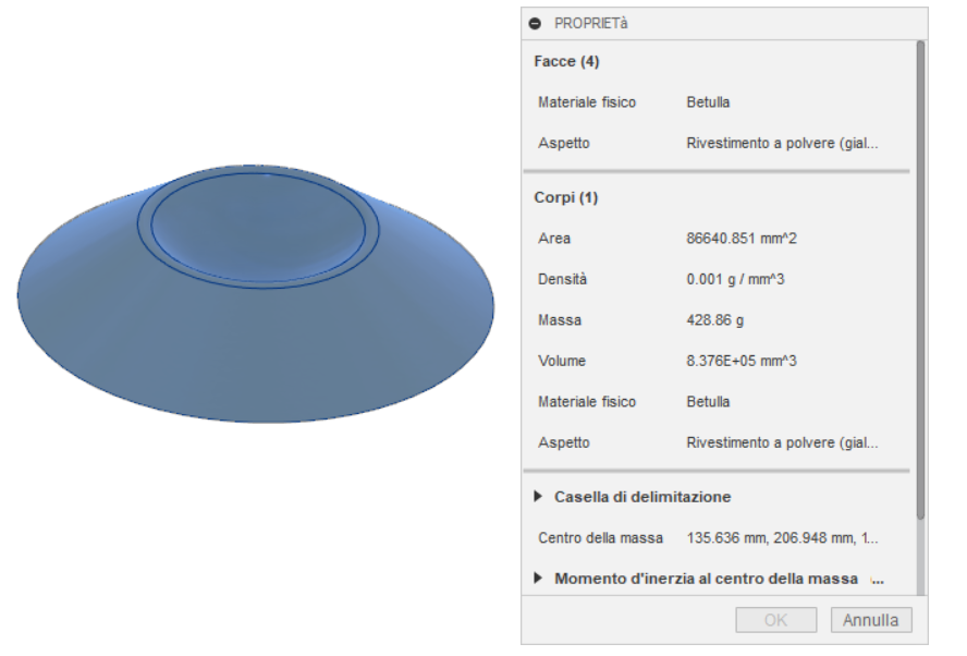

HI everyone!
Sorry but my working week was very busy

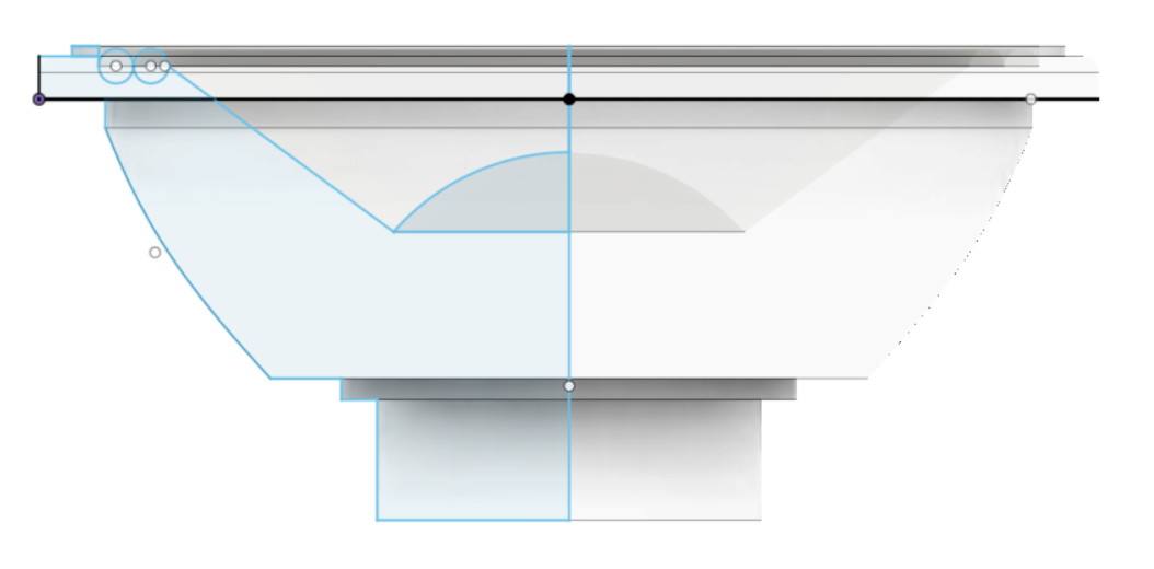

I designed the phase plug measuring real woofer(6mm xmax)and shifting the same cone shape 10mm away but no ports in this time because
I've some questions for HR data:
1.1 If I want to simulate a synergy with reflex ports inside the horn is good to
select "rear vented" and use AP1 and Lpt for this front reflex?
1.2 If yes is ggod to select an "acoustic path lenght" in "combined output" menù with the difference od distance from rear of the woofer cabinet and mouth?
2 what really are VTC and ATC? I used already seen values from another thread...
Maybe I can not translate well hr info

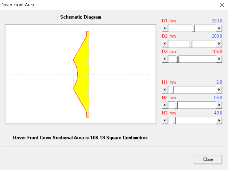

3 I simulate the rcf front volume and cross area
volume is 1970 cc
area is 104 sq cm
my phase plug volume is 878 cc so my atc will be 1970-878=1092?
4 last but not least
how can I calculate front woofer port inside the horn?
Those will be boring questions for you
sorry in advance
Thank you
Ale

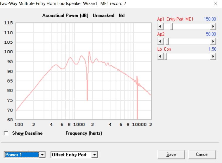

MEH WIZARD HR

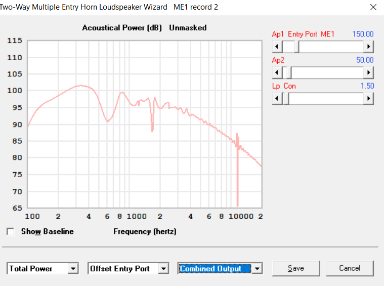

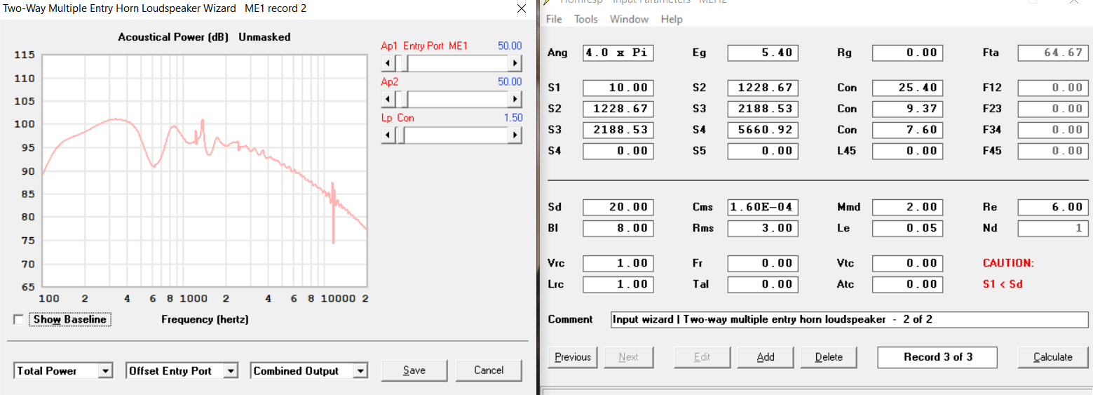

HI
I've tried with "meh" in "input wizard" after reading the manual
my version of HR is 52.40
I simulated a tweeter response with thiele small parameters found on the web beacuse b&c not give t/s for dcx464.
I have a bad notch in 1000-2000hz range when I simulate only tweeter power1
and it changes when I change AP1 and AP2 woofer front port.
If I simulate reverse conical front port with ap1 150 ap2 50 the notch is very bad. with cilindrical (I would use 15mm baltic birch) I don't have the notch.
In this case HR simulate some interferences of front port in the horn flare?
I made some errors inputing some parameters?
thank you
Ale

It's the whole 1/4 WL notch thingy, which says you'll get a deep null in the mids (low/mids in our cases), at the 1/4WL distance port to throat.
So to keep the notch above 800Hz, 1/4 WL math says keep the port within 10.8cm of throat....and is dang hard to do, huh....?
The phase plugs you built are the common way of trying to milk some higher response. Again, nice work.

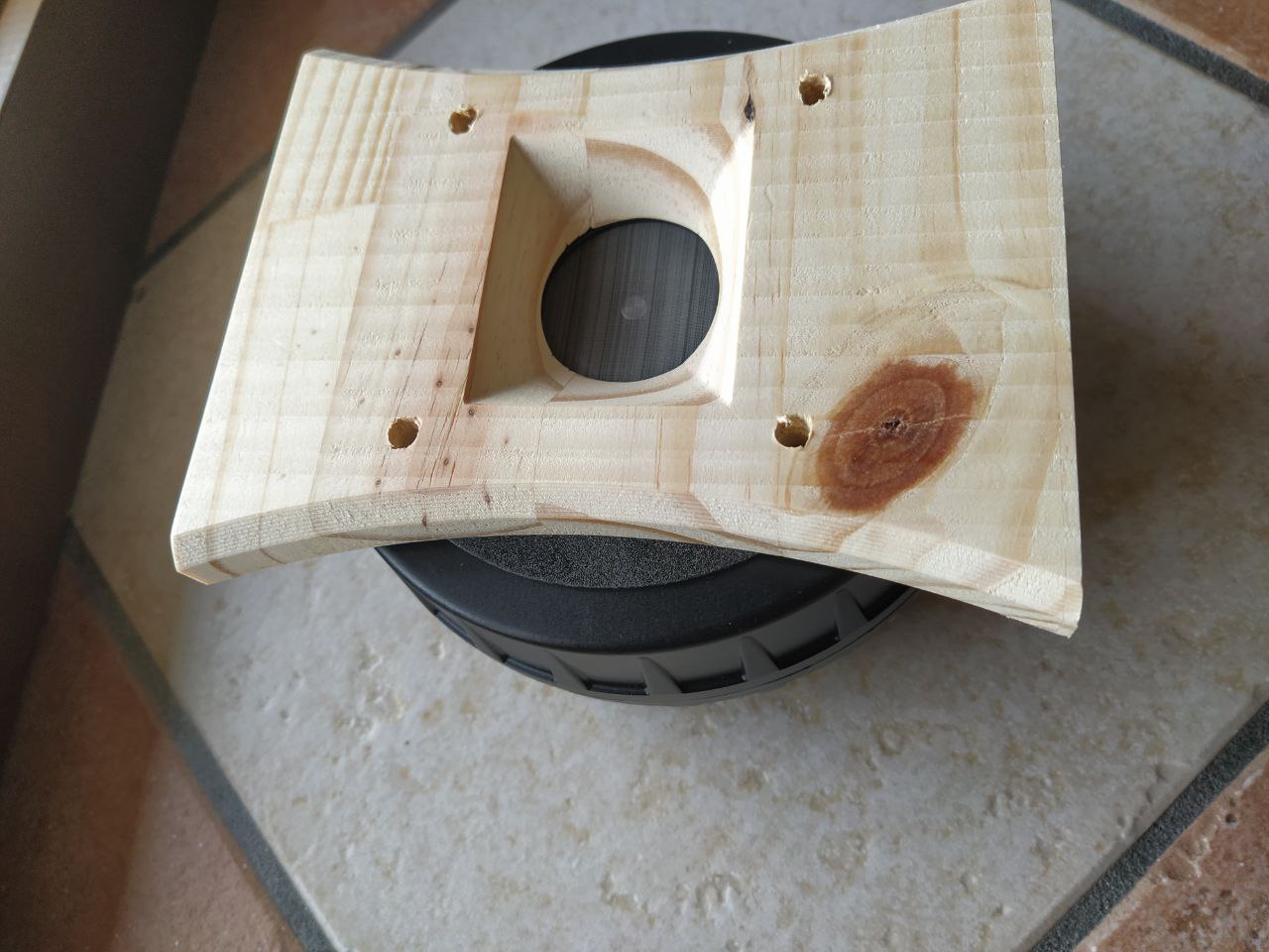

Thanks GM. I'd like to put a 12 or 15" coax in a front horn box with pattern control down to about 100Hz. I know that's going to be very large. It's for voice only, but I want to keep the the pattern out of the actor's mics. I'll do some Hornresp work and start another thread.

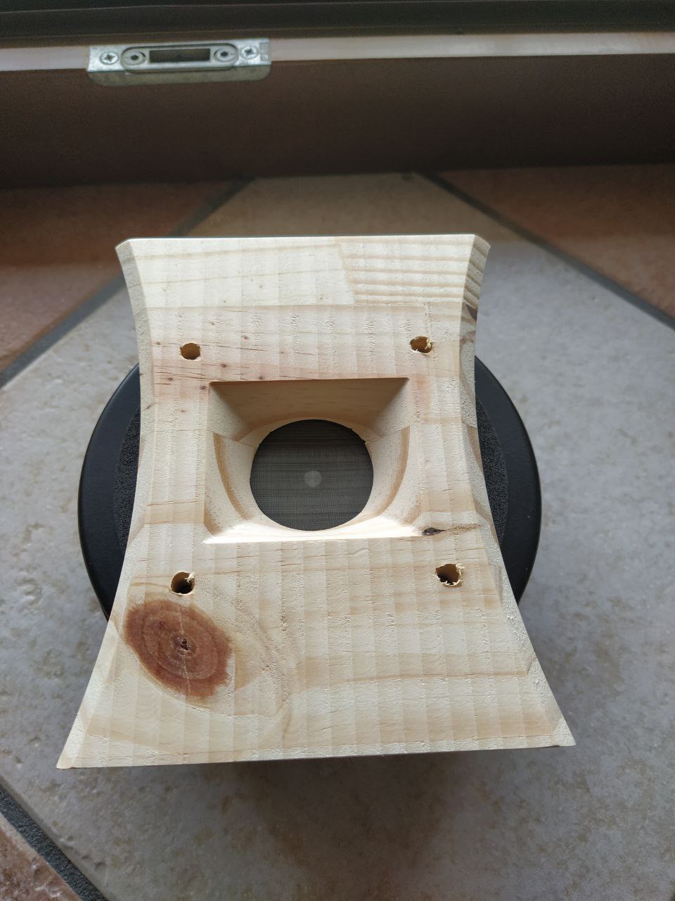

Hi
thanks Mark for your answer.
Meanwhile I milled a test tweeter mouth from spare wood to check the roughness and is perfect winhout sanding. in attached picture
With C lateral shapes I can move woofer very near to the hi's.
This week I will buy the baltic birch and start to mill!

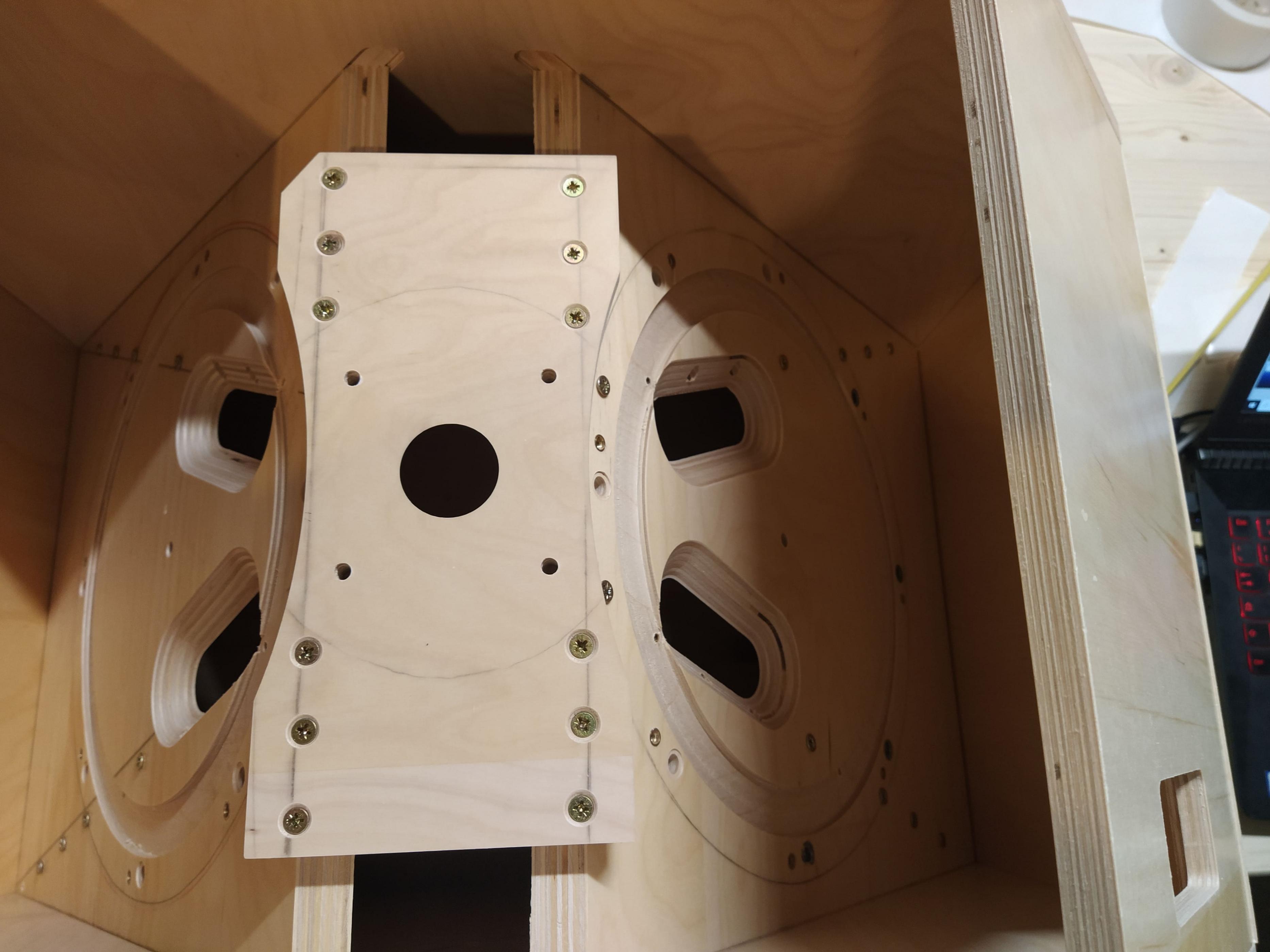

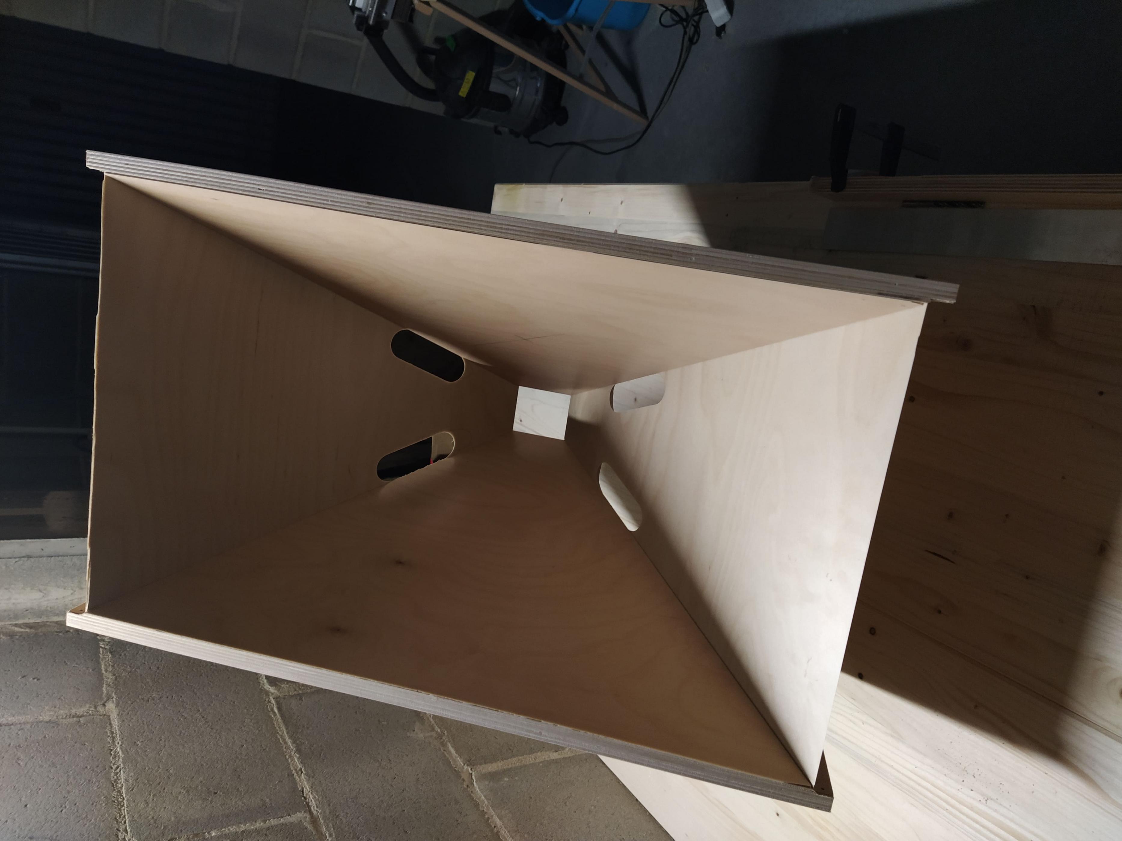

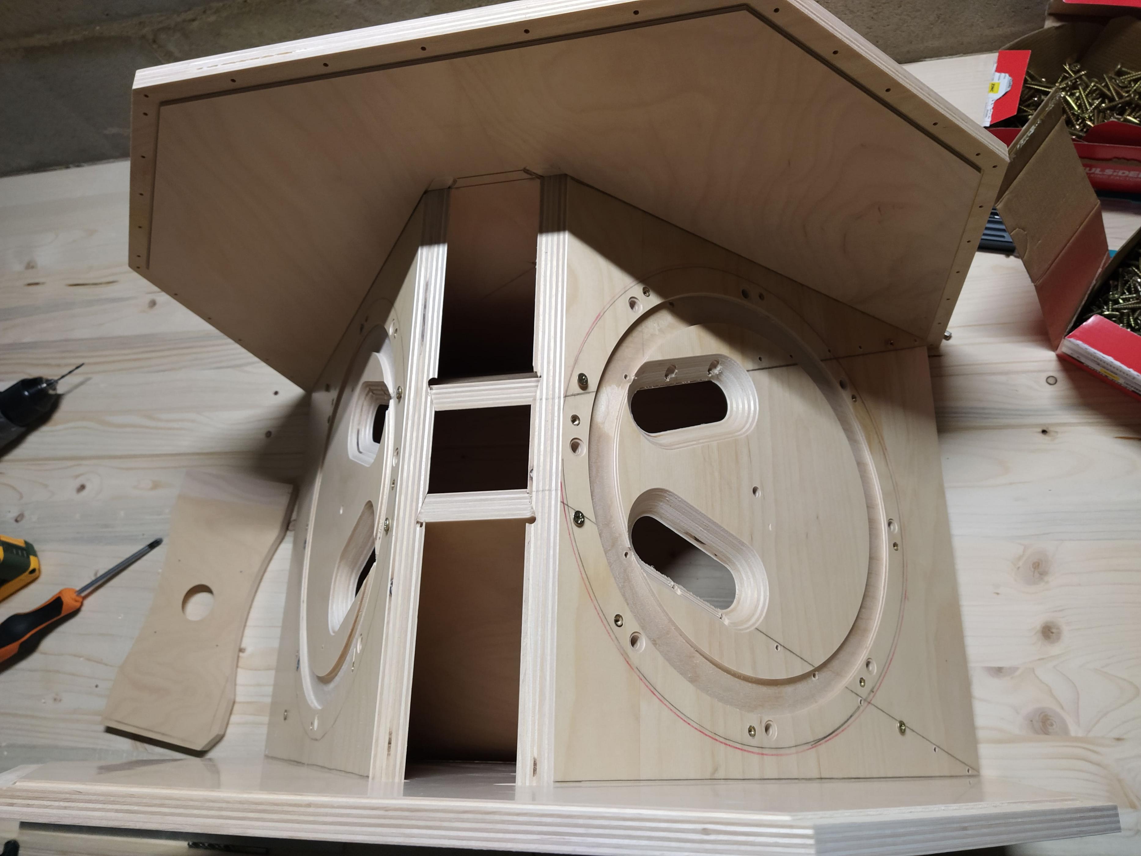

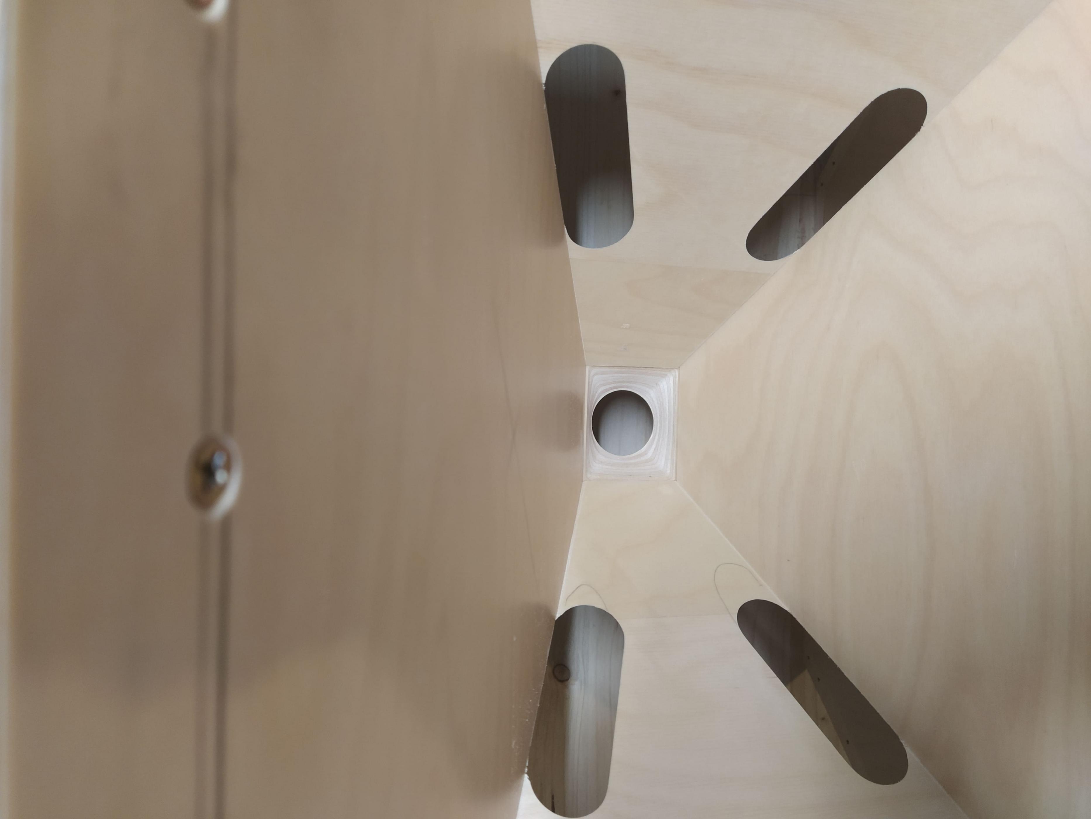

update
hi everyone!
I was very busy
I post some building photos of the first top only for testing: no glue.
i tried a method a strange method to seal parts maybe is already used:
milled canals in joint for o-ring like seals like idraulic cylinders and engine heads. what do you think? is good for testing without anomalies in spectrum or distortion-phase problems?
I think I spent more time doing this cuttings with cnc than if I had done with a simple saw

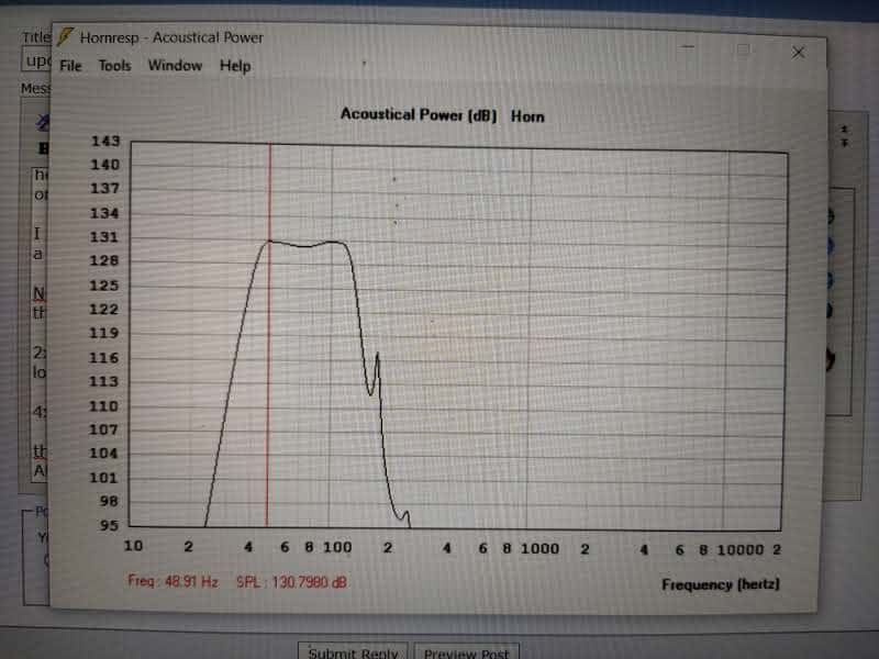

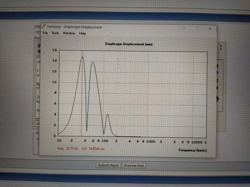

Now I'm thinking about the subs:
the empty space in my car is about 1000x650x550cm so i'm thinking:
2xtham15 loaded with beyma 15lex1600nd 1600w rms 14,5mm xmax
look at hte simulation
4x small br cabs with at least same spl of the thams? any suggestions?
thank you guys!!
Ale

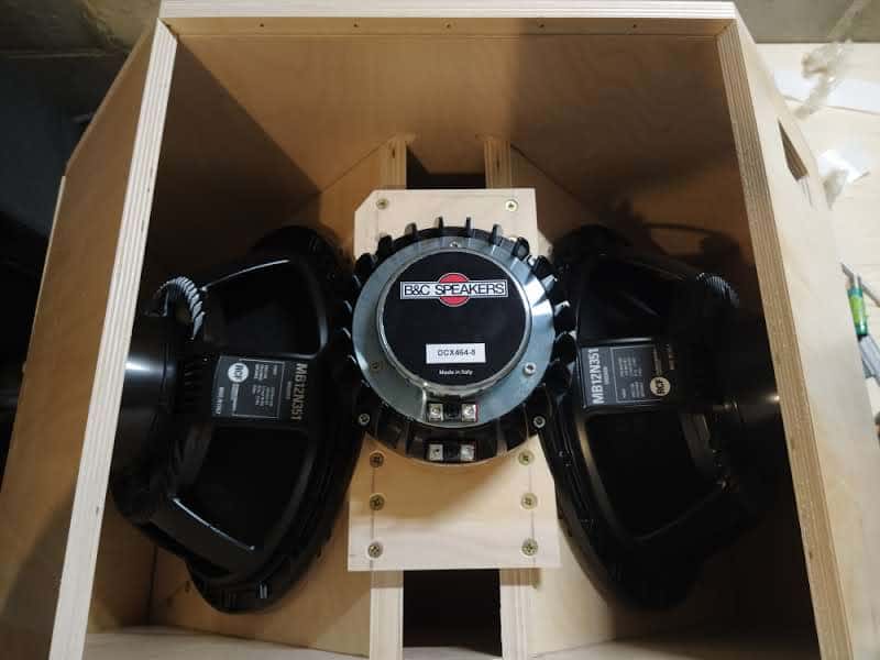

Hi Ale, your build looks great !
The precision shows. Makes me wishful for some CNC capability.
Sorry i missed your post/ amp question from June.
Yes, i think that amp will work great with the mb12n351's. I use a PL340 with 1250W @ 4 ohms on a pair of them.
I've been comparing them to Faital 12pr320's on a current syn project and like them better. But their stronger motor adds about 1.75 kg each, and adds more weight than the project can bear. Sigh...
The throat adaptor you made looks especially cool.
Also like your idea for temporary construction. It beats mine of just using drywall screws to hold the horn together until i'm convinced the ports and such is right.
Good news is that i've yet to measure any improvement between the temporary screw job, and permanent glued-up joining.
(Unlike subs where it usually makes a ton of difference.)

With maybe 2 18sw115 or 2 lavoce san184.50 (vert Hood simulation)
I Remember Mark made some ppsls.
Any suggestions? My rear car space Is perfect for 2 tham15 so 360 360 Total.
Hi
I'm finishing the detachable secondary flare and I'm ready to test.
Meanwhile I'm trying to know which sub(s)
I Need for those tops.
Now i have in mind 1 2x18 ppsl 200l net for 45-120hz at 138db at peak Power.
