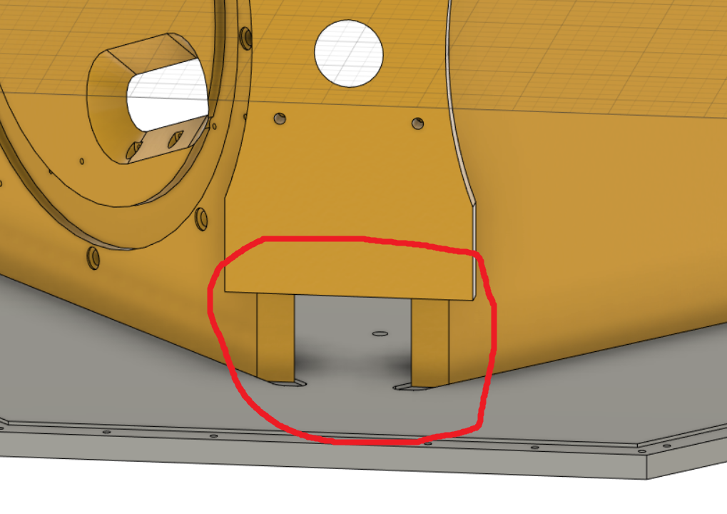

In my synergy I have limited space under the coaxial support. Maybe this(picture) can cause band pass problems or incorrect tuning?

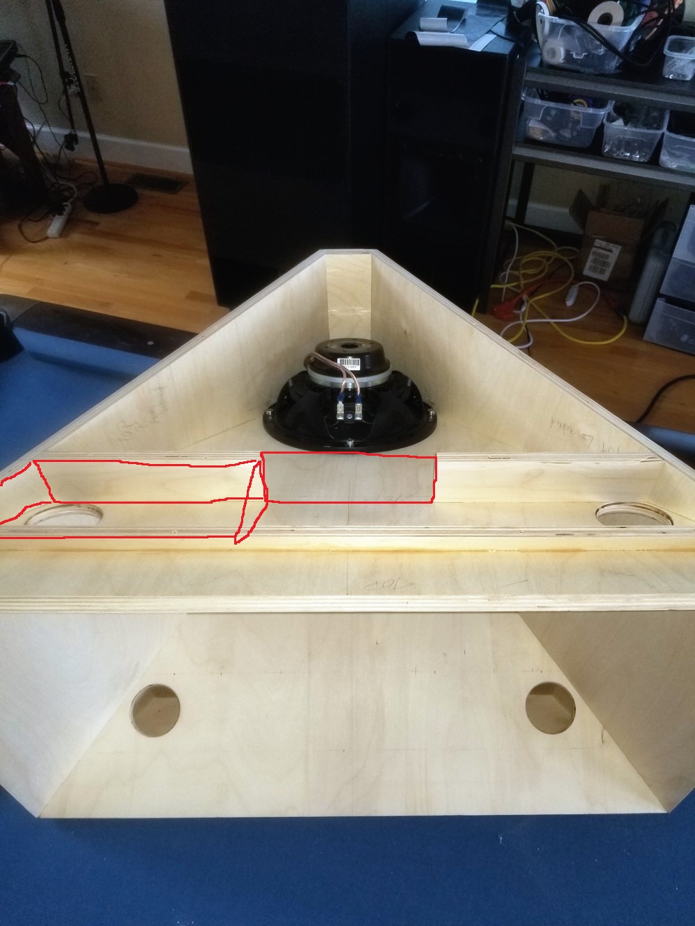

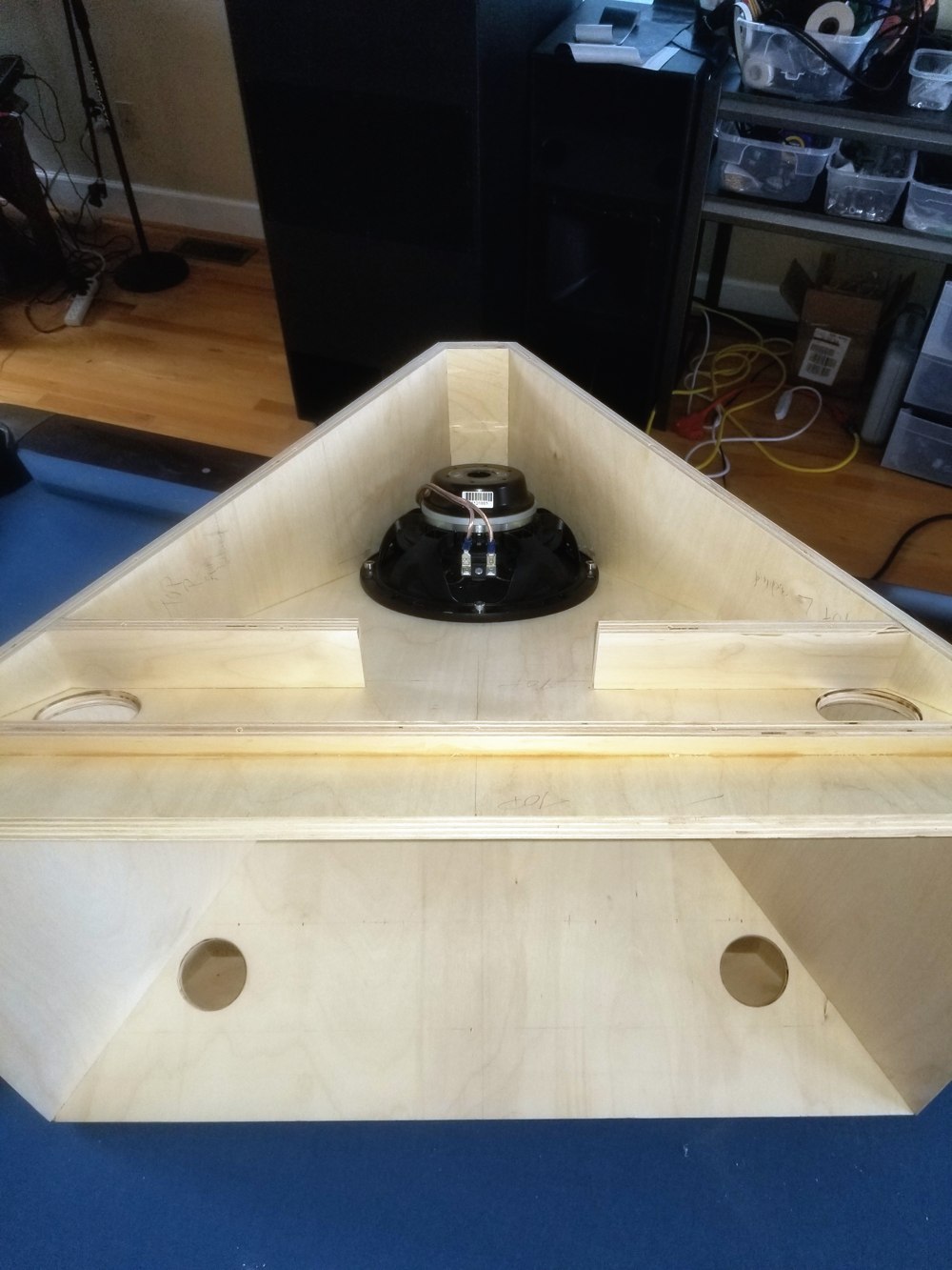

hi Ale,
I've only used BR ports on one synergy, syn8 i called it.
It uses 8"s that simply didn't get down to 100Hz without the ports.
Here's how they fit in for one of the drivers.
The two ports together were about 1/4th of driver SD.
They needed to be out in the mouth....i remember they didn't work so well closer to the throat.

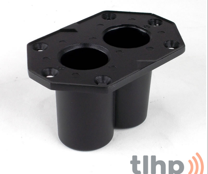

HI
just for info I found a dual angle pole mount, alluminium casting
maybe is useful on synergies. If somebody is interested
Dual-tilt flange (0deg/5deg)

HI
finally 18ds115 arrived. I found those in Italy for 400euros each.
@Mark100
are The red parts in the picture made to gain ports lenght?.

@Mark100

HI
@Mark100
Ale
Yep Ale. The red parts make ducts with about the same cross sectional area as the ports in the horn. (they also help as extra bracing for the panels.)

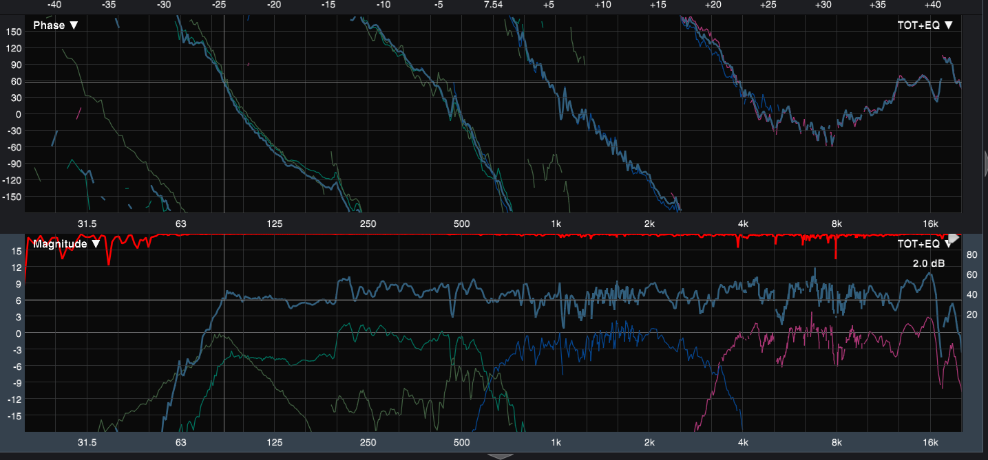

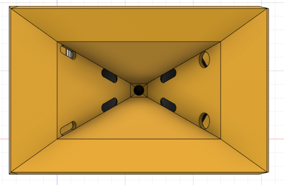

Finally I've made the BR ports mod like the left side of the picture.
Testing results in wrong BR frequency (90hz) even if I simulated 4 ports in winsid (I don't like very much) for 110hz.
Maybe I need only to fill the inside of the box with pink foam like Mark did.
Crossover and delay was adjusted with Smaart looking drivers phase shift and slopes in the xover regions and is ok, No holes or strange dips.

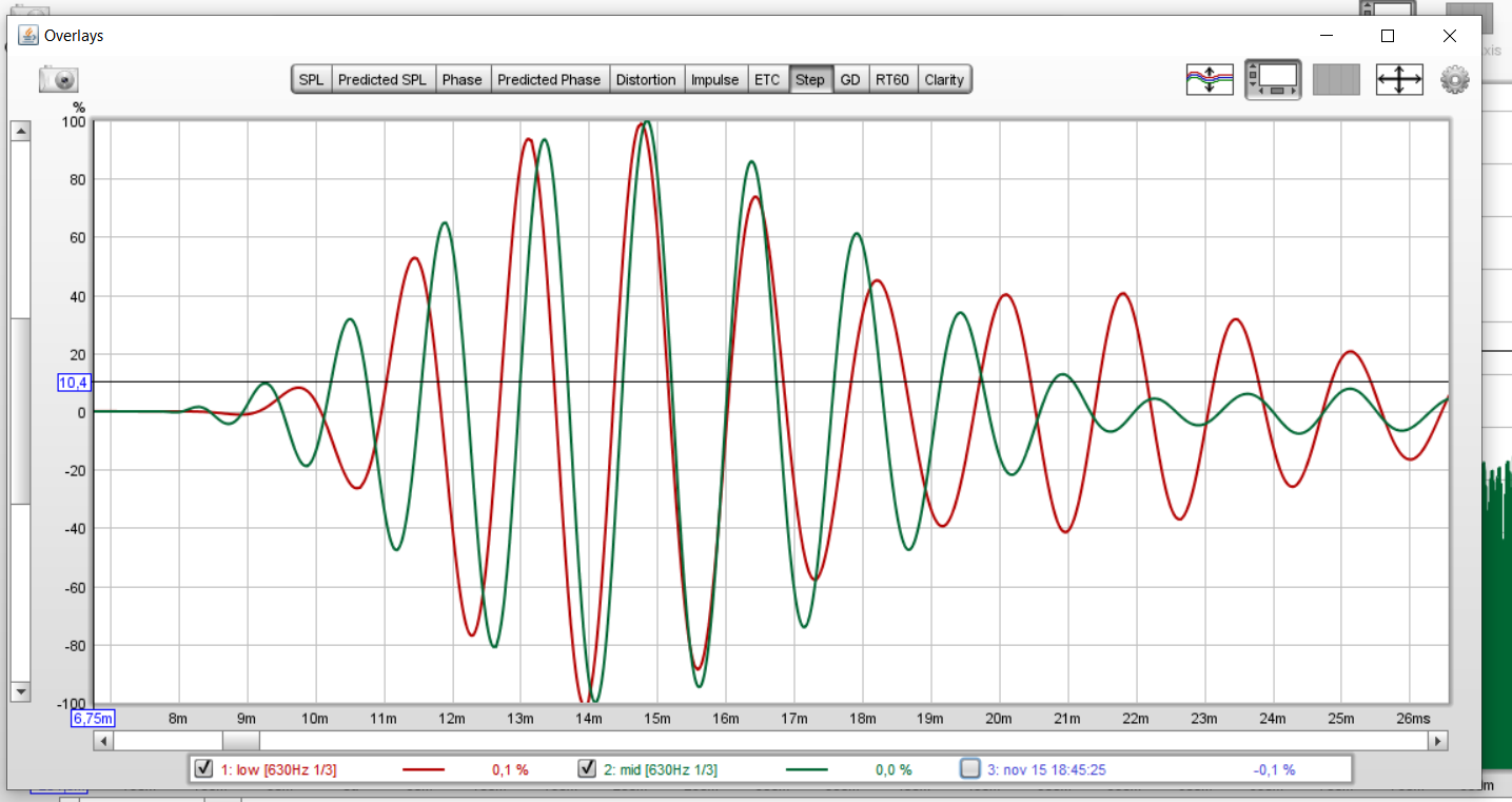

The only strange this I put a little delay (0.30ms) to the woofers so I
did another step response in REW with xover activated. Maybe I'm in phase but some entire cycles behind.
I've filtered impulse both lows and mids at 630hz but it seems one of the impulses is streched and not only delayed. Same thing is I change frequency on both.
I't seems like doppler effect

Ale,HI
The corner port location makes their effective length longer than would be simulated if wall proximity was not accounted for, so their area must be increased to raise the Fb to your desired frequency of 110Hz.
Not sure if I'm reading your chart correctly, but looks like the bass reflex ports are also passing a fair amount of (out of phase) content in the 500 Hz region. That content would clean up by lining interior reflective surfaces around the speakers with fiberfill or sound absorbing foam.
Fiberglass insulation is often pink, and works well (other than the itchy dust..) but most pink foam is closed cell, and would not be what you want to absorb the out of phase junk coming out the BR ports.

Pelanj,
I think it is more likely that your "Klingon war ship" cone volume fillers are resulting in a larger VTC than you calculated, resulting in more of an acoustic band pass than anticipated. That said, your injection ports are also conically shaped, larger on the cone side than the exit size, don't know if you are, or may model that in Hornresp.

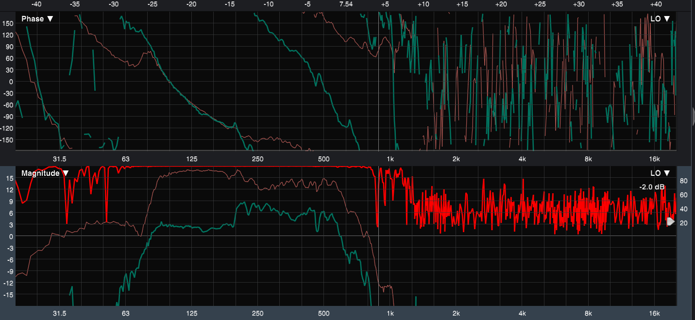

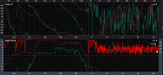

Hi
In my case I've found the lows are falling down too early and I don't like because for PA use I would squeeze the mids without knocking the membranes aganist the rod because of too low frequecies.
I could remake the vertical flares with this changes before glueing definitely:
1. mid ports structurally closest to the coax(I can move closer about 30mm,the suspension width)
2. make smaller mid ports( but today measuring inside the port i found the high roll off is the same measured at horn mouth, and the 100-200 region is good)
3. add aerodinamic cone fillers (glued one piece hardfoam).
4.move reflex ports closer to the cone baskets.
5. Make cone and reflex ports teardrops like relatively to the distance from the troat.
Maybe some points are useless?
I'm very happy for the results at this point but I feel I can get as much.
Ale
red is mic inside mid port.
green is at the horn mouth
