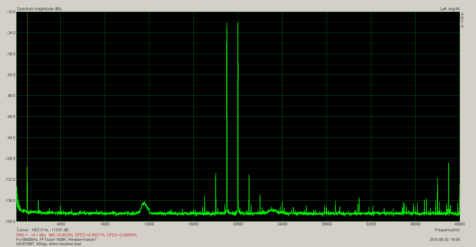

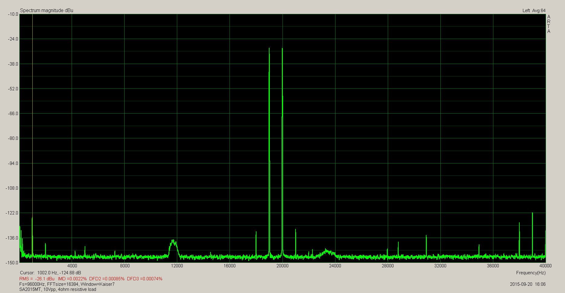

2stageEF high performance class AB power amp / 200W8R / 400W4R

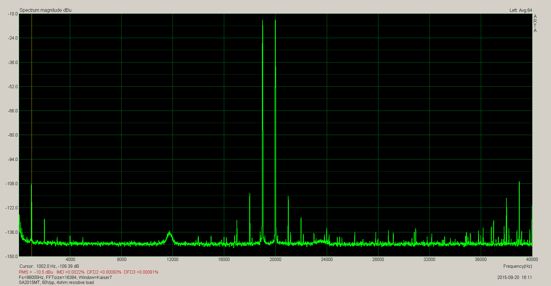

2stageEF 50W MOSFET - aka SA2015MT

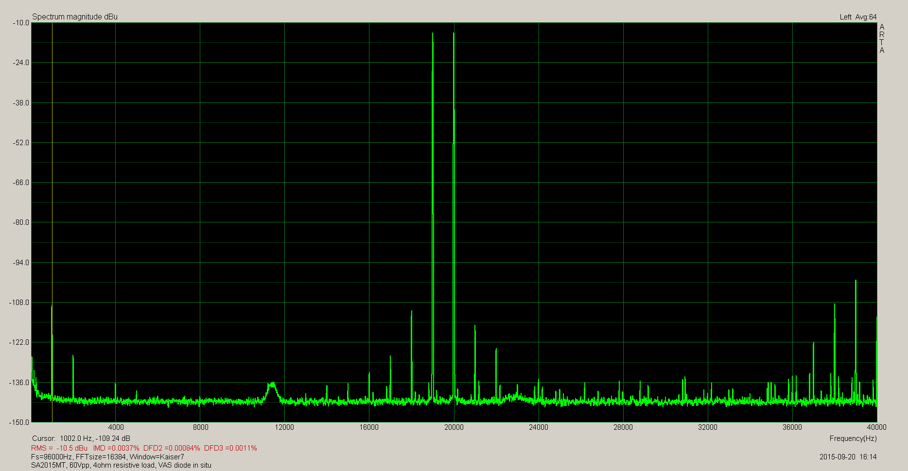

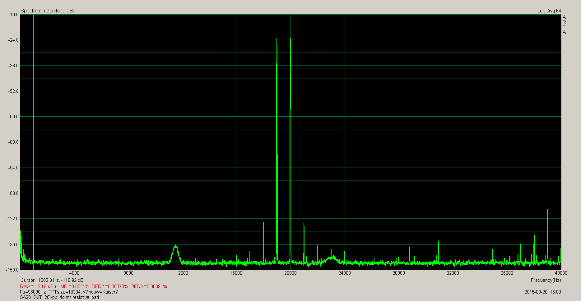

IMD measurements
No VAS diode installed, 4R resistive load:
0.0022% IMD @ 10Vpp @4R
0.0021% IMD @ 20Vpp @4R
0.0020% IMD @ 40Vpp @4R
0.0022% IMD @ 60Vpp @4R
BR, Toni

All really good results.😀
Thx! Some ppm better distortion figures are from your tip to actively drive the LTP cascode. Thx here too!
Hi Tony. How much of a negative impact does the vas diode make on the circuit performance.
Some ppm extra THD especially on higher loads @ higher frequencies.
You can omit the VAS diode, if you don't take care on best VAS sticking behaviour. The overall performance is very good even with VAS anti-saturation diode installed.
BR, Toni

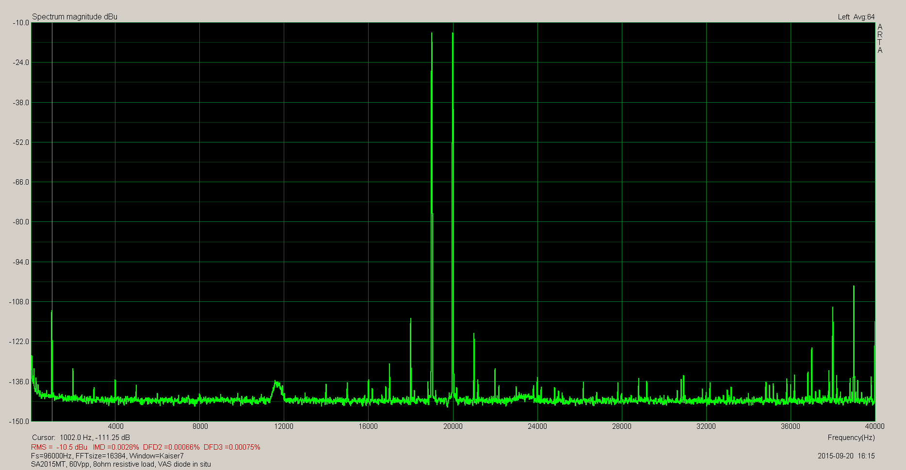

With VAS anti-sticking diode installed:
0.0028% IMD @ 60Vpp @8R
0.0037% IMD @ 60Vpp @4R
BR, Toni

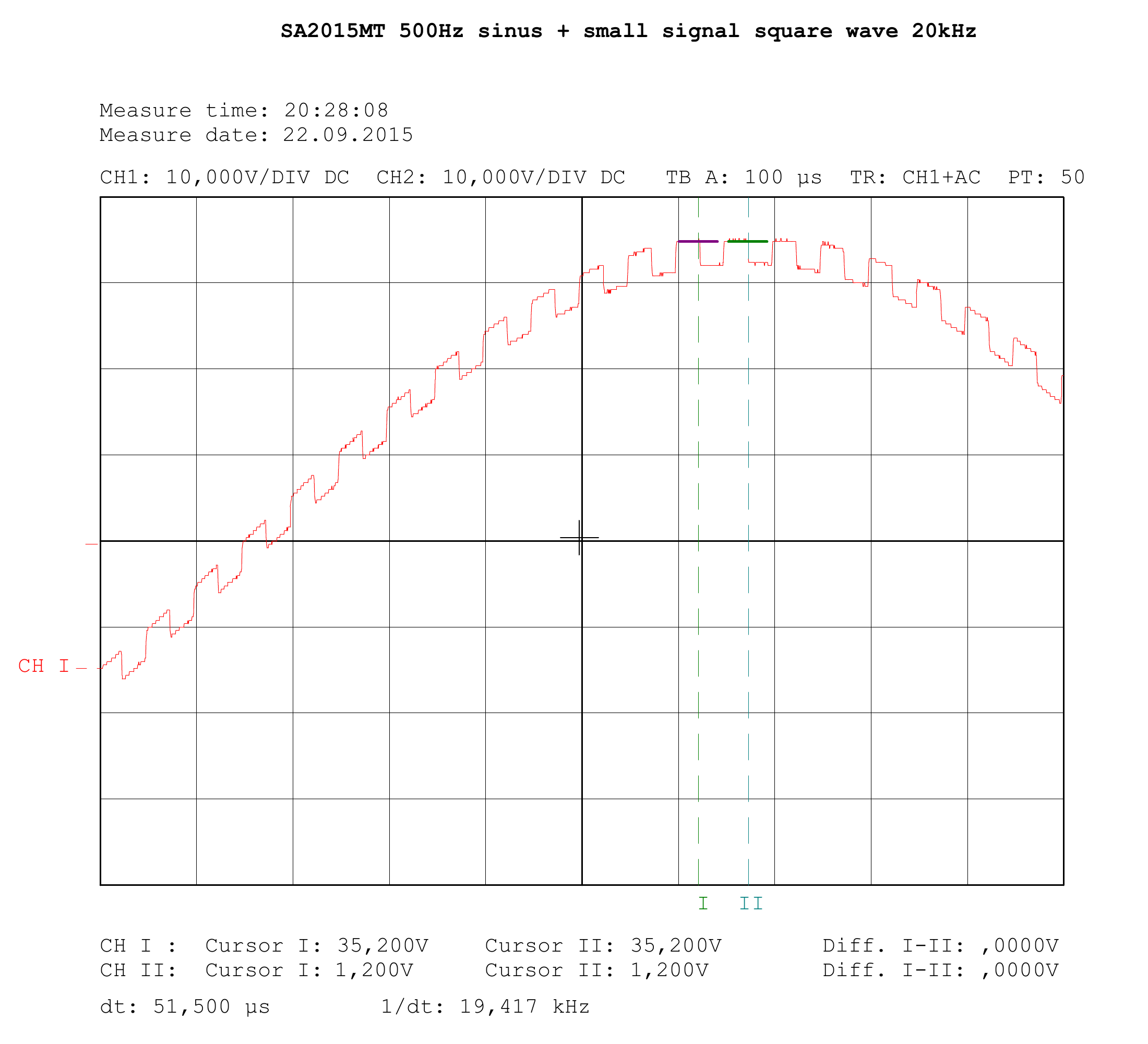

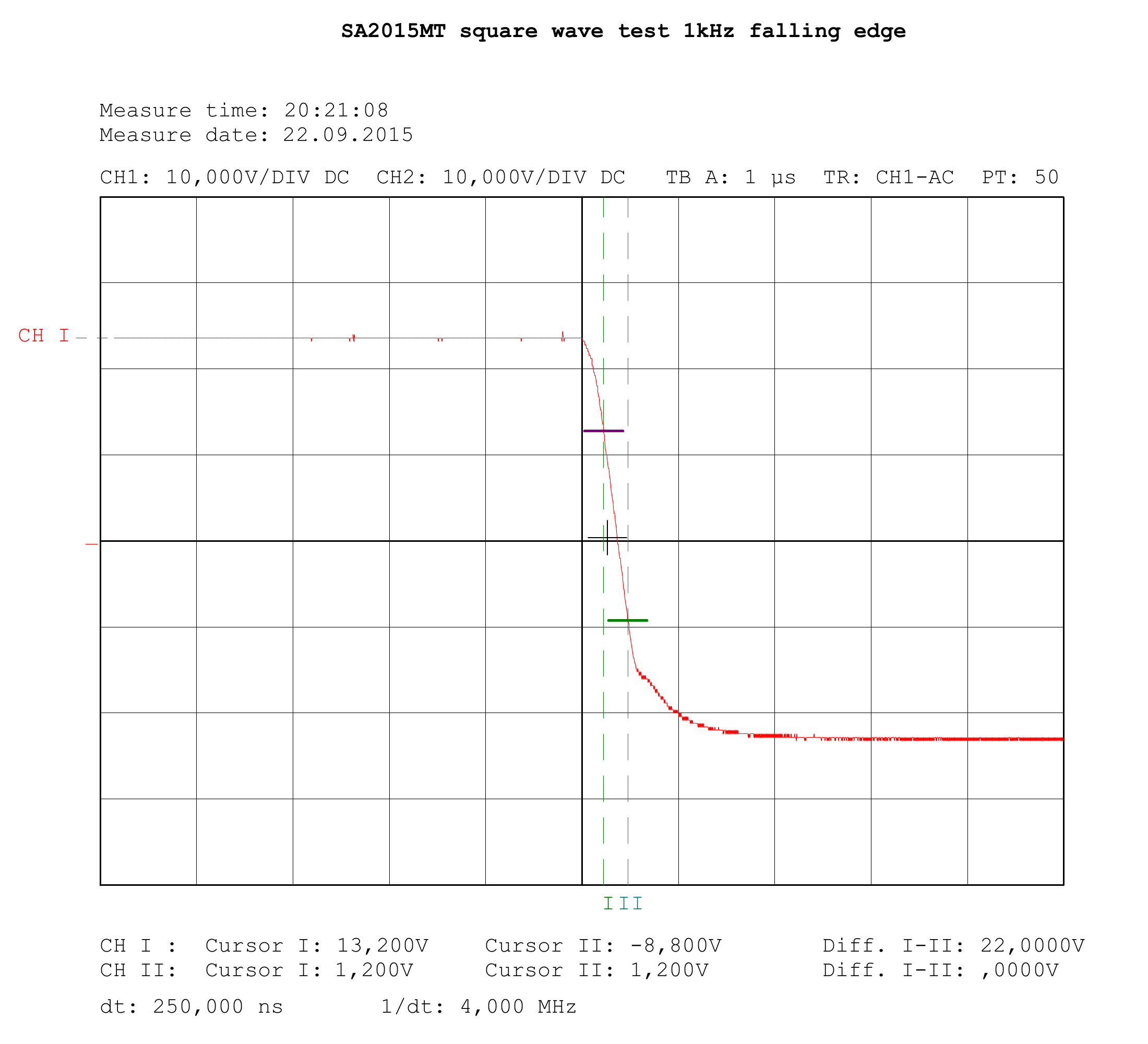

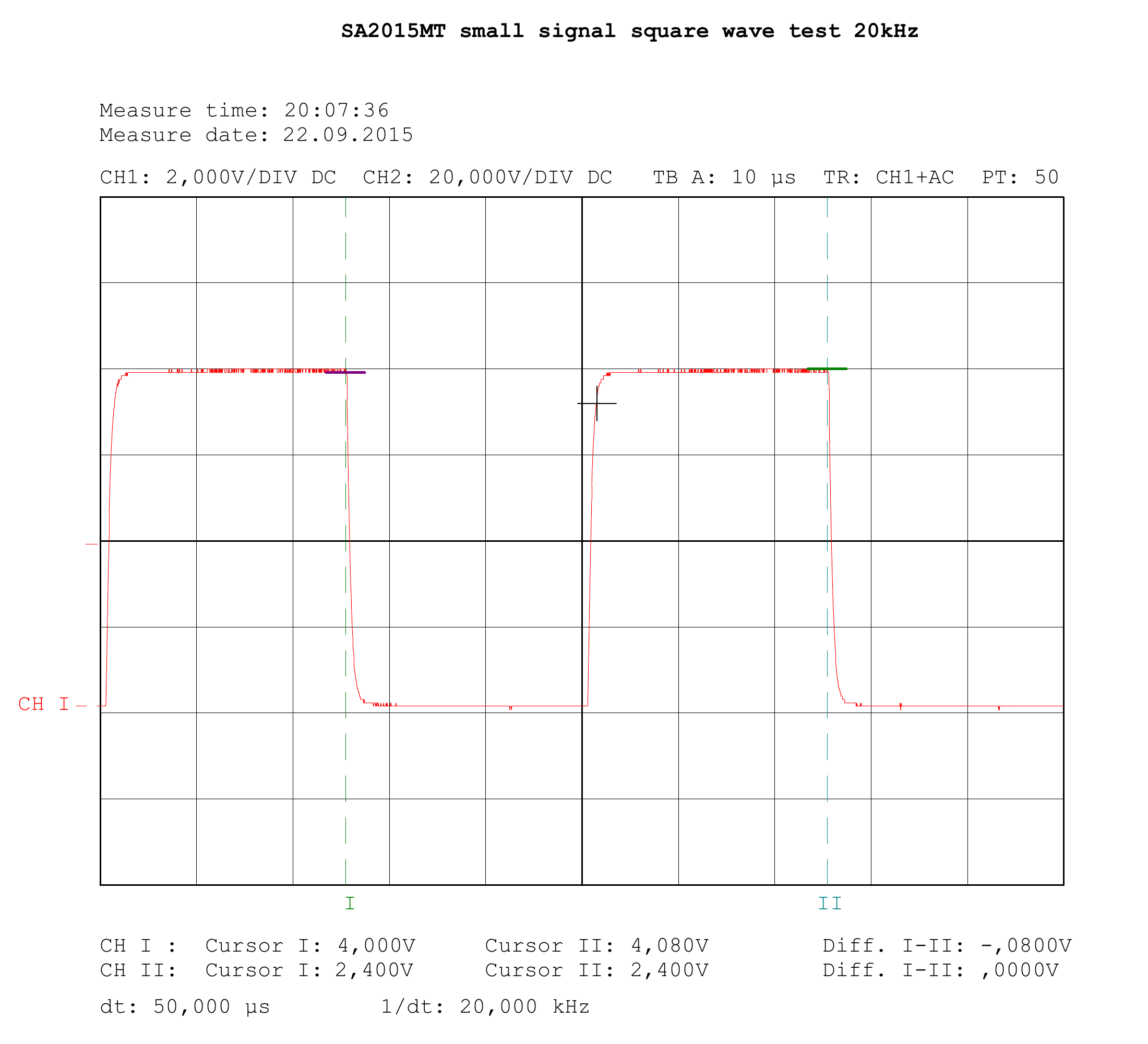

more measurements ...

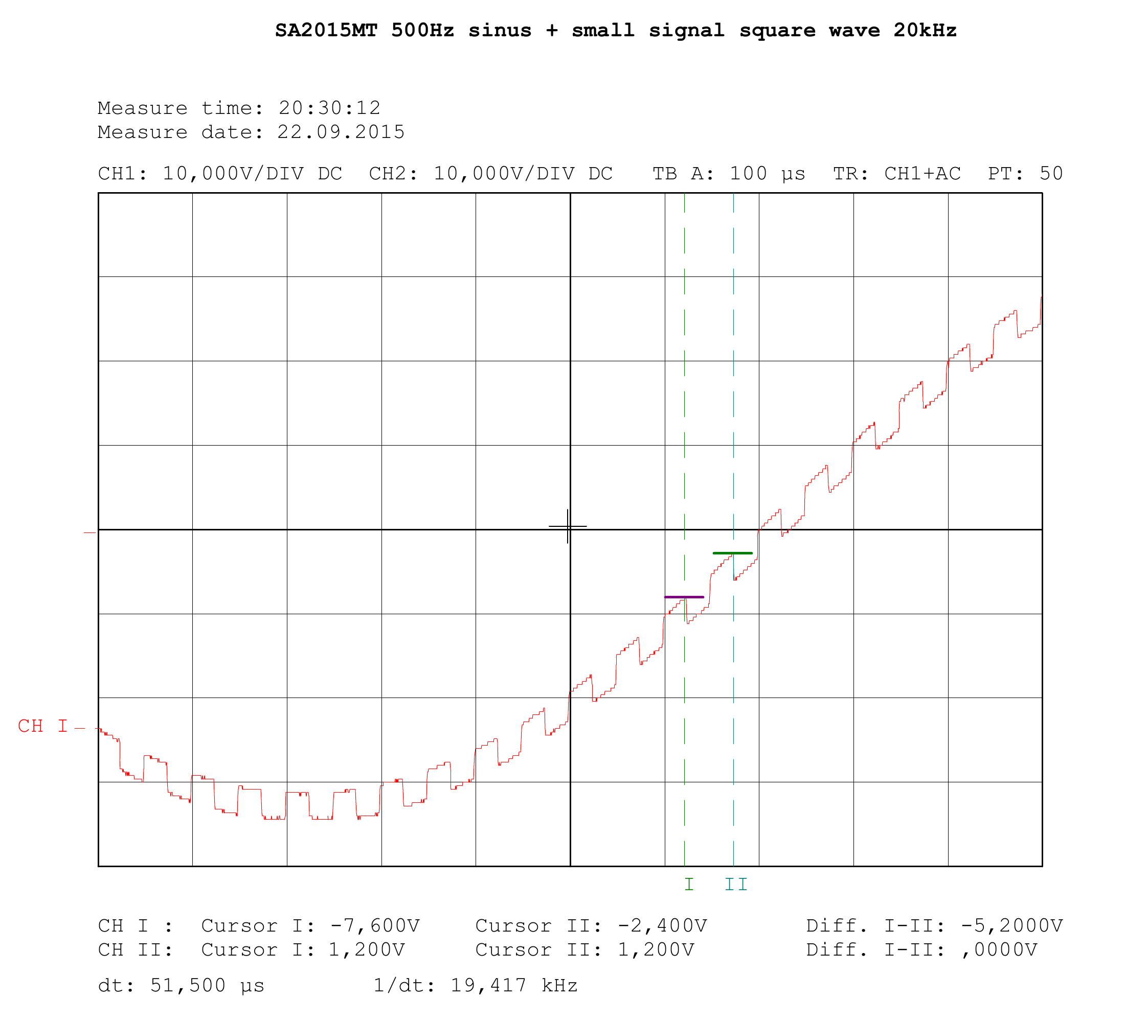

How did you get that sinewave+small square wave test signal?
What equipment, what method?
  • sinus mixed with square wave generated with ltspice
  • created a measure script for ltspice to get data points
  • recalculate data with perl program and export to CSV
The CSV can be imported to the Hameg HMF2525 digital arbitrary function generator.
Have a look also at post #852.
BR, Toni

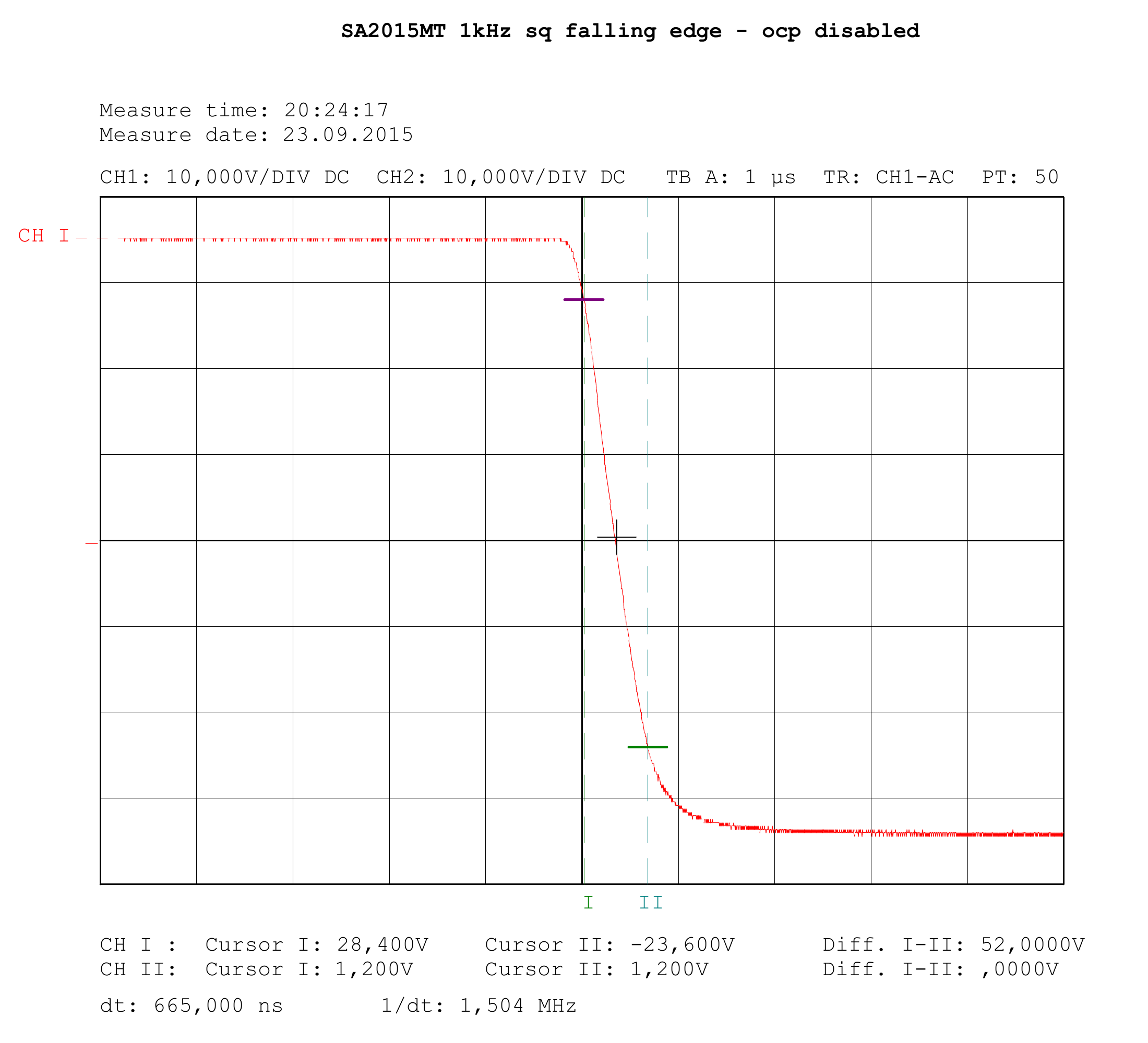

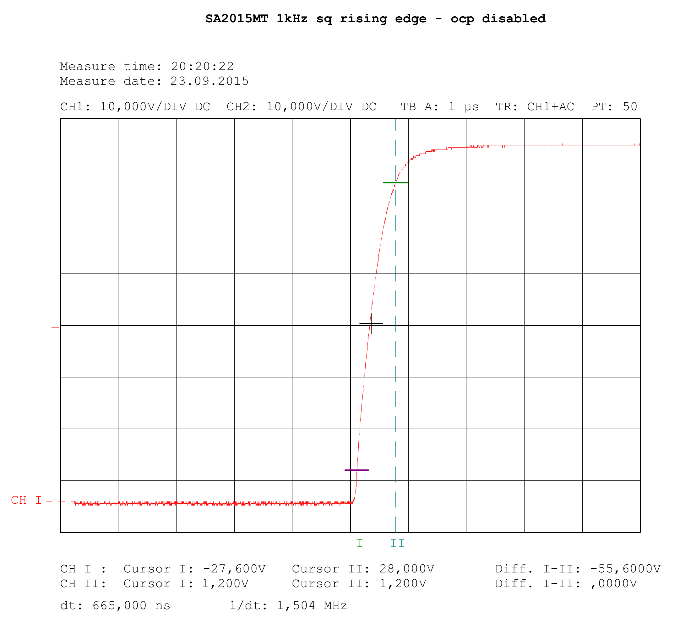

1kHz square wave test reloaded ...
  • IPS filter in situ
  • VAS diode in situ
  • OCP disabled
  • 8R resistive load
The more I test the more I like this amplifier! 😉

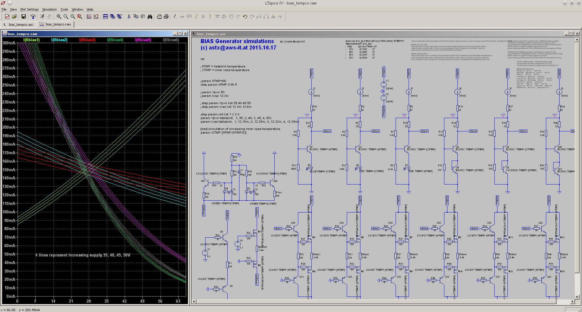

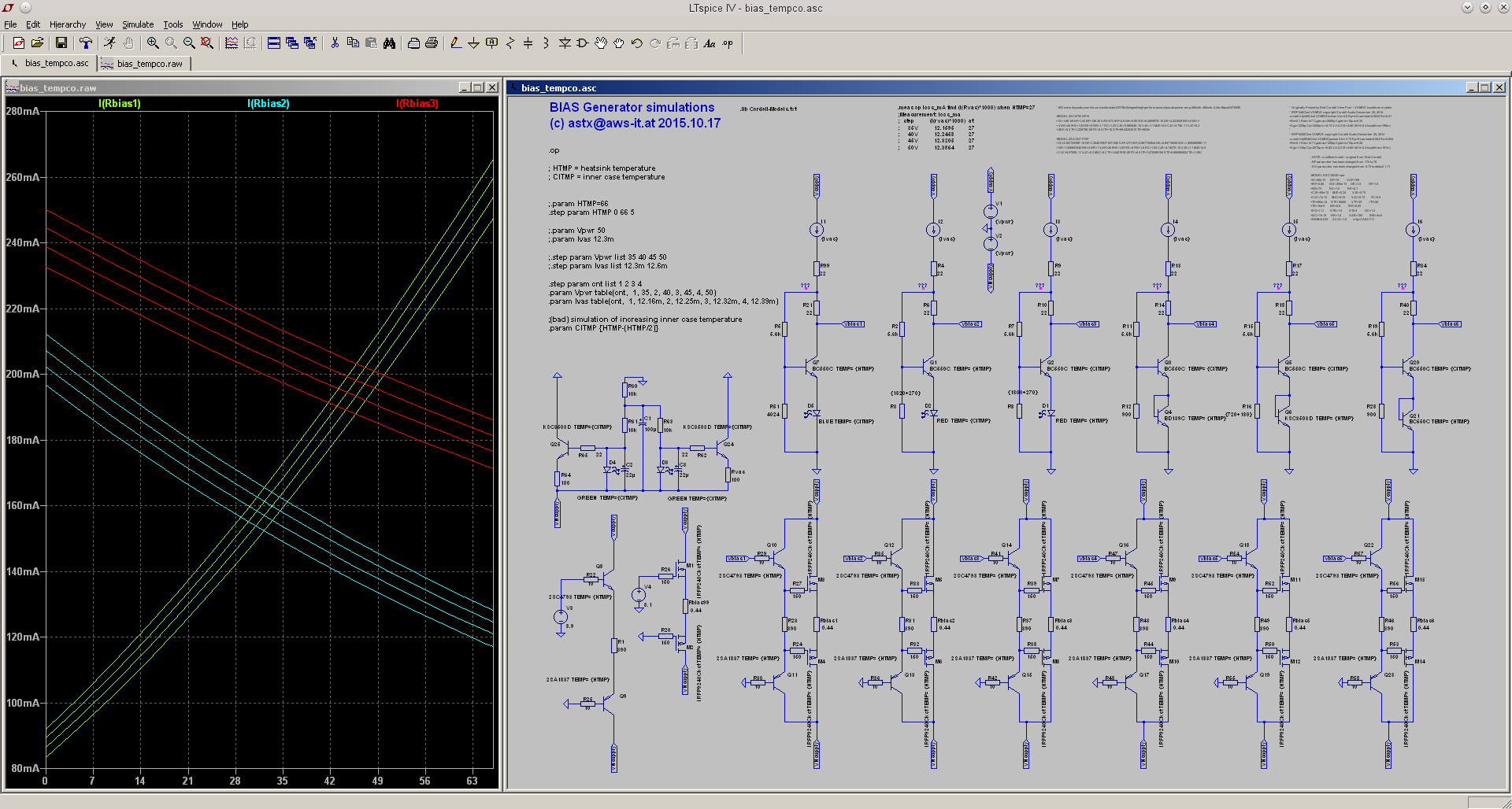

2stageEF 50W MOSFET - aka SA2015MT / BIAS Generator reloaded
Have done some bias generator simulations to better understand what happens when
  • power supply voltage increases from 35 - 50V
  • heat sink temperature increases 0 - 66 degree
  • case inner temperature increases when heat sink gets hotter
For SA2015MT I will use bias generator #2 - BC550C flat surface mounted on heatsink with red LED diode mounted between heatsink and PCB.
Real life measured:
Bias current is stable within < 5% from 24 degree to 60 degree heatsink temperature.
Bias current increases linear with power supply voltage from 35V to 50V.
BR, Toni
