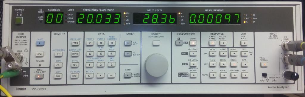

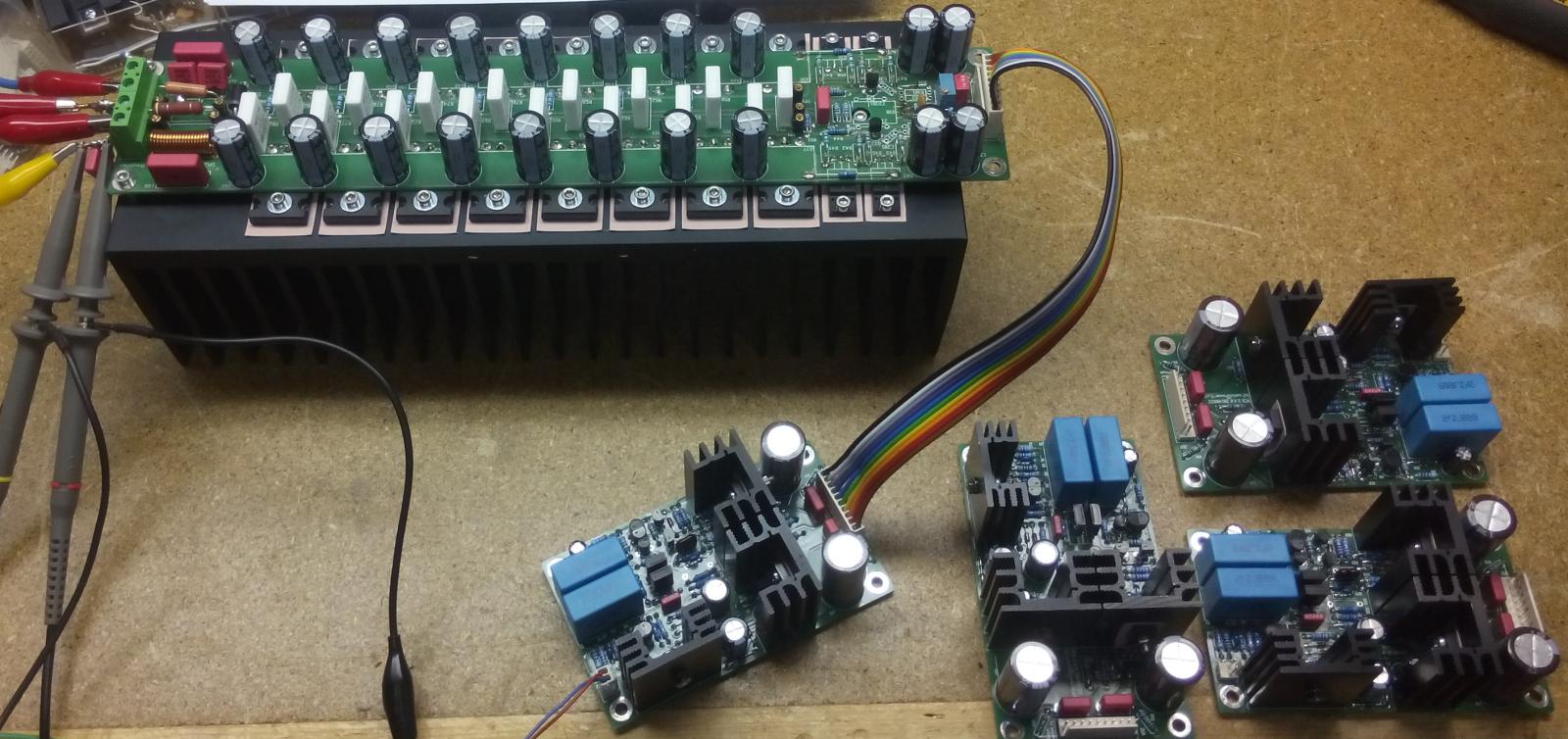

... just finished 4 pieces of input vas modules v3.4
All 4 modules are working out of the box without any problems. 🙂
All 4 modules have nearly identical distortion figures.😉
Attached a distortion quick check:
0.00097% THD+N 20kHz @ 100W @ 8R
BR, Toni
BR, Toni
