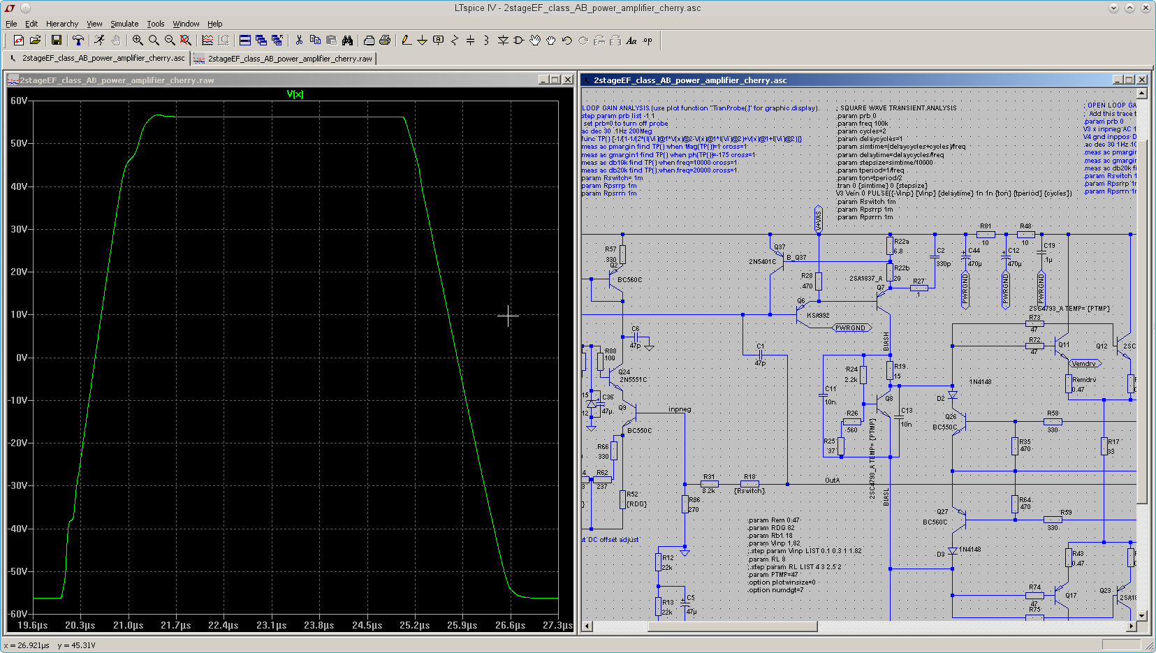

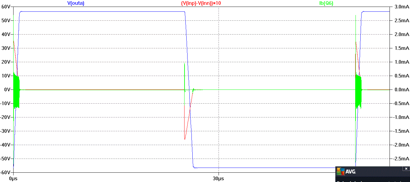

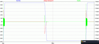

Kean, thiis is a sim of unlimited BW square at outA (before the Zobels etc) Blue curve.
I also show V(inp)-V(inn) magnified by 10x in Red. The voltage across the LTP i/ps is nearly 4V 😱 during the slewing period. It hasn't quite limited so this would be called 'soft slew limiting' but the square wave is definitely non-linear during these periods.
The Green curve is the base current to the VAS input Q6. During the +ve slewing period, the amp has lost control. When the conditions are such that the burst of oscillation extends onto the flat part of the Square, we see the wriggles that Toni shows. During the slewing, the amp is effective 'clipped' so we don't see this nasty stuff.
The sims are 20kHz with only 3n3 load and no 2nd Zobel which is a worst case for the sim. I've got the ribbon inductance in too.
You are right that this is an emphasis on something with should NEVER be triggered by 'real life' signals. In any practical amp, I would use 100kHz BW limitation or even more and all dis evil stuff goes away.

Are these all at 20kHz?
And what about 'short_ribbon_osc'? What is the timescale on that?

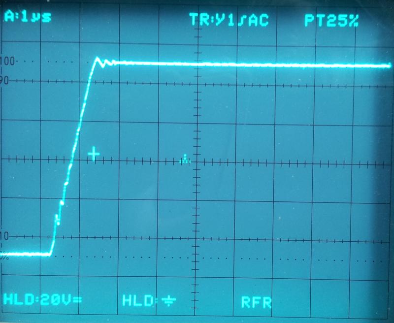

All square wave pictures where 20kHz also the high resolution ones with 1µs/div.
Short_ribbon_sq1 - 4 are increasing level of same square wave frequency.

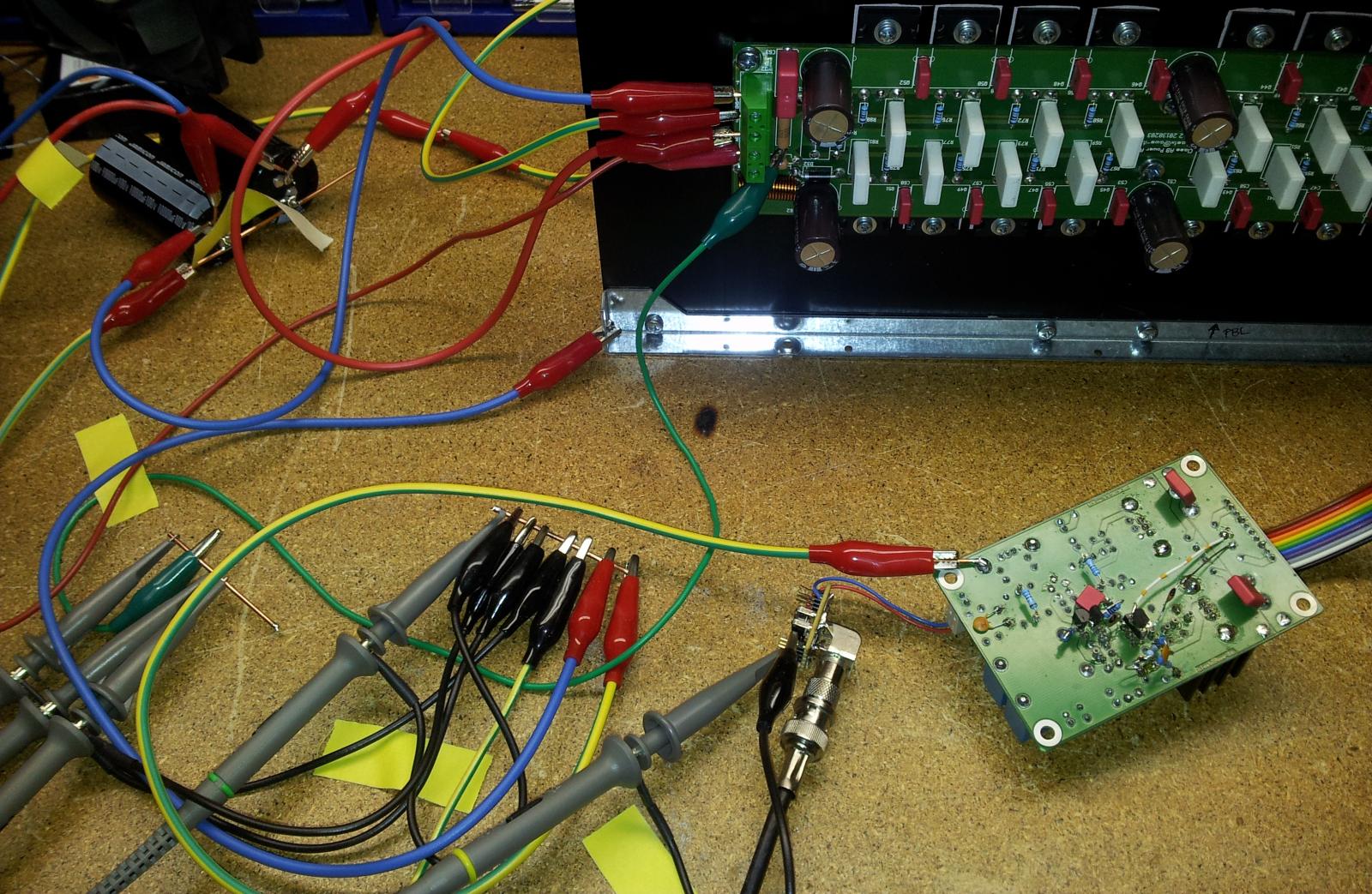

Input/RCA cable is about 3 inch to pcb input socket.I've put in crude inductance for the ribbon cable in my model. But I think the input clean earth on the small PCB is taken to the i/p RCAs and from there, taken directly to Star Earth.
What is the length of this cable from i/p RCA to Star Earth and also the length from small PCB to RCA?
Thick cable from amp ground to star ground 50 cm.
Thick cable from input pcb to star ground 50 cm.
The lengths reflect nearly a "real life" wiring in an amplifier case.

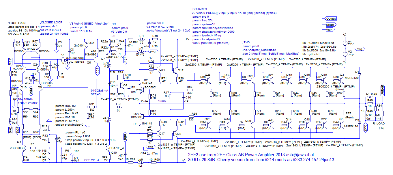

more 'pure Cherry' mods

Toni, if you haven't dismantled the Cherry version could you try another 2 dodges please.
The ribbon is a short & misterminated line so is probably better simmed with both Inductance & capacitance. There's a lot of capacitance on the ribbon lines so my crude sim for this is probably OK.
But Lp4, the Clean earth connection to Star Point via the RCAs, may be a wonky sim
__________________

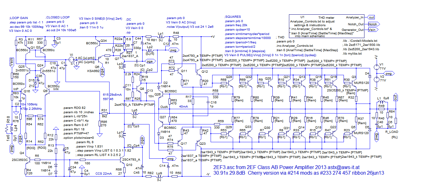

- the Cherry capacitor C1 becomes 47p + 100R in series.
- (C10, the capacitor to the other side of the current mirror should follow but this isn't strictly necessary just to check stability.)
- If this shows an improvement, a 10p capacitor on the base of the VAS input (Q6 base) to the rail may improve things further.
- Lp4 100nH to model the connection of Clean earth on the small PCB to the Star point via RCAs.
- Lp1, 2, 3, 5, 7 & 9 to model the ribbon cable. Both these are crude but better than nothing.
- the Cherry cap+resistor and the matching network to the other side of the CM as above.
- The 10p on the input of the VAS
- R22 becomes 27R
- and is decoupled with 330p+1R
- C16 across R17 33R is removed
- C11 & C13 at the bias transistor become 10n
- Q6 collector is now taken to the Dirty ground on the small PCB
- C3/4 100n to Clean ground on the small PCB are replaced by a single C17 1u from rail to rail
- On my .ASC, I've had to take D15, the cascode Zener to Dirty ground on the small PCB else it won't run. (You have it to Clean earth)

Please bear in mind that this already goes beyond Prof. Cherry's recommendations as I point out in #512 of this thread. We have 4 devices, enhanced VAS + EF2 in a feedback loop so 4 x 20dB/8ve final roll-off, which is only brought down to 3 x 20dB/8ve by the Cherry cap. This can be tweaked stable (VAS emitter resistor + its judicious decoupling) for specific cases but only up to a point. Stray capacitances, parasitic inductances & wonky loads may be too much.
I've had some 'real life' success bending Cherry's rules but this required my own rules.
For the 50W 8R amp(s) (production & experimental versions) and one 100W 8R amp, this is having EVERYTHING including the outputs in a 2x3" single sided through hole PCB. Hence the sim (my own linear circuit analyzer) was probably closer to real life than what we are playing with now.
I've never played with an amp as big as Toni's but I do want to build such a beast as I had such an amp for personal use for a long time.
To complicate matters, this 'instability' in Toni's Cherry version isn't 'linear'. It appears at high levels when the amp is slew limiting. [deleted: major rant about allowing amps to slew limit and why you need 100kHz i/p BW limitation]
I'm in an unenviable position of trying to trouble shoot something at long distance using tools which I KNOW are wonky ,. ie the SPICE doesn't reflect real life. 😡
My best clue is that the 'Baxandall pair' VAS sim I was playing with shows almost exactly the behaviour that Toni measures.
At present, I'm scratching around for stuff which might possible indicate this. The base current of the VAS i/p Q6 I showed in #522 is the wildest happening when I can simulate the stuff Toni sees. (with the 'Baxandall pair' version).
Changing the Cherry cap from 47p to 47p+100R 'damps' this and has a small effect on LG which is better seen on Nyquist. It has only small effect on the traditional 'linear' PM & GM. Similarly the 10p on the input of the VAS which I haven't checked out in detail.
... and I'm doing all this with the 2nd Zobel disabled and around 1-3nF pure capacitive load cos this seems to provoke the most instability.
Incidentally, using my Lp inductors to sim the Ribbon etc has produced some really weird Nyquist plots.

Toni already does this on his ribbon. You can see this on his early pics & PCB layouts. That's why my ribbon sim is numbered LP1, 3, 5, 7 & 9 with the earth between Dirty ground & PwrGnd Lp2, shown as 1/5 the inductance of the others.All of the additional wires in the new cable are ground wires, interleaved with the previously defined wires to reduce the effects of capacitive coupling between neighboring signal wires,
Thanks for this Toni. I think for the BIASH & BIASL lines, there is already so much capacitance due to the drivers etc that this makes little difference. I might be wrong so I'll insert these evil capacitances in my sim.astx said:Currently measured: 2 parallel wires of the used 10 inch ribbon cable have about 14pF and a wire embedded between 2 wires (powergnd) have about 28pF capacitance. If you add capacitors with value 28pF on BIASH<=>pwrgnd and BIASL<=>pwrgnd you will get 3 degree better (!) phase margin => I think this explains, why the long ribbon cable helps to stabilize the amplifier.
IMHO for high frequency the inductance of the ribbon cable is even in a bad terminated bus cable not so important as the inter cable capacitance.
FWIW, my sims show that BIASH, BIASL and the power lines are relatively uncritical for inductance. The power lines have good damping from the 10R resistors. Not sure about the feedback OutA line.
However, my Lp2 between the Dirty small PCB earth (pga on my .ASC) and PWRGND (pwg on my .ASC) and also Lp4 between Clean earth (only on the small PCB) and Star point are critical.
I'm pretty certain my crude simulation of these is wonky and would appreciate any advice. With this in place, LTspice doesn't like D15, the Z12 Zener decoupled to Clean earth so I've taken it to Dirty earth.
__________________
Toni, can you confirm the replacement of C1/3 100n to Clean earth on the small PCB with the single C17 100n across the rails?
Also the earthing of D15, the 12V Zener and the collector of Q6.

A reminder that some other distortion mechanism is limiting what THD Toni measures to 10dB more than sims of either the TMC or Cherry version. This is likely layout, decoupling & earthing.

Firstly, I gotta say I prefer to look at the Inner Cherry Loop at the i/p of the VAS rather than the OPS like Toni.
It makes practically no difference.
Increasing C1, the Cherry cap, reduces the Main Loop Gain. In that respect, it behaves like simple amps with plain Miller. But increasing C1 increases the Loop Gain of the Inner Cherry Loop cos it is extra feedback around this.
The net result is that the return ratio around the OPS hardly varies at all.
I am still not sure exactly why it varies in the way it does but it makes little difference.
An increase in the VAS emitter resistor by-pass capacitor looks like it will improve your "Cherry" stability.
IMHO including the inductances doesn't help you to find better PM. It only confuses LTSpice. Think of an older posting from me where I compared long/short ribbon cable against THD. So try to sim with caps with 2 x 28p from BIASL/BIASH connected to pwrground and another time with 2 x 6p connected to pwrground. I think the THD difference using short or long ribbon cable is based mainly on this extra VAS load.
Note: The input capacitance of the used driver transistors is low and the extra load of 2x22p on VAS is not negligible.
- 2 x 100n and 2 x 470µ from rails to powergnd are cleaning the supply for Input/VAS stage.
- Collector of VAS predriver Q6 has moved from clean ground to pwrground
- D15/12V Zener for cascode is connected already on clean ground

Toni, if you haven't already written me off as a fraud ... Can you try the Cherry version as follows.
- C1 & 10 revert to simple 47p
- R22 is 27R as previous Cherry versions
- which is decoupled with C7 330p in series with R27 1R
- remove C16 across R17 the 33R at the base of the outputs
- C11/13 at the bias transistor become 10n
- the change from previous Cherry versions is 10R in series with the VAS input, Q6's emitter

Toni, I still can't get my sim to replicate the faults you show in #518. I'm simulating your ribbon cable capacitance with Cp1-4. It doesn't show more THD with 2" compared to 10". About the only thing it seems to show is the evils of taking Q6 collector to Clean earth.
But can you confirm that C1/3 100n at the ips rails are now taken to Dirty earth on the small PCB. It was taken to Clean on your early PCBs.
Or is there a difference between your #457 latest TMC version and the Cherry version you are testing?
_______________________
But I think I'm getting enough to do something about the oscillation you see.
The good news is that the THD analyzer seems only slightly affected.
