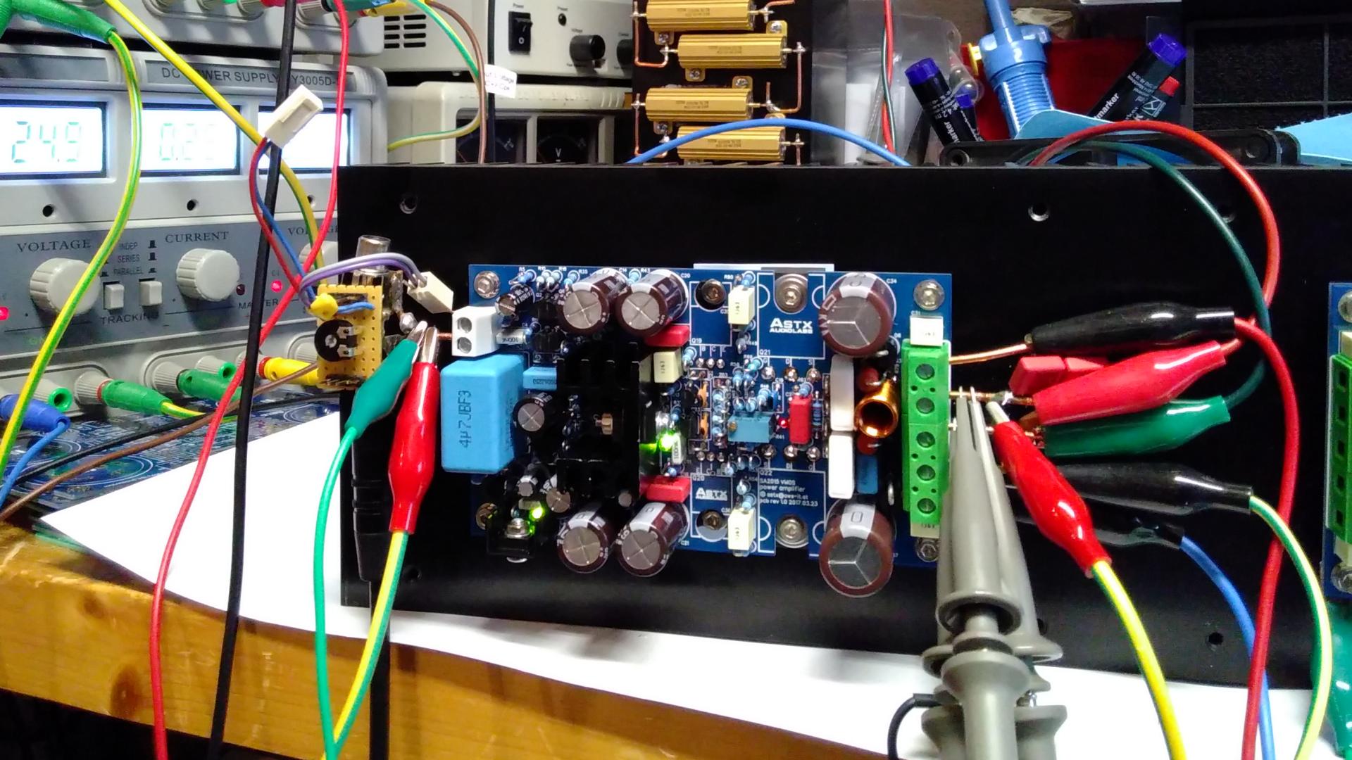

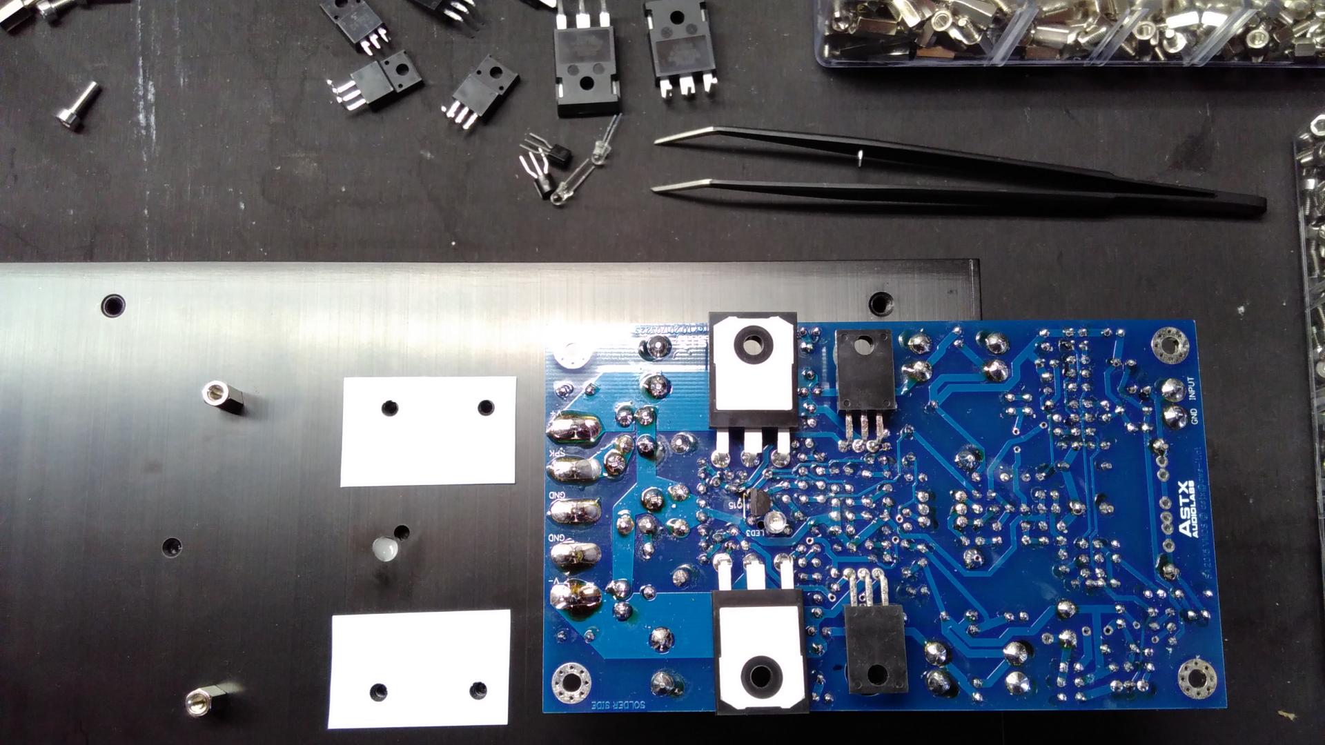

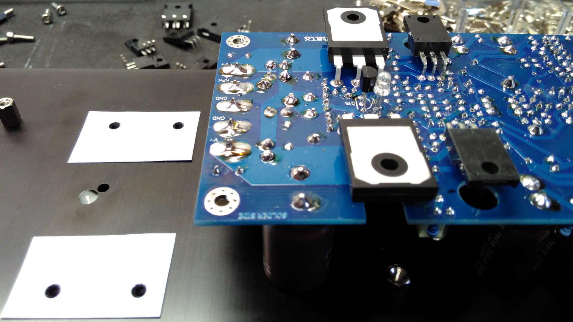

Hi Toni,what are fet that used here,240/9240 or these expensive and difficult to find IXTH80N20L fets?
- 2nd channel mounted
- tested
- QC OK 🙂
Have fun,
Toni
The used MOSFETs are IXTH80N20L and IXTH48P20P. A single IRFP240/9240 pair wouldn't survive rail voltages +/-50V with such power levels (200W@4R continuous) ...
In principle you can use the pcb also for IRFP240/9240 devices but at a much lower output power /lower rail voltages ...
The compensation may need a redesign.
The SOA protection always need to be redesigned. When I find time I can assemble a pcb using IRFP240/9240 only.
BR, Toni

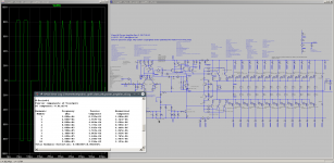

SA2018 ultra fidelity monster amp
SA2018 - something like this?
Simulation results: 420W@8R (+/- 90V rails, 100mA bias per pair, 1.2A bias total, slew rate 100V/us)
Have fun, Toni

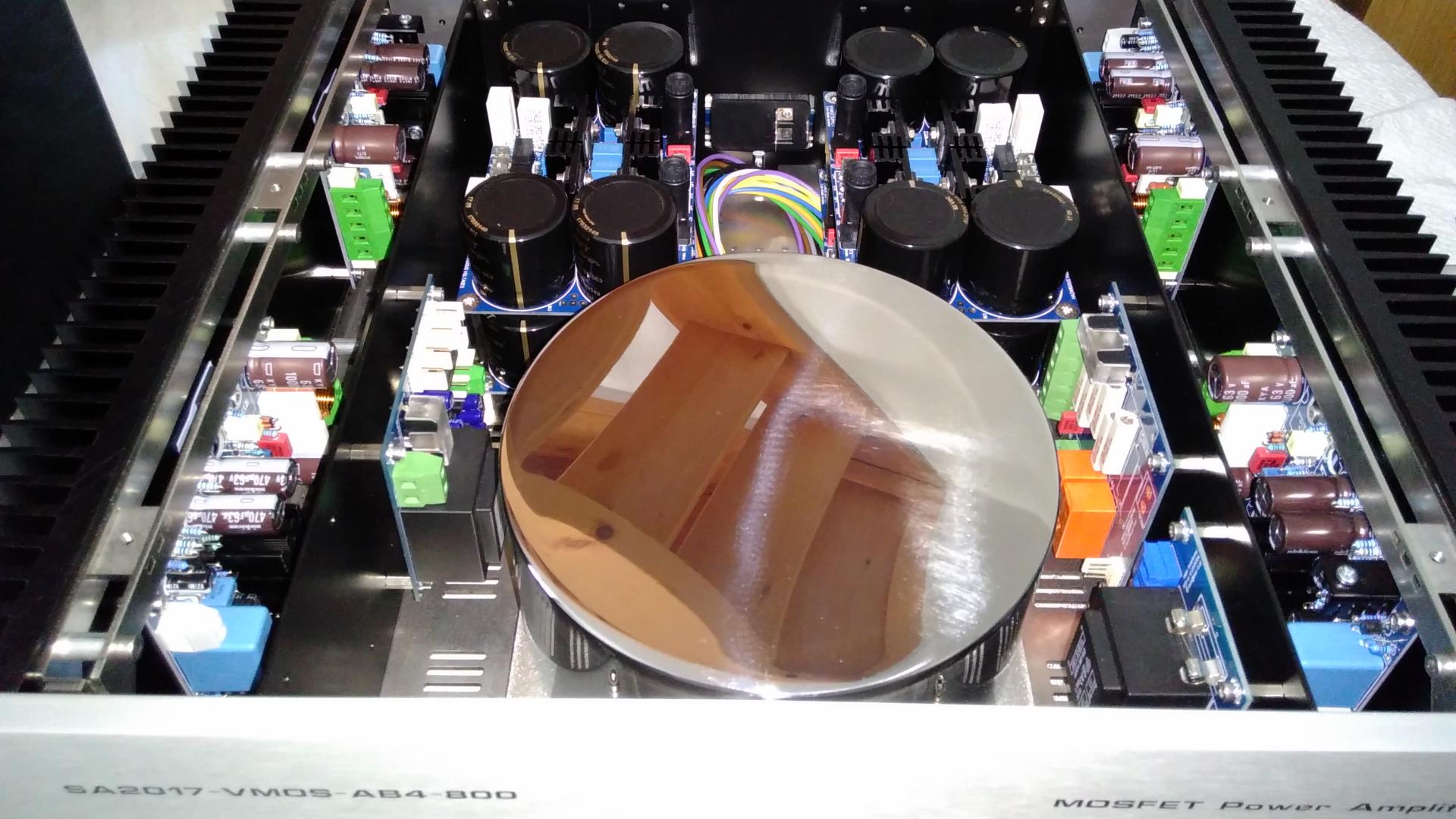

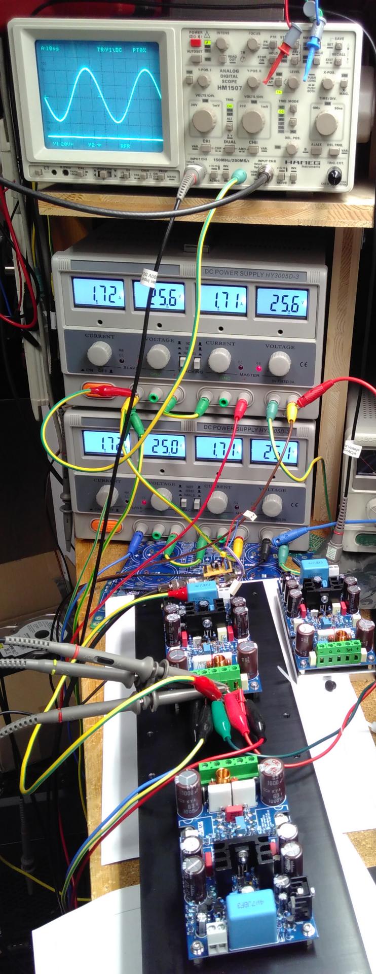

SA2015 4 channel VMOS
^^^ You meant "wow. it's great to have that"?
... all 4 power amp modules tested (working all out of the box) and mounted on heatsinks.
Next steps:
Toni
Next steps:
- soldering housekeeping circuits
- cabling
Toni
Touching the perfection!!!🙂
Waiting for the cabling,i want to see how you manage all the cables.😉

SA2018 - 12 pair MOSFET monster will need more research (e.g.: SOA checks; many more hours of simulation and tests). Currently I have a limited amount of spare time so you need to wait a few weeks ...
Stay tuned. I definitely will build a prototype if I find time.
BR, Toni

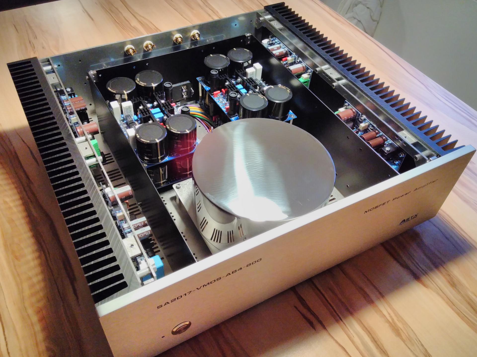

2571 is a work of art!

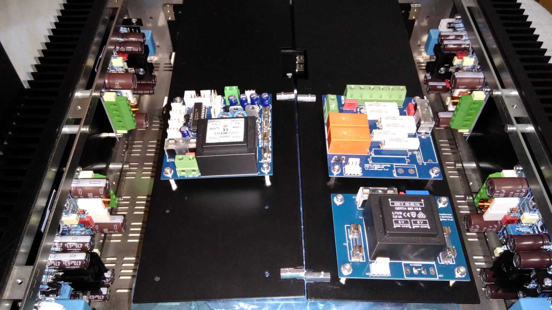

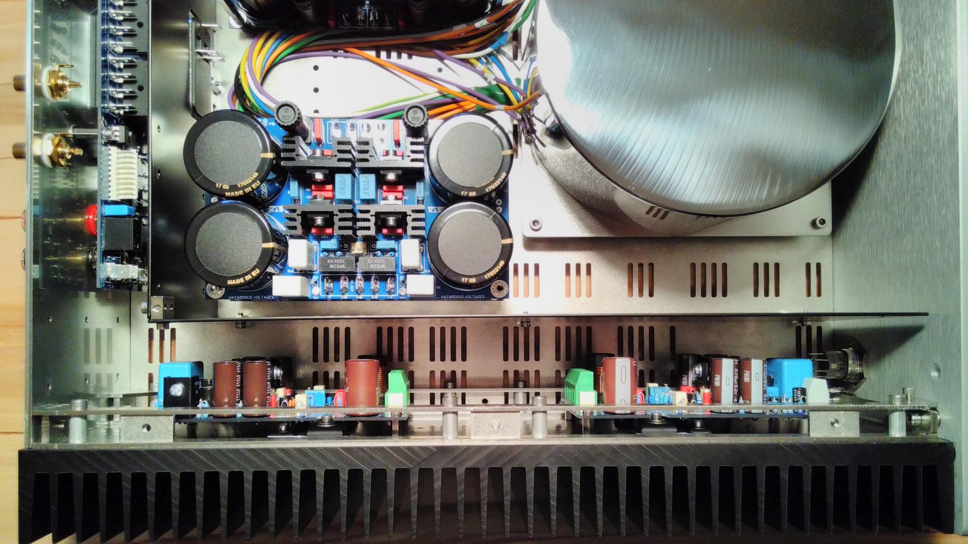

Where is the MCU? To be fitted on wall opposite main toroid?
See attached pictures ...
Have fun,
Toni
