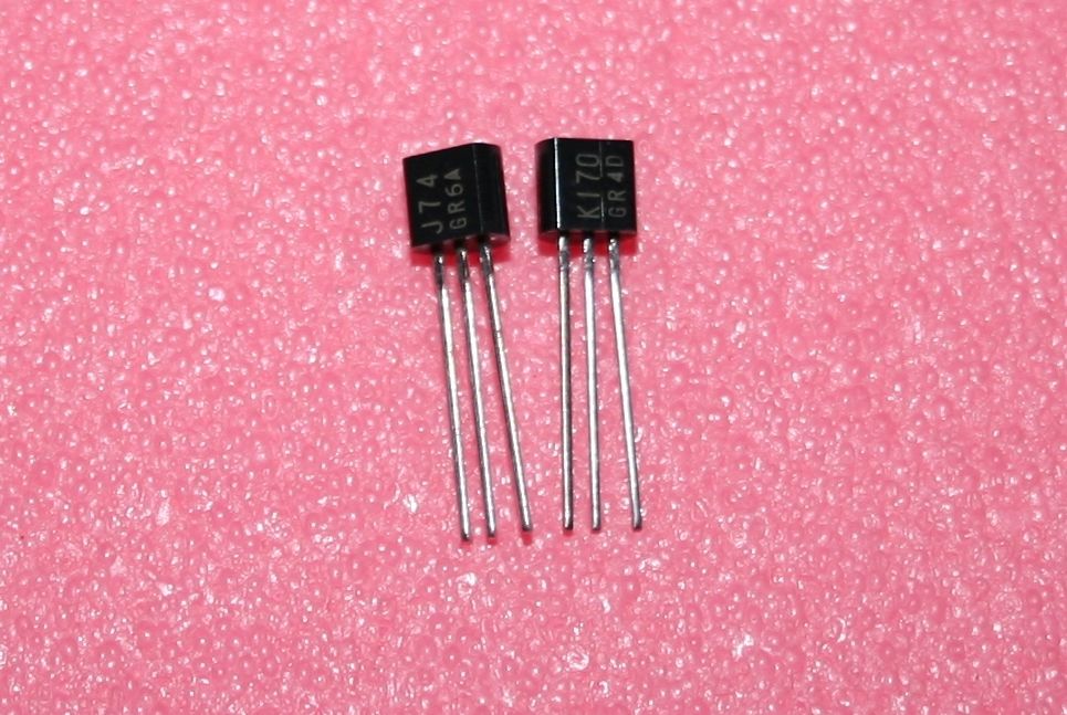

Just measure the Vgs,
And you will be amazed with the China k170 j74 jfets.
Even more the pin arrangement was distorted.

My guess is fake. Examine them with some magnification and you will most likely see the original imprint under the new 2sk170 one on some of them. Original ones can still be found with reasonable price from reputable sellers. I have bought fake ones also. If it sounds to good to be true you can bet it most likely is.
Thank you for your opinions.Is there any printing letter code behind the transistor in the circle ?

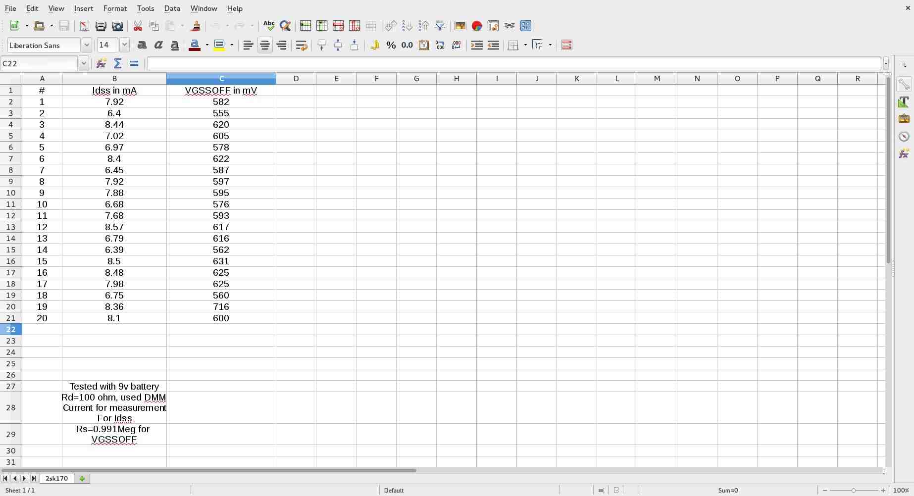

I managed to get 20 from a local source. I can get some more if its original. They all look from the same batch. I measured the idss and vgsoff. Most of them looked ok as per the datasheet idss vs vgsoff curves, could someone please eyeball these before I sink more money into it. Any other sure way of knowing if these are good. I dont have a curve tracer but I do have a scope.

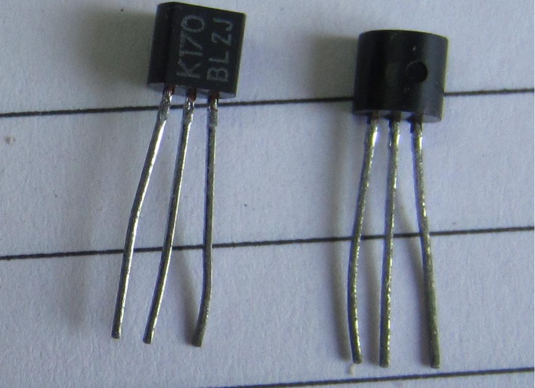

Hi.I bought 200pcs of 2sk170bl from China.Are they genuine or fake?Here is pictures with flash and not flash.Taken with Galaxy note 2
Fakes.
Look at the 1 and 7 of "K170" totally different font. Look at my picture and compare to these Japanese real ones. Also the encapsulation of the plastic case is not as neat as with the real ones.
But it says made in Thailand, maybe different production line, different printing and cases ???
Don't think Toshiba would accept lower standards from a foreign plant, though.
Measure them for Yfs and you know it for sure. it's not that difficult to do.
