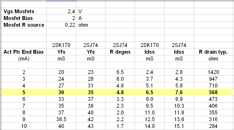

Somewhere in the F5x Thread, there is a table of j74/k170 degeneration resistor values for a range of Idss.
From what I remember the j74 has a slightly higher transconductance (gm) than the k170 of the same Idss.
It seems that using a slightly higher Idss j74 and adding a degeneration resistor brings the Pchannel to roughly equal the Nchannel of the FET pair.
Degeneration
Hi AndrewT,😀
I thank you for your helpful info ,I'll look for the chart will be a handy reference to keep in the bag of tricks,LOL.
Life is a bowl of Cherries or is it jfets,lol.
Have a GREAT day!🙂
NS
well done, you found the correct table.
Using the table.
Go to column 5, k170 Idss.
Select the Idss value you have.
Go to column 6, j74 idss.
Select the matching Idss on the same row.
Go to column 4 R degen.
Select the matching resistor value that is added to the j74 source.
the example highlighted in yellow is k170 = 6.5mA idss, the matching Pchannel is a 7.6mA j74 with a 4r8 degeneration resistor in the j74 source.
This is what p3 does in the F5/F5t. it varies the two source resistors to give a DIFFERENCE in the FET source resistor to bring the gm of the upper and lower devices to become the same transconductance.
There is a misprint in the table, the mS unit under Idss in col5 & 6 should read mA

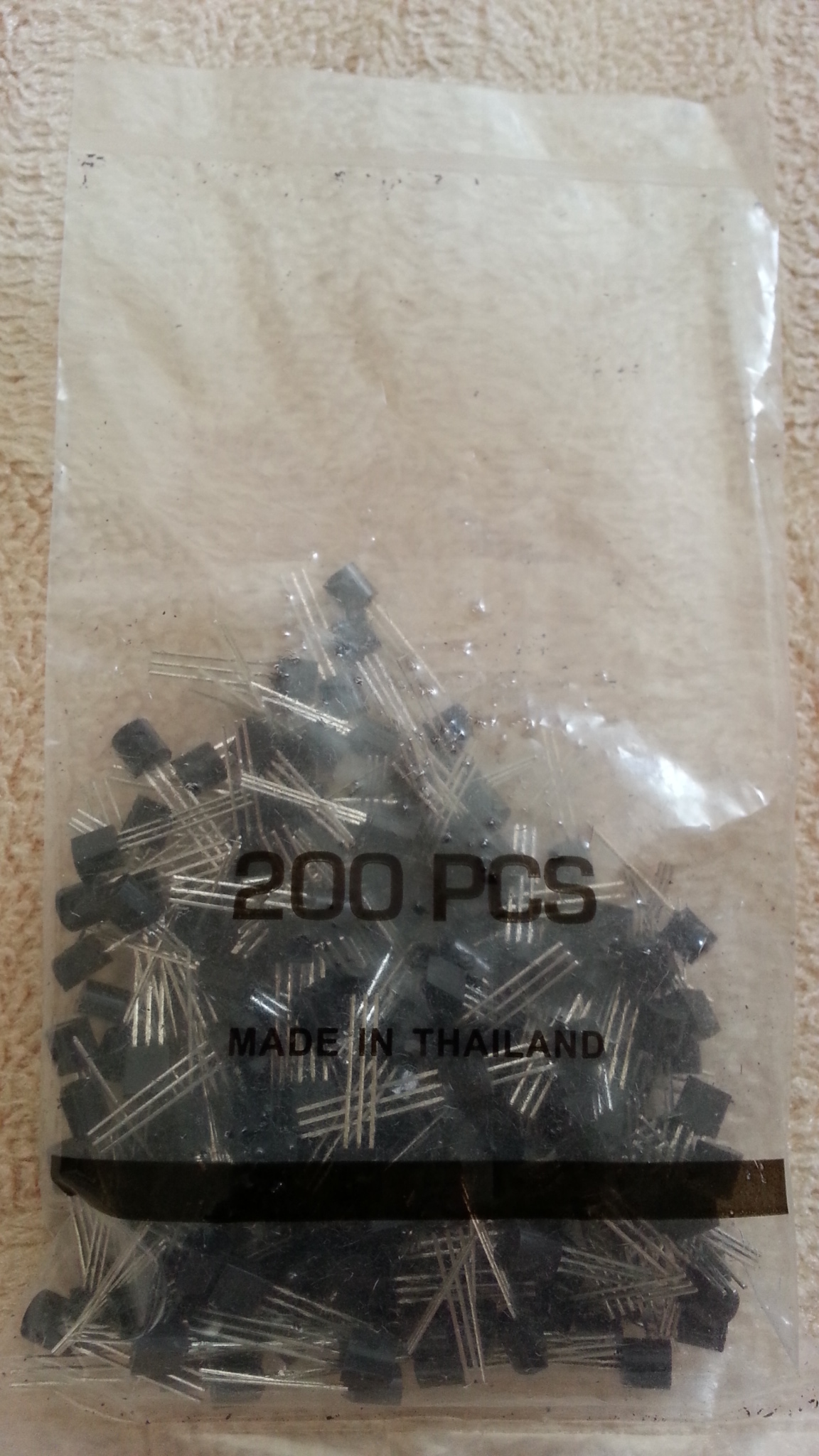

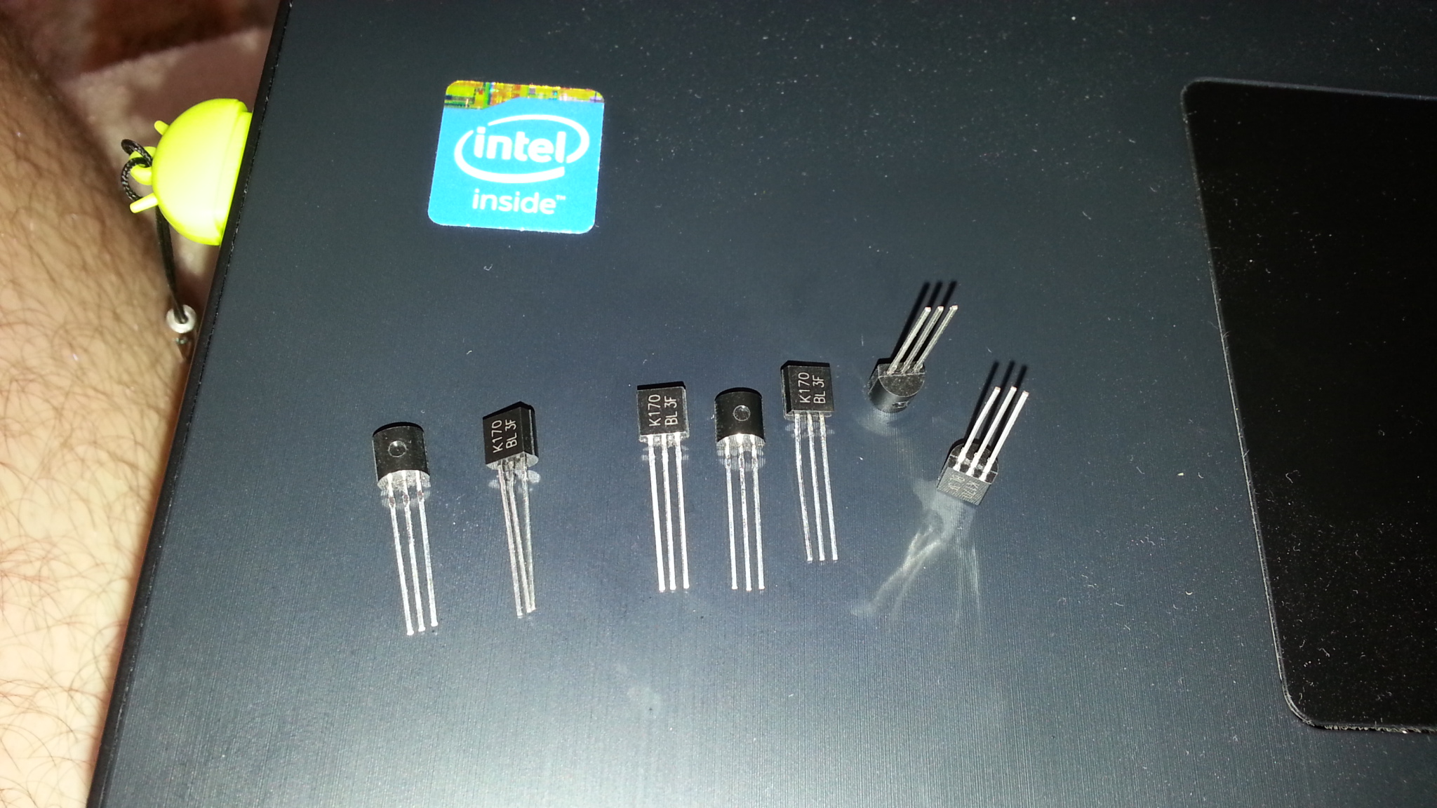

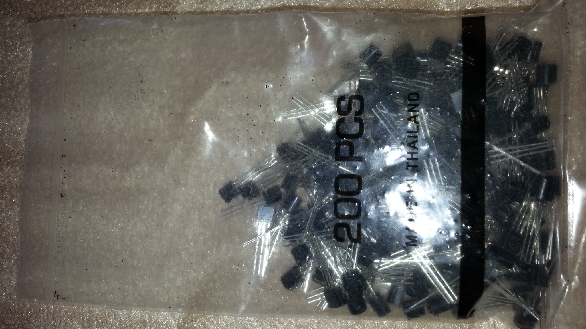

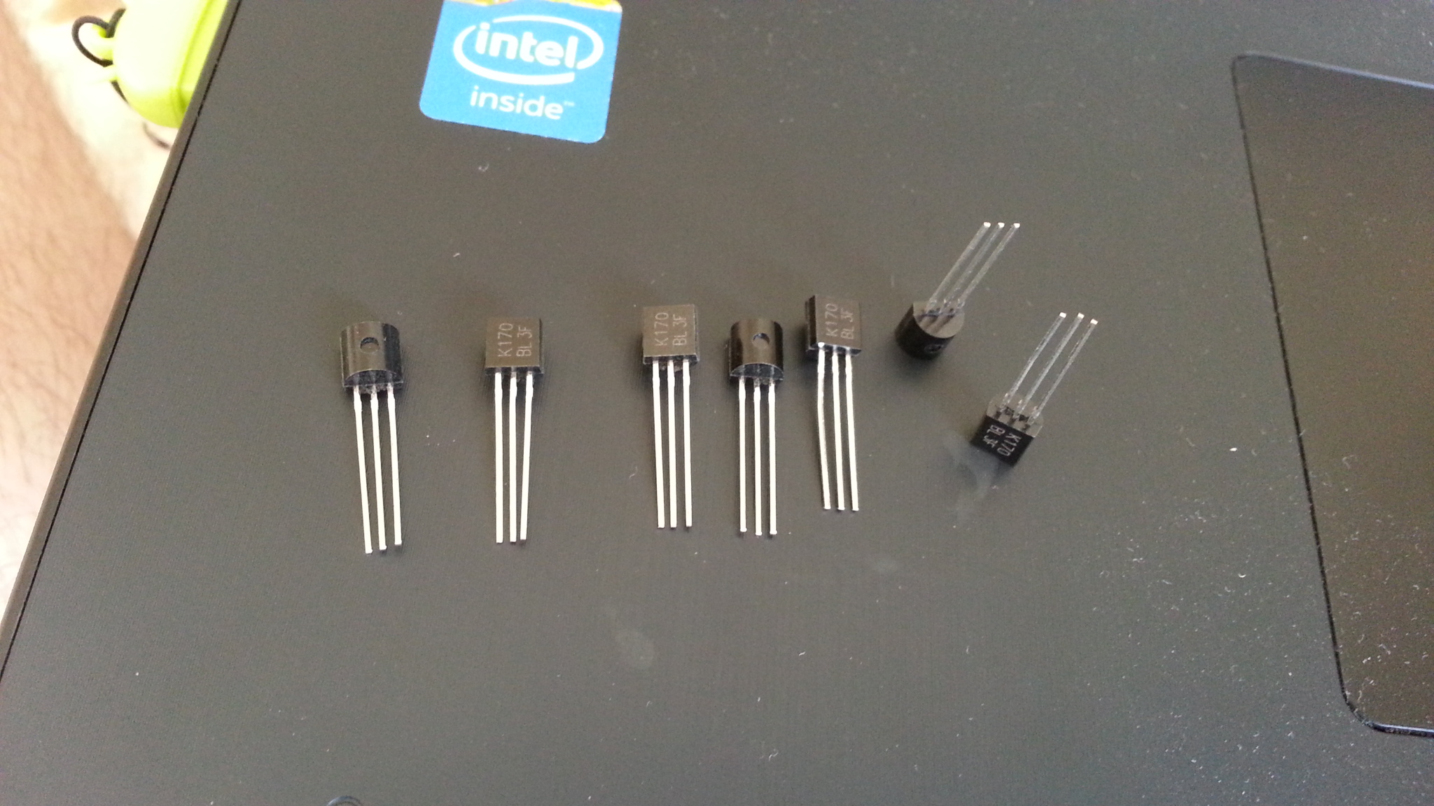

Hi.I bought 200pcs of 2sk170bl from China.Are they genuine or fake?Here is pictures with flash and not flash.Taken with Galaxy note 2

my newbie eyes say there relabeled, because original printing has a good allignment, and label colour is different. i got mine from alweit and ti-kan, both much different than yours
i also have bought 200pcs K170 BL from local store for only $20, too cheap to be true. more likely same printing as yours, but Idss check only 2-3mA
