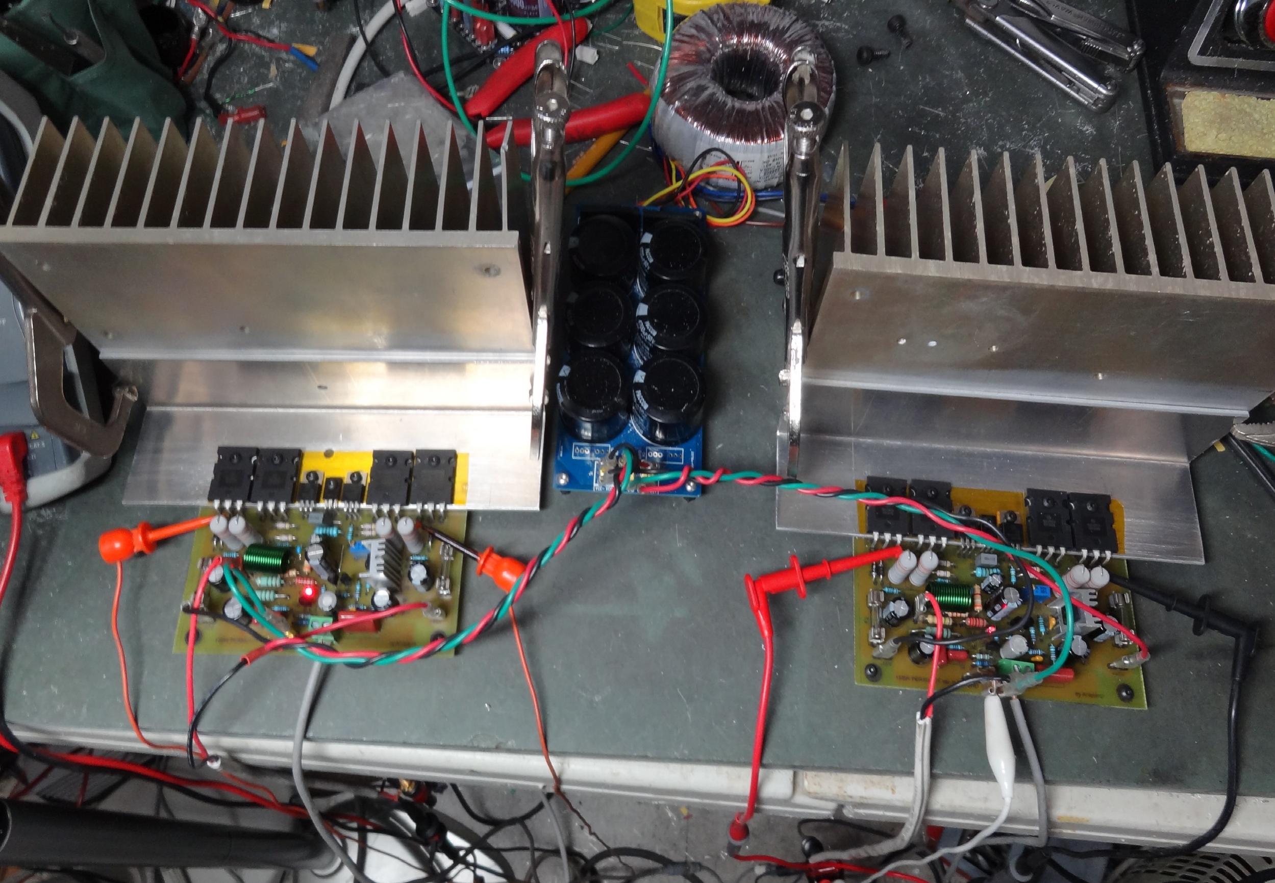

The Turtledove is singing beautifully. Very, very nice! Thanks for sharing this design with us. It played from first start up. Looks great on the scope. I have it playing right now on my A/B system. Compared it to the Honey Badger and Peeceebee so far. Holds it own very well and I just have it on a so-so PSU. 160VA 30-0-30vac transformer and 6X4700 caps. Even with this small PSU it sounds really, really good. I will be recommending this one to my friends.
Blessings, Terry

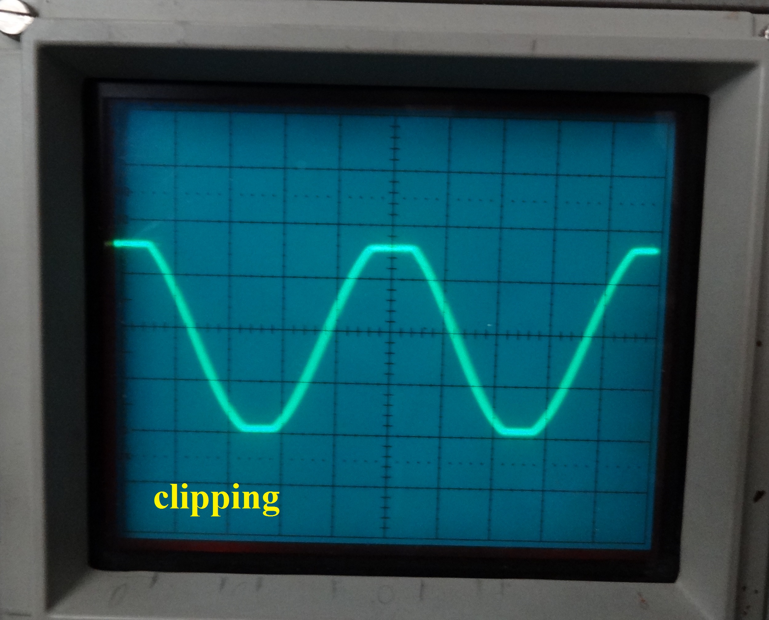

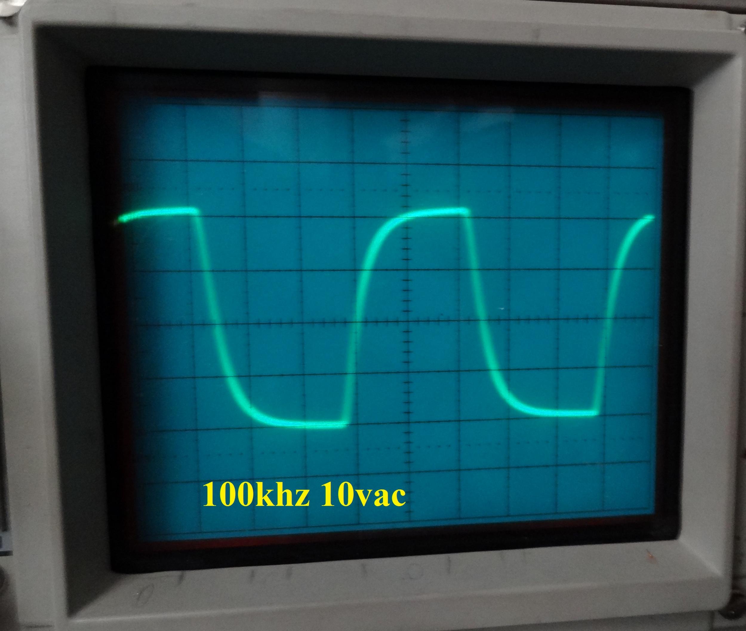

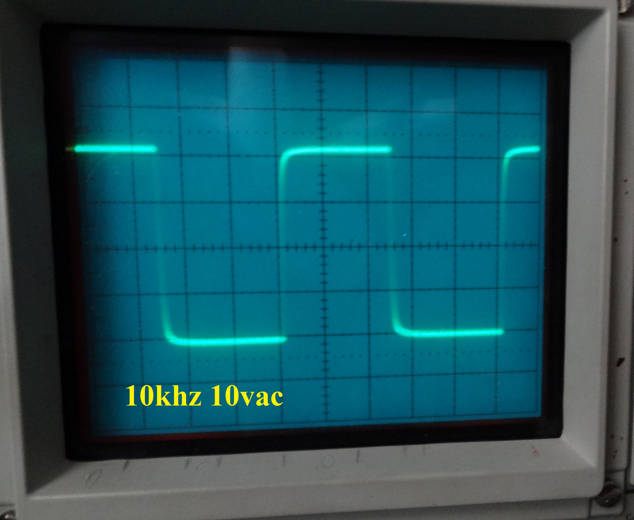

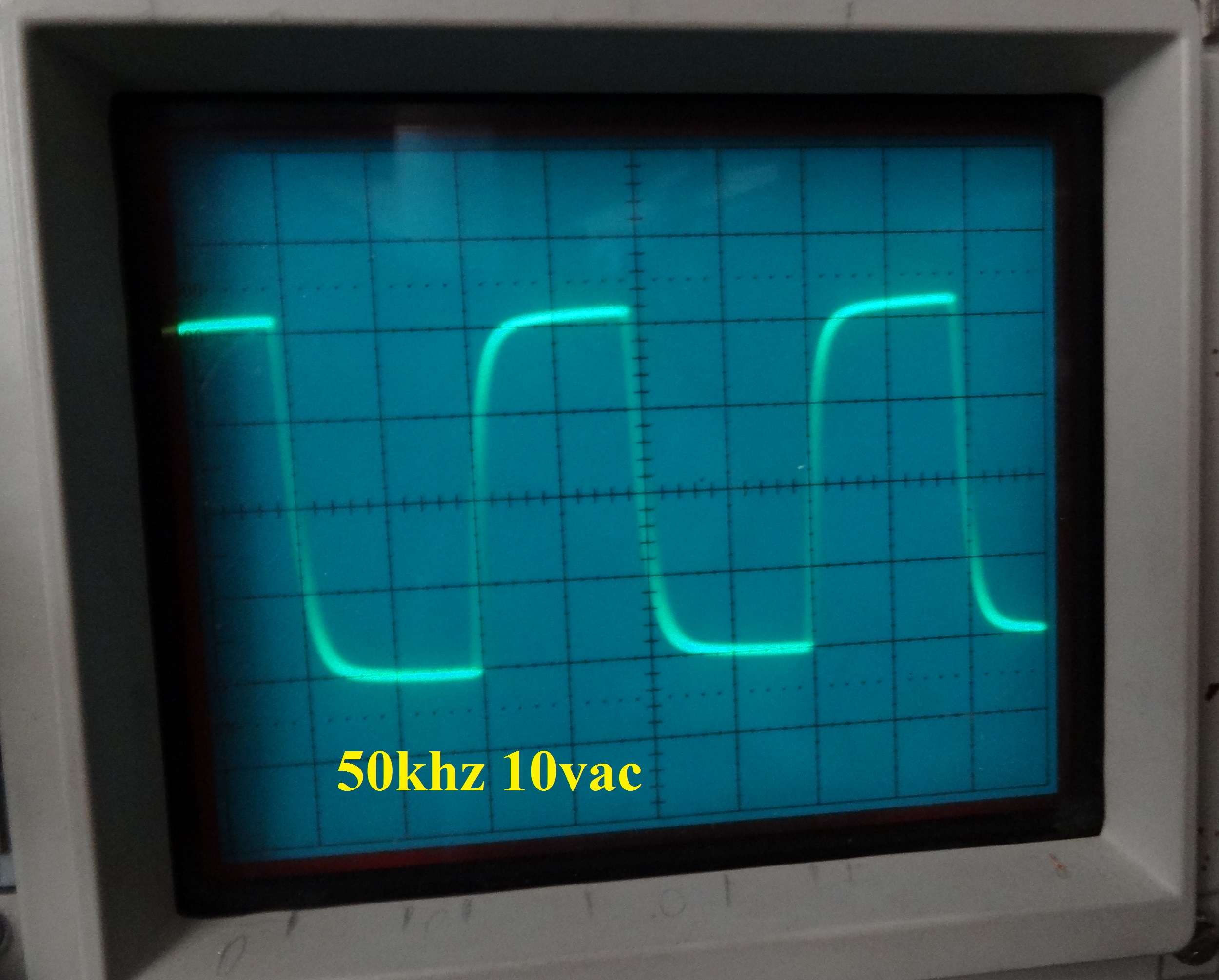

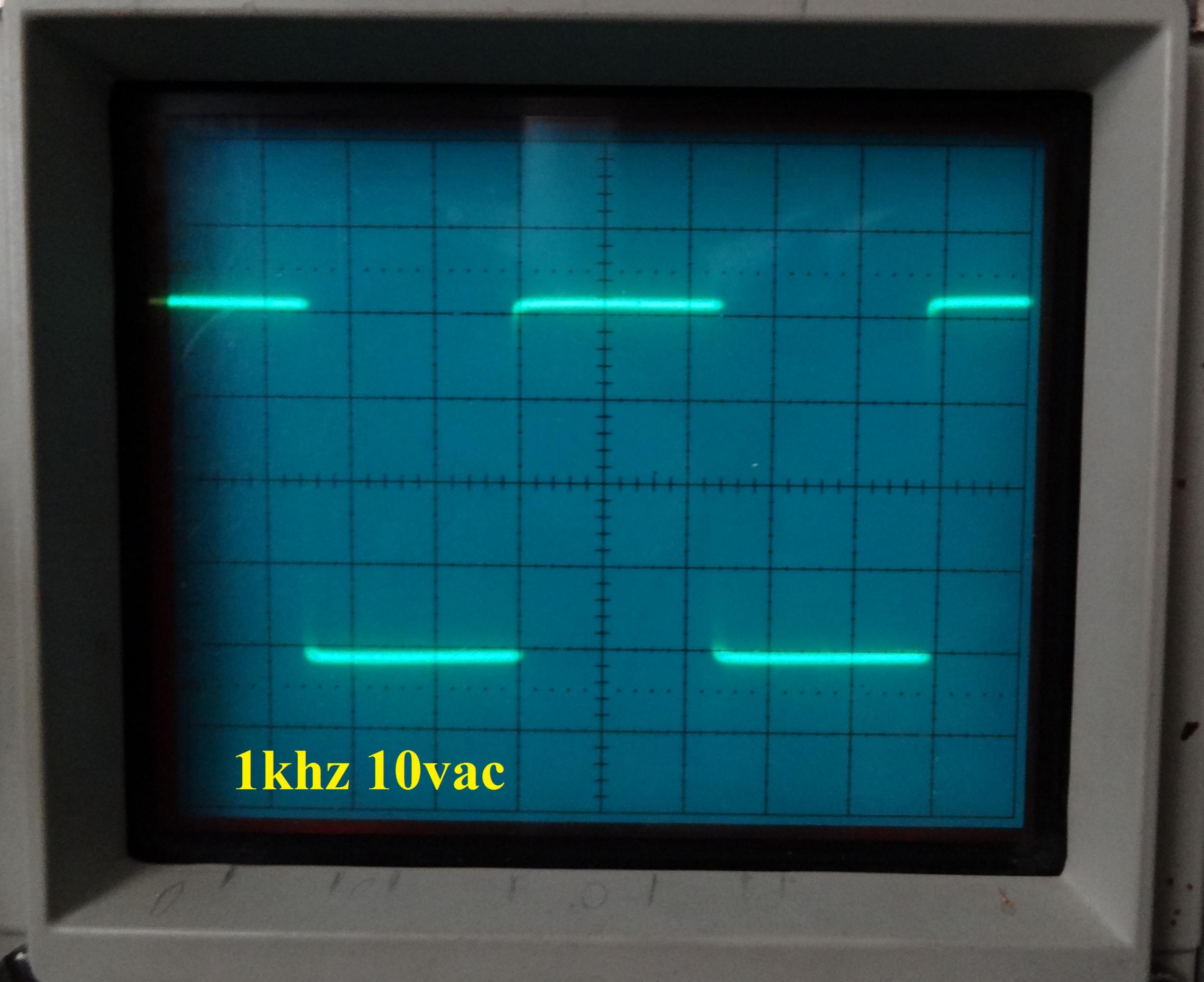

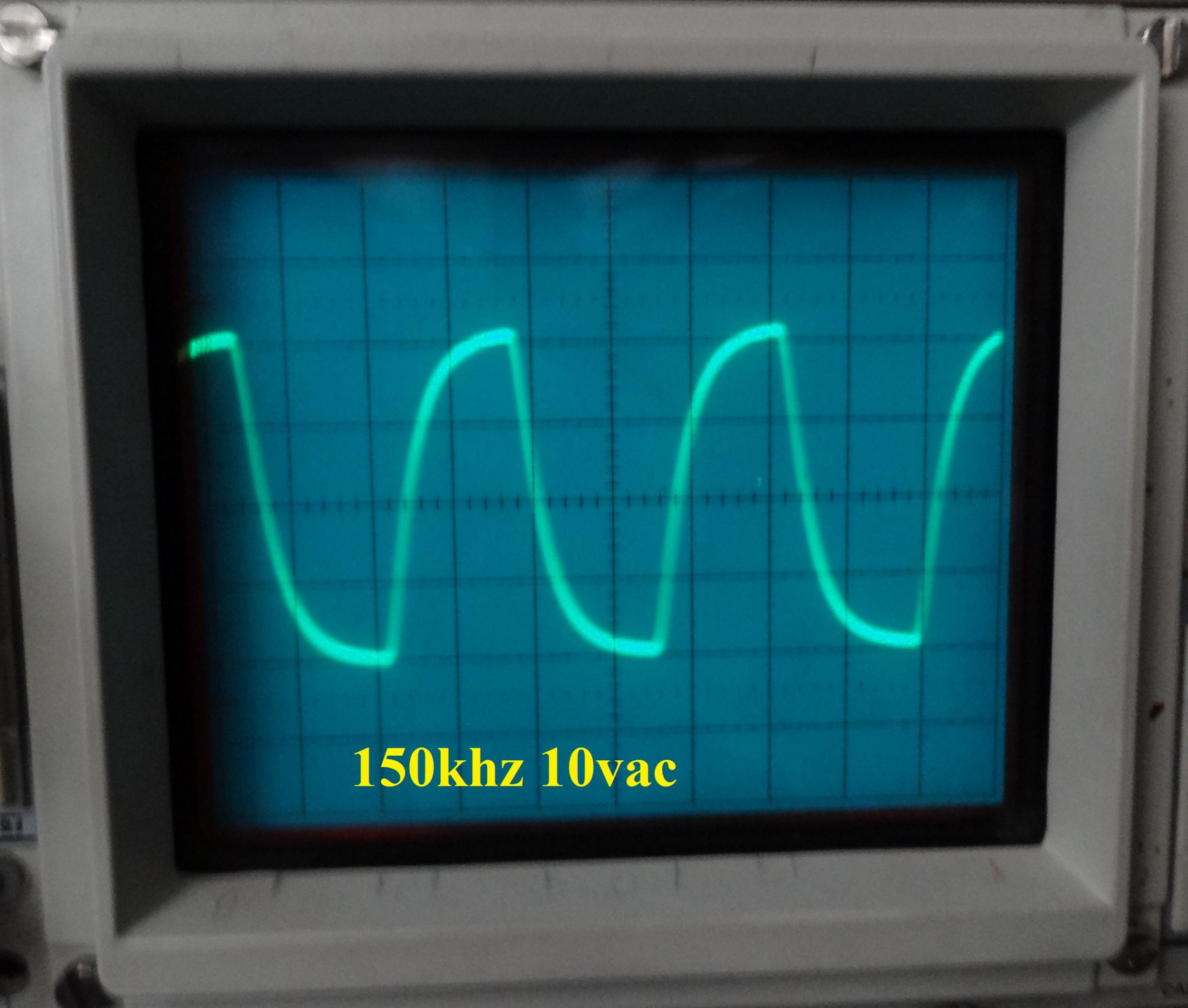

Can I put this pictures to my blog? Can you take some pictures of the scope?
Here you go.
I used +-40V rails into an 8R dummy load. It clipped at 27Vac. Bias is set to 90ma per device.
Let me know if you need any other pictures.
Blessings, Terry

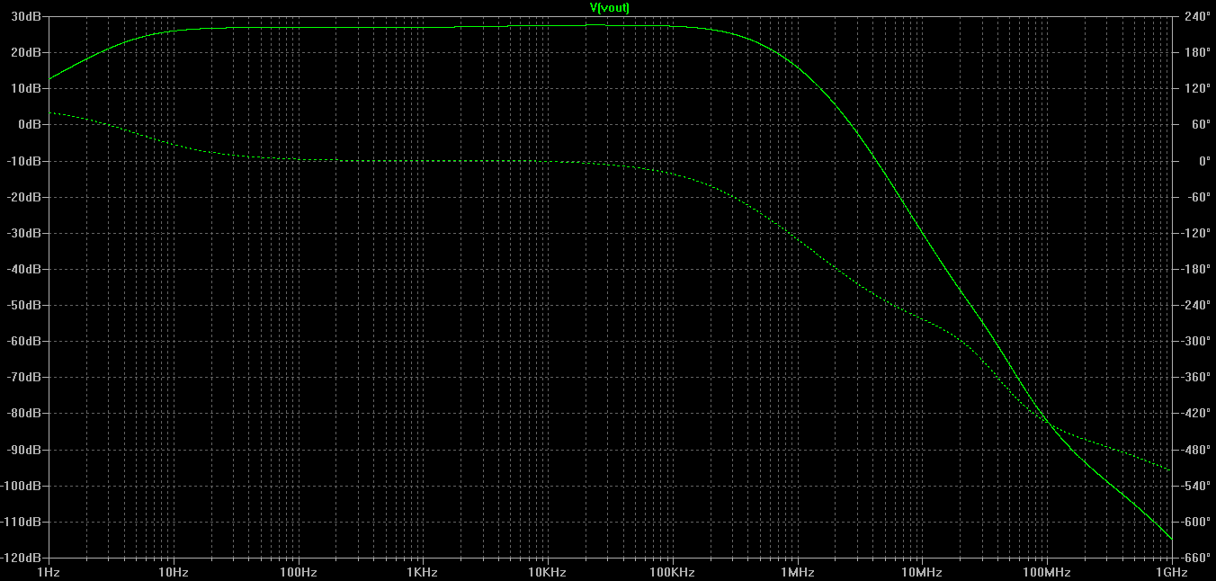

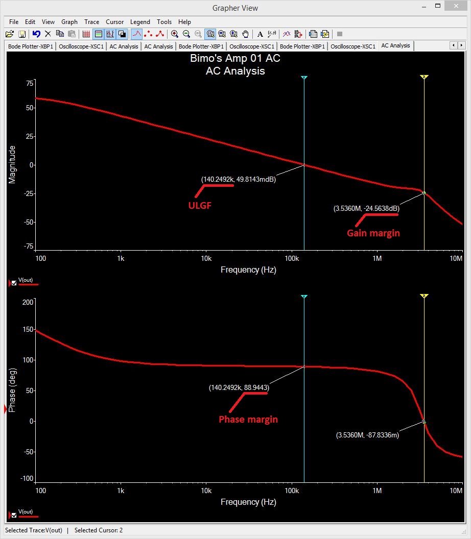

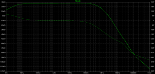

may be you have better method than M. Tian with tian probe?
Bimo, something is not right. The graph shows the gain @ 1KHz is some 6db. Open loop. It can't be the case... too low to be truth... in this case the margins are also calculated incorrectly.
Of course it is right. This amplifier have low open loop gain (micron). This is the open loop gain using Bob Cordell method (insert 1GH inductor in feedback).
You make an assumption, please run the simulator
This is what I see, looking at the global loop
You're right, the loop gain is low. The margins are good, mainly because of that reason - although they are slightly lower than the ones presented earlier. But ULGF at 140 KHz shows the amp is heavily compensated (mainly with the cap between the VAS output and (-) input - influencing overall speed of the circuit and THD at the higher end of the audio frequency range, as well as phase response (around 8.5 degrees phase shift @ 20 KHz with the loop closed).
Nevertheless, it's an interesting, working low loop gain design with rather low THD (for such a low loop gain).

By the way, tian probe is easier to measure phase margin and gain margin, but I know you don't like to use Ltspice.
Phase Margin = 103 degree
Gain Margin = 30 dB
The phase margin reported from post #73 is 88.9 deg and the gain margin 24.6dB, which are different from those figures in post #49.
I tend to believe post #73 is correct, with simple Miller compensation, in theory the phase margin cannot exceed 90 degree.
The Tian probe plot in post 54 indicates an OLG of 6dB @1kHz, which is very suspicious when the CLG is much higher.

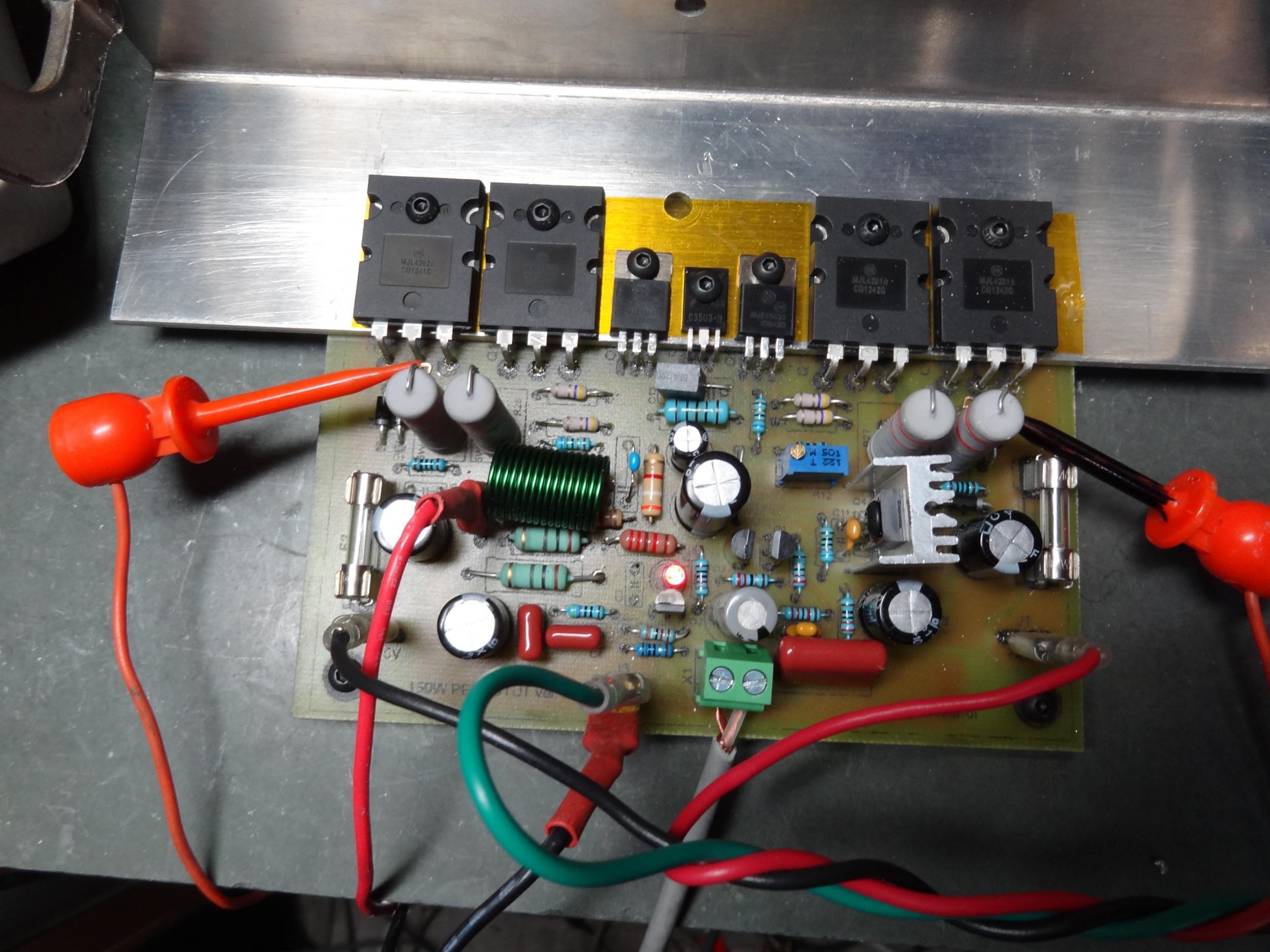

Hi Bimo,
I built the ASKA clone using your layout and schematic. I'm having issues so I built a spice file but it doesn't work either. Can you take a look at it and see if you can find my error? i hope to use it to troubleshoot my boards.
Thanks, Terry
Thanks, Terry
