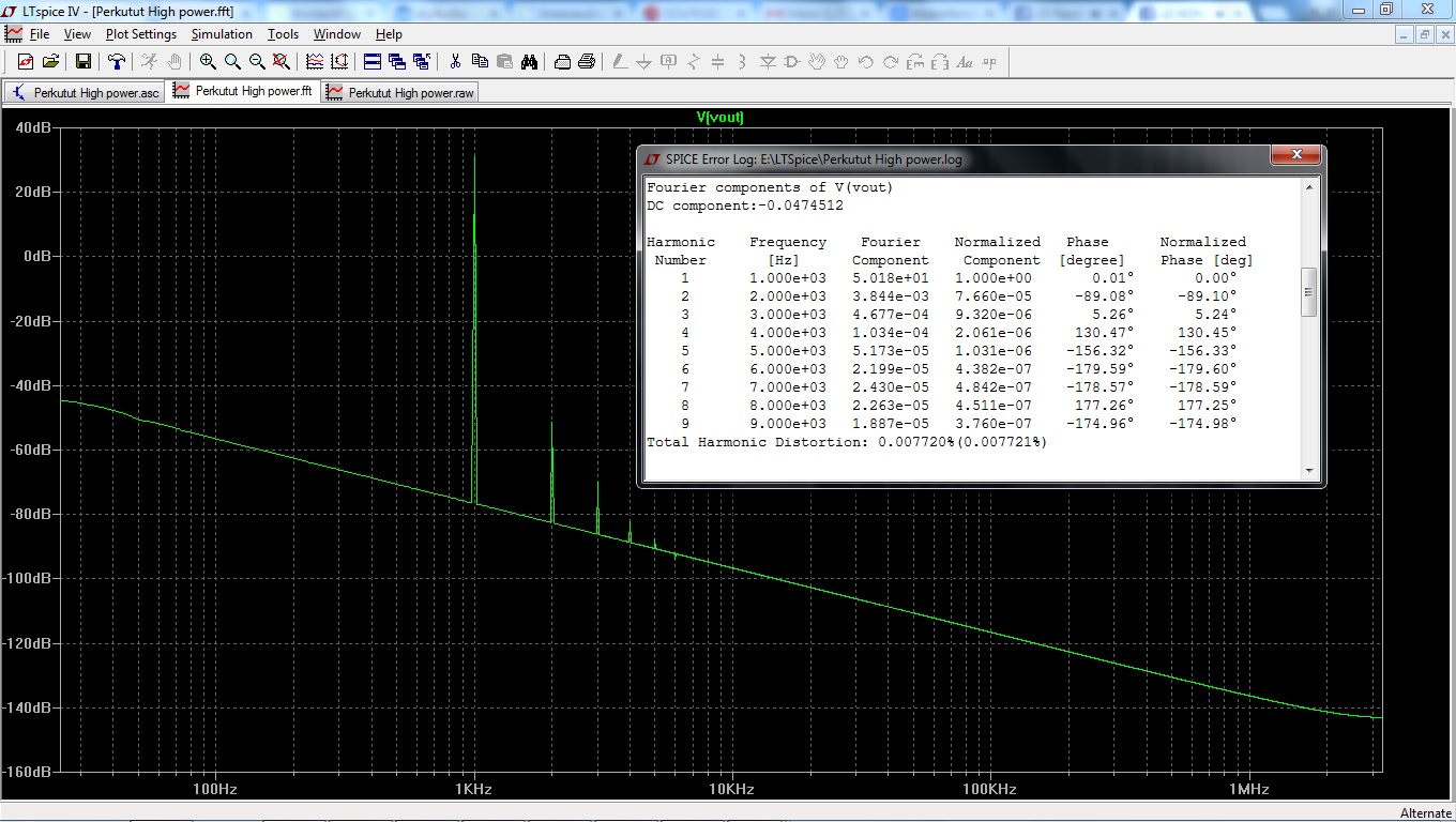

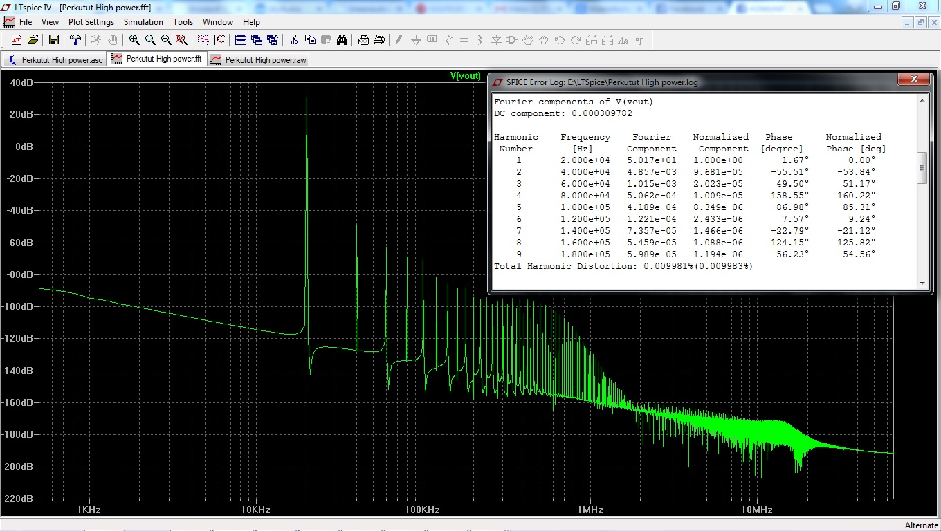

I modified perkutut amp to use +-63VDC PSU. I change VAS transistor (not single transistor). AKSA 55 and Mr. Hugh Dean's design philosophies is my inspiration. Terimakasih Mr. Hugh Dean.
