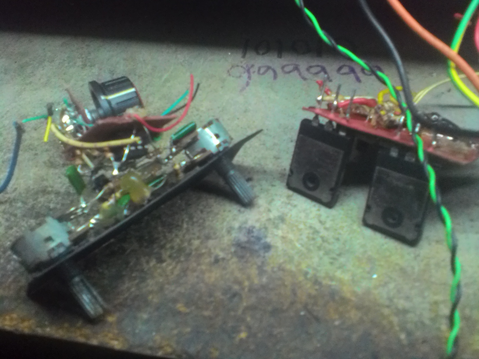

I didn't start any fires but I did have a few transistor failures. The VAS transistor ran very hot, Q3, BC546. I was using them with a 4 way active x-over so they were not being driven very hard. I had a common power supply driving 4 units and I did get some collapse of the supply rails during heavy bass passages otherwise lots of enjoyment.

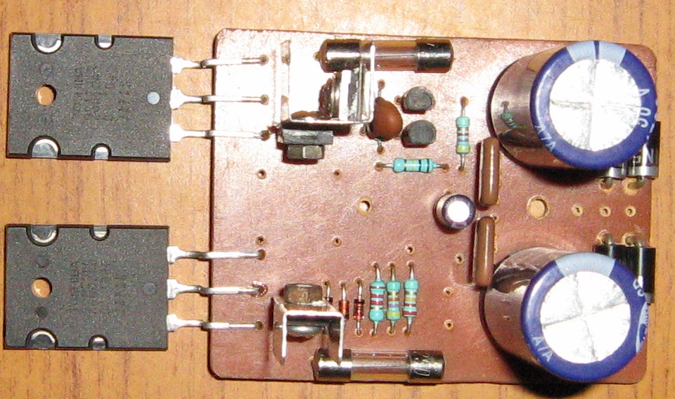

Very good experience with Digi 125 kit, Have been using 7 channel of these for last two + years.
No problem what so ever and very good sound too.

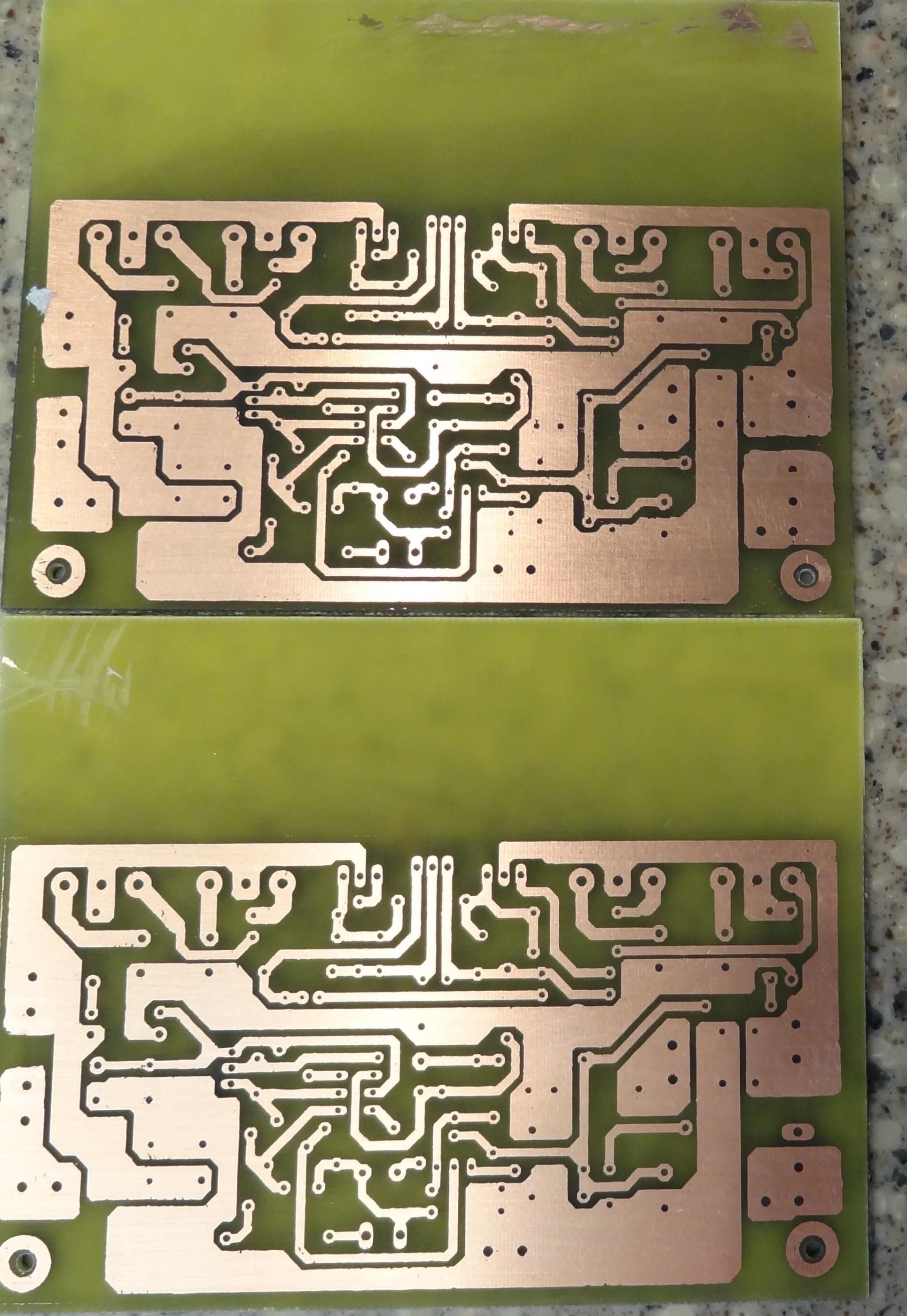

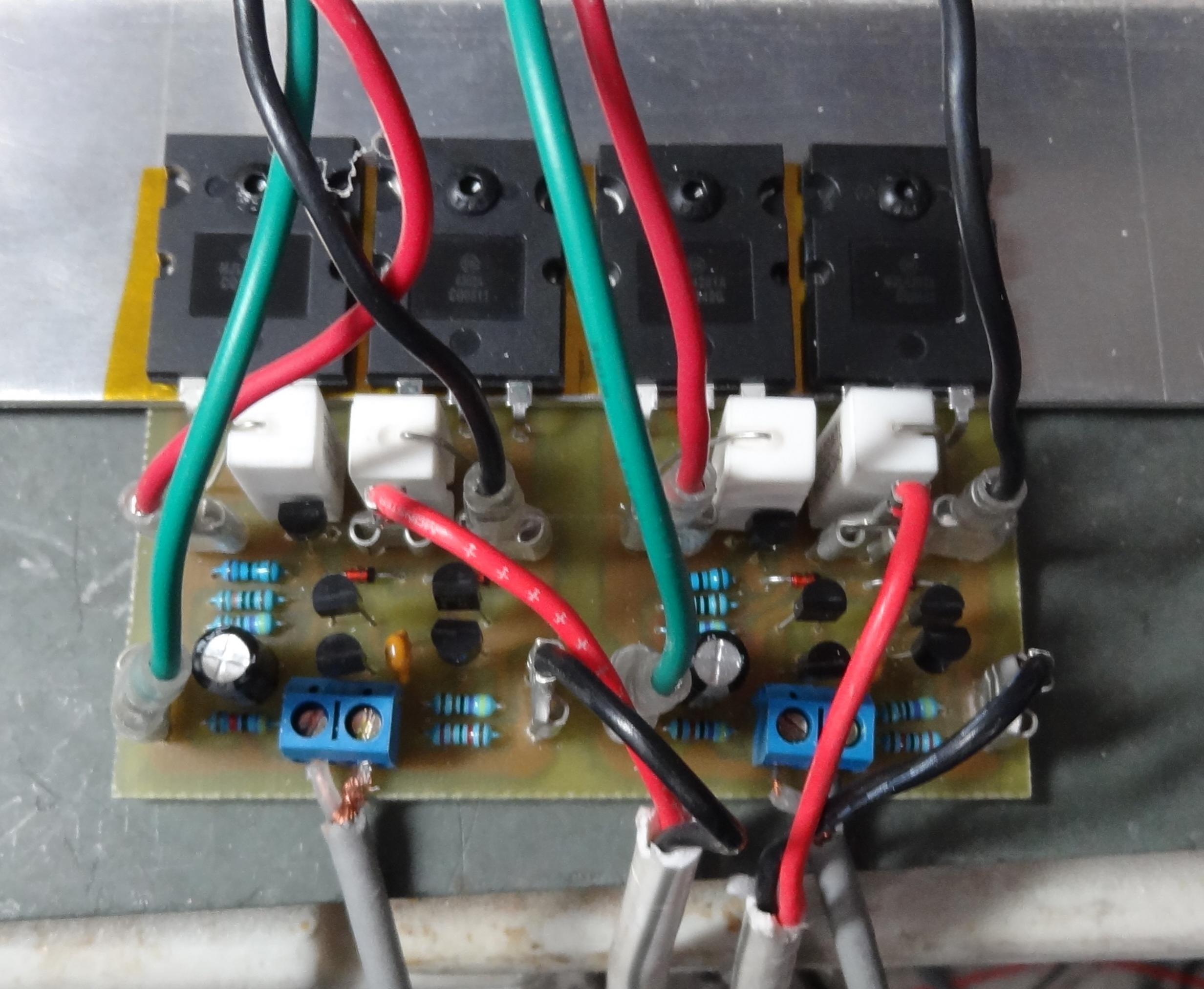

I was intrigued by the little Micron 50S so I etched a pair and built them. When I fired them up, both channels show a -200mV offset. So, I built a spice model so I would have something to compare it too. The spice model shows a -180mV offset. Checking the bias shows that the PNP outputs have about 100mA but the NPN has almost nothing. Maybe this is part of the design but that is too much offset. Maybe one of you who knows better than me can take a look and see what is causing this. I'm attaching a photo and the asc file.

Please change these:
R3 = 3K3
R5 = 22K
R6 = 1K
C2 = 100uF

I made those changes in the spice file. The offset is better but the bias drops to 3mA on the PNP and less that 1mA on the NPN. I'm already seeing crossover distortion on the scope. Do you think that will make it worse?

You can add one dioda and paralel with resistor between D1 and D2. Then adjust value of the resistor to set bias current. Don't set bias current to high, you can enter to thermal runaway. For class B, 1 to 10 mA is enough.

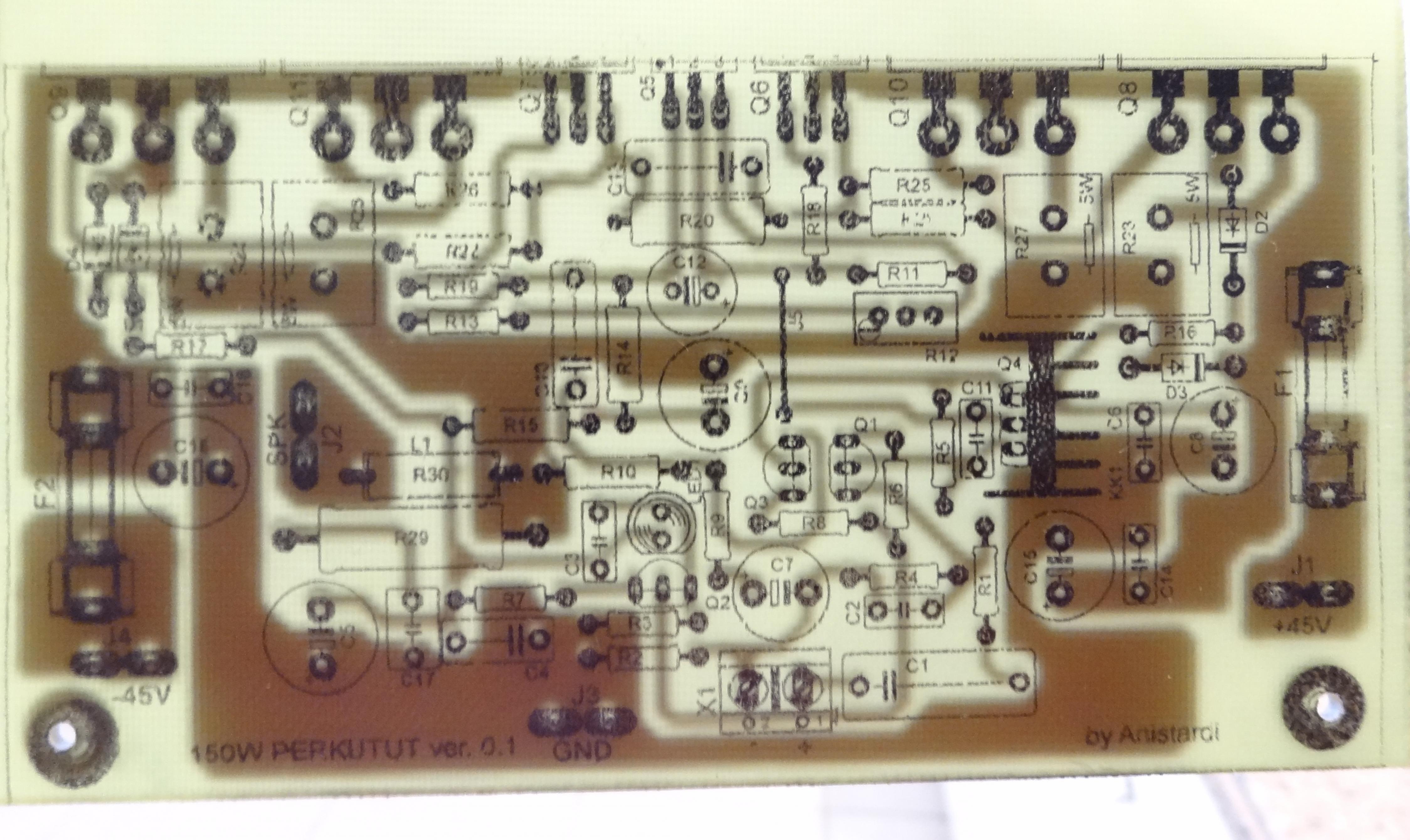

May be you want to build this: http://anistardi.wordpress.com/2014/10/14/perkutut-amplifier/

Alternative for Q4: 2SA1381
C2, C10, and C11 should be Silver Mica or Ceramic NP0/COG
C1 is MKP or MKS (usually I use WIMA, because it is cheap).

This is not because of THD or sound quality, but sliver mica and ceramic NP0/COG have almost zero temperature coefficient. We do not want amplifier stability change because the temperature changing.
Of course if you always operate the amplifier in same temperature, it does not matter 🙂
