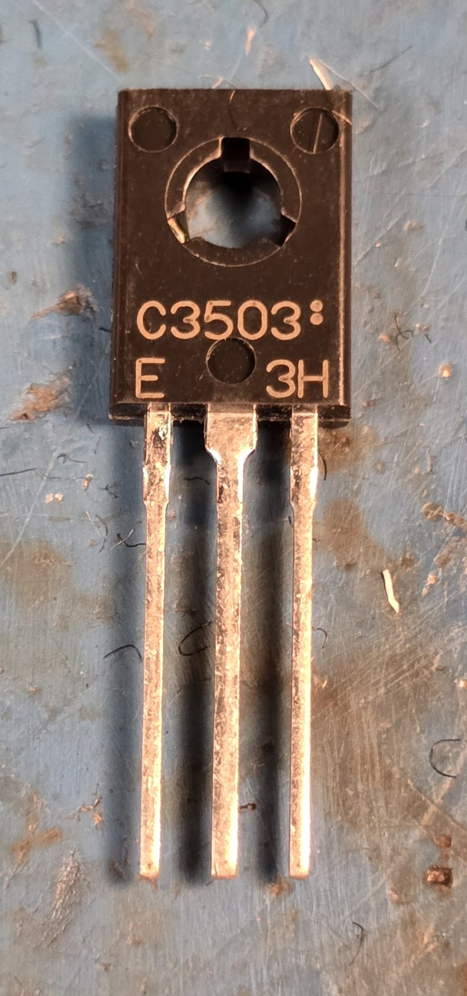

Yeah I think you're right. FWIW, this is what Rochester is shipping in C3503.And they are not onsemi. most likely Sanyo.
Question for those in the GB:
If I do manage to find SA1381E from a secondary source of unknown reliability, what would make you feel comfortable that they are legit?
Other than a visual inspection, sending them out for testing is likely too expensive. So, I am thinking of testing a sample from each bag. Something like this.
The easy testing would be:
Thoughts?
- Test for breakdown voltage (using a eBay tester like this)
- Test for Gain on a Mega328
- Curve trace (on something like a Diligent Analog Discovery). SC3503 & SA1381 has a curve with a quasi-saturation region which should be easy to spot.
- Higher current load testing than the Mega328 or curve tracer is not capable of. Maybe a breadboard circuit at 10V - 20V Vce and 10mA or 20mA? Verify that the gain is good at a higher current and they don't fry.
Thoughts?
