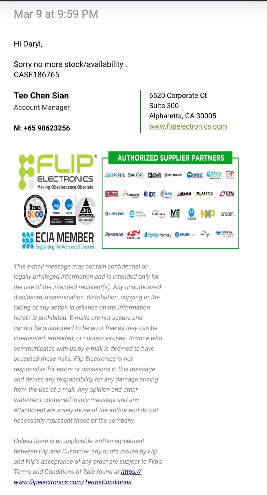

Flip has been discussed before. They are B2B only. If someone with a business in Electronics wants to help broker the transaction, please reach out to me.
Seems like we are late or getting pushed aside on all these requests. Hoping that MOER will have some luck with tacticalic.
