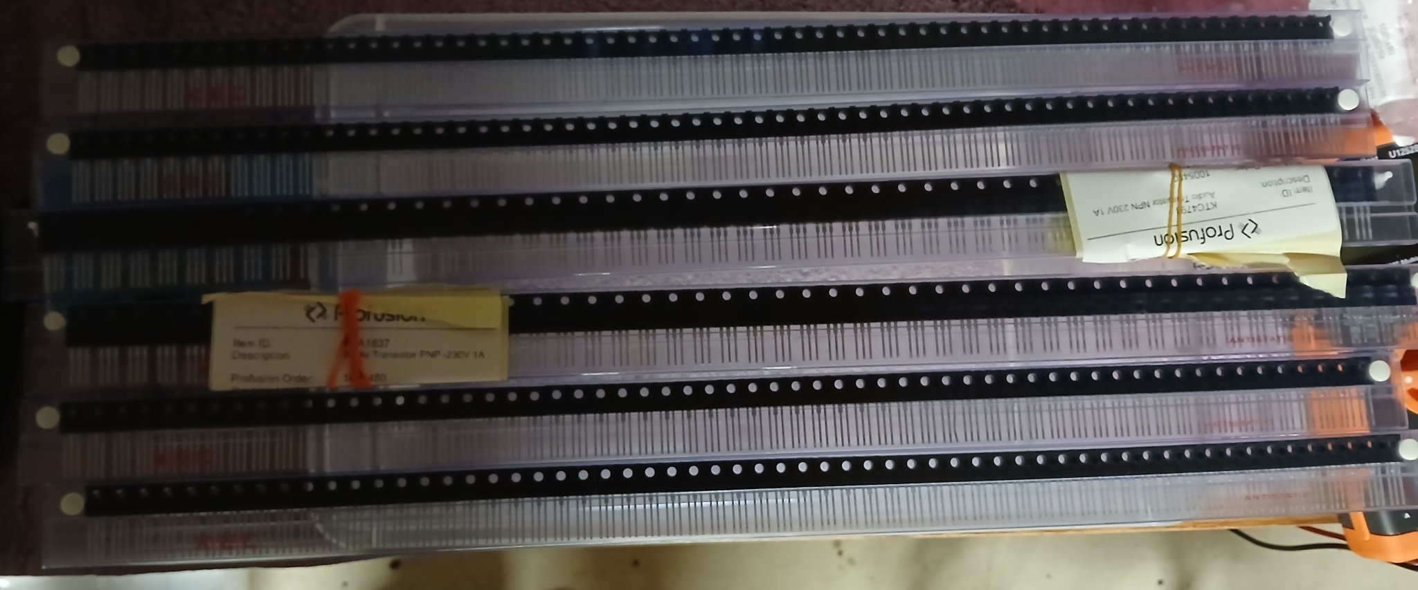

I received my order from Profusion, arrived in 6 days.
Some KTC3503Y & KTA1381Y. From a few I tested, the KTC3503Y hFE was 153-159. The KTA1831Y hFE was 125-127.
I also added a tube of KTC4793 & KTA1837 to the order.
