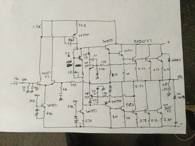

Hi Anatech, i posted a few operating points, we can see that the gain is around 110 --> 90 up to 1A and start to fall abruptly above 1.5A, that s exactly what is displayed in the datasheet.
110/120mA, 93/840mA, 75/1.5A, 41/3.6A, and so on to 31/5.2A
Indeed and always liked the triple for Quasi but was little hard to tame for stability.
Without the differential input, could be much easier to make a stable amplifier.
Feedback loop after output cap should improve bass , be able to use shown smaller cap.
I could see potential to get to much lower distortion with fine tune.
And just keep it single supply for fun

I ll re do a test for the fun with some Motorola models that i ve still at hand, from memory the gain is about 80 at 1A,
with a MJ2955 you could do a very good amp with just an EF2 provided that it had no more than 3A current, indeed
in simulations with an EF2 there s a brutal increasement of H3 past this value and it is ubiquitous for all such epitaxial
devices that were generic of the 2N3055, including the old darlintons like MJ2500-2501/3000-3001, TIP141-142/146-147, BDV64/65-BDX66/67 that were all generic of this transistor.
All those old power darlingtons have a resistance that goes from the emitter of the driver to the emitter of the power transistor,
typicaly 60-120R depending of the device, the higher the TDP the lower the resistance, it is 70R in some high quality Sanken darlingtons, these ones have tremendous gain and Ft contrary to the old epitaxial from the late 70s.
3 amps of current is only a 28 volt rail and 8 ohm load only. So three in parallel is about right if you want to drive a low impedance load. For “8 ohm only use” you can get by with a damn TO-220. They’ll just blow at 4 ohms, but if you never abuse it they’ll run forever.
Those Sanken darlingtons are nice. The best ones handle full power to like 70 volts, and give me less stability problems than the old school ones. The problem with the old school ones is the driver is no better than a TIP31 speed wise. And the monolithic ones don’t really like being run in triples because the base-emitter resistor for the driver is in the wrong place. They simply omit it on the Sankens, leaving only the one on the output. They run fine in triples with a TO-92 predriver, and a resistor hung from base to output rail. And have enough gain where you don’t really need to unless you WANT to (ie, lowering Zout when clipping - a little habit I picked up from the rave DJ days).
No, kind of a “DC300A” with output and input caps. it’s short circuit current is limited to just over 8.5 amps. But will drive a typical 2 ohm load (4 pairs of speakers in parallel). The idea is not to spot weld. And enough heat sink where it can actually do it for more than 15 seconds at a time (unlike the original).Hi wg_ski,
Spot welder? lol!
I thought about doing a 2N3055/MJ2955 version with stacked series outputs. But it would take 16 per channel, and that’s a LOT of drilling and I doubt I could fit it in that form factor. I started a PCB design with a “tunnel” heat sink, and two boards would clam shell together, but like many projects remains unfinished. The board design is around here somewhere in one of the many 2N3055 threads.
You know, I've rebuilt enough DC300A amplifiers. They used an excellent op amp. Still, didn't sound very good.
Stacked outputs. Not a great idea, like a Marantz 510 amplifier and many others. They can have stability issues too. ... And yeah! WAY too much drilling and mounting, but you would have all kinds of heat spreading.

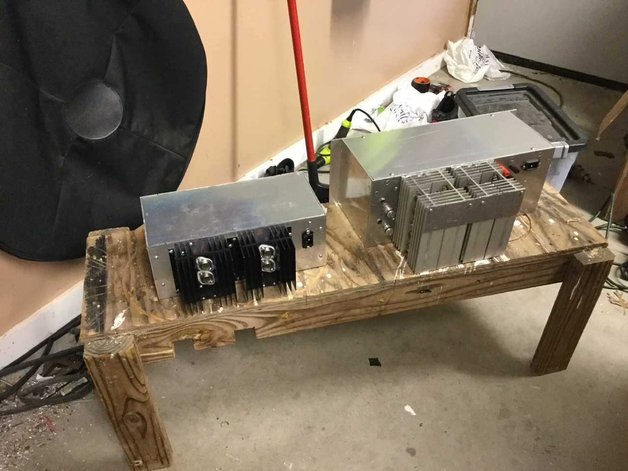

Tunnel heat sinks work great, but need the fan to run all the time at low speed at least. Great examples would be the Marantz 500, 2500, 2600 and 510, Luxman M05, I think the Yamaha EMX-300 used a one sided tunnel and very effectively made a flat, powered mixer. I may have the model # wrong. Paging amplifiers once used a bit of sheet metal against a finned heat sink to form a tunnel, again more effective cooling (Yamaha turned this on it's side). I'm sure there are many other very good examples as well as junk that used a form of a tunnel.
The worst thing about a tunnel is the fan noise. Then as the fan ages it picks up dust and other deposits and that gets noisy. The bearings eventually become noisy as well. I like convection cooling, no fan to fail or plug up. If it has an air filter, almost no one cleans or replaces them. The best part is that they are quiet and don't pretend to be vacuum cleaners.
