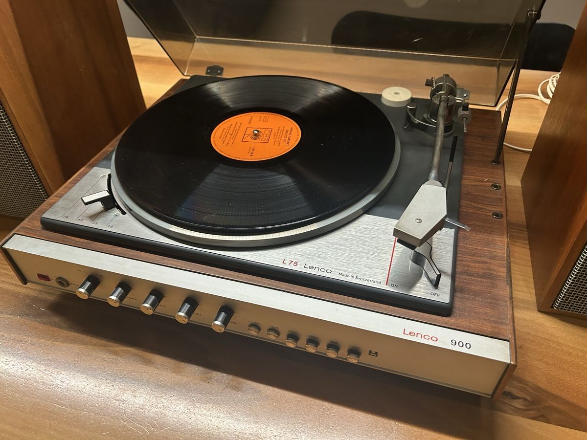

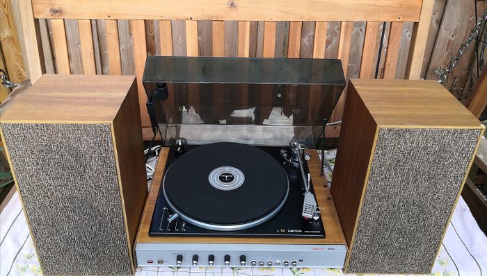

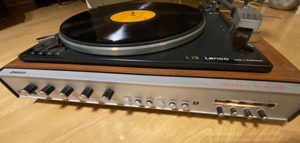

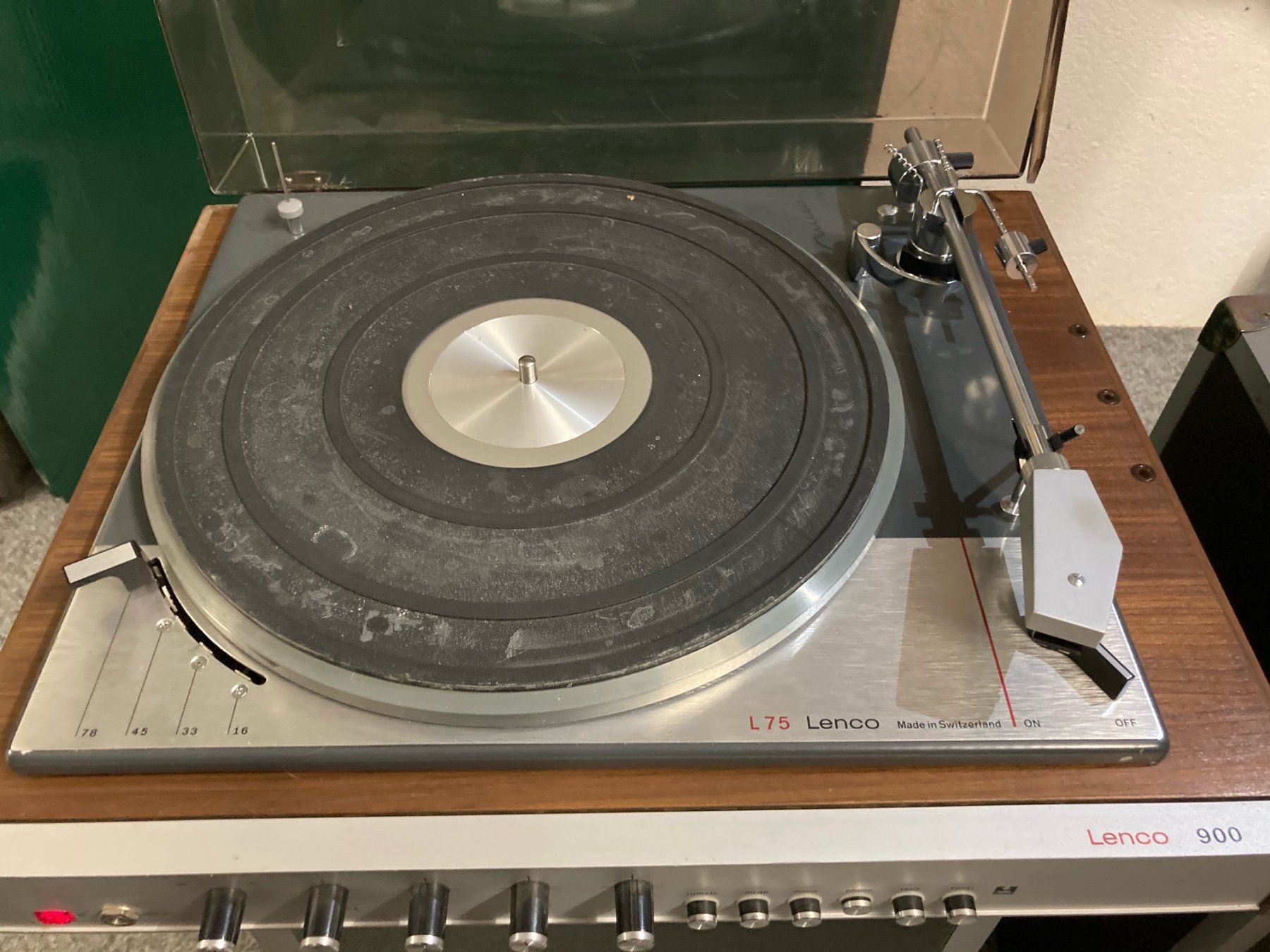

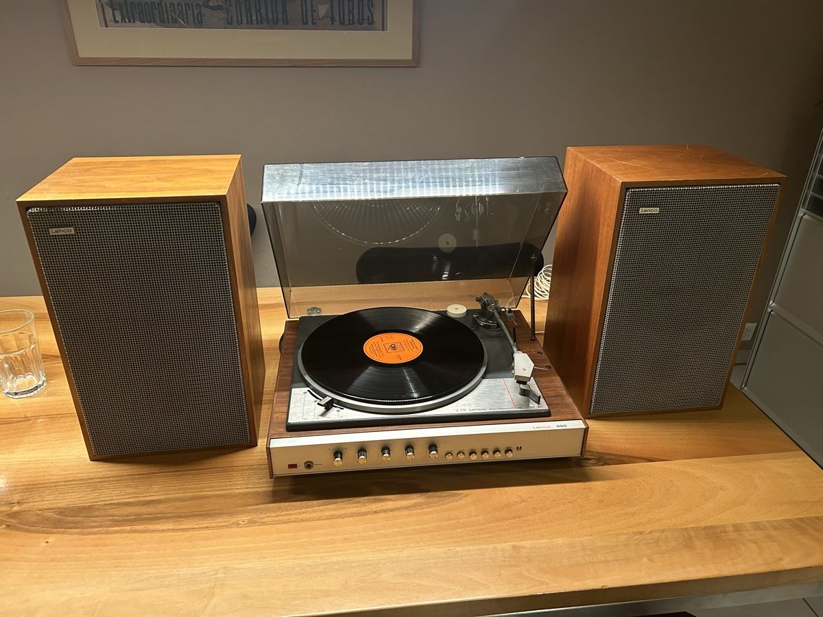

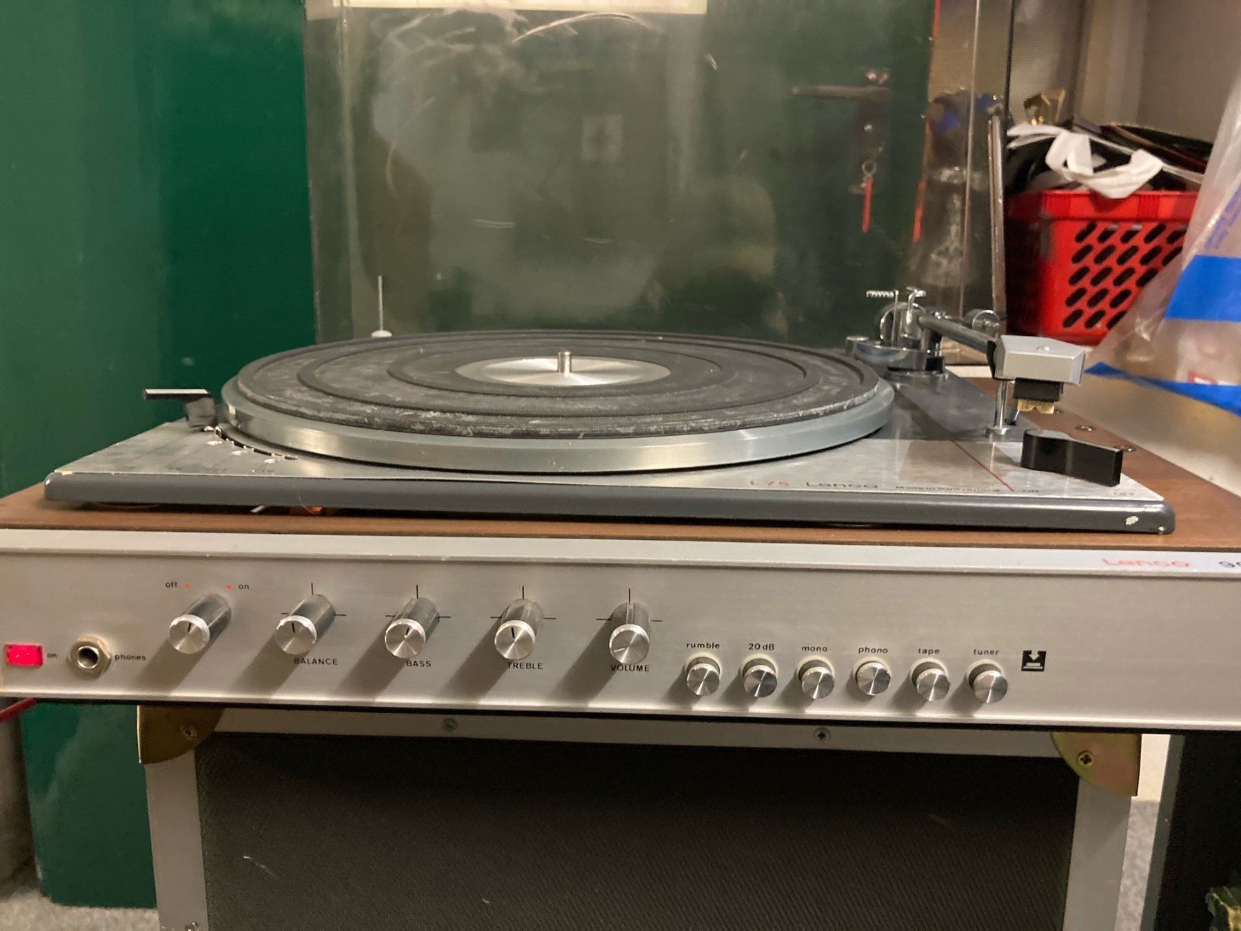

thank you for this advice - L900 is the integrated amp and the used turntable is the model L75 (sometimes the L78)Probably the best amplifier with 2N3055 was the Bedini 25-25. But let's not forget the integrated Lenco L900 combo turntable +15+15 2N3055 amp.
https://www.lencoheaven.net/forum/index.php?topic=16499.0

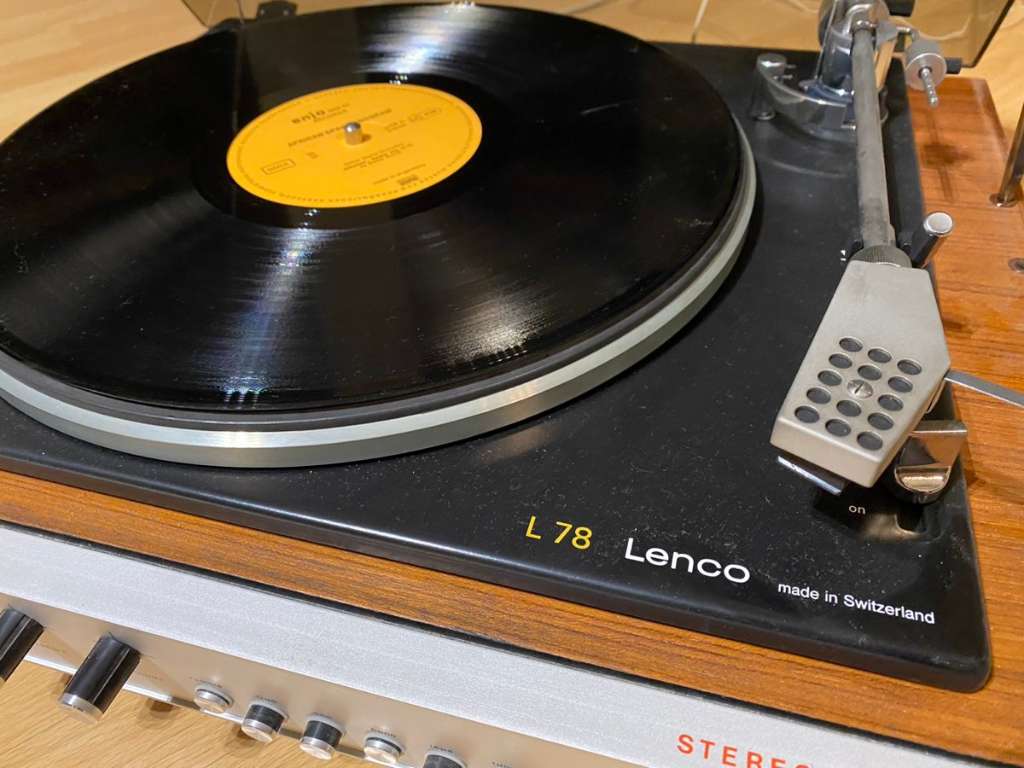

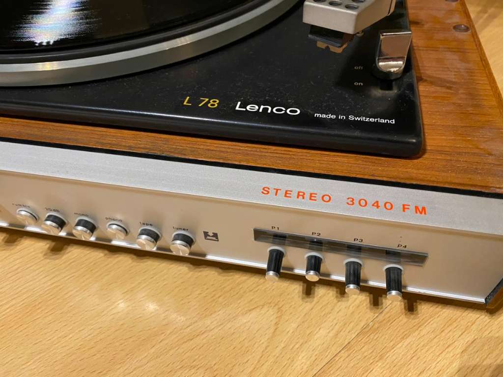

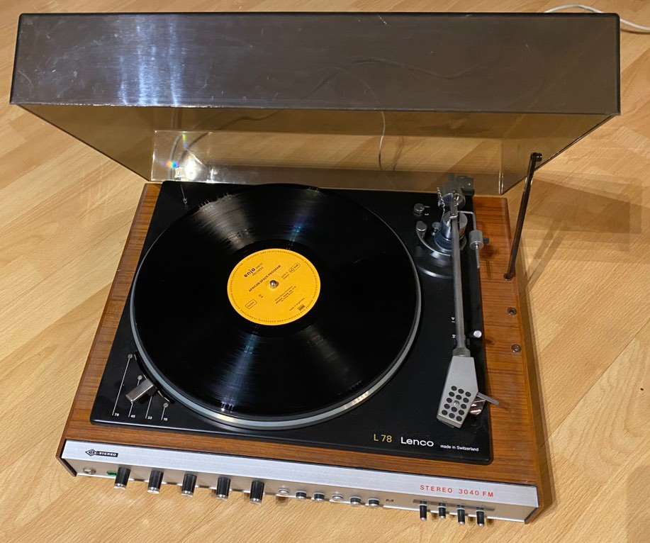

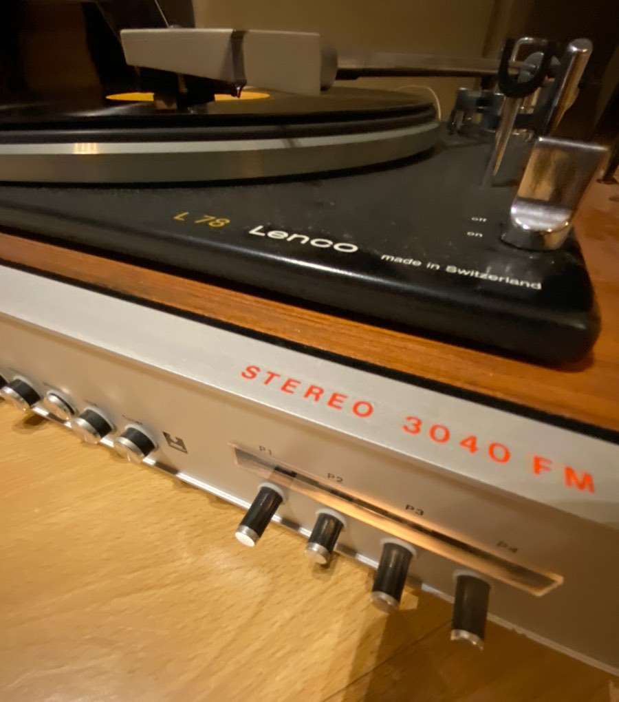

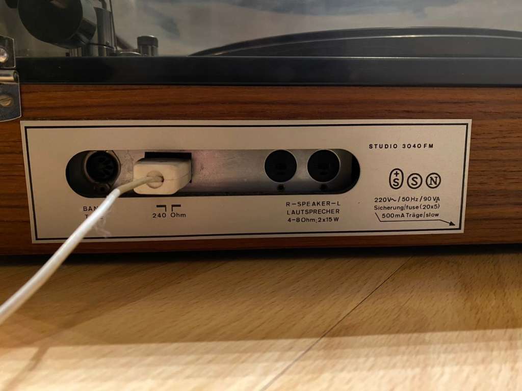

Also with integrated FM stereo tuner available (model "stereo 3040")

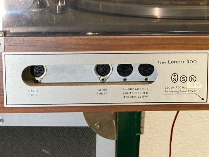

It was loud for the time, looks nice too. But the question is what output transistors it had? was it 2N3055?
Those early stereos were gruesome things. They did not perform well compared to real audio equipment. But, they were much better than something along the lines of a "Candle" having the same format. The earlier version of the Lenco used Germanium transistors. It was terrible, but people loved them.

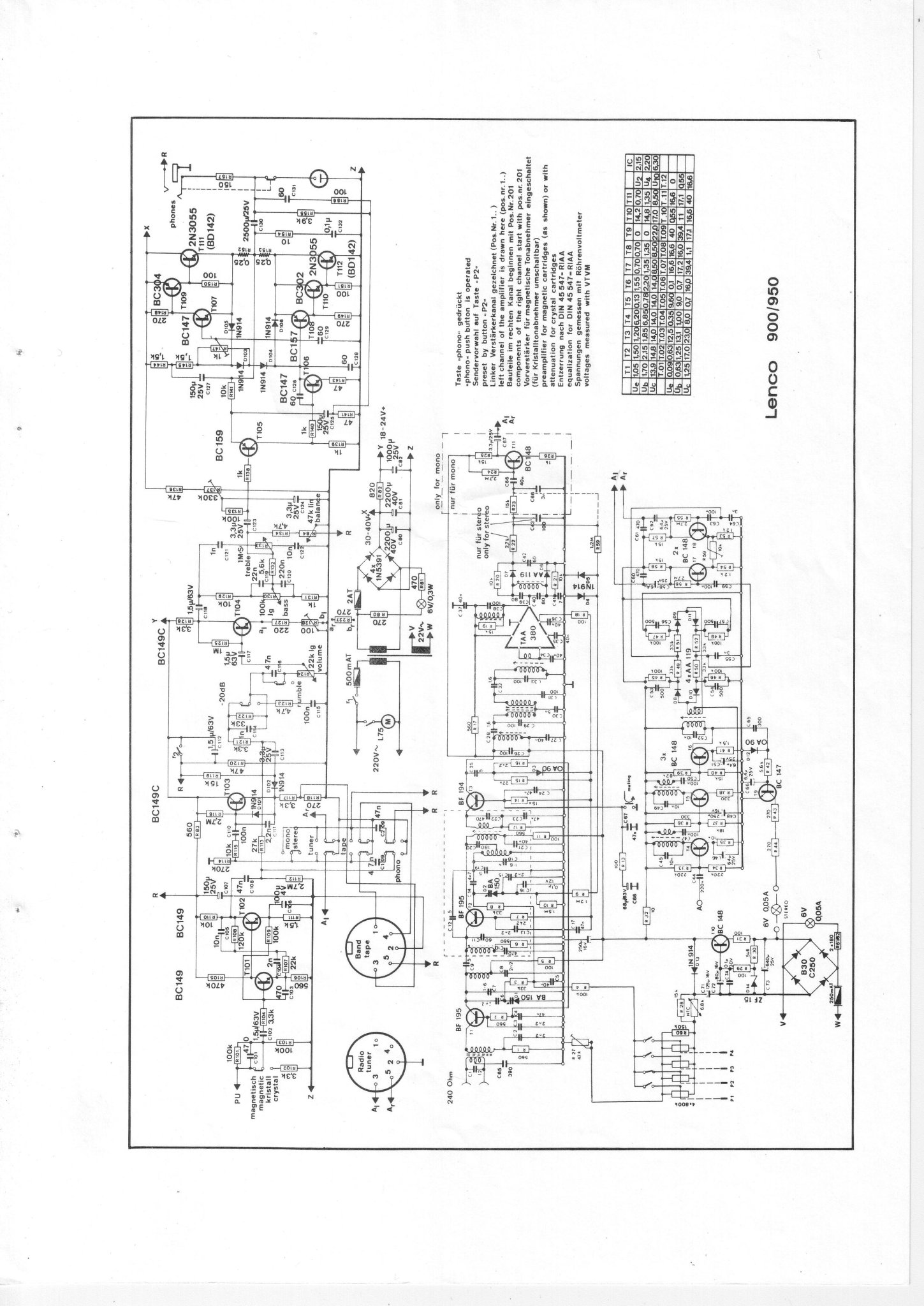

question post #596:
according schematic for 900 under
https://www.hifi-archiv.info/Lenco/Lenco L 900 Manual/index.html
(also in the attachment)
sometimes 2N3055, sometimes BD142
stereo 3040FM is the same
