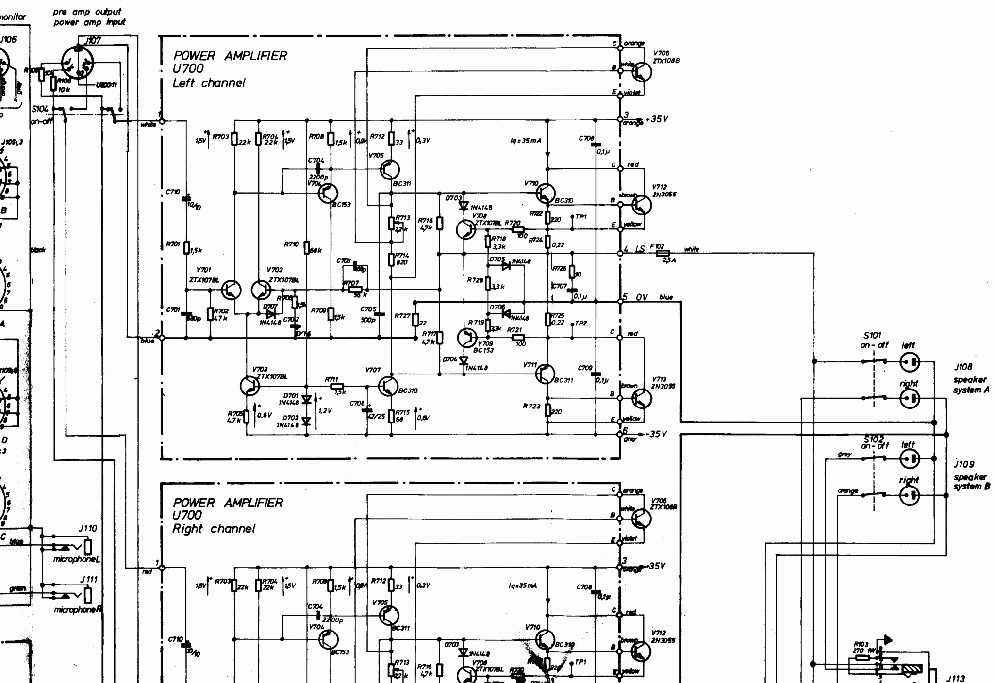

German manufacturer Klein & Hummel used them as power devices in their ES-707 integrated amplifier from 1969, whose power amplifiers basically were RCA Power Transistor Manual designs. But I also don't know anything about the reliability of this ES-707. They were also used by Naim.

High speed switching type, similar to 2N5038. I know they used those and the BDY58’s in the modern Naim clones, but some are being built with Sanken LAPTs as they are actually cheaper today. Digikey wanted stupid money for a 2N5038 last time you could get them there.
Hi wahab,
The CCS tail current for a diff pair was well known as a best practice even back then. It comes down to the fact that a resistor is less expensive than all the parts used to make a CCS. The cost of a signal transistor wasn't killer back then unless you are talking about a cheap product.
Once manufacturers began looking at performance, late 70's and early 80's, you saw circuit design get serious. Otherwise it is merely a cost issue, including the cost of stuffing the PCB.
Cost components was an issue but there was often tricky designs, FI this Sonab P4000 has a lot of good things, CCSs for both the LTP and VAS, this latter being enhanced with an emitter follower, wich is a very good idea, but it s not perfectly designed with a hasardous compensation scheme among others, output stage use two 2N3055, because at the time manufacturers would sell you an NPN power device for say 2$ while they scamed you by asking 10$ for the PNP complementary.
That Sonab P4000 schematic has a lot of good things going on indeed; no need for a Baxandal diode in this driver/output topology. Smartly done.
Stick a PNP in there and increase R714. Potential pot wiper problem solved, and no need to kluge the PCB doing it.…. with a hasardous compensation scheme among others, output stage use two 2N3055, because at the time manufacturers would sell you an NPN power device for say 2$ while they scamed you by asking 10$ for the PNP complementary.
Keep the NPN output stage, but use MJ15003’s and you can 4-ohm it all you want to. Back in the day when the 3055 QCs we’re all over the place, there was a complementary pair available - 2N3716 and 2N3792. Yeah, the PNPs were pricey. But if you thought epitaxial 2N3055’s had a ruggedness problem you ain’t seen nothin yet till you tried 2N3716’s which did have an 80 V VCEO rating. Plug it in, turn up the volume and wait for the kaboom. Only thing that goes faster are germanium.

Are you sure? Seems to me the circuit would still benifit from a baxdalThat Sonab P4000 schematic has a lot of good things going on indeed; no need for a Baxandal diode in this driver/output topology. Smartly done.
Diode//resistor.
Maybe, but keep in mind we're talking about 2N3055 outputs. It's like putting makeup on a pig. Why?
The 2N3055 is an economy transistor used for the sole purpose of saving costs by the time better ones came out. Almost anything performed better, MJ15003 / MJ15004. 2N5631 / 2N6031 and of course the 2N3773 / 2N6609 being solid industry performers. If I ever saw a blown 2N3055, I always used something better for replacement. The original was a linear power supply pass transistor. That was the original design and one reason why originals had low fT (so they wouldn't oscillate mounted off the PCB on a heat sink). As semiconductors matured, we were treated to even better parts and higher amplifier performance as a result.
