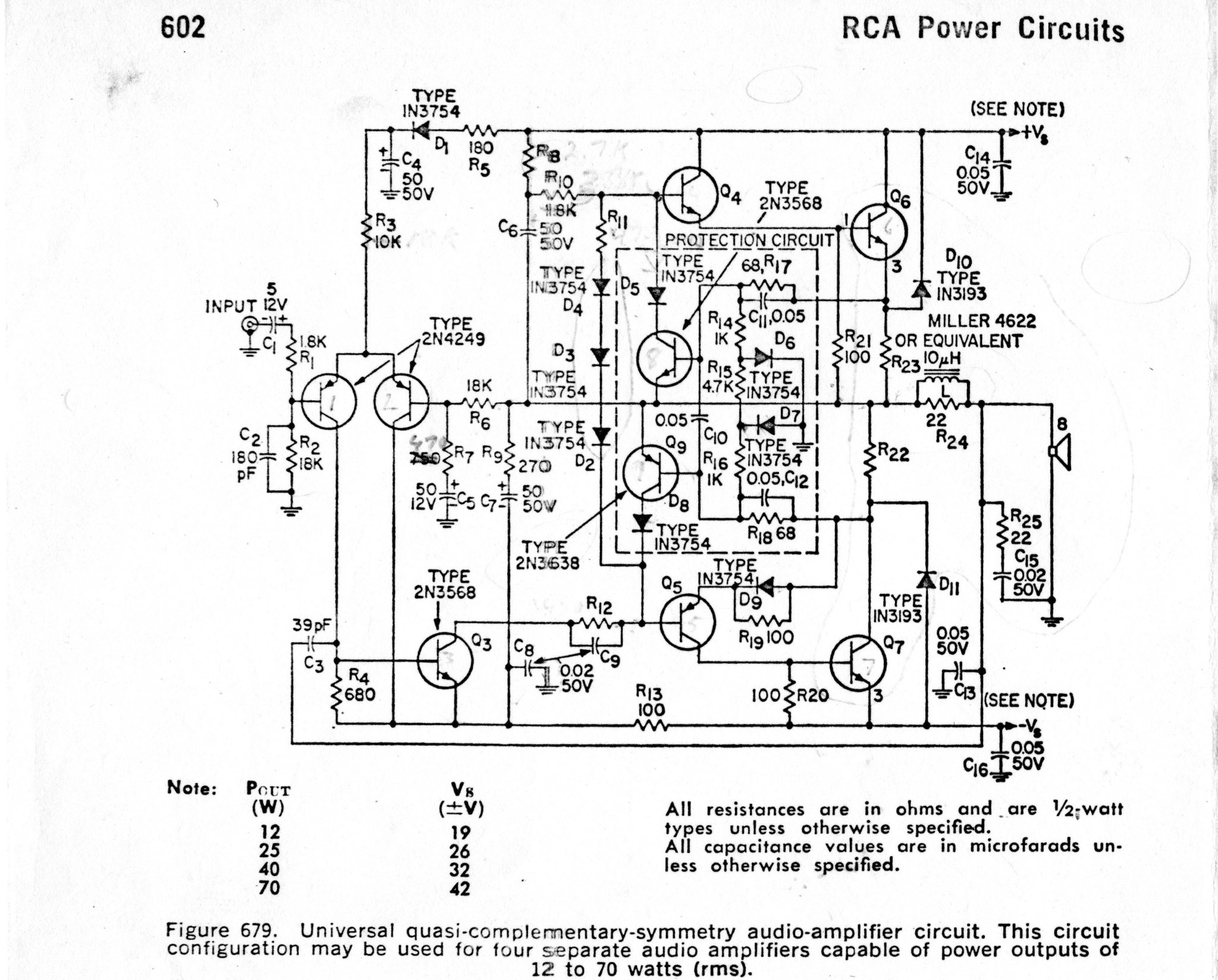

In 1976 I built the 70W version of this amp from the RCA Power Circuits handbook.
Although it lists the output devices Q6 & Q7 as 40636's, when I tried to buy them the distributor said they were NLA and replaced by the 2N3055.
So that's what I used and it worked out well.

40636 was just one of many “selected 2N3055’s”. As the process matured, most of them would actually take 80 volt rails.
I had an old HH Scott with the singleton input (but other than that, same schematic). It had a 75V singke supply with output caps. It called for either 40636, 40411, or 2N3055. Mine had the 3055’s. Drivers were what blew - and I ended up using MJE181/2 because the originals were NLA. I ran with the original set of outputs, which survived the fault. Motorolas wouldn’t have.
The PDF don’t want to open on this old machine. But if I recall it, it was 90 volt VCER instead of only 70. I think 40636 was 80 volt VCEO. I used to have that whole old data book, but it disappeared eons ago. Oldest I have now is the 1982 Harris power device book. And the 2N3053/4/5 pages (and front cover) are long gone. A few fell off and got lost every year. My first page now is the 2N3439/3440/4063/4064 page. And all the 5-digit house numbers were no longer in use at all.
My RCA databook (falling apart but all pages still there) says 40636 Vcer=95V.
For some reason best known to themselves RCA relabelled the 40636 as an RCA1B01. But a moot point because that's gone too now.
Quite a few Moto transistors (Onsemi) like the MJ15003/4 would work in these old amps. Probably without mod but a better approach might be to improve the bandwidth. (MJ15003 fT=2MHz compared with 2N3055 (H type) which maybe managed 1MHz.)

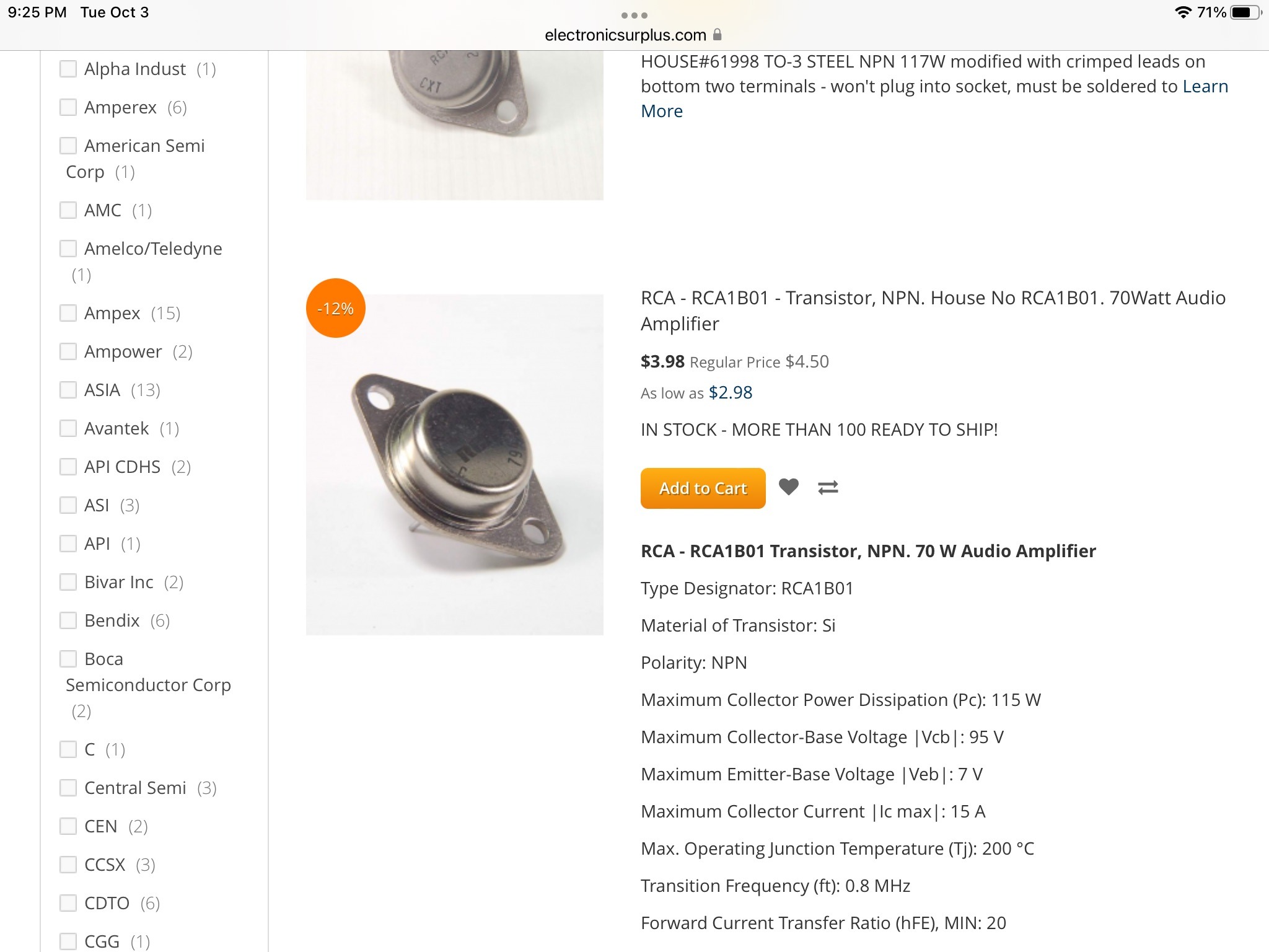

I found some place actually selling the 1B01 surplus, and it lists 95 Vcbo. Ive never actually run into those in an actual amp, but every manner of 5 digit #.
When fixing those old amps my usual inclination is to put in something better than a 2N3055, like a 2N5631. I have a pretty good stash of the NPNs and PNPs - in the old aluminum case. Could use MJ15024’s, but if it don’t need that I save them for what does.

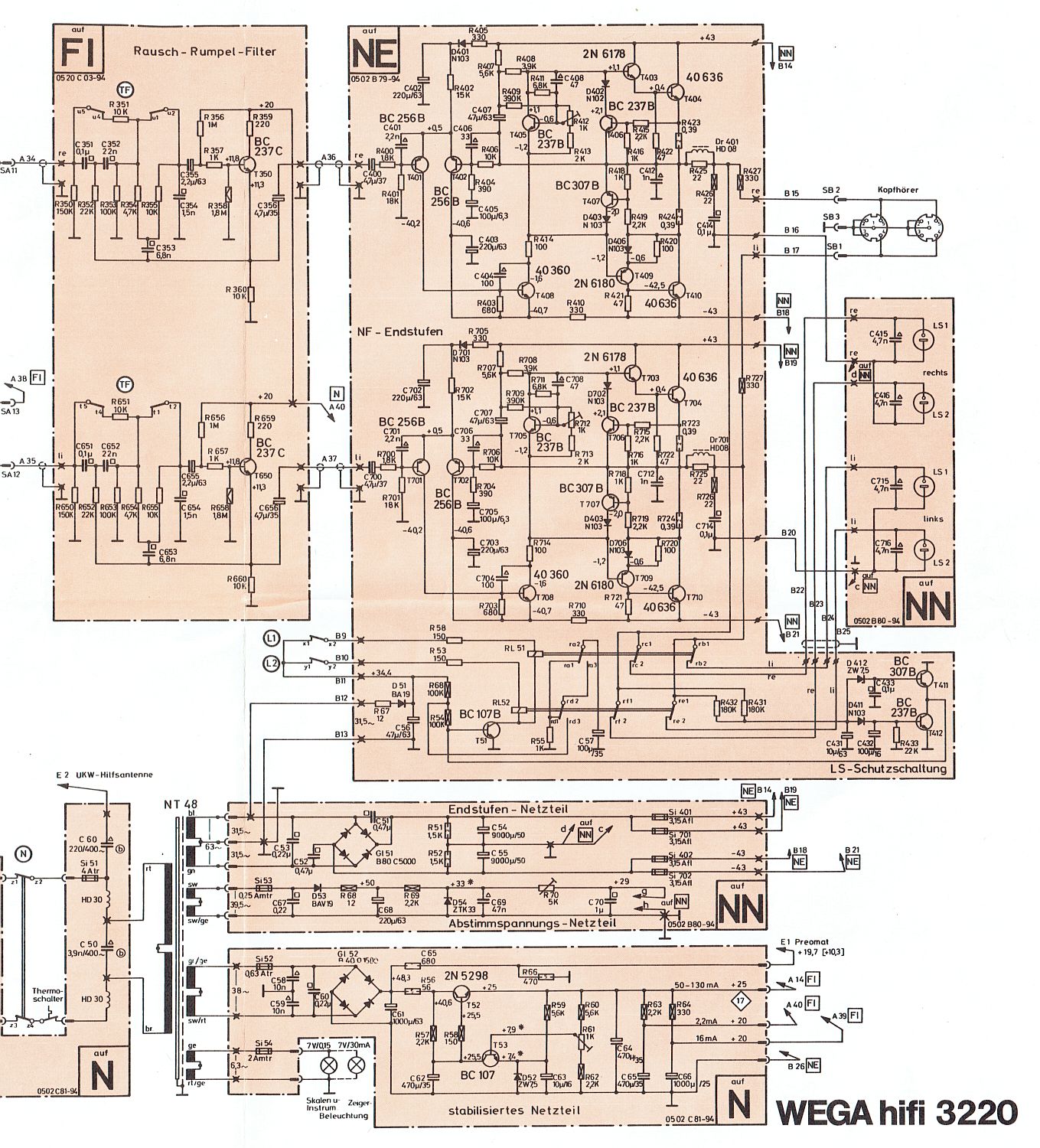

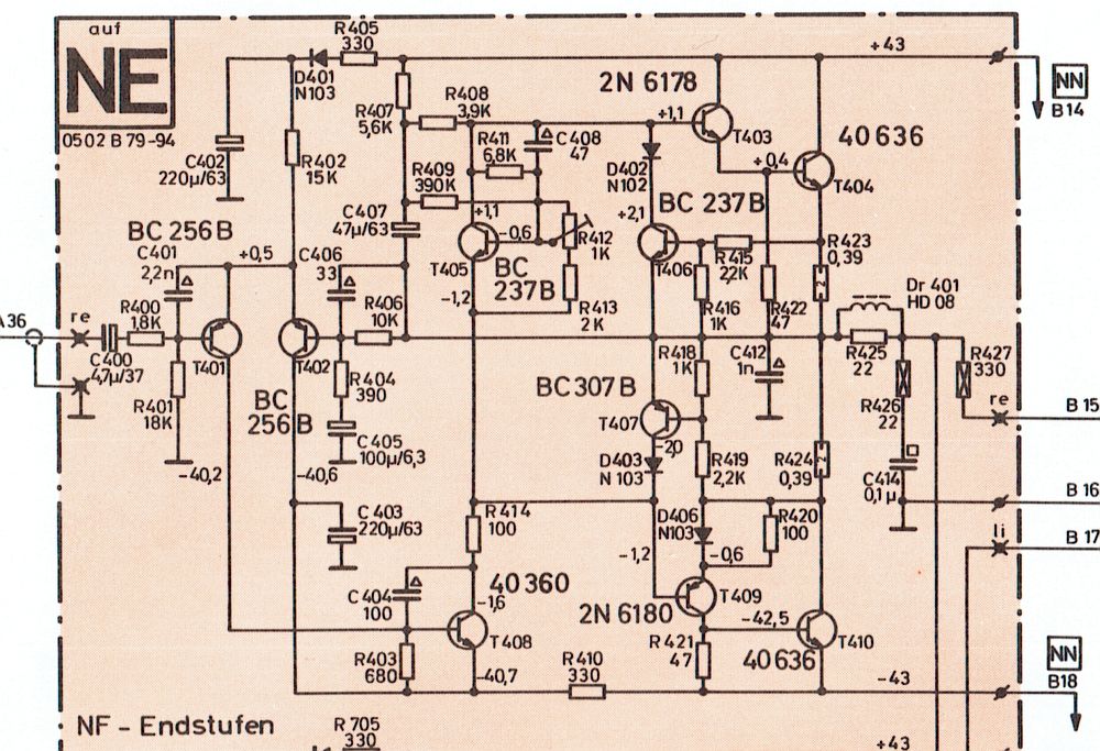

Talking about the RCA 40636, I just demolished a junk Wega 3220 hifi console yesterday which has a quasi-complementary output stage with the 40636 devices. The unit came with the original service manual, so hereby a scan of the output stage. Rail voltages are +/- 43V, which each rail to each output stage individually fused at 3.15A. I have no particular future project for the 40636 devices, so if anybody needs them they are available, as well as the original service manual.
This circuit is very close to RCA's own circuit in the RCA1B01 datasheet (also attached).
Baxandal diode already incorporated; but the circuit would benefit by constant current sources in the input and VAS stage.

Thank you for posting this schematic and datasheets.
One detail in the Vbe multiplier of the power amp unit from Wega's 3220 hifi console is very special: R409 (390K).
This I haven't see before.
What is the aim of R409 ?

why did you demolish this design icon? And what did you do with it's Dual 1229 record changer?
Anyway, yes, the power amplifier appears to be right from the contemporary RCA appication notes, as well as the RIAA amplifier which fell out of the Fairchild µA739 databooks.
