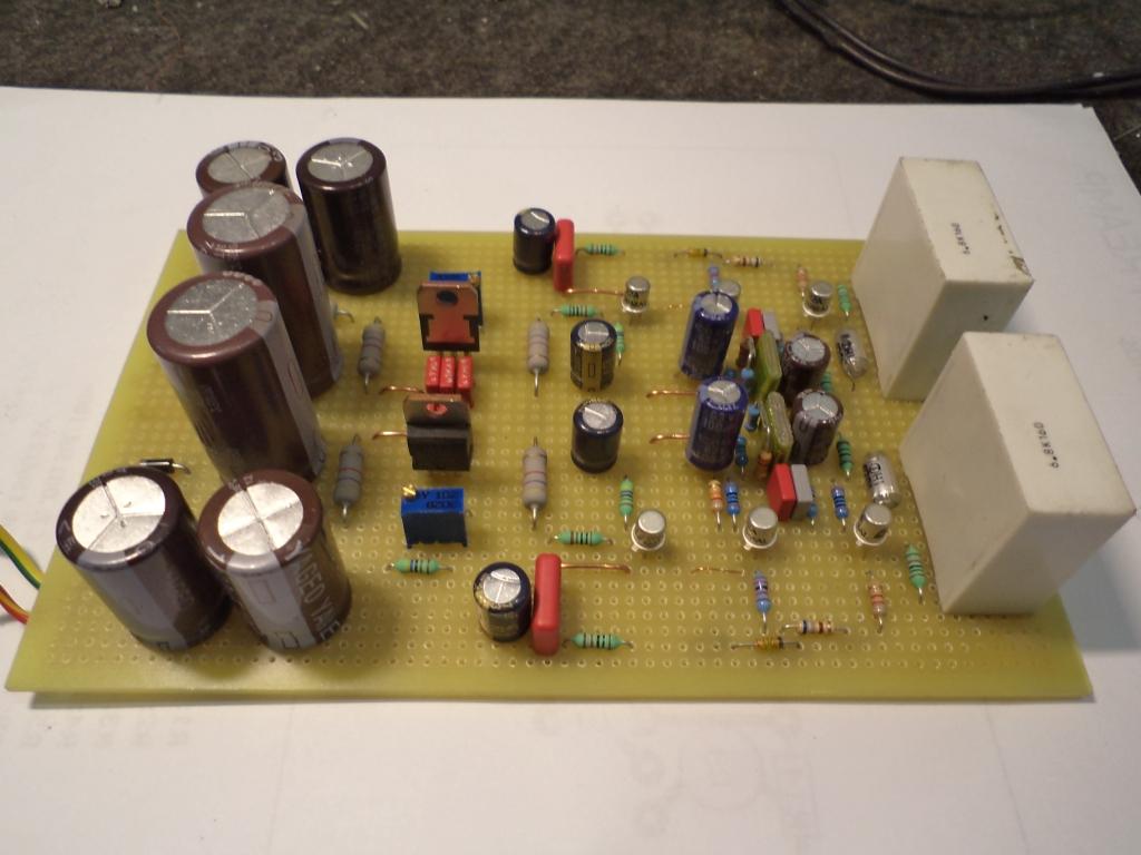

I am constructing in a vero board as we speak couple of things i can tell for sure
---In minimalistic circuits like that PSU plays a very important role
---When it comes to the RIAA net work except quality and tolerance i noticed variations depending on the make of the part regardless of the value
Working on it pictures in a few hours

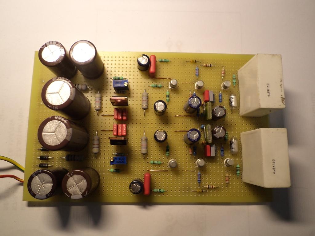

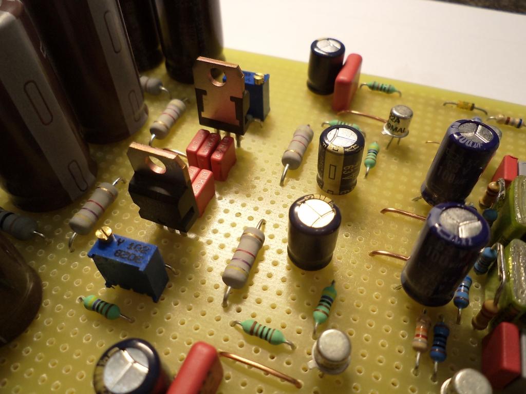

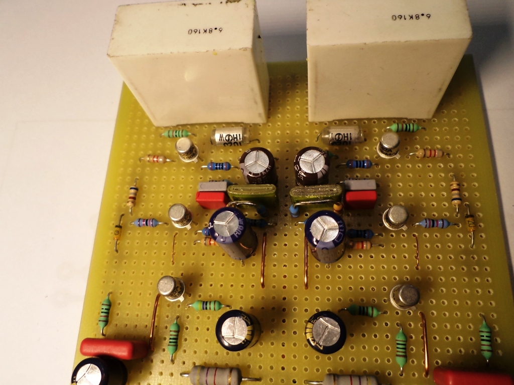

The board is working on the first click ...No mistakes that i have noticed .
I decided to go with regulated rails and a different power supply for each ch ... have made couple of things different there ( i like my own style of regulation based on LM 317 ) but with one or two twists.
Gained plenty of experience on that while trying to find a more audiophile psu yet simple for my DOZ There learned that the DOZ is a far better preamplifier if supplied properly ...
couple of things
1) yes the board is the same neat as is on the top both on lower side
2) yes both trimmers increase supply if turned CW😀😀😀
3) I will install termination options on the input plugs depending on the customer that is going to listen to the phono stage and his pickup settings
4) No changes from the original circuit except minor changes in the RIAA network ( very minor ) and also there mix matching of the capacitor types produced slightly different results kept the original values almost and trusted my ears for the rest
5) input capacitor was done with a MKT 6.8/ 160 ... I don t like that but it was the only thing available at the shop on a Friday afternoon and output capacitor was 47/63 extremely low ESR and bypassed with 1.0 ufd film capacitor ....
My intention is to see if there is any noises after the board is housed in a metal case and i will keep the options open to supply from a CT depending on the noise if any produced ...
Then i will listen to it ... give to a few phono enthusiasts , customers and friends that normally own sophisticated systems to see how it will turn up .
Here is some photos of the board and in a couple of days new one will come up with the complete construction.

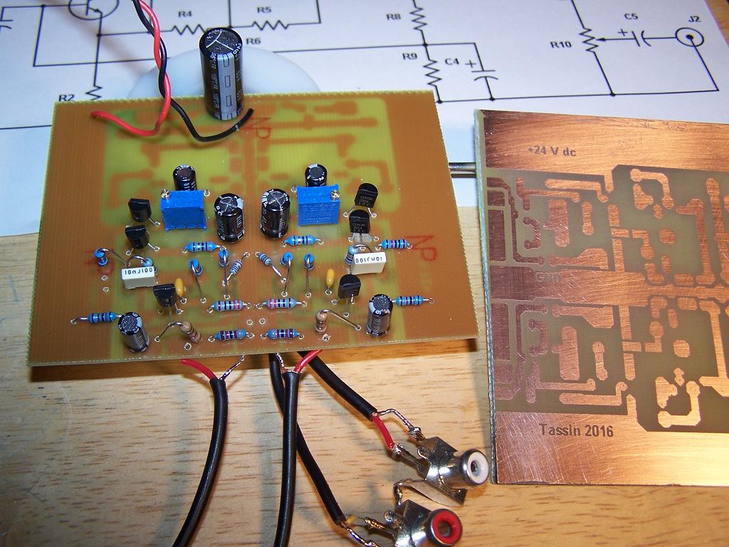

Well it's been a while but I finally built Ivey's pre-am. I put a 4K7 trimmer instead of the fixed resistor so I could balance the outputs. I also took out the
1uF cap in the input. I'm not going to say that this is the best sounding pre I've ever heard but it's in the top 5%. I made my own pc board layout because I may add a tone control section in the future. The layout is there, I just have to mount the components. All total I spent about $20 usd. Not bad at all.

That is real pretty stuff.
The broads are great looking, with a good ground plane.
What layout software did you use? I use Express PCB.
Also, the use of the pot, was a grand idea.
