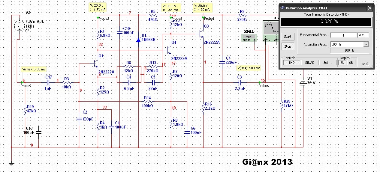

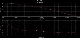

In memory of Ivey i studied his circuit in my multisim, started to test in real life and i would like to share my implementations and optimized components values. For an "old" riaa, calculated by hand, it's a great result!
If you want i will show my "tribute" to Ivey with my schematic and graphs from simulator, than a simple pcb with or without his series regulated supply, so similar to that i used for years with excellent low-noise satisfaction in musicality.
Are you curious? 😉
Sonically yours,
Gianni
Ok, let's start!
Major improvements are:
Less distortion: from 0,3% to 0,03% @5mVrms - 1KHz
More headroom, especially in high band: before it was 2dB @20KHz, now 10dB!
More accurate RIAA curve: now is within 0,2db with E12 series!
Less noise: now it's under 80dB @1KHz and under 65dB @20KHz.
Added the possibility to tune-up the MM with an additional loading cap and/or resistor (asked during the thread).
I prefer a light subsonic filter under 40Hz, it's easy for everybody to modify a capacitor if you want to go flat @20Hz.
I use 2n2222A in TO-18 metal case and i love this simple and old circuit!!!
I would like any feedback, i will answer to tell my point of view and my choices.
Gianni
